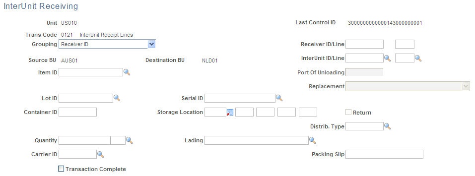

InterUnit Receiving Page
Use the InterUnit Receiving page (BCT_INV_IURCV) to correct or modify transactional data for interunit transfers staged with an electronic data collection system or received from a third-party material management system.
Navigation:
SCM Integrations, and then Create Transactions, and then Inventory, and then Interunit Receiving
This example illustrates the fields and controls on the InterUnit Receiving page. You can find definitions for the fields and controls later on this page.
Transaction code options are:
Field or Control Description
0120 - InterUnit Receipt
Use to enter basic receipt information.
0121 - InterUnit Receipt Lines
Use to enter detailed receipt information. You can complete the receipt using only this transaction code (by selecting Transaction Complete) or using the InterUnit Receipt End Transaction.
Note: This transaction code is the default value when you first open the page.
0125 - InterUnit Receipt End Tran (interunit receipt end transaction)
Use to complete an interunit receipt. When you save the transaction, PeopleSoft Inventory sets the transaction log status for the receipt to New, enabling the InterUnit Receipt process to pick up the transactional data for processing.
The system displays or hides certain fields on this page depending upon the transaction code that you select.

The business unit defaults that you established on the Inventory Display Options page govern whether lot, serial, staged date, and configuration fields appear upon entry to this page. Any fields for which the default is Yes always appear. Any fields for which the default is No appear when you save or refresh the page, and only if they apply to the item in question.
The business unit's default display options determine how many location levels appear upon entry to this page. If you are entering a material storage location that requires additional levels, enter the storage area, then refresh the page to display the remaining levels for that area.
If you are using the InterUnit Receipt Lines transaction code, select to complete the receipt without entering an InterUnit Receipt End Tran transaction.
When you save the page, PeopleSoft Inventory inserts the transactional data into the transaction log and clears the page; therefore, you can enter a new transaction.
