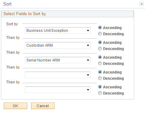

Sort Page
IT_EXCPT_SORT
Configure sort parameters to be used on the Manage Exceptions page.

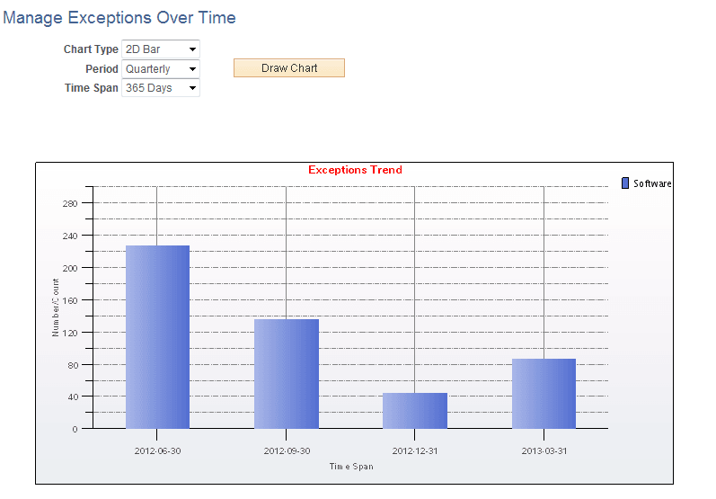

Manage Exceptions Over Time Page
IT_CHART
View a graphical representation of the number of business rule exceptions over time.

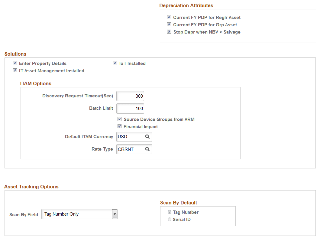

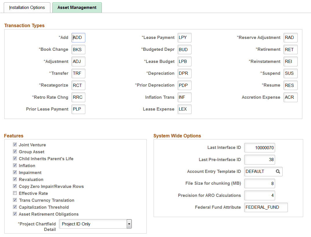

Installation Options — Asset Management Page
Use the Installation Options — Asset Management page (INSTALLATION_AM) to set the batch limit for PeopleSoft IT Asset Management and choose whether to display the financial impact of assets within PeopleSoft IT Asset Management.
Navigation:
Set Up Financials/Supply Chain, and then Install, and then Installation Options
Click the Asset Management link.
This example illustrates the fields and controls on the Installation Options - Asset Management page. You can find definitions for the fields and controls later on this page.
Installation Options - Asset Management page (1 of 2)
Installation Options - Asset Management page (2 of 2)
Select the IT Asset Management Installed check box to access the ITAM Options group box.
Field or Control Description
Batch Limit
Run Manage Exceptions in either a batch or online mode. Batch mode is the appropriate choice for large numbers of exception transactions. The batch limit specifies the threshold for switching from online to batch processing. In this example, if there are 100 or more transactions to process, the processing will occur in batch; if there are fewer than 100, processing will occur online.
Enter the threshold to determine whether or not to process the exception actions online or in a batch process.
Financial Impact
Select this check box to display the financial search options and financial information within Manage Exceptions. When this check box is selected, the Financial List and Financial Impact appear on the Manage Exceptions and the Manage Assets Not Reporting pages as search criteria fields. Additionally, when there are assets that have exceptions, there is an additional tab that appears in the components called Financial Information.
See Application Fundamentals: Installation Options - Asset Management Page.

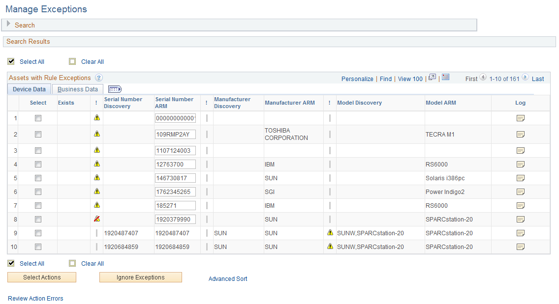

Manage Exceptions Page
Use the Manage Exceptions page (IT_EXCPT_SEL) to search for exceptions and perform reconciliations on the displayed exception list.
Navigation:
IT Asset Management, and then Asset Discovery and Validation, and then Manage Exceptions, and then Manage Exceptions
This example illustrates the fields and controls on the Assets with Rule Exceptions - Device Data page. You can find definitions for the fields and controls later on this page.
Exception Exception
The system displays the exception icon beside each discrepancy that is found for the asset.
Ignore Exception Icon Ignored Exception
This icon appears when a Business Rule exception has been designated as an ignored exceptions for an attribute for a given asset and if the ignore exception is current. That is, the icon appears if the ignored exception Begin Date is less than or equal to today's date and the Expiration Date is greater than or equal to today's date. This icon displays until the next run of the comparison process. Ignored exception actions are not included for selecting actions.
Exception_ActionPerformed Exception - action performed
This icon appears if an action has already been performed for that attribute. Once an attribute for the asset has been processed, it cannot be processed again. This is true even if there is more than one action to take for that attribute. Once the first action has been applied in a session, a second action cannot be applied for that attribute in a subsequent session. In order to apply further actions, a new Asset Comparison must take place.
Device Data Tab
Access the Device Data tab.
The following definitions apply specifically to the business rules delivered with the system. The suggestions for reconciling this information may be different in your environment.
Exists
Displays alert when there is a duplicate serial ID for those assets that have an "Asset Not in ARM" exception. The Exists column is irrelevant (blank value) if the asset does not have an "Asset Not In ARM" exception. Click the link to access the Manage Physical Use page. The values that display in this column are:
  • D: (duplicate serial ID) - an asset exists with the same serial number in the ARM that is also designated as being in physical use (IN_PHY_USE = Yes). (Only one of these assets should be enabled as in physical use.)
  • E: (exists) - an asset exists with the same serial number in the ARM but it is NOT in physical use (IN_PHY_USE = No).
An Asset Not in ARM exception can result from three different scenarios:
  • Asset not in ARM exception (with no duplicate indicator in the Exists column) - the asset should be added using the Manage Exceptions page functionality. Manage Exceptions generates workflow to add the asset.
  • Asset not in ARM exception (with D in the Exists column) - the asset should NOT be added using the Manage Exceptions page functionality, as there are already more than one asset with this serial number. One of these existing assets should have the In Physical Use flag enabled. This will remove the duplicate and allow one of the assets to be reconciled. A decision should be made as to which of the duplicates should be removed from physical use.
  • Asset not in ARM exception (with E in the Exists column) - the asset should NOT be added using the Manage Exceptions page functionality. An asset already exists in the Asset Repository with the same Serial ID. It is probable that the existing asset is the same asset that is found from discovery. To fix the problem, the existing asset in the Asset Repository should have the In Physical Use enabled.
See Understanding the Compare Asset Repositories Process.
Serial Number Discovery and Serial Number ARM
Displays the serial number of the asset found in third-party inventory and the serial number of the asset in the asset repository.
If the serial numbers match, you do not need to take any action regarding the serial number, so investigate the exception(s) that caused the asset to appear in Manage Exceptions.
If the serial number (asset) appears in discovery, but not in the asset repository, the appropriate action choice might be Add Asset. If investigation reveals that an asset already in ARM is the same as that asset in third-party inventory, reconciliation allows you to update the serial number in the asset repository through the Manage Exceptions grid. Typos are not uncommon in Serial Numbers. Manage Exceptions deals with them effectively.
In this scenario, there should also be an entry where the serial number appears in the asset repository, but not in the third-party database, and it is at that entry where you can update the ARM number on the grid to match the correct asset from the third-party inventory. If the new serial ID is updated, the exception associated with the third-party asset which is to be reconciled is removed from reconciliation because the updated serial id exception replaces the exception for the asset found in discovery, not found in the ARM. If you have also selected the third-party asset for processing, it will not be processed.
Note: The system displays only those assets that are in your asset group.
Manufacturer Discovery and Manufacturer ARM
Displays the manufacturer of the asset found in the third-party database and the manufacturer of the asset in the asset repository.
If the manufacturers match, you do not need to take any action.
If the manufacturer appears in third-party data, but not in the asset repository, or there is a difference in the values, the default reconciliation action is to update the manufacturer in the asset repository.
The values that are displayed are the descriptions of the Manufacturer field. Both the manufacturer description and the manufacturer ID will be updated in the ARM, if that action is executed.
Model Discovery and Model ARM
Displays the model designation of the asset found in the third-party database and the model designation of the asset in the asset repository.
If the model designations match, you do not need to take any action.
If the model designation appears in third-party data, but not in the asset repository, or there is a difference in the values, the default reconciliation action is to update the model designation in the asset repository.
Select Actions
Click this button to display the actions you may take on the selected assets. For each selected row, all of the asset's discrepancies and the rules and actions associated with those discrepancies are determined. Once determined, the rules and actions are presented on the Select Actions page.
Ignore Exceptions
Click this button to ignore exceptions for the selected assets. You are directed to the Ignore Exceptions page where you can add the selected exceptions to an ignore list.
Note: You should not ignore software exceptions. If the software exceptions are ignored, it could present you with a lower count of the licenses that you have distributed, thereby subjecting you to potential license compliance issues.
See Managing Ignored Exceptions.
Advanced Sort
The assets are sortable with the delivered grid sort (using the header column name.) so you can sort on all columns other than the exception flag columns. The advanced sort allows you to define a sort order by field hierarchy.
Review Action Errors
Click to view any action errors that may have occurred during the reconciliation. Action errors will show from previous reconciliations as well as from this reconciliation after the Submit Actions button is pressed on the Select Actions page. There may be some delay in generating action errors when processing in batch mode.
Log Log
Click the Log icon to access the Asset Comment page. Add relevant comments regarding the exception.

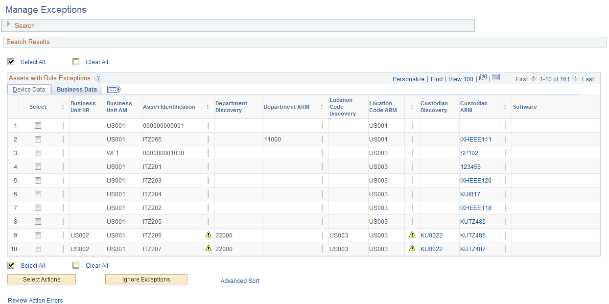

Business Data Tab
Access the Business Data tab
This example illustrates the fields and controls on the Manage Exceptions - Assets with Rule Exceptions page: Business Data tab. You can find definitions for the fields and controls later on this page.
Resolving the custodian exceptions through your standard asset transfer processes for the Asset Repository may resolve department or business unit issues during the next asset comparison process.
Business Unit HR and Business Unit AM
The system displays the business unit associated with the primary user of the asset found in the third-party database and the business unit of the asset in the asset repository.
If the business units match, you do not need to take any action.
If the business unit appears in third-party data, but not in the asset repository, or there is a difference in the values, the default reconciliation action is to route the transaction to a financial asset manager for transfer.
Asset Identification
The asset ID displays when the asset exists in the Asset Repository.
Department Discovery and Department ARM
The system displays the department of the primary user of the asset found in the third-party database and the department of the custodian of the asset in the asset repository.
If the departments match, you do not need to take any action.
If the department appears in third-party data, but not in the asset repository, or there is a difference in the values, the default reconciliation action is to update the department in the asset repository, where the new department resides in the assets current SetID, or route the transaction to a financial asset manager for transfer.
Location Code Discovery and Location Code ARM
The system displays the location code that is derived from the IP address of the asset found in the third-party database and the location code of the asset in the asset repository.
If the location codes match, you do not need to take any action.
If the location code appears in third-party data, but not in the asset repository, or there is a difference in the values, the default reconciliation action is to update the location code in the asset repository.
Custodian Discovery and Custodian ARM
The system displays the custodian (also known as the primary user) of the asset found in the third-party database and the custodian of the asset in the asset repository.
If the custodians match, you do not need to take any action.
If the custodian appears in third-party data, but not in the asset repository, or there is a difference in the values, the suggested reconciliation action is to update the custodian in the asset repository, email the custodian, or email the primary user.
Software
If there is a software exception on the asset, the system displays a link to the details of the exception. Click Details to access the Software Exceptions page. The suggested reconciliation actions are to email the custodian, email the custodian manager, email the primary user, email the primary user manager, or email software group owner.

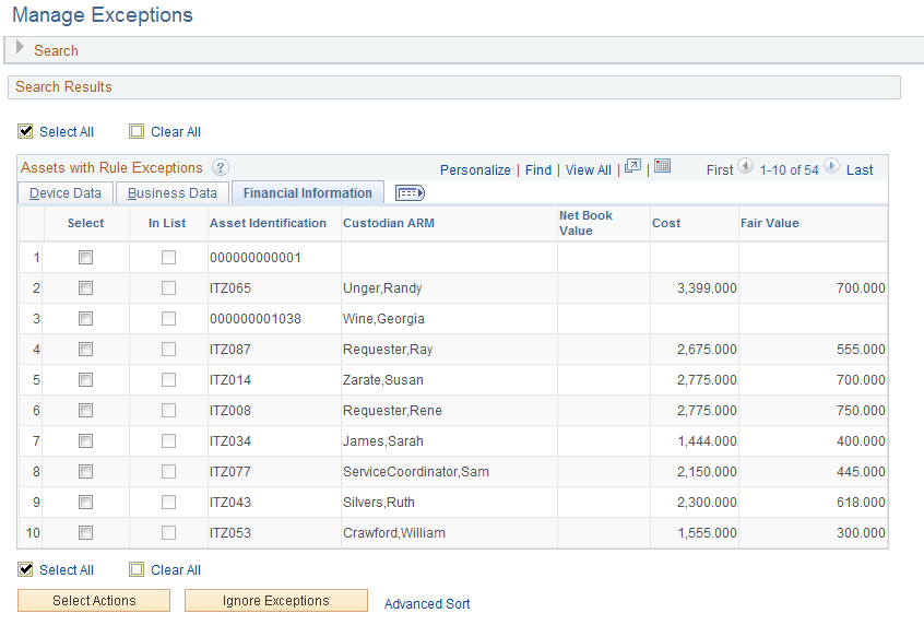

Financial Information Tab
Select the Financial Information tab.
This example illustrates the fields and controls on the Assets with Rule Exceptions page - Financial Information tab. You can find definitions for the fields and controls later on this page.
Assets with Rule Exceptions page - Financial Information tab 2 of 2

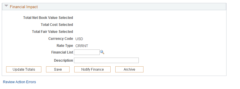

The Financial Information tab is displayed when the Financial Impact check box is selected in Installation Options and one or more of the financial search criteria are selected.
In List
This check box indicates that this asset has been saved to any financial impact list
Select
This check box indicates that the asset is a target for action on the Manage Exceptions page or for addition to a Financial List. If you click the Save button in the Financial Impact section, and this box is checked, another check will appear in the In List column beside the existing check. At this point, you can take action on the asset from either the Assets with Rule Exceptions grid or the Financial Impact section, if the Financial List is not yet saved.
Net Book Value (NBV)
Net book value is calculated by obtaining the asset cost and the associated accumulated depreciation from the current effective row of the PeopleSoft Asset Management record, PS_DEPR_RPT. The calculated NBV is original asset cost less life-to-date depreciation (COST – DEPR_LTD.)
Cost
Asset cost is derived from the PeopleSoft Asset Management record, PS_DEPR_RPT.
Fair Value
Fair value is derived from the PeopleSoft Asset Management record, PS_AM_FMV_DTL, accessing the current effective row.
Total Net Book Value Selected , Total Cost Selected and Total Fair Value Selected
Respective totals are displayed when you select one or more assets from the Assets with Rule Exceptions grid.
Currency Code and Rate Type
Values default from those values supplied within User Preferences.
See Application Fundamentals: User Preferences - IT Asset Management Page.
Save List As and Description
Supply a name and description for the newly created Financial List, which includes the selected assets and their corresponding financial information.
Update Totals
Select to calculate or recalculate the NBV, Cost and FV totals after selecting or altering the assets for inclusion in the list.
Save
Click to save the Financial List once you have provided a name and description and updated financial totals.
Notify Finance
Displays a notification page to alert the Financial Asset Manager that there is a Financial List in need of attention.
Archive
Select to archive the selected Financial List, along with Business Unit, Asset ID, and header information. You may select to archive a financial list when it becomes obsolete. The list then becomes a read-only document.

Sort Page
Use the Sort page (IT_EXCPT_SORT) to configure sort parameters to be used on the Manage Exceptions page.
Navigation:
Click the Advanced Sort link on the Manage Exceptions page.
This example illustrates the fields and controls on the Sort page.
Sort page
The system displays the fields that are available for sorting. The sort order is returned to the exceptions page and the values are sorted.
Use the Manage Exceptions Over Time page (IT_CHART) to view a graphical representation of the number of business rule exceptions over time.
Navigation:
IT Asset Management, Manage Exception Trend Chart, Manage Exceptions Over Time
This example illustrates the fields and controls on the Manage Exceptions Over Time page. You can find definitions for the fields and controls later on this page.
The Manage Exceptions Over Time page provides the ability to graph Manage Exceptions trends over a rolling twelve-month period. As you resolve the Business Rule exceptions from the Manage Exceptions page, the number of exceptions are recorded for each Business Rule where Trend Analysis is enabled.
If the Metrics process is run multiple times during a day, exception counts for that day are recorded from the latest run. They are counted every time and the most recent counts are recorded. Average exception counts for a month and a quarter are calculated only once (when the Metrics process is run for the first time after end of the month or the end of the quarter). Once the counts for a month and a quarter are calculated, they are never calculated again.
Chart Type
Select either 2D Bar or 2D Line to view trend data as either a two dimensional bar graph or two dimensional line graph. The default value is 2D Bar.
Period
Select to present totals as Daily, Monthly, or Quarterly trends for business rule exceptions (for those business rules enabled for trend analysis). The default value is Quarterly.
Time Span
Select the period over which to graph trend data:
  • 7 days
  • 30 days
  • 90 days
  • 180 days
  • 365 days (default value)
Note: Variances from the same period in the prior year appear when placing the cursor on a data point, if applicable.
DrawChart
Click to plot the data points based upon the criteria selections that are made for chart type, period and time span.
If you want to exclude certain trend data, you can archive the data.
