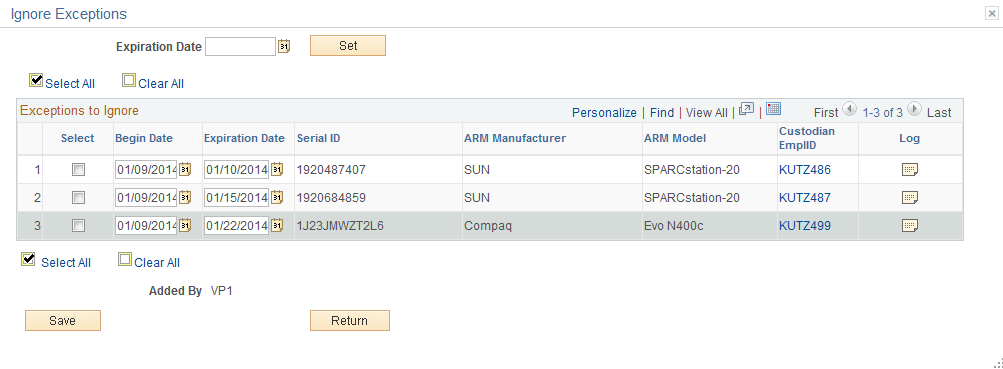

Ignore Exceptions page
When the Ignore Exceptions page is launched from Manage Exceptions, the page displays the selected asset or assets and associated rules for the exception. You can choose which asset/rule combinations to ignore. When the Ignore Exceptions page is launched from Assets Not Reporting, the page displays the selected assets.
WARNING:
You should not select to ignore software exceptions. If the software exceptions are ignored, it could present you with a lower count of the licenses that you have distributed, thereby subjecting you to potential license compliance issues.
Field or Control Description
Expiration Date and Set button
Enter the date with which you want to populate the Expiration Date for the selected assets or rules and click the Set button;
Select
Select the check box for the asset or asset/rule combinations that you want to add to the ignore list or that you want to set the Expiration Date.
Begin Date
Enter the date that you want the selected exceptions to be added to the ignore list. The default value is the current date. If you blank out the begin date, the system will still populate the begin date with today.
Expiration Date (row level)
Enter the date that you want the selected exceptions to be removed from the ignore list. The ignored exceptions are then returned to the regular presentation of exceptions for processing on the expiration date.
Custodian EmplID
Click this link to access the Custodian Information page for custodian details.
Log
Click the Log icon to access the Asset Comment page. Include any relevant comments, such as the reason this exception is added to the ignore list. Comments that are saved using this page can be viewed from the View Asset Log page (IT Asset Management, Asset Discovery and Validation, View Asset Log.)
See Working with the Asset Log.

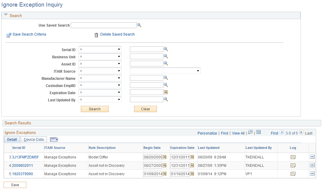

Search for ignored exceptions by entering search criteria or leave the criteria blank to retrieve all of the exceptions that are on the ignore list.
This example illustrates the fields and controls on the Ignore Exception Inquiry - Detail page. You can find definitions for the fields and controls later on this page.
Search
Click to access the Ignored Exceptions - Detail based on the search criteria you enter on the Ignore Exceptions Inquiry.
Serial ID
Click to access the Printable View of Asset page.
ITAM Source
Displays the source component where the exception occurred and was added to the ignore list: from Manage Exceptions or from Assets Not Reporting.
Rule Description
Displays the rule that was ignored. This appears from Manage Exceptions only and is blank for Assets Not Reporting.
Begin Date and Expiration Date
Modify the begin date and expiration date for the ignored exceptions.
Log
Click the Log icon to access the Asset Comment page. Include any relevant comments, such as the reason for modification of this exception. Comments that are saved using this page can be viewed from the View Asset Log page (IT Asset Management, Asset Discovery and Validation, View Asset Log.)

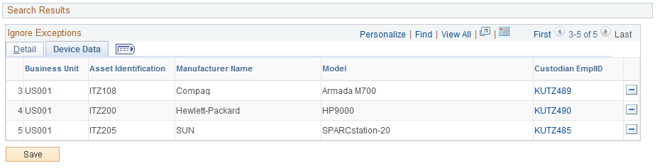

Ignored Exceptions - Device Data
View device details for ignored exceptions: business unit, asset ID, manufacturer name, device model and custodian employee ID. Click the Custodian Empl ID link to access custodian detail.
This example illustrates the fields and controls on the Ignore Exceptions Inquiry - Device Data page.
