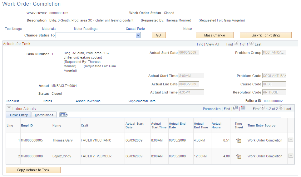

Work Order Completion Page
Use the Work Order Completion page (WM_WO_ACT) to enter data to complete a work order.
Navigation:
Maintenance Management, and then Work Order Management, and then Work Order Completion
This example illustrates the fields and controls on the Work Order Completion Component. You can find definitions for the fields and controls later on this page.

Tool Usage
Click this link to access the Tool Usage page, where you enter actual tool usage for this work order task.
See Tool Usage Page.
Materials
Click this link to access the Materials page, where you enter actual quantities of items used. You can also click the Issue link to issue additional materials to the work order or to enter returned items.
See Materials Page.
Meter Readings
Click this link to access the Meter Readings page, where you enter the current meter readings for the asset.
See Meter Readings Page.
Causal Parts
Click this link to access the Causal Parts page, where you enter any assets or asset components that caused the task problem.
See Causal Parts Page.
Mobile Updates Pending
This link is appears on the page if a task or any task-level data such as Materials, Checklists, and more have been sent to a mobile device from Maintenance Management and an update to that data has not been received from the mobile device since the last date and time that the previous update was sent. In this case, the task is considered to have an update pending.
Change Status To
Select the status to which you want to change the status for all of the work order's tasks. Only authorized users can change the status to Complete or Closed. The status rules for the work order apply to this component.
Go
Click this button to access the Change Status page where you can select a status for one or more work order tasks associated with this work order. You can also select the Notify Scheduler check box and add a note concerning the reason for the status change. An email is sent to the scheduler of the work order task.
Mass Change
Click this button to access the Mass Change page, where you can update the actual start dates and times, the PCR values, or both for all of the work order tasks.
You select the Update Actuals Dates/Time check box and enter dates and times in these fields:
  • Actual Start Date
  • Actual Start Time
  • Actual End Date
  • Actual End Time
You can select Apply to Labor Actuals check box to allow the entered actuals to be copied not just to the task actuals but also down to the next level of the labor actuals. If the fields are editable, the mass change actuals will be copied into the fields, regardless of whether data was already entered.
You select the Update P-C-R Codes check box and enter the PCR codes in these fields:
  • Problem Group
  • Problem Code
  • Cause Code
  • Resolution Code
Submit For Posting
Click this button to submit the time entries for posting in PeopleSoft Expenses. Only users who have the Allow Submit Time for Posting check box selected on the User Preferences - Maintenance Management page can access this button.
Note: Once you submit the time sheet directly to the staging tables for Project Costing from the Work Order Completion component, you cannot modify the data posted. If you need to adjust the data, then you must enter a new line of labor data with the corresponding positive or negative adjustment.
When a task is set to complete status and the complete actuals for any labor lines have been entered but have not been submitted for posting, the user will receive a reminder message when returning from the Task Status Change page on whether they would like to submit those actuals to Project Costing for posting.
See Expediting Work Order Completion.
Checklist
Click this link to access the Checklist page, where you select completed tasks.
See Procedures.
Notes
Click this link to access the Work Order Task Notes page, where you can review existing task notes and add new notes.
See Procedures Page.
Asset Downtime
Click this link to access the Downtime Entry page, where you can enter the planned and actual downtime of the asset. You can also click a link to access the Asset History page from this page.
See Asset Downtime.
Actual Start Date, Actual Start Time, Actual End Date, and Actual End Time
Enter the actual start and end dates and times for the work order task.
Problem Group, Problem Code, Cause Code, and Resolution Code
Select a problem group and PCR codes for this work order task, if applicable.
Failure ID
Click this link to access the Work Order Failure Tracking page and add or review the details of a failure event associated with an asset selected for the work order or a work order task. This information is used by the PeopleSoft Maintenance Management Failure Analysis component to enable you to perform a meaningful analysis of system-calculated metrics-based on the tracking of failure events associated with a work order task.
See Work Order Failure Tracking Page.
Inspection ID
Click this link to access the inspection instance created for the work order task. You can review or complete an inspection instance before setting the parent task’s status to Completed. You cannot set the parent task’s status to Completed until you complete the associated inspection tasks.
Copy Actuals to Task
Click this button to copy the appropriate labor actuals to the task actuals (if task actuals are enterable). For all the labor actuals entered for a given task, the earliest labor actuals are copied as the task start actuals and the latest labor actuals are copied as the task end actuals.
Labor Actuals Time Entry and Distribution
Select the Labor Actuals Time Entry tab on the Work Order Completion page.
