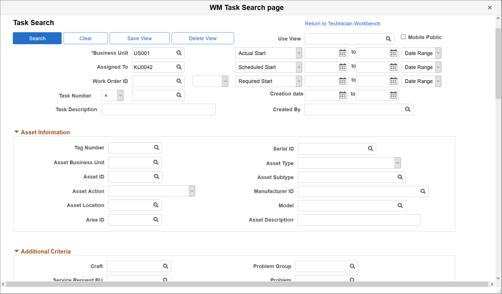

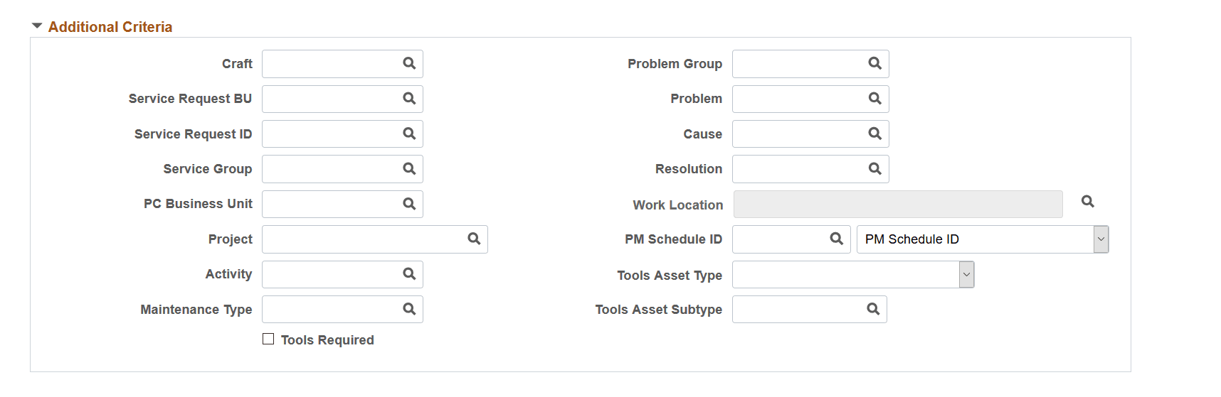

Technician Workbench - Task Search Page
WM_TSK_SRCH_SEC
Perform ad-hoc views (searches), and save and delete views.

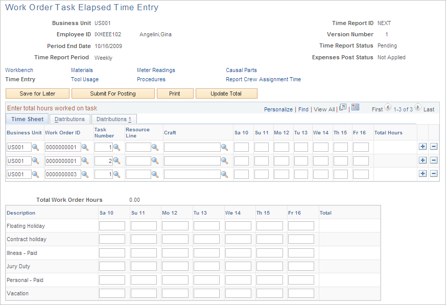

Work Order Task Elapsed Time Entry Page
WM_ETIME_ENTRY
Enter elapsed time entries for this work order task.

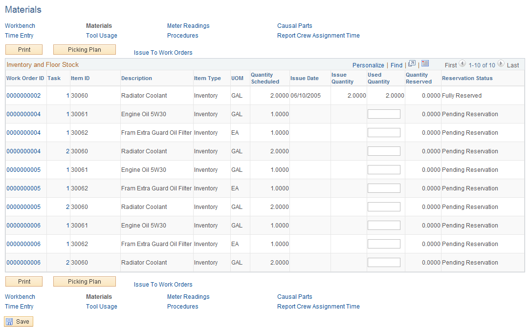

Materials Page
WM_WOE_MTLS
Review inventory and floor stock scheduled for the task, issue the selected materials to the work order, generate a pick plan, and directly access the Schedules page of a selected work order task.

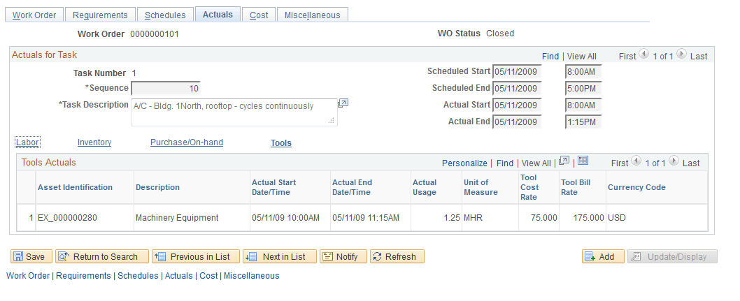

Work Order Task Tools Usage Entry
WM_TLS_USAGE
Enter the dates and times a tool was used and the quantity used for a work order task.

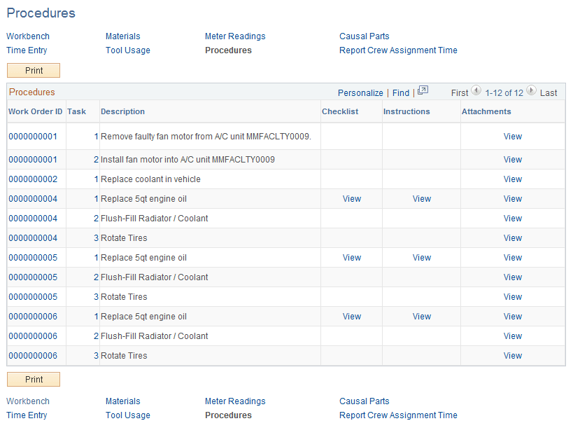

Procedures Page
WM_WOE_LIST
Review the work order checklist, instructions, and attachments associated with a task.

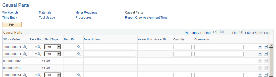

Causal Parts Page
WM_WOE_CAUSAL_PART
Enter one or more parts responsible for causing the failure or the need for the task.

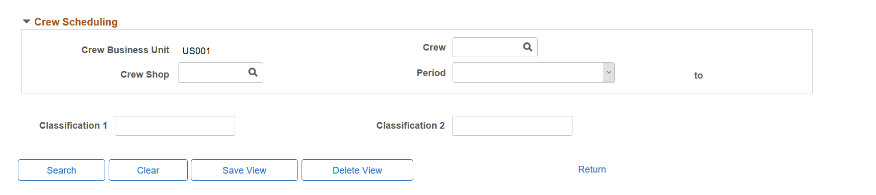

Report Crew Assignment Time Page
WM_CS_RPRTHRS_WB
Enter carryover hours, completed hours, and the completed date for a crew assigned to a task.

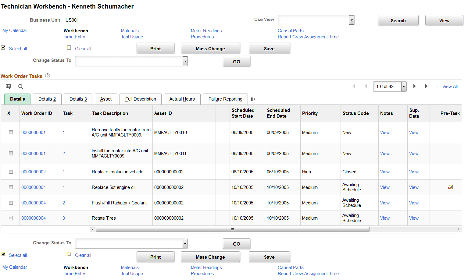

Technician Workbench Page
Use the Technician Workbench page (WM_WOE_WB) to select, search, update, and print work order tasks.
Navigation:
Maintenance Management, and then Workbenches, and then Technician Workbench
This example illustrates the fields and controls on the Technician Workbench. You can find definitions for the fields and controls later on this page.
Field or Control Description
You have "n" Service Request(s)
Click this link to access the Service Request Inbox page, which lists the service requests assigned to this technician. This list includes service requests associated with a work order and service requests in which the agent assigned the task to a technician without creating a work order.
Note: This field only appears on the Technician Workbench page if one or more work orders is associated with a service request.
Use View and View
Click the View button to access the Task Search page, where you enter and select criteria to narrow your task search.
Note: When you select the Actual Start date and the Scheduled Start or Scheduled End date on the Task Search page associated with the Technician Workbench, the system searches against the actual start date for a labor task line and the scheduled start or end date for a labor task line. When you select these dates on the Work Order Workbench Task Search page or the Work Progress Tracking Task Search page, the system searches against the actual start date for the work order task and the scheduled start or end date of the work order task.
See Work Order Workbench - Task Search Page.

Time Entry
Click this link to access either the Work Order Task Punch Time Entry page or the Work Order Task Elapsed Time Entry page to enter work order and personal (non-work order) time for a selected task.
Note: You must add all of the general ledger business units that are assigned to employees in the on the Organizational Data page (Travel and Expenses, Update Profile) and the Employee Job page (Maintenance Management, Labor Administration, Manage Employee Data) to the Project Costing Integration template that is associated with the project that was used to create the work order. You must also use the business unit assigned to each employee to set up the Expenses business unit on the Expenses Definition page (Set Up Financials/Supply Chain, Business Unit, Expenses Definition).
See Labor and Personal (Non-Work Order) Time Entry.
Materials
Click this link to access the Materials page.
See Materials Management.

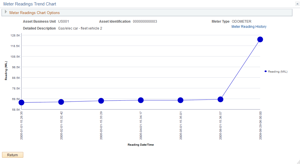

Meter Readings
Click this link to access the Meter Readings page.
See Meter Readings.
Procedures
Click this link to access the Procedures page.
See Procedures.
Causal Parts
Click this link to access the Causal Parts page.
See Causal Parts.

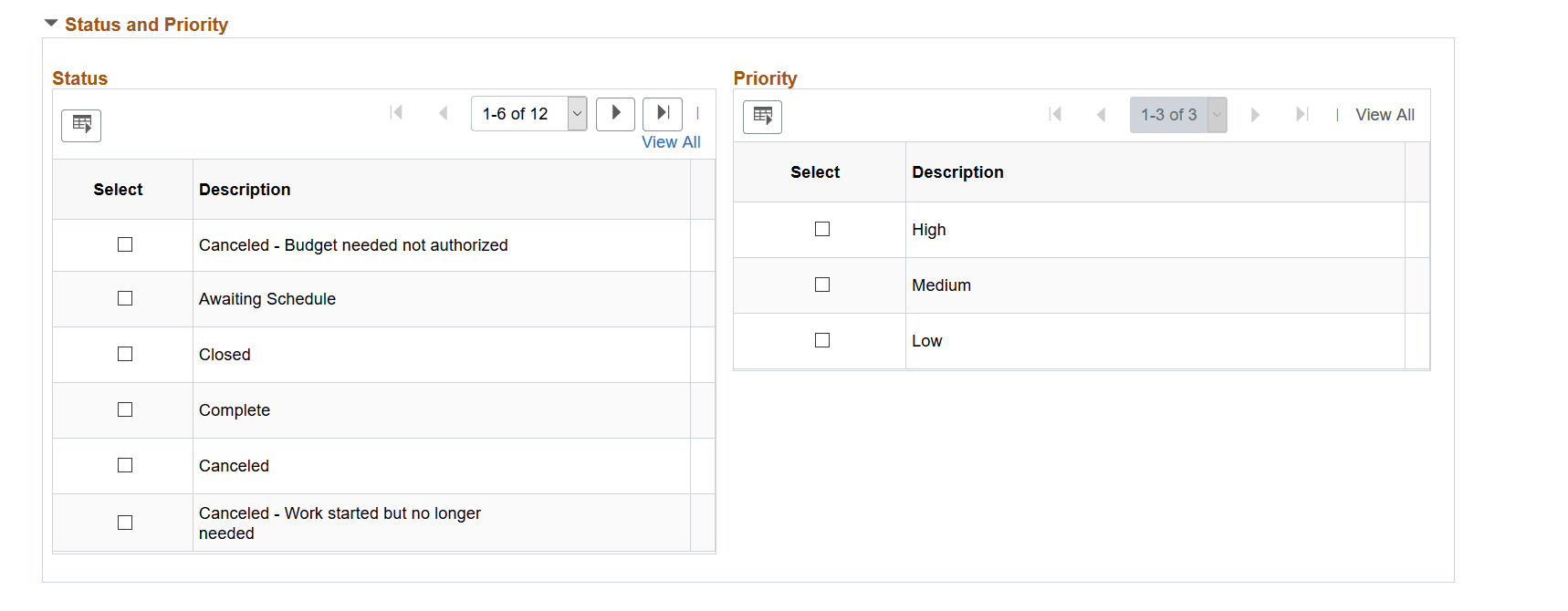

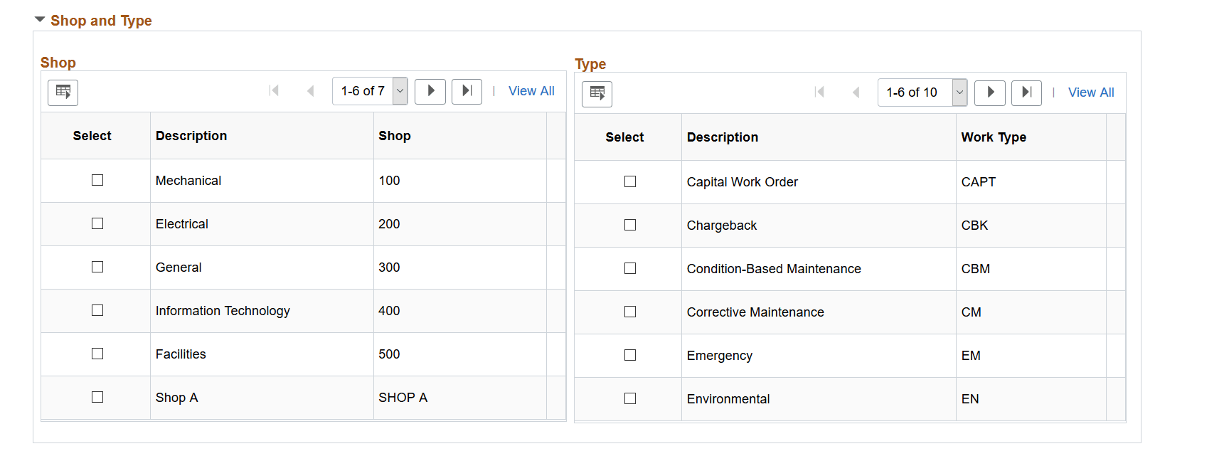

Use the Technician Workbench - Task Search page (WM_TSK_SRCH_SEC) to perform ad-hoc views (searches), and save and delete views.
Navigation:
Click the Search button on the Technician Workbench page.
This example illustrates the fields and controls on the Technician Workbench - Task Search page. You can find definitions for the fields and controls later on this page.
Technician Workbench - Task Search page (1 of 5)
This example illustrates the fields and controls on the Task Search page. You can find definitions for the fields and controls later on this page.
Technician Workbench - Task Search page (2 of 5)
Technician Workbench - Task Search page (3 of 5)
Technician Workbench - Task Search page (4 of 5)
Technician Workbench - Task Search page (5 of 5)
When you click the Save View button, you save the named view for later use. To search for a saved view, select the view name in the Use View field and click the Search button. The resulting tasks will appear in the Work Order Tasks grid. Alternatively, to perform an ad hoc search, enter any search criteria in the Task Search page without saving the view and click the Search button.
Search
Click this button to search for work orders or work order tasks based on the search criteria that you enter on the page. You can select search criteria without saving the view or select search criteria and use Save View button to save that criteria and reuse it.
Clear
Click this button to clear any existing search criteria from the page. You can select new search criteria and click the Save View button to reuse this new search criteria.
Save View
Select search criteria and click this button to name and save the view for reuse.
Delete View
Click this button to delete the current saved view.
Use View
Search for a saved view and click the Search button to search for work orders and work order tasks that fall within the search criteria for that view.
Mobile Public
Select this option to make the saved view available to all Technicians using Mobile devices. If this option is selected the Assigned To field is replaced with an Assigned To Current Technician check box. If this check box is also selected, then the Mobile Public view will only return tasks that are assigned as a scheduled labor resource to the technician who is executing the Search View.
Note: This only applies to technicians who work for organizations that have integrated a third-party mobile device with PeopleSoft Maintenance Management Web Services.
You can include any of the remaining fields on the Task Search page as search criteria to narrow your search for work order tasks.
Business Unit is not required for searches.
Use the Work Order Task Elapsed Time Entry page (WM_ETIME_ENTRY) to enter elapsed time entries for this work order task.
Navigation:
Click the Time Entry link on the Technician Workbench page.
This example illustrates the fields and controls on the Work Order Task Punch Time Entry page. You can find definitions for the fields and controls later on this page.
The fields in the header and the buttons on this page work the same way that they do in the Work Order Task Punch Time Entry page.
Time Sheet
Select the Time Sheet tab to enter elapsed time for work order tasks on which this employee worked. In elapsed time entry, you enter the hours worked on specific days of the week based on the Period End Date and Time Report Period.
  • If Time Report Period is Daily, then a single day appears in the Work Order Task Elapsed Time Entry, Time Sheet grid.
  • If Time Report Period is Weekly, then the days of the week appear in the Work Order Task Elapsed Time Entry, Time Sheet grid.
  • If Time Report Period is Biweekly, use the Previous Week and Next Weekbuttons to transfer to the previous week or next week for the week not currently shown.
  • If Time Report Period is Semimonthly, the time entry is the same as for the biweekly page.
    However, you can click the Next button twice from the first week and arrive at the last week, which may have just one day available for time entry, depending on the month.
Distributions
Select the Distributions tab, which displays the ChartField distributions that are associated with the resource line. If this a new resource line (actuals entries only), then the distributions are derived form a distribution template. You can override these values, if necessary.

Materials Page
Use the Materials page (WM_WOE_MTLS) to review inventory and floor stock scheduled for the task, issue the selected materials to the work order, generate a pick plan, and directly access the Schedules page of a selected work order task.
Navigation:
Click the Materials link on the Technician Workbench page.
This example illustrates the fields and controls on the Materials page. You can find definitions for the fields and controls later on this page.
Materials page
Print
Click this button to print reports from the Work Order Task Report Options page.
Picking Plan
Click this button to generate a picking plan for selected materials for PeopleSoft Inventory based on the predefined Picking Plan run control in user preferences.
Issue To Work Orders
Click this link to access the Issue to Work Order Search page, where you enter details to issue the item to the work order task. Once the item is issued, the Issue Date and Issue Quantity fields appear in the Inventory and Floor Stock grid.
This grid displays each inventory item or floor stock item that was entered for the selected work order tasks.
Used Quantity
Enter the quantity of this item that was used.
Delivery Truck icon and Delivery Instructions
Displays delivery instructions informing PeopleSoft Inventory which materials to deliver and where to deliver them. Delivery instructions, along with the Delivered Y/N flag (appears as a delivery truck icon) for materials, are updated by the planner or scheduler to indicate where materials need to be delivered. These instructions might also include special handling instructions (such as a fork lift is needed). The Delivered Y/N flag indicates which materials are typically delivered to the work location. You can indicate how you want the materials delivered in the Inventory Schedules grid and the Purchase/On-Hand Schedules grid of the work order task.
Purchase Order and On Hand Materials
This grid appears on the Materials page of the Technician Workbench if you selected any materials that need purchasing or are on hand for a work order task. The grid displays the Resource Type, UOM (unit of measure) and Quantity Required for the task and the Due Date or date the materials are needed.
Used Quantity
Enter the quantity that was used for the task. If the UOM for the selected item is EA (each), you will receive an error if you enter a partial quantity (quantity value with a decimal) in this field. This field is informational only. However, a query was established for this field, which enables your organization to add it to your customized reports.
This grid also defines the staging status of the requisition or the purchase order that may have been created for materials selected for a task, and indicates if the material is on hand.
Tool Usage Page
Use the Work Order Task Tools Usage Entry page (WM_TLS_USAGE) to enter the dates and times a tool was used and the quantity used for a work order task.
Navigation:
Click the Tool Usage link on the Technician Workbench page.
This example illustrates the fields and controls on the Tool Usage page. You can find definitions for the fields and controls later on this page.
Tool Usage page
Asset ID
Select or override the asset ID (Serial ID, VIN, or Asset Tag Number) for the tool. A default value appears if a value was selected in the Tool Schedules grid of the work order task. A description of the tool also appears. The selected asset must be flagged as a tool.
Note: For unplanned tool usage (tool requirements were not defined or scheduled), when you select this value, default values are applied to the Asset Type, Subtype, Manufacturer ID, and Model fields, if applicable. These fields are not visible from the Technician Workbench page.
Quantity Used
Enter the quantity used. For example, if the cost to use a truck is 10 cents per mile and the truck traveled 20 miles during the task, then the quantity used is the total number of miles (20) that the truck traveled for the task. This quantity is multiplied times 10 cents per mile to arrive at the total cost of the tool usage: 2.00 USD.
Actual Start Date, Start Time, Actual End Date, and End Date
Enter the actual start and end dates and times in which the tool was used for a work order task.
Actual Duration
Displays the actual duration of the task based on the actual start dates and time values converted to hours divided by the Quantity Used value. This calculation depends on the unit of measure (UOM) that applies to the tool.
Tools Cost
Select the Tools Cost grid on the Tool Usage page.
Tool Cost Rate and Tool
Override the default Tool Cost Rate and Tool Bill Rate values, as necessary. The default value is derived from the values entered on the Tool Rates page of the shop.
Transaction Date
Override the default system date, as necessary.
Distribution
Click this link to access the ChartField distribution page for tools to be processed in PeopleSoft Project Costing.

Meter Readings Trend Chart
Navigation:
Click the Chart icon on the Meter Readings page
This example illustrates the fields and controls on the Meter Reading Trend Chart page. You can find definitions for the fields and controls later on this page.

This chart compares the meter readings that were read on the odometer of this vehicle every 200 miles, and each date and time the meter readings were taken.
Procedures Page
Use the Procedures page (WM_WOE_LIST) to review the work order checklist, instructions, and attachments associated with a task.
Navigation:
Click the Procedures link on the Technician Workbench page.
This example illustrates the fields and controls on the Procedures page. You can find definitions for the fields and controls later on this page.
Procedures page
Checklist, Instructions, and Attachments
Select to access the checklist, instructions, and attachments pages associated with the work order task. If the work order is associated with a service request, you can view the service request attachments. You can also access the task and add instructions or checklist items via the Work Order component. You must call up the task again to access the view links for any additional procedures that you added to the task.
Causal Parts Page
Use the Causal Parts page (WM_WOE_CAUSAL_PART) to enter one or more parts responsible for causing the failure or the need for the task.
Navigation:
Click the Causal Parts link on the Technician Workbench page.
This example illustrates the fields and controls on the Causal Parts page. You can find definitions for the fields and controls later on this page.
Causal Parts page
Part Type
Select if this causal part is either an inventory item, an asset, or a description. Values are:
  • Part
    If you select this value, then the inventory Item ID field is enabled so that you can select the item that caused the problem.
  • Asset
    If you select this value, then the Asset Unit and Asset ID fields are enabled so that you can select the asset that caused the problem.
Quantity
Enter the number of parts or assets that caused the problem.
