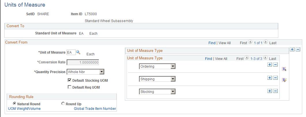

This example illustrates the fields and controls on the Units of Measure page. You can find definitions for the fields and controls later on this page.
Field or Control Description
Conversion Rate
Enter conversion rates that conform to the quantity precision rule for an item-UOM combination. For example, if an item's standard UOM is defined as a whole number, you cannot enter a conversion rate that contains a decimal value.
Quantity Precision
The rule that is to be used for this item-UOM combination.
Note: Because serial-controlled items are by definition whole numbers, they can have only whole number quantity precision.
Default Stocking UOM (default stocking unit of measure)
Select this check box to define one unit of measure as the default stocking UOM. The default stocking UOM is used as a default on the PO Receiving, Inspection, Express Putaway, Manual Staging, and RMA & InterUnit Receiving pages.
If the item is a serial controlled item, the default stocking UOM is defined as the standard UOM from the Define Item - General: Common page (Items, Define Items and Attributes, Define Item, General) and you cannot change it.
In PeopleSoft Inventory, the Default Stocking UOM can be used within the default hierarchy for:
  • The Create/Update Stock Request component if it is also defined as an ordering UOM type.
  • The Express Issue page if it is also defined as a shipping UOM type.
  • The Define Par Location - Line page and the Maintain Par Locations component if it is also defined as an ordering UOM type.
For more information on the default hierarchies, see the individual component.
Default Req UOM (default requisition unit of measure)
Select to indicate that the UOM should be displayed by default for requesters using PeopleSoft eProcurement. If not selected, the item supplier UOM (Items, Define Items and Attributes, Purchasing Attributes, Item supplier) or the standard UOM (Items, Define Items and Attributes, Define Item, General) is displayed by default for the requester.
In PeopleSoft Inventory, the Default Req UOM can be used within the default hierarchy for:
Unit of Measure Type
Indicate which transactions use the selected UOM. You must select at least one of these UOM types for each item:
Ordering: The UOM is used for stock requests. The ordering UOM is also used by PeopleSoft Order Management.
Shipping: The UOM is used for express issue and shipping/issues transactions.
Stocking: The UOM is used for any putaway or receiving transaction. This UOM can also be used for numerous other transactions, including transfers, container management, adjustments, picking, and physical accounting.
