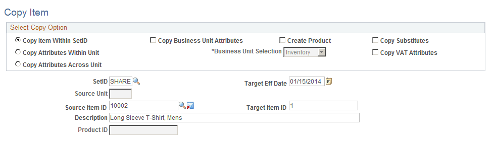

This example illustrates the fields and controls on the Copy Item page. You can find definitions for the fields and controls later on this page.
Copy Item page
Field or Control Description
Copy Item Within SetID
If you select this option, you can also copy the purchasing and inventory business unit attributes that are established for the item by selecting the Copy Business Unit Attributes option.
The Inventory Business Units and the Purchasing Business Units group boxes at the bottom of the page display the business units that have established the item ID. By default, all business units are selected. Clear those business units with attributes that you do not want to copy to the target item. When you are copying from inventory business units, planning attributes at the business unit level are copied along with weight and volume attributes and configuration attributes. Values that are calculated through the replenishment process are not copied. However, other replenishment attributes (set up attributes, for example) are copied.
When you are copying items within the same business unit, the VMI customer ship to attributes are copied. If the business unit that is being copied to is a VMI business unit, only inventory items can be copied.
Note: If you copy items between business units with different currencies, you must change all cost and price fields for the item manually.
Source Item ID
If the item that is being copied still has a status of Under Initialization, then the target item is also placed in Under Initialization status. If the item that is being copied has a status of Approved, Hold, Discontinue, or Inactive, and item approval is not required, then the item is placed in Active status. If item approval is required, the item is placed in Under Initialization status.
