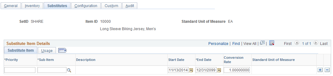

This example illustrates the fields and controls on the Define Items - Substitute page. You can find definitions for the fields and controls later on this page.
Substitute Item
Field or Control Description
Priority
The substitute item with the highest priority (the lowest number) is substituted first. Priority doesn't need to be sequential, though it must be greater than zero. PeopleSoft applications display, print, and suggest substitute options in priority order.
Start Date, and End Date
Determines the date range for substitution validity. The current date appears by default as the start date, and December 31, 2099 appears as the default end date. You can change both dates.
Conversion Rate
Indicates the quantity of the substitute item that is required to replace the original item. The default value is 1, but you can modify the value as necessary. Conversion rates are calculated by using the standard UOM.
Copy to Business Unit
After you finish defining substitution options for the item, click this link to access the Copy SetID to BU Substitute Items page, where you can copy the SetID's substitution definition to selected business units.

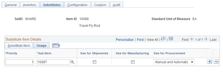

This example illustrates the fields and controls on the Define Item — Usage Page. You can find definitions for the fields and controls later on this page.
Define Item- Usage Page
Use for Shipments
Indicates whether the substitute item is valid for material stock requests and sales orders during the picking process.
Use for Manufacturing
Indicates whether the substitute item can be used for substitutions on BOMs or production picking plans.
Use for Procurement
Defines whether the substitute item will be available for use in Procurement at the item SetID level to perform Automatic Item Substitution and/or Manual Item Substitution. You must also define the Purchasing Attributes for an item ID for the item to be used in the Purchasing, eProcurement system. Choose from these values:.
  • Automatic Substitution: This Substitute Item will be eligible for use in Procurement when performing Automatic Item Substitution
  • Do Not Use: This Substitute Item will not be eligible for use in the Procurement applications. This is the default value.
  • Manual Substitution: This Substitute Item will be eligible for use in Procurement when performing Manual Item Substitution.
  • Manual and Automatic: This Substitute Item will be eligible for use in Procurement when performing Manual and Automatic Item Substitution
