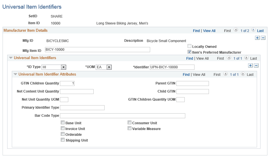

Universal Item Identifiers Page
Use the Universal Item Identifiers page (ITM_MFG_UPN) to define universal item identifiers by assigning them by item ID, manufacturer ID, and UOM.
Before you can access this page, you must select and save a preferred (default) manufacturer on the Manufacturer's Item page.
Navigation:
Items, and then Define Items and Attributes, and then Universal Item ID
This example illustrates the fields and controls on the Universal Item Identifiers page. You can find definitions for the fields and controls later on this page.
To define universal item identifiers for an item, use the Universal Item Identifier (IN_MFG_UPN_GBL) component. Use the Universal Item Identifier (IN_MFG_UPN_CI) component interface to load data into the tables for this component.
To define universal item identifiers:
  1. Select the Sel (select) check box in the row that is next to the manufacturer for which you want to assign a universal item identifier.
  2. Click the Universal Item Identifiers link.
    The PeopleSoft system displays the Universal Item Identifiers page.
  3. Select a universal item ID type and a UOM, and enter an identifier.
    The default universal item ID-type code comes from the Manufacturer page.
  4. Save the changes.
Field or Control Description
SetID
Enter an identification code that represents a set of control table information or Table Sets.
Item ID
Enter an identification code for the associated item.
Mfg ID
Enter the Manufacturer ID.
Description
Enter the name of the Manufacturer.
Mfg Item ID
Enter the Manufacturer Item ID.
Locally Owned
Select to indicate that the manufacturer is locally owned.
Note: More than one manufacturer ID can be locally owned.
Item’s Preferred Manufacturer
Select to indicate the preferred manufacturer of the item.
Item Identifier Type
Select the universal item ID type of the manufacturer.
Unit of Measure
Select the appropriate UOM of the Manufacturer .
Identifier
Enter the unique GTIN ID for the particular Item Identifier and Unit Of Measure combination of the appropriate Manufacturer and Manufacturer Item ID.
GTIN Children Quantity
Enter the count of the child GTINs contained in this item.
Parent GTIN
Enter the GTIN of the trade item for the product packaging level immediately above this item.
Net Content Unit Quantity
Enter the amount of the trade items contained in a package and usually claimed on the label.
Child GTIN
Enter the GTIN of the trade item for the product packaging level immediately below this item.
Net Unit Quantity UOM
Enter the unit of measure for net content.
GTIN Children Quantity UOM
Enter the unit of measure of the quantity of children.
Primary Identifier Type
Enter the classification identifier used for the unique identifier nomenclature. The code will usually be GTIN.
Bar Code Type
Indicate if the trade item is physically bar-coded with the primary trade item identification number.
Base Unit
Select to indicate if the associated GTIN is the lowest level of an item's hierarchy.
Note: If yes, this GTIN cannot have any children and means there are no other products within and is the lowest package unit.
Consumer Unit
Select to indicate that this trade item will be scanned at point of use.
Invoice Unit
Select to identify that the information provider will include this trade item on their billing or invoice.
Variable Measure
Select indicate that an article is not a fixed quantity, but is variable.
Note: A quantity can be the weight, length or volume. A trade item is used or traded in continuous rather than discrete quantities.
Orderable
Select to indicate that this GTIN can be ordered.
Shipping Unit
Select to identify that the information provider considers the trade item as a dispatch (shipping) unit.
