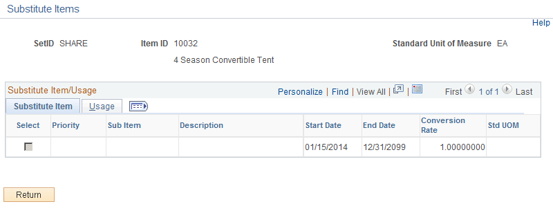

Substitute Items (SetID level) Page
Use the Substitute Items (SetID level) page (INV_SUB_ITEM_SEC) to view an item's substitution definition at the SetID level and, if appropriate, select an alternate item.
Navigation:
Enter an item ID on the Availability Inquiry Selection page Inventory, and then Manage Inventory, and then Review Inventory Balance Info, and then Item or Product Availability and click the Item Search/Item Links button next to the Item ID field. Then click the Substitute Items link.
This example illustrates the fields and controls on the Substitute Items page (SetID). You can find definitions for the fields and controls later on this page.
The Substitute Items page shares the same object name as the Copy Set ID Substitute Items page.
Click the Return button to close the page without selecting a substitution.
Select the check box on the row of a substitute item if you want to populate the Item ID field on the previous page with the substitute item's item ID.
Field or Control Description
Conversion Rate
Specifies the factor to convert the transaction quantity to the items standard UOM.
The conversion rate can be different at the SetID, business unit, and BOM levels.
Use for Shipments
Indicates whether the substitute item is valid for picking for sales orders and material stock requests.
Use for Manufacturing
Indicates whether the substitute item can be used for substitutions on BOMs or production picking plans.
Use for Procurement
Indicates whether the substitute item can be used for substitutions during online sourcing in PeopleSoft Purchasing. This value is not copied to the business unit because PeopleSoft Purchasing uses only the substitution definition from the SetID level.

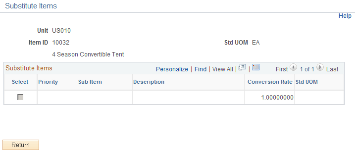

Substitute Items (business unit level) Page
Use the Substitute Items (business unit level) page (INV_BU_SUB_ITM_SEC) to view an item's substitution definition at the business unit level, and if appropriate, select an alternate item.
Navigation:
Enter an item ID on the pages in the Material Stock Request component or the Express Issue page, and click the Transfer button next to the Item ID field. On the Transfer page, click the Substitute Items link.
This example illustrates the fields and controls on the Substitute Items page (business unit). You can find definitions for the fields and controls later on this page.
The Substitute Items link is not available for a supplier return-request type on the Express Issue page. Substitutions are not permitted for supplier returns.
For each substitution option, the system displays this information:
Conversion Rate
Specifies the factor to convert the transaction quantity to the item's standard UOM.
