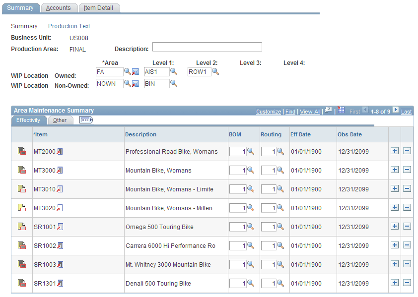

Production Area: Summary Page
Use the Summary - Summary page (SF_PRDN_AREA_SUM) to define and maintain general information for each production area, indicate default WIP locations, and identify items to be manufactured within a production area.
Navigation:
Production Control, and then Define Production, and then Production IDs/Schedules, and then Define a Production Area
This example illustrates the fields and controls on the Summary - Summary page: Effectivity tab. You can find definitions for the fields and controls later on this page.
Field or Control Description
WIP Location Owned and Non-Owned
Enter values for the production area. If you are producing items that include non-owned components, for example, you are the subcontractor and the customer is supplying the components, define a non-owned WIP location in addition to the owned WIP location. Additionally, if you receive items that are consigned to you by the suppliers, they must be stocked in a non-owned location until they are consumed in production.
Note: All consigned items are set up as non-owned. However, consigned manufactured items must be moved to owned WIP locations during the completions process.
If you are exclusively using owned components in the WIP location, you do not need to identify a non-owned WIP location. Owned inventory can only be issued from and received into an owned inventory location. Likewise, non-owned inventory can only be issued from and received into a non-owned inventory location.
Note: The transfer of consigned inventory from a non-owned location to an owned location results in the recognition of the payment liability.
The owned and non-owned WIP locations for a production area indicate the locations where material should be issued or consumed, if the component's issue method is set to Issue or Replenish and any of these conditions exist:
  • No routing exists for the item.
  • An invalid WIP location is associated with any work center on the item's routing.
  • The operation sequence on any of the item's components is zero or nonexistent.
Storage Area
The system displays the number of storage levels in the Area, Level 1, Level 2, Level 3, and Level 4 fields that have been defined for each storage area.
Effectivity Tab
Item
Select an item. You can associate one or more items with each production area. You can specify any approved item, except floor stock, planning, and expensed items.
Note: When adding an end item with an item status of Hold or Discontinue, you receive a warning message.
Detail Button(detail button)
Click the Detail button to access the Item Detail page.

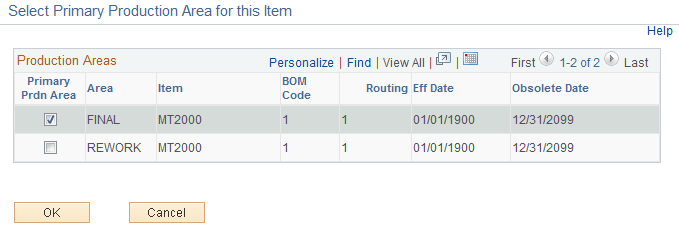

Select Primary Production Area for this Item Page
Use the Select Primary Production Area for this Item page (SF_PRDNAREA_SEL_SP) to select the default location where the production item will typically be manufactured.
Navigation:
Click the Item Search button and click the Primary Production Area link.
This example illustrates the fields and controls on the Select Primary Production Area for this Item page. You can find definitions for the fields and controls later on this page.
The primary production option identifies the primary production area for a specific BOM and routing code combination. This occurs because PeopleSoft Supply Planning enables you to plan for multiple BOM and routing code combinations. This primary production area option enables PeopleSoft Supply Planning to determine the production area that the production ID or production schedule to be manufactured.
This example illustrates how this works:
Production Area BOM Code Routing Code Primary Production Area?
AREA1
1
1
Yes
AREA2
1
1
No
AREA3
2
2
Yes
AREA4
2
2
No
Using this example, if PeopleSoft Supply Planning generates one supply record (such as a production ID) with a BOM and Routing code equal to 1 and one with a BOM and routing code equal to 2, then the system would use AREA1 for the first supply record and AREA2 for the second supply record.
Because primary production areas are defined at the BOM and routing combination level and these combinations can be effective-dated, the production area is the primary production area only for the dates specified on the combination.
Primary Prdn Area (primary production area)
If you enter the page and the correct primary production area is selected, then click the Cancel button to return to the Area Maintenance - Summary page.
To change the primary production area, select the check box next to the production area that you want to designate as the primary location where this item is manufactured. When you click OK, the system accepts your changes.

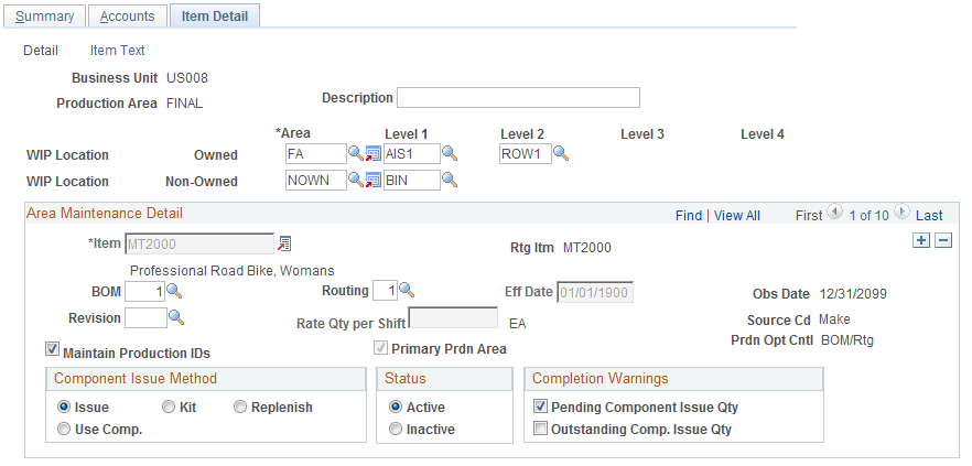

Production Area: Item Detail Page
Use theProduction Area: Item Detail page (SF_PRDN_AREA_ITEM) to define production details for each item associated with a production area.
Navigation:
Production Control, and then Define Production, and then Production IDs/Schedules, and then Define a Production Area, and then Item Detail
This example illustrates the fields and controls on the Production Area: Item Detail page. You can find definitions for the fields and controls later on this page.
Item Detail - Detail page
Owned and Non-Owned WIP Locations
You can change the values for these fields.
Area Maintenance Detail
Item
Appears for each production ID or production schedule. The item cannot be changed or deleted once a production ID or production schedule has been created for the item.
Rtg Itm (routing item)
Displays the routing used to manufacture this item. The end item may have its own routing or reference another item's routing for its manufacturing methods. The referenced routing can be assigned directly to the end item, its item group, or its item family.
BOM and Routing codes
Revision
(Optional) Select a revision to use for this item.
Rate Qty per Shift (production rate quantity per shift)
Whether you can enter a whole number or a decimal in this field depends on the item's unit of measure and quantity precision combination defined in PeopleSoft Inventory.
Source Cd (source code)
Displays the value for the assembly item. Only items with a source code of Make or Buy can be assigned to a production area.
Prdn Opt Cntl (production option control)
Displays the value that indicates whether the item has been defined as using production options with the Item Attributes by Unit - Manufacturing page.
Maintain Production IDs
Deselect this check box if there is no existing production for this item and if you want to change from maintaining production IDs to maintaining production schedules.
The check box is selected and unavailable if this is the item's primary production area. Select the primary production area on the Primary Production Area page accessed through the Area Maintenance - Summary page.
Component Issue Method
Indicates how the end item's components are issued for production.
See Selecting the Component Issue Method for Each Item.
Note: The component issue method can be different in each production area for the same item.
Status
Select Active or Inactive. If you select Inactive, then new production IDs or production schedules cannot be defined for the production area or item. However, you can maintain any production that you've previously defined, and track any existing production in process until it's completed and closed.
Completion Warnings
Select a value to indicate the situations in which warnings should be sent during the completions process:
  • Pending Component Issue Qty: Select this check box to send warnings if there are pending component issue quantities during a backflush. Pending quantities can be caused to incomplete lot IDs, negative quantities when the business unit does not allow negative quantities, or other causes.
