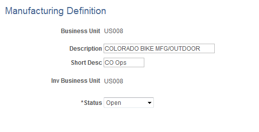

Business Unit Definition Page
Use the Business Unit Definition page (BUS_UNIT_MFG1) to define manufacturing business units.
Navigation:
Set Up Financials/Supply Chain, and then Business Unit Related, and then Manufacturing, and then Manufacturing Definition
This example illustrates the fields and controls on the Manufacturing Definition page. You can find definitions for the fields and controls later on this page.
Important:
Manufacturing business units must be identical to PeopleSoft Inventory business units to link the manufacturing and inventory processes.
To define a manufacturing business unit:
  1. Enter values in the Description field and the Short Desc (short description) field for the manufacturing business unit.
    The Inv Business Unit (inventory business unit) field is display-only.
  2. Indicate whether the facility status is Open or Closed.
You must set the facility status to Open to manage production or add BOMs or routings.

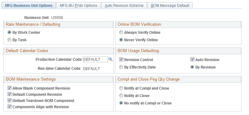

MFG Business Unit Options Page
Use the MFG Business Unit Options page (BUS_UNIT_OPT_MG) to set up manufacturing business unit options.
Navigation:
Set Up Financials/Supply Chain, and then Business Unit Related, and then Manufacturing, and then Manufacturing Options
This example illustrates the fields and controls on the Manufacturing Options - MFG Business Unit Options page. You can find definitions for the fields and controls later on this page.
Rate Maintenance/Defaulting
Use the Rate Maintenance/Defaulting group box to enter conversion rates for work centers or tasks.
If you determine that labor, machine, and overhead rates and costs are to be tracked by department or cost center, select By Work Center; all tasks assigned to the work center will use the same conversion rates and overhead rates. If you determine rates and costs are to be tracked by crew or resource, select By Task. With this option, each task can have a unique conversion and conversion overhead rate.
For example, if you select By Work Center, then you can access the conversion code fields on the work center pages but not on the task pages.
Online BOM Verification
Specify how to handle online verification for production BOMs. If you use PeopleSoft Engineering, you can also specify how to handle online verification for engineering BOMs:
Field or Control Description
Always Verify Online
Runs the process online during BOM maintenance.
Never Verify Online
Runs the verification as a deferred process.
When BOMs are complex and deep, select Never Verify Online to improve BOM maintenance performance, and run the BOM verification process from the BOM Verification page.
Default Calendar Codes
To indicate a default production calendar for the manufacturing business unit, select Production Calendar Code. You create calendar codes and their associated calendars using the Calendar Code Definition page. The first calendar code and associated calendar that you create for the business unit is the default for this field. It is treated as the primary production calendar for the business unit. If a calendar code is not associated with a work center—or if the calendar code associated with the work center is not effective yet or is obsolete—the system uses the calendar defined here to schedule production.
The Run-time Calendar Code field is display-only. It indicates which calendar code is used as the default production calendar for the business unit.
When you associate a different calendar code than the current runtime calendar code, the system optionally sends a workflow notification to selected roles that you define. This workflow notification indicates to the user (such as a production control manager) that the calendar originally used for scheduling is not in sync with the calendar code specified for the business unit.
If you do not define a calendar code and an associated calendar for the business unit—or if the production calendar associated with the business unit runs out—PeopleSoft Manufacturing uses the default five-day work week. A five-day work week is defined as Monday through Friday, with one shift. You set it up using the Work Week Definition page.
BOM Usage Defaulting
The BOM Usage Defaulting group box enables you, at the business unit level, to indicate whether you maintain BOMs:
  • In PeopleSoft Manufacturing and PeopleSoft Engineering.
  • By revisions.
  • By effectivity dates (and whether revisions can be automatically generated for revision controlled items).
Revision Control
Select to generate BOMs by revisions.
Auto Revision
Select to automatically generate revisions.
By Effectivity Date
Select to maintain BOMs by effectivity date.
By Revision
If you are maintaining BOMs by effectivity date, you can specify an effective revision that equates to an effectivity date.
While the value that you define here (at the business unit level) is the default at the item setup level, you can overwrite this at the item level.
To automatically create revisions to items, use the mass maintenance functionality in PeopleSoft Manufacturing or PeopleSoft Engineering. You can use either of these features:
  • BOM Mass Maintenance by Mass Maintenance Code (MMC)
  • BOM Mass Maintenance by Engineering Change Order (ECO)
The mass maintenance process creates revisions for those items that have both revision control and automatic revision selected. In other cases, the process functions as a regular mass maintenance process without creating automatic revisions.
Use the Auto Revision Scheme page in this component to define the scheme that the system uses to generate automatic revisions.
BOM Maintenance Settings
Allow Blank Component Revision and Default Component Revision
Select these two check boxes to define component revision default settings that affect the BOM Maintenance pages. The check boxes only apply to revision-controlled items. In addition, they operate independently of each other. Therefore, there are four possible combinations of settings.
Default Teardown BOM Component
Select to indicate business unit settings for teardown components. You can only select this check box for teardown production orders. If you select this check box, the system indicates that the components are teardown outputs on the BOM Maintenance Component Details page when you add or change components on a BOM.
Note: This check box only affects teardown components with a source code of Make or Buy.
If teardown components are selected on a BOM, the system copies the components to the output list when you create a teardown production order, based on the BOM code.
Components Align with Revision
Select to indicate that any component existing on a BOM for a revision-controlled assembly must be associated with one of the assembly revisions. This is the default setting, and it is the most common setting for revision-controlled environments. However, if the environment requires a change to the BOM structure without rolling the revision of the parent assembly, then deselect this option to enable you to do so. This can be required in outsourcing scenarios where you are the contract manufacturer and are required to adhere to customer-specified revision in manufacturing.
When this option is deselected, you can introduce a new component against the current revision of the assembly as of the current date versus the start date of the current revision for the assembly. In this scenario, the components required to build the assembly for the revision-controlled item are based on the revision specified, including any additional component changes up to the date specified when creating the component list.
Note: In addition to deselecting this option, you must also set the assembly item's business unit item-attributes manufacturing setting for BOM usage to By Effective Date so that new components for that assembly can be created for dates not associated with the assembly revision.
Compl and Close Peg Qty Change
This group box controls how often pegging notifications are sent to a user or group of users when changes are made on a production ID. PeopleSoft Manufacturing has a number of common circumstances that could cause excessive pegging notifications to be generated. For example, normal scrap activity during the completions process could result in quantity reduction notifications. Completing serial controlled items would generate a receipt notification for every serialized item. The close process generates close notifications for every order closed.
PeopleSoft Manufacturing offers three options for controlling the number of pegging notifications generated during the completions and close processes:
  • Notify at Compl and Close: Enables all normal pegging notifications including order quantity changes and closing of production.
  • Notify at Close: Enables normal notifications in the production close process and suppresses order quantity change notifications during compl
  • No Notify at Compl or Close: Suppresses close notifications during the close process and suppresses quantity change notifications during completions.

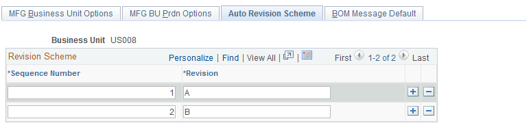

Auto Revision Scheme Page
Use the Auto Revision Scheme page (EN_REVISION_SCHEME) to define automatic revision schemes at the manufacturing business unit level.
Navigation:
Set Up Financials/Supply Chain, and then Business Unit Related, and then Manufacturing, and then Manufacturing Options, and then Revision Scheme
This example illustrates the fields and controls on the Manufacturing Options - Auto Revision Scheme page. You can find definitions for the fields and controls later on this page.
This page is primarily intended for use during implementation of the system.
Revision Scheme
You generate automatic revisions by using the mass maintenance functionality. Before creating an automatic revision, however, the system must determine which scheme or sequence of revisions to use to create the next revision. On the Revision Scheme page, you create such a revision scheme by entering sequence numbers as well as an alphanumeric order for the revisions. The system uses this scheme to automatically increment sequenced assembly revisions. Each time new revisions are automatically generated, they follow the order defined in this list of sequenced revision names. For example, if the current revision for an item is C, then the next automatic revision will be D. If the current revision doesn't exist in the scheme, then the system creates the revision with the lowest non-existing sequence number. For example, if an item currently has revisions A, B, and X, then the next revision created for the item will be C.
You can insert interim revisions into the sequence scheme if needed. For example, if the sequence is 100, 110, 120, you can add a 115 between the 110 and 120 revisions. Changing the revision scheme does not update the sequence of revisions already in use on an item.
You cannot enter duplicate sequence numbers or revisions numbers or letters. If you try to change or delete revision names that are already in use on a BOM, you receive a warning message.

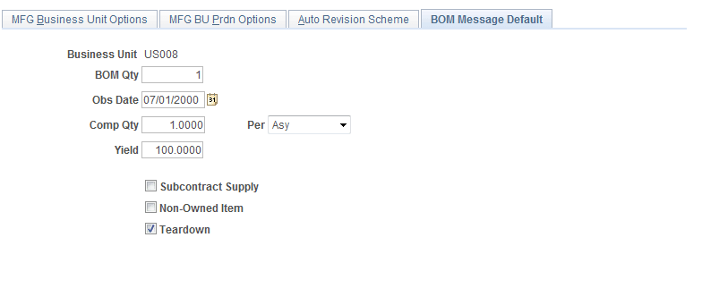

BOM Message Defaults Page
Use the BOM Message Defaults page (EN_BOM_MSG_DFLT) to set manufacturing business unit defaults for BOM messages received from a third-party product data management system.
Navigation:
Set Up Financials/Supply Chain, and then Business Unit Related, and then Manufacturing, and then Manufacturing Options, and then BOM Message Default
This example illustrates the fields and controls on the Manufacturing Options - BOM Message Default page. You can find definitions for the fields and controls later on this page.
If you are using effectivity dates, enter the obsolete date for the components of the incoming BOM message.
Indicate the component quantity to assign to incoming BOM message components.
In the quantity Per field, enter whether you want the component quantity for incoming BOM messages to apply per assembly or per order. If you set the quantity per assembly—and when the system determines component requirements in PeopleSoft Supply Planning—the system divides the quantity-per by the BOM quantity and then multiplies that result by the demand or order quantity. If you set quantity Per field to Order, the system uses the quantity regardless of the demand quantity or order size.
Component yield is the expected percentage of usable components within a batch of components issued to production. If you know that components may be damaged during the issuing or assembly process, you can account for that loss here. Indicate the yield to be assigned to incoming BOM messages.
Select Subcontract Supply if you are subcontracting all or part of the manufacturing process and you want to assign this status to incoming BOM messages.
Select Non-Owned Item for incoming BOM messages if you do not own the component, and you want to indicate that the component is consigned to you or is supplied by a customer.
You can indicate if incoming BOM message components should be a potential output from a teardown order. When you select Teardown, the system designates the component as a teardown output.
