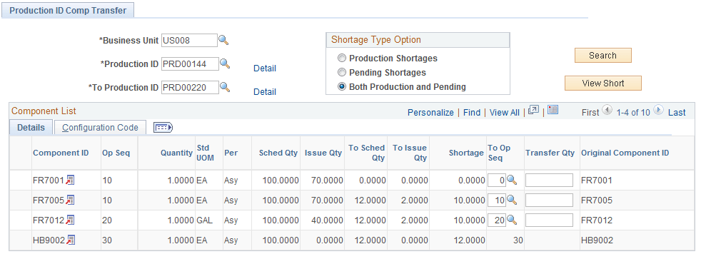

Production ID Comp Transfer Page
SF_COMP_TRANSFER
Correct errors after a production ID split. Use this page to transfer components between production IDs to cover shortages.
Component Detail Page
SF_COMPTR_COMP_SEC
View component shortages for the From production ID or the To production ID.

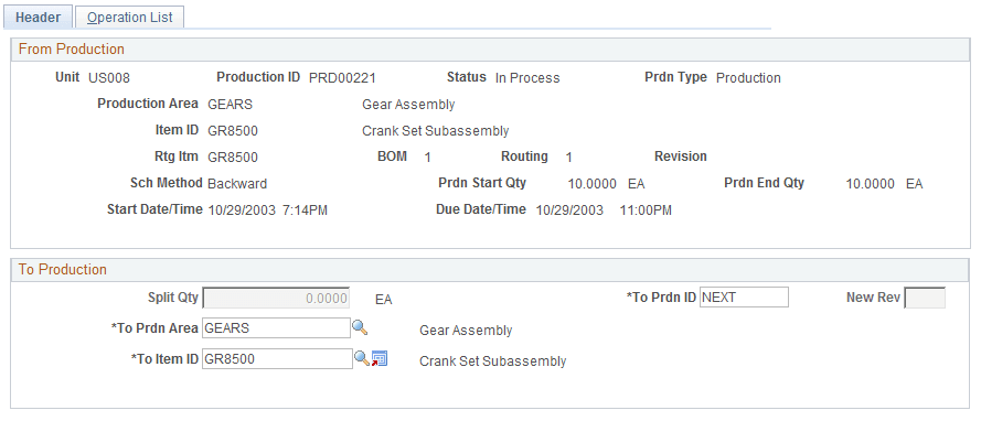

Production ID Split - Header Page
Use the Production ID Split - Header page (SF_SPLITID_HDR) to define production ID split information.
Split only production IDs with a status of In Process.
Navigation:
Production Control, and then Process Production, and then Split Production, and then Production ID Split, and then Header
This example illustrates the fields and controls on the Production ID Split - Header page. You can find definitions for the fields and controls later on this page.
Field or Control Description
From Production
Displays the production header data from the production ID that you are going to split.
Split Qty (split quantity)
If the production ID that you want to split has no operation list, enter the total quantity that you want to split from the original production ID. Whether you can enter a whole number or a decimal depends on the unit of measure and quantity precision combination that was defined for the item in PeopleSoft Inventory.
For example, if item ID A0007 has a unit of measure of EA and a natural round, whole number combination, then you can only enter whole numbers. If you enter an incorrect number format, you'll receive an error message.
If this field is unavailable, enter the split quantity on the Operation List page because there may be several operation steps with quantities that can be split.
Note: You cannot split a higher quantity than what is remaining at the operation sequence. For example, suppose that there is a quantity of 20 at operation sequence 10. Then you cannot split more than 20. If you enter a higher split quantity than the quantity that is available, you receive an error message.
View Trace Info
Click to access the Traceability page, where you can view the assembly serial IDs that have been associated with this production ID.
To Prdn ID (to production ID)
Enter a value for the new production ID if you are not using automatic numbering. If you are using automatic numbering, retain NEXT as the value.
New Rev (new revision)
Enter a value if the item is revision-controlled and this new production ID represents a new revision for the end item.
Note: Changes to the revision on the To item ID as reflected on the To production ID header only. Components copied during the production ID split process are based on the From production ID's component list and are not based on the revision number entered in the New Rev field.
To Prdn Area (to production area)
Select the area where the new production ID is processed. The production area for the To production ID can differ from the production area of the From production ID, but the end item must be assigned to the production area where you are moving the split quantities.
If you select an area that has a WIP storage location that differs from the From production area, you receive a warning message indicating that any material issued in WIP is not automatically transferred to the new area's WIP location. Use the EZ Transfer page or the Material Release page to move the components to the new WIP location.
To Item ID
You can split the original production ID to the same item or to a different item. However, you cannot split a primary item to a batch item—that is, an item that has at least one co-product. If you're splitting a batch item to a different batch item, then the new item inherits the by-products from the original item ID as long as they are not fully completed on the from Production ID. In that case, they are not copied.
Note: If the To item ID in a production ID split has an item status of Hold or Discontinue, you receive a warning message; however, the warning message does not prevent you from performing the action.
These situations cannot exist when selecting a value:
  • The To item ID cannot exist as a component on the parent component list.
  • The To item ID cannot exist on the parent output list as a by-product because the To item ID would be the end item as a primary item and a by-product.
  • The To item ID cannot be changed on rework or teardown orders.
Config Code (configuration code)
Select or enter a value if the item is configured:
  • If the From item ID and the To item ID are identical, you can change the configuration code for the To production ID.
  • If you split to a different item, the system prompts you to select a new configuration code for the To item ID.
  • If the configuration code changes during the split process, you can change the sales order for the new To production ID.

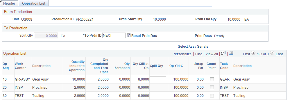

Production ID Split - Operation List Page
Use the Production ID Split - Operation List page (SF_SPLITID_OP) to indicate the production quantity to be split from the original production ID at specific operation steps.
Quantities can be split by operation based on the quantity that exists at the original production ID operation sequence.
Navigation:
Production Control, and then Process Production, and then Split Production, and then Production ID Split, and then Operation List, and then Header
Enter information on the Header page before accessing this page.
This example illustrates the fields and controls on the Production ID Split - Operation List page. You can find definitions for the fields and controls later on this page.
To Production
Appears only on the header of this page, when the From production ID has operations and reflects the total split quantity for the To production ID.
Use NEXT if you are using automatic numbering, or enter a specific production ID number for the new production ID.
Reset Prdn Doc (reset production documents)
Select to reprint the production documents for the To production ID.
Components
Click to view the production ID Components page. Use this page to make changes to the components that you're copying to the To production ID. This button is unavailable until a split quantity is entered at an operation.
Note: If you are splitting the entire production quantity to a new production ID, you cannot make adjustments to the components.
Operation List
This information appears for the From production ID, and is used to split operation data to the new production ID:
Op Seq (operation sequence)
Operation step in which processing has or will be take place. Components or ingredients can be added here.
Work Center and Description
Current location where the From production ID is processed. These fields are display-only and cannot be changed here.
Quantity Issued to Operation
Production quantity of assemblies completed at the prior operation and sent to the current operation. If the operation is the first operation in the process, the quantity issued to operation is the production ID quantity.
Qty Completed and Thru
Quantity completed at the operation. This quantity does not include any scrapped assemblies. These fields are display-only and cannot be changed here.
Qty Scrapped (quantity scrapped)
Number of assemblies that have been scrapped at the operation sequence. This field is display-only.
Qty Still at Op (quantity still at operation)
Production quantity that is considered still in process and that can be split to a new production ID. This display-only field is calculated using this formula:
(Issued quantity) - (Quantity completed and through the operation) + Scrapped quantity)
Enter the production quantity to be transferred to a new production ID. Enter a split quantity for each operation that has a quantity remaining at the operation. However, you cannot split a quantity that is greater than the quantity still at the operation sequence.
Note: You can split the entire original production quantity if you have not recorded any completions or scrap at any prior operations.
Scrap Pct (scrap percentage)
A weighted average of the scrap percentage specified when recording end item completions and scrap. This percentage represents the percentage of run time expended before the end item is scrapped.
Count Point
The check box is display-only if this operation sequence is a count point. Define an operation step as a count point on the new production ID by using the Operation List Maintenance page.
Task Code and Description
Task that is performed at the operation step.
See the product documentation for PeopleTools: Process Scheduler

Represents the quantity of components scrapped during the assembly process but not yet consumed from the WIP location due to material shortages.
Original Component ID
Displays the name of the original component ID.
OK
Click to return to the Operation List page.
Save
Click to process the production ID split. When you save the page, the production ID split is generated and these actions occur:
Use the Production ID Comp Transfer page (SF_COMP_TRANSFER) to correct errors after a production ID split.
Navigation:
Production Control, and then Process Production, and then Split Production, and then Production ID Comp Transfers, and then Production ID Comp Transfer
This example illustrates the fields and controls on the Production ID Comp Transfer page. You can find definitions for the fields and controls later on this page.
You can only perform component transfers on production orders with a status of In Process. In addition, only production ID materials that have actually been issued from the original production ID can be transferred to the To production ID.
Click the Detail link to view production details for either the From production ID or the To production ID.
Shortage Type Option
You can view all components on the From production ID or only the components that currently have shortages on the To production ID. If you view component shortages, the values are:
  • Pending Shortages: System displays all pending shortages that exist when the pending consumed quantity and the pending yield loss quantity is greater than 0.
    This condition indicates that the component was not found in the WIP location or storage location if kitting (kit issues create pending quantities in some instances) or insufficient quantity on hand was found and the full quantity could not be issued. A pending issue quantity could exist on the newly split production ID if there are material shortages for the component.
  • Production Shortages: System displays all production shortages that exist when the issue and yield loss quantity is less than the component's scheduled quantity.
  • Both Production and Pending: System displays all components on the To production ID, including those that have both production and pending shortages.
Search
Click to retrieve the selected production ID information.
View Short
Click to view the components that have shortages.
View All
Click to retrieve all components.
Component Search Button
Click the Component Search button to access these links:
  • From Component: Click to view component detail information for the From production ID that was split.
  • To Component: Click to view component detail information for the To production ID.
  • To Component List: Click to view the component list of the To production ID if the component appears more than twice on the To production ID.
Component List
Issue Qty (issue quantity)
Number of components already issued or consumed on the From production ID.
To Sched Qty (to schedule quantity)
Scheduled or required component quantity on the To production ID based on production quantity and component's quantity per assembly or quantity per order.
To Issue Qty
Number of components already issued to the To production ID.
To Op Seq (to operation sequence)
Select the operation step in which the component is added to the To production ID.
Transfer Qty (transfer quantity)
Enter the quantity of the component that you want to transfer to the To production ID. If you enter a quantity that is less than the quantity that is outstanding, a pending issue quantity remains.
Appears if the component was a substitution for another component requirement.
