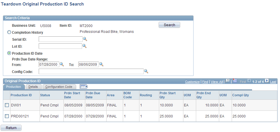

Production ID Maintenance Page
Teardown Original Production ID Search Page
SF_TRDN_PID_SEC
Locate the original production ID used to create the teardown item.
This page is used for teardown orders only.

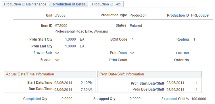

Production ID Detail Page
SF_PRDNID_STATIC
View production ID and scheduling data.

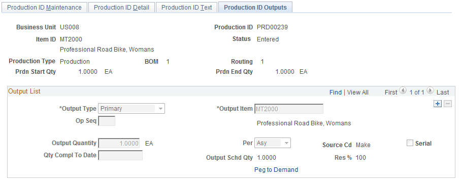

Production ID Outputs Page
SF_PRDN_OUTPUT
Maintain and display production output information.

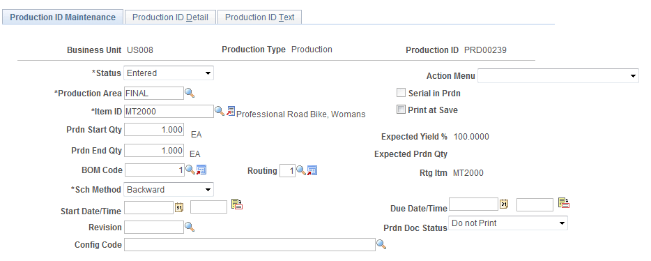

Use the Production ID Maintenance page (SF_PRDNID_MAINT) to create and maintain a single production ID for production, rework, or teardown orders.
Navigation:
Production Control, and then Define Production, and then Production IDs/Schedules, and then Maintain PIDs, and then Production ID Maintenance
Select a Production Type.
This example illustrates the fields and controls on the Production ID Maintenance page. You can find definitions for the fields and controls later on this page.
Field or Control Description
Status
You can add a production ID with a production type of Production in either the Entered, Firmed, or Released status.
You can add a rework or teardown production ID with a Firmed or Released status only.

BOM Code and Routing Code
The values appear by default for the production area and item combination effective for the area and item as of the current date. Change the BOM and routing codes if alternate routings are used for this production ID.
Only the BOM and routing codes for the item and the selected production type are available. For example, suppose that you select the Rework production type, you can only select rework BOMs or rework routings if either are defined. Rework and teardown routings are optional. If you do not select a rework or teardown routing, the system does not create an operation list for the production ID, and you need to manually enter the actual start date and time and actual due date and time. For teardown production, the production BOM (or an original production ID) is used to determine the teardown output list. The end item is copied to the component list.
Rtg Itm (routing item)
Displays the item whose routing is used to manufacture, rework, or tear down the end item. Each assembly item can have its own unique primary and alternate routings or reference another item's primary and alternate routings.
Due Date/Time
If you change the due date and time for the production ID so that a different BOM and routing combination is used, a warning message appears enabling you to accept the new BOM and routing combination.
Effectivity dates apply only if you use the Production Option Maintenance component to define the valid BOM and routing combinations.
BOM and routing combinations can be viewed in the Production Option Maintenance component.
Select valid production options (predefined BOM and routing combinations) for the item. If you select the Valid Production Options only option on the Item Attributes by Unit - Manufacturing page, then only the predefined combinations can be entered or selected.
Production Option Button(production option button)
Click the Production Option button to access the Production Option Selection page.
If you create a component list and there are operations linked to the components that do not exist on the routing, the system treats those components as linked to the first operation sequence. This is similar to how the system handles a component with a 0 operation sequence. Unmatched output by-products, on the other hand, are linked to the last operation.
Once you add the production ID, keep these points in mind if you make any changes to the routing code:
  • The system recalculates the production ID's actual start or due date and time based on the new routing's lead times and scheduling parameters.
  • If the production ID is in the Firmed or Released status, changing the routing code also deletes the existing operation list.
    The system creates a new operation list for the production ID using the routing code specified.
  • If the production ID is in the Firmed or Released status, you can change the routing code only if a subcontracted purchase order has not been generated against the production ID.
  • If the production ID is forward scheduled and the due date and time for production has changed based on the new routing, the system prompts you to delete the existing component list.
    If you select Yes to the Component List for Production ID prompt, the system deletes the component list and creates a new one based on the BOM in effect on the new due date.
Sch Method (scheduling method)
If you are using the production start date as a basis for creating the schedule for the production ID, select Forward. If you are using the production completion date as a basis for creating the schedule for the production ID, select Backward.
Start Date/Time or Due Date/Time
If you selected a routing, enter only one of these dates. The system automatically calculates the other date once you define whether the production for this item is based on forward or backward scheduling.
Keep these points in mind when entering a start date and time or a due date and time:
  • If a routing is not used, manually enter both the start and due dates/times, regardless of the scheduling method selected.
  • When using Forward scheduling and entering a start date, the first minute of operation for the earliest shift of the day appears as the default time.
    If the earliest shift spans multiple days, the first minute of the date specified appears as the default time (for example, 12 a.m.).
  • When using Backward scheduling and entering a due date, the last minute of operation for the latest shift of the day appears as the default time.
    If the latest shift spans multiple days, the last minute of the date specified appears as the default time (for example, 11:59 p.m.).
Note: If capacity and material availability are concerns, estimate the start and due dates when you create or maintain the production ID using PeopleSoft Manufacturing, and then schedule the production ID's start and due dates using PeopleSoft Supply Planning.
Revision
If a revision was specified for the area and item, it is displayed here. Otherwise, if the item is revision-controlled, the BOM revision in effect as of the due date for the order is used. Changing the revision is valid only if the item is revision controlled. Select an alternate revision if alternates have been specified. If you are changing the revision and the production ID is in Firmed or Released status, the system prompts you to replace the existing component list.
  • If you select Yes to the Component List for Production ID prompt, the system deletes the component list and adds a new one based on the BOM's effectivity date
  • If you select No, the system uses the existing component list for the production ID.
Prdn Doc Status (production document status)
Indicates whether production documents have been printed. Values are:
  • Do not print: This is the default if the production ID status is Entered.
  • Ready to Print: This is the default if the production ID status is Firmed.
    The system prints production documents when the production ID's status is Firmed or later.
  • Printed: This indicates that documents have already been printed.
    You can only print production documents when the production ID's status is Firmed or later.
Print at Save
Select to print production documents for the production ID at save time.
Action Menu
Select any of these pages to access additional information:
  • Update Comp List (update component list): Click to access the Update Component List component, where you can make changes to the component list for this production ID.
    See Understanding Component Lists.
  • Update Op List (update operation list): Click to access the Update Operation List component, where you can make changes to the operation list for this production ID.
    See Understanding Operation Lists.
  • View Outputs: Click to access the Production ID Outputs page to view the outputs associated with this production ID.
  • View Serial Info: Click to access the Traceability page, where you can view the assembly serial IDs that have been associated with this production ID.
  • Review Proactive Costing: Click to access the PID Costing page to view the current costs of a production ID based on the component list and operations list.
    The costs are a snapshot of the production ID's costs at a particular point in time.
    See PeopleSoft Cost Management: Proactive Production Cost - PID Cost Page.
  • Planning Attributes: Click to access the Planning Attribute page.
    See Update Production Page.
  • Peg to Demand: Click to access the Pegging Workbench to peg the production ID to a sales order.
  • Show Pegged Demand: Click to access the Pegging Inquiry page to view any pegged orders.
    See PeopleSoft Supply Chain Management Common Information: Understanding Pegging.
  • Setup Print Options: Click to access the Process/Output Options page to select different print criteria for the production documents.
  • Process Monitor: Click to access the Process List page.
    See PeopleTools: PeopleSoft Process Scheduler Documentation
Adding and Maintaining Production IDs Using a Weekly View
You can also maintain and view production IDs by using the Production by Area pages.
See Production by Area Summary Page.
Production Start Date/Shift or Production Due Date/Shift Page
Use the Production Start Date/Shift or Production Due Date/Shift page (SF_PRDN_DUE_SBP) to display production start date and shift information or production due date and shift information for the selected production ID.
Navigation:
Click the Detail button next to the Start Date/Time or Due Date/Time fields.
The first or last minute of the production shift is based on these scenarios:
  • For Forward scheduling, the system uses the work center calendar for the routing's first operation, if one exists.
  • For Backward scheduling, the system uses the work center calendar for the routing's last operation, if one exists.
  • If work center calendars do not exist for the routing's first or last operation's work center, the system uses the production calendar, if one exists.
  • If a production calendar does not exist, the shift's start or end time specified for the five-day work week is used.
  • If you are changing the due date and time and a routing is specified, the system recalculates the start date and time.
    Conversely, if you are changing the start date and time, the system recalculates the due date and time. The production start date and shift and the production due date and shift associated with the start date and time and due date and time are also determined.
  • If the production ID is in the Firmed or Released status and you replace the start date and time or due date and time, the system updates the operation list with each operation's new start and due dates and times.
  • If you are changing the due date or the due date changes as a result of a change in start date, the system prompts you to delete the existing component list.
    If you select Yes to the Component List for Production ID prompt, the system deletes the component list and adds a new one based on the BOM in effect on the new due date.
  • If the production ID is in the Firmed or Released status and a subcontracted purchase order has been generated against the production ID, any changes that result in a change to the start date and time or due date and time may affect the purchase order due date.
    The system displays a warning message when changes occur that result in a change to the start dates and times and the due dates and times.
Use the Teardown Original Production ID Search page (SF_TRDN_PID_SEC) to locate the original production ID used to create the teardown item.
Navigation:
Click the Search button next to the Original PID field to access this page.
This example illustrates the fields and controls on the Teardown Original Production ID Search page: Production tab. You can find definitions for the fields and controls later on this page.
If the production type is Teardown, the output list is based on the components used on a previous production ID or on the components designed as teardown outputs on the item's BOM.
Select Completion History, and if the serial ID and lot ID exist for the original order, select values.
You can also select a production due date range or configuration code from the available options. After you make the selections, click Search for a list of production IDs. If multiple production IDs were used to create the item, the system generates a list of production IDs, but it only selects production IDs with a status of In Process or later status with a production type of Production.
Production Tab
Select the check box next to the original production ID that you're tearing down.
Use the Production ID Detail page (SF_PRDNID_STATIC) to view production ID and scheduling data.
Navigation:
Production Control, and then Define Production, and then Production IDs/Schedules, and then Maintain PIDs, and then Production ID Detail
This example illustrates the fields and controls on the Production ID Detail page. You can find definitions for the fields and controls later on this page.
Frozen Production
Indicates whether a decision was made to hold or firm up the due date for this production ID by PeopleSoft Supply Planning. Change production information using the Production ID Maintenance page. If you change production information and the status is Yes, the system displays a warning message indicating that the production ID has been frozen by PeopleSoft Supply Planning and the change results in the production ID being rescheduled. You can continue or cancel the changes. If you change this information, the production ID is no longer frozen and the status changes to No.
Frozen Substitutes
Indicates whether the system has frozen substitutes in the PeopleSoft Supply Planning system. This means that when you sent this production ID to PeopleSoft Supply Planning, the Planning engine did not include substitute components.
OM Business Unit (Order Management business unit), Sales Order No and Configuration Code
These fields display sales order information if the production ID results from a sales order configured in PeopleSoft Order Management.
Print Count
Indicates the number of times that production documents have been printed for the production ID.
Completed Qty (completed production start or production end quantity)
Indicates whether assemblies have been completed to stock, routed to another WIP location, or issued directly to another production ID.
Scrapped Qty (scrapped quantity)
Indicates the number of assemblies that have been scrapped in process.
Use the Production ID Outputs page (SF_PRDN_OUTPUT) to maintain and display production output information.
Navigation:
  • Production Control, and then Define Production, and then Production IDs/Schedules, and then Maintain PIDs, and then Production ID Maintenance. If you're adding a new production ID, the Production ID Outputs page is not available until after you save the page.
  • Select View Outputs from the Action Menu on the Production ID Maintenance page.
This example illustrates the fields and controls on the Production ID Outputs page. You can find definitions for the fields and controls later on this page.
Output List
Output Type
Values are:
  • Primary: Main output from the manufacturing process.
  • Co-Product: Item that—along with the primary item or output—is planned for and produced as part of the manufacturing process.
    It shares the cost of the process, and there may be independent demand in planning for this item.
  • Recycle or Waste: By-product item that is incidental to the manufacturing process.
    It can be either a waste product or a recycle by-product, which can be used as an input to other processes. The by-product has either a relief (negative) cost for recycle by-products or a disposal (positive) cost for waste by-products. There would probably not be independent demand for by-products.
  • Teardown: Component items that result from tearing down a completed end item.
    Components can be reused in other production and can be returned to stock or routed to another production ID. This output type is available only for teardown production IDs.
Op Seq (operation sequence)
Operation step in which the output is generated. For primary and co-products, this is always the last operation. By-products and teardown outputs can be generated at any intermediate operation. If the operation sequence is 0 or does not exist on the operation list, it is assumed the output is generated at the last operation.
Output Sched Qty (output scheduled quantity)
Output quantity based on the scheduled quantity but adjusted for scrap. The format for this display-only field may depend on the item's unit of measure and quantity precision combination defined in PeopleSoft Inventory.
For example, suppose that item ID A0007 has a unit of measure of EA and a natural round, whole number combination. In that case, only whole numbers entered appear.
  • Co-product quantity.
    If the primary or co-product is expressed in terms of a quantity per order, the quantity specified on the BOM is the output quantity, regardless of the expected output quantity for the production ID or production schedule.
    If the primary or co-product output quantity is expressed in terms of a quantity per assembly, a QPA will first be determined. The primary or co-product QPA is (BOM output quantity) ÷ (BOM quantity). The expected completions for the primary or co-product are (Expected completions at the last operation) × (Primary or co-product QPA).
  • By-product quantity.
    When determining the output for the recycled and waste products, the system uses the expected start quantity for the operation where the by-product is completed.
    If the by-product output quantity is expressed in terms of a quantity per order, the quantity specified on the BOM will be used, regardless of the operation start quantity.
    If the by-product output quantity is expressed in terms of a quantity per assembly, a QPA for each output will be calculated. The QPA is determined by dividing the by-product output quantity by the BOM quantity. The by-product output quantity for the PID and schedule is determined by multiplying the operation expected start quantity by the QPA.
Release Type
This field is used by PeopleSoft Supply Planning and indicates if the entire quantity of an end item at an operation should be completed at the end of the operation. Select None for no incremental release. Select Over Time to indicate that you want a specified quantity of end items to be on hand before completions occur.
Release Offset
This field is used by PeopleSoft Supply Planning and works with the Over Time option of release type. Enter the quantity of end items to be on hand before completions occur.
Peg to Demand
Click this link to access the Pegging Workbench page to peg the production ID to a sales order.
Show Pegged Demand
Click this link to access the Pegging Inquiry page to view any pegged orders.
Adding Unplanned By-Products
Add Button
Click the Add button to add an additional (unplanned) by-product. You can add or change Recycle, Teardown, or Waste by-products on the production ID; however, you cannot add or change primary items or co-products.
Note: You can only add teardown outputs to a Teardown type production ID. Similarly, you cannot add recycle or waste outputs to a Teardown production ID. However, you can change the output quantity, operation sequence, and Per field for any by-products.
Output Qty (output quantity)
Whether you can enter a whole number or a decimal depends on unit of measure and quantity precision combination that was defined for the item in PeopleSoft Inventory.
Res % (resource percentage)
Indicates the resource percentage for the primary and co-products.
Important:
Only by-products such as recycle or waste products can be added or changed. You cannot change or add primary items or co-products.
If you are maintaining a rework production ID, the output page lists only the reworked item as the end item. You cannot define co-products or by-products with rework.
