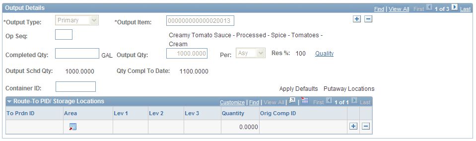

This example illustrates the fields and controls on the Output Details scroll area on the Record Completions/Scrap page. You can find definitions for the fields and controls later on this page.
To enter batch completions quantities (for production IDs with multiple outputs):
  1. Access the Record Completions/Scrap page.
  2. Enter a completed quantity and select an operation sequence.
    The Output Details scroll area becomes available.
    If you're recording completions at an intermediate operation, the system displays all by-products. If you're completing operations at the last operation, the system displays all outputs: primary, co-products, and by-products.
  3. (Optional) ClickView All to display all end items being completed.
  4. Enter the completed quantity for each output.
    The completed quantity for each end item is calculated based on the batch (BOM) quantity. You can, however, override the output quantity for each end item.
  5. (Optional) Click Add to add by-products.
    1. Select the output type; you can only add Recycle or Waste by-products.
    2. Select the output item.
    3. Select the operation sequence where the by-product is being generated.
      The default operation sequence is zero, and if you do not change the default, the system treats it as the last operation.
    4. Enter the output quantity based on per end item or per order.
  6. Click Save to process the multiple output completion.
