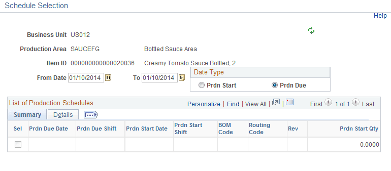

Schedule Selection Page
Use the Schedule Selection page (SF_PA_SCH_PEG_SP) to peg completions to a specific production schedule row.
Navigation:
Production Control, and then Process Production, and then Complete Production, and then Record Completions and Scrap, and then Production Selection
Enter the production area and item, and then click the Complete to a Specific Schedule link.
This example illustrates the fields and controls on the Schedule Selection - Summary page. You can find definitions for the fields and controls later on this page.
You may want to complete for a specific production schedule because a substitution was made or a data entry error needs to be corrected. In addition, by pegging to a production schedule, you update the specific production schedule when you run the Completions Update process.
Field or Control Description
Date Range
Enter the date range.
Date Type
Displays how you want to view the production schedules. Values are:
  • Prdn Start (production start)
  • Prdn Due (production due)
Refresh Button
Click to refresh the data if you made any changes to the date range or date type.
Sel (selection)
Select the specific production schedule that you want to record completions and scrap.
OK
Click this button to return to the Production Selection process page.
