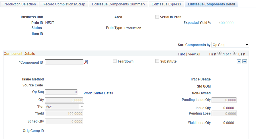

Edit/Issue Components Detail Page
SF_EDIT_COMPS_DET
View detailed information for each component for selected production.

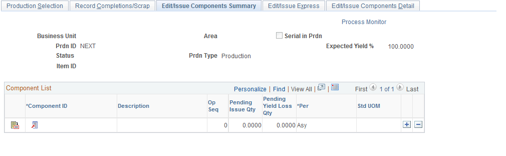

Edit/Issue Components Summary Page
Use the Edit/Issue Components Summary page (SF_EDIT_COMPS_EDIT) to edit or view components.
In addition, use this page to edit or issue components during the Record Completions and Scrap process or after the Record Completions/Scrap process has been run.
Navigation:
  • Production Control, and then Process Production, and then Complete Production, and then Record Completions and Scrap, and then Edit/Issue Components Summary if you are editing or issuing components during the completions process
  • Production Control, and then Process Production, and then Issue Materials, and then Edit/Issue Components, and then Edit/Issue Components Summary if you are editing or issuing components after you've recorded completions and scrap
This example illustrates the fields and controls on the Edit/Issue Components Summary page . You can find definitions for the fields and controls later on this page.
Field or Control Description
Print at Save
Select this check box if you want to print production documents for a particular production ID at save time.
Setup Print Options
Click this link to access the Process/Output Options page to select different print criteria for the production documents.
Express Page Button
Click the Express Page button to access the Edit/Issue Express page to view or assign serial and lot numbers.
Express Page Button
Click the Detail button to access the Edit/Issue Component Detail page.
Item Search Button
Click the Item Search button to access the Item Search, Item Availability, or Item Substitution pages.
Op Seq (operation sequence)
Determines the WIP inventory location to which the components are issued and from which they are consumed. When you add a new component to the component list, the operation sequence defaults to zero. When recording end item completions and scrap, the system consumes a component with an operation sequence of zero at the first operation and decrements the component quantity on hand in the production area's default WIP location.
You can change the operation sequence to any valid operation on the end item's operation list. When you select an operation sequence, the component must be issued to and is consumed from the WIP location associated with the operations work center.
Per
Indicates whether the quantity required is per assembly (Asy) or per order (Ord). Per assembly indicates the quantity required to complete one end item. Per order indicates the amount required, regardless of the end items that will be produced.
  • If the component is per assembly, the system calculates the consumed quantity by multiplying the quantity per by the end item completion and scrapped quantity.
  • If the component is per order, and you're recording completions for a production ID, the system consumes the full order quantity during the first recorded backflush.
    Once consumed, it will not be consumed again during any subsequent backflushes. If you're recording completions for a production schedule, the consumption of a per order quantity depends on the Manufacturing Options setting for Calc Per Order for Production Schedules.
Pending Issue Qty (pending issue quantity)
The system calculates this value for those components whose operations have had end item completions or scrap reported.
Enter a new pending issue quantity if you consumed more or less than the quantity calculated.
The pending issue quantity is based on the quantity completed plus the quantity scrapped multiplied by the quantity per assembly. If the quantity on the component list is expressed in terms of quantity per order, the full quantity appears. This quantity is consumed only at the time of the first backflush for production ID. For production schedules, the Calc Per Order for Production Schedules option on the Manufacturing Business Unit Option page determines how the quantity is displayed.
If you have enabled PeopleSoft Workflow, the system sends a notice to the production supervisor that there is a nonzero quantity for this component. PeopleSoft Manufacturing uses the Identify Production with Pending Quantities workflow for this notification.
  • If the option is set to Calc Per Order for Prdn Sched, the system displays the per order quantity for every production schedule completion.
    If you have already consumed the order quantity for the production run, you must zero out this amount.
  • If the option is set to do not Calc Per Ord on Prdn Sched, the system doesn't display any per order quantity for any production schedule completion.
    In this instance, you must enter the order quantity when the material is consumed for the production run.
Pending Yield Loss Qty
If the quantity of components lost is more or less than planned, indicate the new pending yield loss quantity here. If the item's yield loss is set to calculate the pending yield loss quantity, then the system calculates the pending yield loss for those components whose operations have had end item completions or scrap reported. You define whether or not you want the system to calculate pending yield loss quantity at the business unit or item level. If you do not want the system to calculate pending yield loss quantity, then you manually record the yield loss at the appropriate times.
The system uses this formula to calculate the pending yield loss quantity:
(Quantity Completed + Quantity Scrapped) x Expected Yield Loss Percentage
Expected Yield Loss Percentage = (1 - Component Yield / 100)
Adding or Substituting Components
Component ID, Op Seq (operation sequence), Per Asy (assembly) or Ord (order), Pending Issue Qty (pending issue quantity), and Pending Yield Loss Qty (pending yield loss quantity)
Enter values for these fields if you're adding or substituting components.
Note: Pending issue and pending yield loss quantities are not calculated for expensed or floor stock items. In addition, you cannot enter values for components with an issue method of Kit.
To change or enter the quantity per, yield, or scheduled quantity, use the Edit/Issue Component Detail page.
If you're substituting a component, zero out the pending issue and pending yield loss quantity for the original component.
Allowing Negative On Hand Inventory
If the PeopleSoft Inventory business unit parameter allows negative inventory balances and there is not enough material in the WIP location to cover the pending issue or pending yield loss quantity, the quantity on hand in the WIP location will become negative. Another business unit parameter determines when the system issues a warning message prior to driving quantity on hand negative. This message allows you to decide whether to continue with the completion transaction or to wait until the inventory is moved into the WIP location before continuing. If you do not allow the inventory to go negative, the quantity that couldn't be consumed remains in the pending issue or pending yield loss fields. These must be reconciled once the WIP location has sufficient quantity on hand.
If the item that you're consuming is serial-controlled, you cannot drive the quantity on hand negative, regardless of the PeopleSoft Inventory business unit setting.

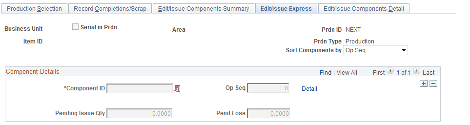

Edit/Issue Express Page
Use the Edit/Issue Express page (SF_EDIT_COMPS_EXPR) to (Optional) Select lot- or serial-controlled components that have pending issue or pending loss quantities.
You can view or change lots assigned to lot-controlled components by the backflush lot selection rule.

This example illustrates the fields and controls on the Edit/Issue Components - Edit/Issue Express page. You can find definitions for the fields and controls later on this page.
Component Details
You can change any of this information on this page:
  • Component ID
  • Pending issue quantity
  • Operation sequence
  • Pending loss
Access the Lot/Serial scroll area on the Edit/Issue Express page (Production Control, and then Process Production, and then Complete Production, and then Record Completions and Scrap, and then Edit/Issue Express).
Lot ID
Select a lot if you're editing or issuing lot-controlled components. You can view or change lots assigned by the backflush lot selection rule.
Qty Req (required quantity)
Specify the amount of components that you want to consume from each lot. This field can be automatically populated during backflush using the backflush lot selection rule.
Use the Edit/Issue Components Detail page (SF_EDIT_COMPS_DET) to view detailed information for each component for selected production.
Navigation:
  • Production Control, and then Process Production, and then Complete Production, and then Record Completions and Scrap, and then Edit/Issue Components Detail
  • Production Control, and then Process Production, and then Issue Materials, and then Edit/Issue Components, and then Edit/Issue Components Summary. Click the Detail button next to the component you want to edit or view.
This example illustrates the fields and controls on the Edit/Issue Components Detail page. You can find definitions for the fields and controls later on this page.
Component Details
Component ID, Op Seq (operation sequence), Qty (quantity), quantity Per, Yield, and Sched Qty (scheduled quantity)
Enter or modify values for these fields.
Work Center Detail
Click this link to access work center-related information.
Qty (quantity)
The calculated quantity per is next to this field. The system calculates the quantity per by dividing the quantity per assembly by the bill of material's BOM quantity. You designate the level of precision for the calculated quantity per on the Manufacturing installation options page.
Pending Issue Qty (pending issue quantity) and Pending Yield Loss Qty (pending yield loss quantity)
Although these values appear by default from the Edit/Issue Components Summary page, you can change them here.
Note: If you are not completing end items, a pending issue or pending yield loss quantity greater than zero indicates that the components couldn't be consumed from the appropriate WIP location from a previous completions or edit components transaction. This is due to a shortage of the component in the WIP location associated with the component's operation sequence.
Issue Qty (issue quantity)
This field represents the quantity consumed that was issued from the WIP location for the component and was charged to WIP. For items using the Kit issue method, this is the quantity that was issued during Material Release of a production Pick Plan or issued using the Issue/Return Kit Components page. You cannot modify kitted components here. This field is used for production IDs only.
Yield Loss Qty (yield loss quantity)
This field represents the component quantity that was scrapped during end item completion and issued from the WIP location. This field is used for production IDs only.
Issue Method
This field indicates the component replenishment issue method.
Quantities of an item that are stored in a nettable, available WIP location and reserved for production use are not available for other purposes.
