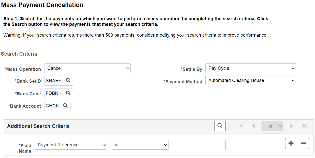

This example illustrates the fields and controls on the Mass Payment Cancellation page - Step 1. You can find definitions for the fields and controls later on this page.
Mass Payment Cancellation page Step 1
This example illustrates the fields and controls on the Mass Payment Cancellation page - Step 2. You can find definitions for the fields and controls later on this page.
Mass Payment Cancellation page Step 2
Search Criteria
All fields in the Search Criteria group box are required fields. You must enter at least one field name and value as additional search criteria.
Field or Control Description
Mass Operation
Select the processing option you want to perform: Cancel, Escheat/Stale-date, Undo Cancel, or Undo Escheat/Stale-date.
Note: After posting, you cannot undo the cancellation or escheatment.
Settle By
Select the settle through method, either Financial Gateway or Pay Cycle. Pay Cycle appears as the default.
Note: If you select Financial Gateway, during the Mass Payment Cancellation process, the system creates and sends a message to the PeopleSoft Financial Gateway. Once the system receives a response from the PeopleSoft Financial Gateway, the search results are displayed in Payment Inquiry.
Bank SetID, Payment Method, Bank Code, and Bank Account
Enter bank information and a payment method to further narrow your selection.
Field Name
Select at least one field name and value. You may select more than one field name to use in your search criteria. Payment Reference appears as default.
When you select Payment Reference, you can define multiple values and multiple ranges. The system joins these fields by the or condition. For example, you can define Payment Reference = 100000, or Payment Reference = 200000, or Payment Reference between 300000 and 400000. The system retrieves all payments that meet that criteria.
When you select Pay Cycle and value, the system requires that you select a Pay Cycle Sequence Number and value as well.
When you select other available field names, define a single value or single range of values for that field name. When you select the other fields, they are joined by the and condition. For example, you define Pay Cycle = Weekly, and Pay Cycle Sequence Number = 001, and Payment Reference = 100000, or Payment Reference = 200000. The system retrieves the payment references 100000 and 200000 generated from the Weekly pay cycle with a pay cycle sequence number of 001.

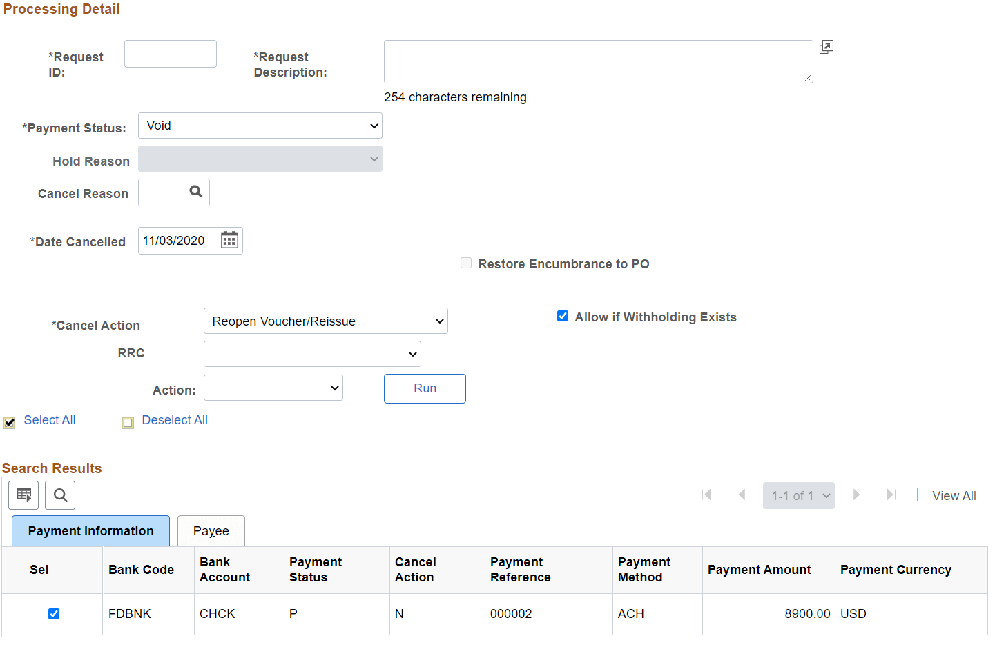

Processing Detail - Common Fields
The fields appearing in this group box are dependent upon the mass operation you selected in the Search Criteria group box. These fields are common to all mass operations.
Request ID and Request Description
Specify a request ID and a description. The system uses these IDs to track each process request. This field is required and displays for all mass operations.
Document Sequencing
Click to access the Document Sequence page to override the default document type and enter a document sequence number, if applicable. This link appears only if document sequencing is enabled.
Action
Select to run one of the following on-demand processes:
  • 1. Mass Cancel: Selecting this option runs the Mass Cancellation process. This is the only process available if you select the Undo Cancel as the mass operation.
    Note: This is the only action that appears if you do not use on-demand processing.
  • 2. Payment Post: Selecting this option runs the Mass Cancellation process followed by the Payment Posting process.
  • 3. Voucher Post: Selecting this option runs three processes: first, the Mass Cancellation process, followed by the Payment Posting process, and then the Voucher Posting process. This process is available when you select the Cancel mass operation and the Do not reissue/Close Liability cancel action.
Processing Detail - Cancel Mass Operation
These fields are displayed in addition to the common fields when you select Cancel as the mass operation. These fields are similar to fields displayed on the Cancel Payment page.
See Cancel Payment Page.
Payment Status
Select a payment status of Stop or Void. Void appears as the default.
Date Cancelled
Enter a date to cancel the payments. Today's date appears as default.
Hold Reason
Specify a hold reason for payment cancellations placed on hold. This field is available only when the cancel action is Reopen Voucher/Put on Hold.
Cancel Reason
Specify a cancel reason for payment cancellations.
Cancel Action
Select a cancel action that includes:
Do not reissue/Close Liability.
Reopen Voucher/Reissue.
RRC
Select a return reason code. This field is available only if the bank account is listed on the PIR Definition page.
See PIR Definition Page
Restore Encumbrance to PO
Select to restore the PO encumbrance and close the voucher liability. If the check box is not selected, only the voucher liability is closed. This check box is selected by default and is only applicable when the cancel action is Do not reissue/Close Liability and you use Commitment Control.
Allow if Withholding Exists
Select to cancel selected payments for vouchers that are subject to withholding. The payment to the withholding agency is not canceled unless it is included in the search results based on your search criteria. This check box is selected by default.
If the check box is not selected, the system creates an error for the selected payments for vouchers that are subject to withholding. The payment to the withholding agency is canceled if it is included in the search results based on your search criteria.
Note: The check box is not applicable if you only report withholding information.
