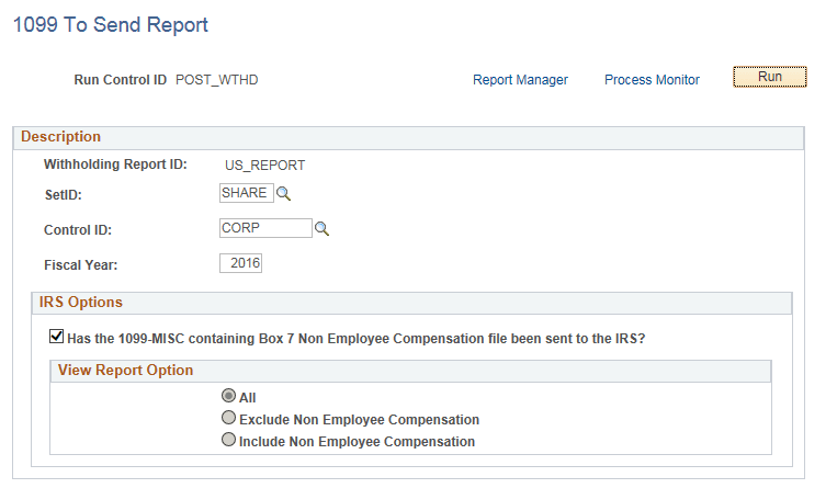

1099 to Send Report Page
TO_SEND_RPT
Define run parameters for the 1099 Withholding to Send Detail Report (APY8056). Use the report to review a summary of the data stored in the withholding detail table (WTHD_TO_SND_DTL). The report lists all the information created by the 1099 reporting process and is a replica of the data in the file you are sending to the IRS. You must complete the 1099 Report process-with the exception of sending the file-for the report to accurately summarize your data.

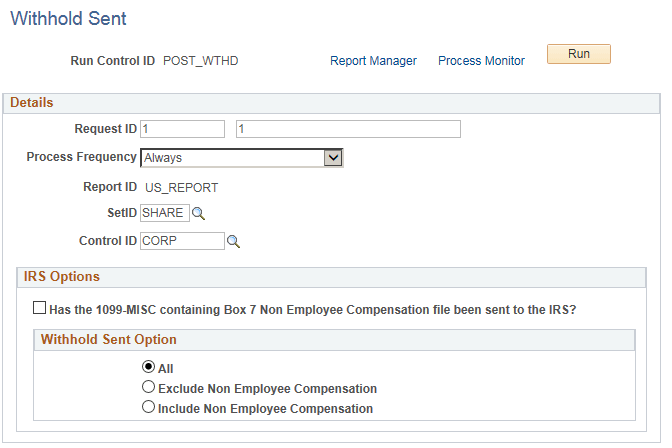

Withhold Sent Page
WTHD_SENT
Request a run of the Withholding Sent File Application Engine process (WTHD_SENT). This process finalizes the 1099 reporting and file creation process. It records all the data in the file you have sent. Do not run this process until you send your file to the IRS. You can only run it once for each time you run the withholding report. The system uses this information when creating correction or replacement files.

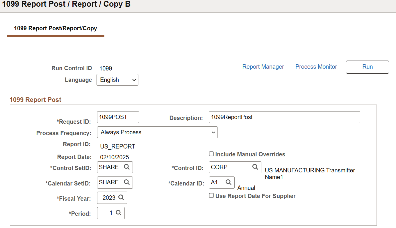

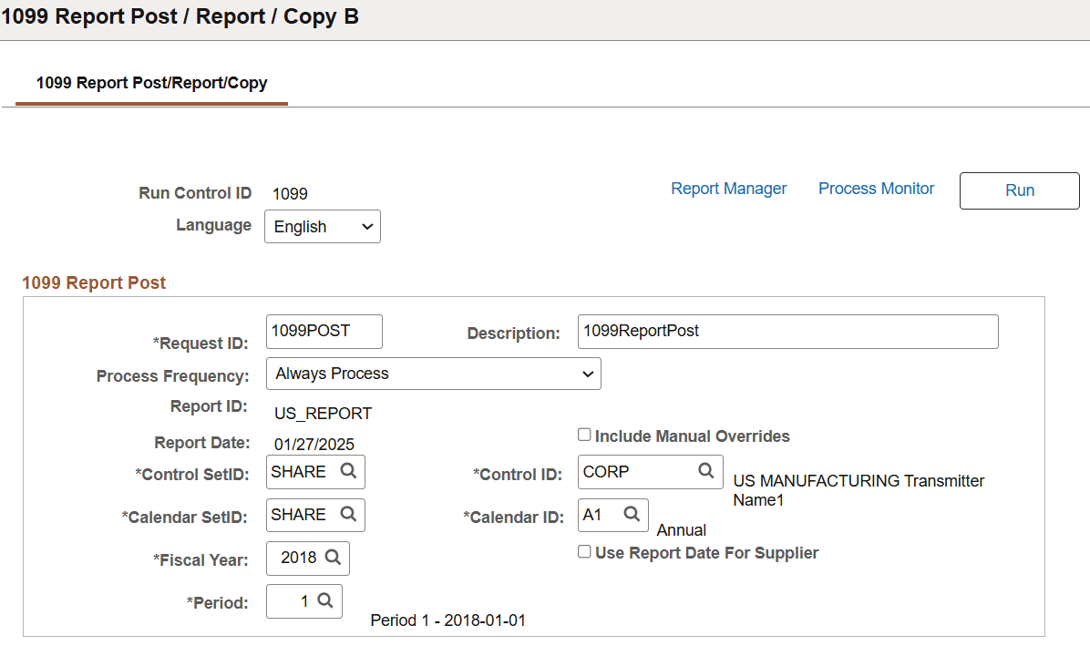

1099 Report Post / Report / Copy B Page
Use the 1099 Report Post / Report / Copy B page (RPT_1099_JOB) to request to run the 1099 Job (AP_1099), that includes the 1099 Report Post Application Engine process (1099_RPT_PST), the 1099 Report Application Engine process (AP_APY1099), and the 1099 Copy B Sort Application Engine process (AP_COPYB_RPT).
You can also select to run these processes individually. In addition, you can select to run the 1099 report forms (1099-MISC, 1099-NEC, 1099-G, and 1099-INT) separately or as part of the same run control request.
Navigation:
Suppliers, and then 1099/Global Withholding, and then 1099 Reports, and then Withhold 1099 Report Job, and then 1099 Report Post / Report / Copy B
This example illustrates the fields and controls on the 1099 Report Post / Report / Copy B page for fiscal years 2019 and earlier (1 of 2). You can find definitions for the fields and controls later on this page.

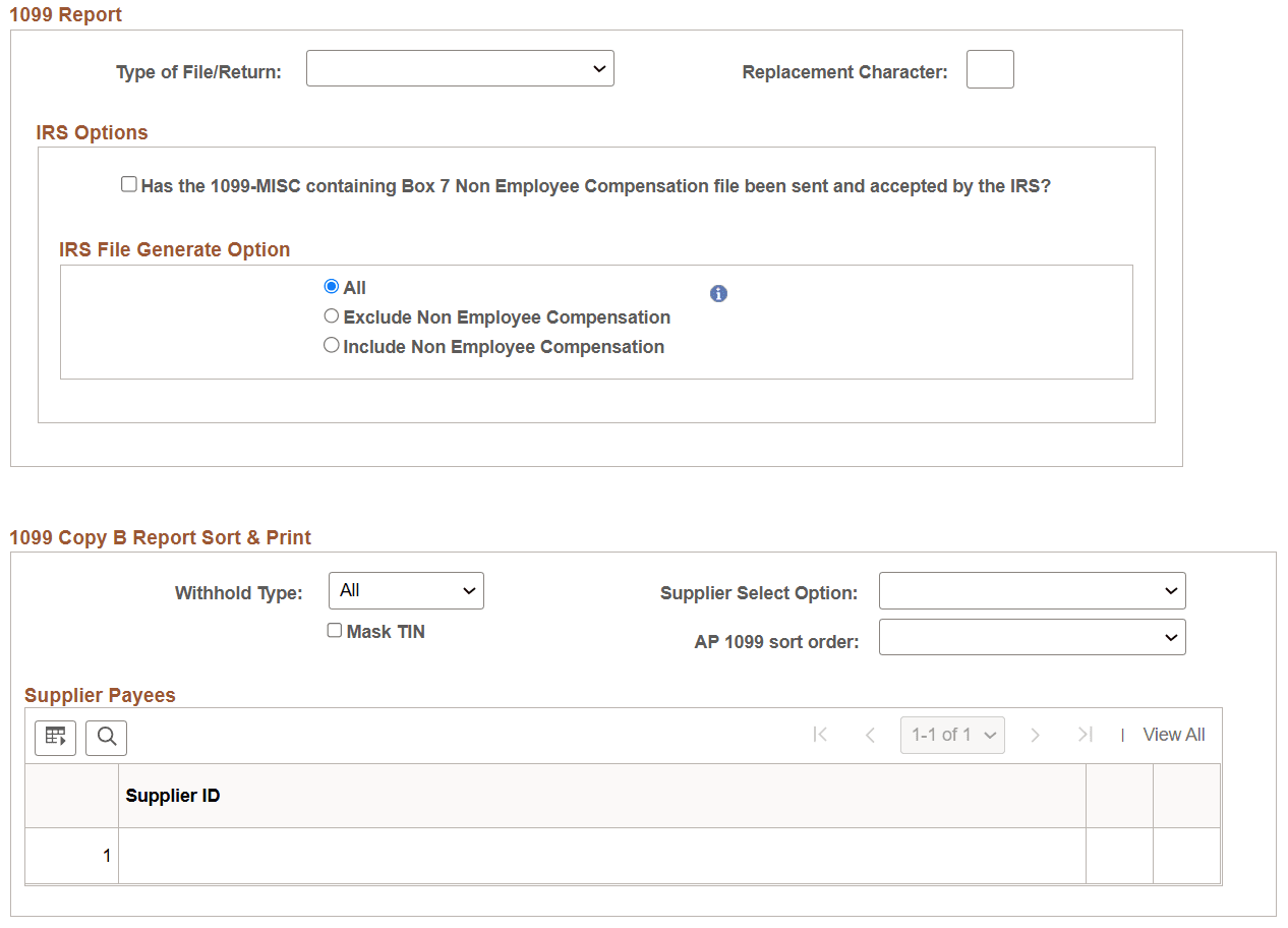

1099 Report Post Report Copy B Page (1 of 2) Before 2019
This example illustrates the fields and controls on the 1099 Report Post / Report / Copy B page for fiscal years 2019 and earlier (2 of 2). You can find definitions for the fields and controls later on this page.
1099 Report Post Report Copy B Page (2 of 2) Before 2019

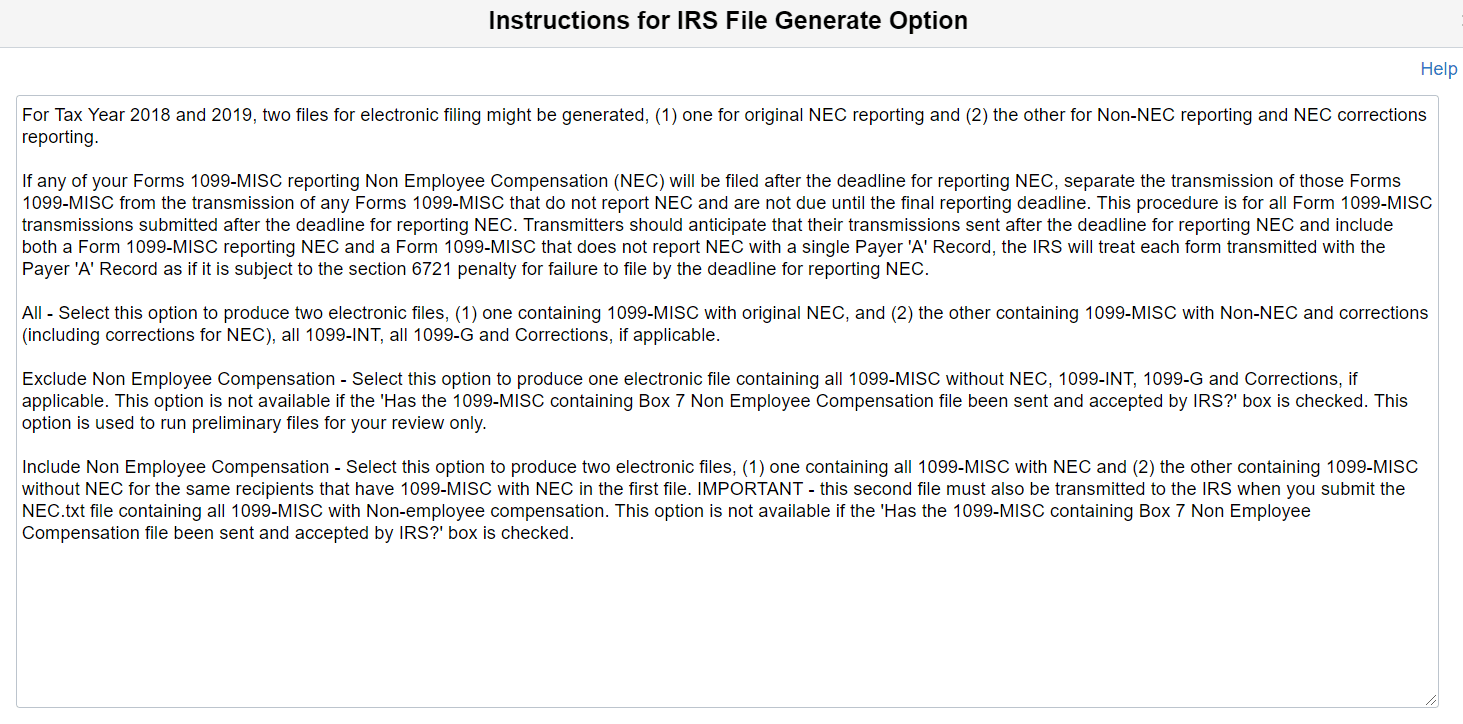

Field or Control Description
Instructions
Click to view the instructions for IRS File Generate Option.
This example illustrates the fields and controls on the Instructions for IRS File Generate Option page.

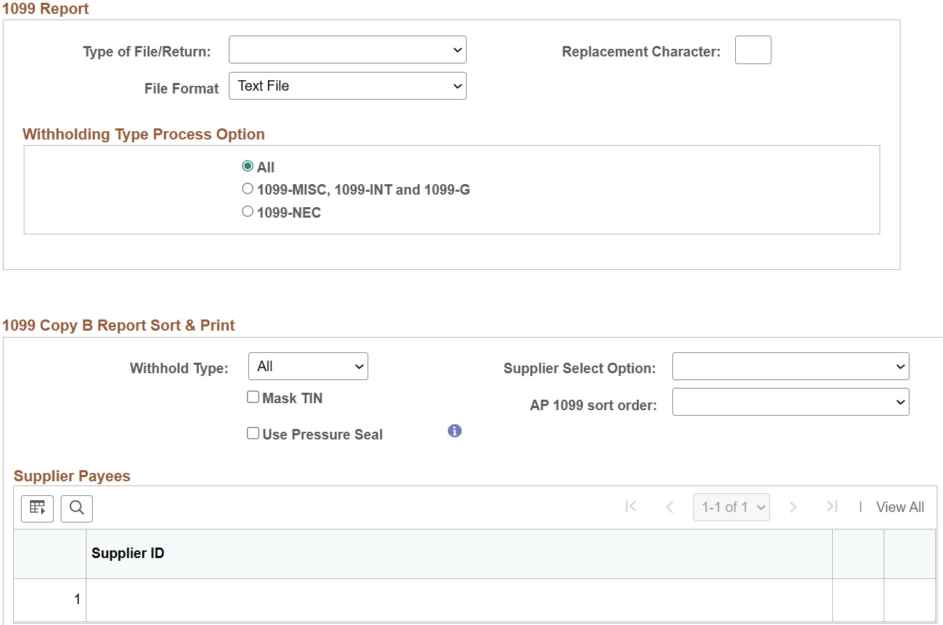

This example illustrates the fields and controls on the 1099 Report Post / Report / Copy B page for fiscal years 2020 and later (1 of 2). You can find definitions for the fields and controls later on this page.
This example illustrates the fields and controls on the 1099 Report Post / Report / Copy B page for fiscal years 2020 and later (2 of 2). You can find definitions for the fields and controls later on this page.
1099ReportPostReportCopyBpage_2020andlater (2 of 2)
The 1099 Report Post / Report / Copy B page is divided into three sections; 1099 Report Post, 1099 Report, and 1099 Copy B Report Sort & Print. Each section corresponds to the three 1099 processes, respectively (1099_RPT_PST, AP_APY1099, and AP_COPYB_RPT).
The 1099 Report Post / Report / Copy B page is for U.S. reporting. The Withhold Reports page is for global reporting. The person who controls security for your PeopleSoft pages defines security for these pages so that your users can access whichever reports are applicable for the company.
1099 Report Post
Parameters common to all three processes are listed in this group box. You must complete these parameters to run the 1099 Job or any of the three 1099 processes.
Report Date
Displays today's date by default.
Include Manual Overrides
Select to include manually adjusted or updated withholding transactions. This is usually selected for 1099 reporting.
Control SetID and Control ID
Select the withholding control SetID and control ID to use to create 1099 reporting.
The system uses the payor data for the specified control ID you entered on the Report Control Information - Payor Data page. This data must match the information the IRS has on file. In particular, the tax ID, transmitter control code, and name data should be the same, since the 1099 Report process pulls the header information for the IRS file from this page.
Calendar SetID and Calendar ID
Select the calendar you want to use. You must create an annual calendar with one period for the entire year to use for 1099 reporting.
Fiscal Year and Period
Enter the fiscal year and period for the calendar you specified. The system uses this information to determine which transactions to include in the posting. It selects all transactions with a payment date in the specified period. For 1099 reporting, the period is defined as a calendar year.
Use Report Date For Supplier
Select this check box to use the date the report is run to get the max effective dated Supplier Address that will be reported on the copy B. If unchecked, then the system will use 12/31/ reporting year.
When you run the 1099 Report Post process, the system extracts the withholding transaction data and populates the Withholding 1099 Report table.
1099 Report
You must complete these parameters to run the 1099 Job or the 1099 Report process. You do not have to complete these parameters if you are running the 1099 Report Post process or the 1099 Copy B Sort process individually.
Type of File/Return
Select the type of the file or return to create. Options include:
Orig/Corr (original or correction): Select if you have not yet sent a file to the IRS or you are sending a correction file after sending an incorrect one.
Replace: Select if the IRS requests a replacement file.
Test: Select if you are sending a test file.
Replacement Character
Enter the character the IRS sends you as a replacement character to include in the file if you need to send a replacement file.
File Format
Select the file format. The available options are: CSV File, XML File and Text File. This field is available only when the Fiscal Year is 2025 or later.
IRS Options
IRS Options section is available only for fiscal year 2019 and prior.
Suppliers that receive non-employee compensation (NEC) must now be paper/electronically reported to the IRS by January 31. IRS Options and IRS File Generate Option provide the capability to ensure that this IRS reporting requirement is met.
Has the 1099-MISC containing Box 7 Non Employee Compensation file been sent and accepted by the IRS?
Select this check box to produce your remaining 1099s. You should have sent the electronic file for the 1099-MISC containing Box 7 NEC to the IRS and ran the Withhold Sent process prior to this.
You can leave this check box deselected while running the process and creating files to verify your various 1099 Suppliers.
Note: If you plan to submit all of the 1099s at one time on or before January 31, do not select this check box.
These options allow you to create the electronic files for 1099-MISC reporting NEC, 1099-MISC that do not report NEC, 1099-INT, 1099-G, as well as corrections, if applicable. The IRS requires that 1099-MISC reporting NEC in Box 7 be filed by the NEC Reporting deadline, while 1099-INT, 1099-G, and 1099-MISC that does not report NEC be filed by the final deadline when filed electronically.
Starting with the 2018 tax year, two electronic files may be produced for 1099-MISC
  1. If you have Supplier(s) with 1099-MISC reporting NEC, these Supplier(s) will be reported in the file with the suffix of NEC.txt
  2. A second file will be created for Supplier(s) containing 1099-MISC that do not report NEC, 1099-G, and 1099-INT. This second file will have a suffix of process instance#.txt
These options are used to produce the appropriate file for the appropriate reporting date.
All: Select this option to produce two electronic 1099-MISC files:
  1. One containing 1099-MISC reporting NEC and
  2. Another containing 1099-MISC that does not report NEC, all 1099-INT, all 1099-G, and corrections, if applicable.
If you are ready to report all of your Suppliers’1099’s on or before January 31, choose this option. This will produce:
  1. One file for all your Suppliers that have 1099-MISC reporting NEC that is required by the IRS deadline of January 31 and
  2. Another file for all your Suppliers that have 1099-MISC that does not report NEC, 1099-INT, 1099-G, and corrections, if applicable.
Exclude Non Employee Compensation: Select this option to produce one electronic file containing all 1099-MISC that does not report NEC, 1099-INT, 1099-G, and corrections, if applicable. This option is not available if the Has the 1099-MISC containing Box 7 Non Employee Compensation file been sent and accepted by the IRS? check box is selected. This option is used to run preliminary files for your review only.
Include Non Employee Compensation: This option is used to meet the IRS NEC Reporting deadline for filing 1099-MISC reporting NEC.
If your Suppliers have amounts in any of the other Boxes along with Box 7 for 1099-MISC, a second file will also be created to report non-NEC data to the IRS.
The second file must also be transmitted to the IRS when you submit the NEC.txt file containing all 1099-MISC reporting NEC.
If you cannot process all of your 1099s in order to meet the January 31 IRS reporting requirement for 1099-MISC reporting NEC, you must first run the 1099 Report process with the Include Non Employee Compensation option.
Starting in 2018, two files may be created, one to report 1099-MISC reporting NEC (filename suffix = “NEC.txt”) and one to report 1099-MISC that does not report NEC (filename suffix = “Process instance#.txt”).
Once these files have been sent to the IRS and the Withholding Sent process has been run, you will need to run the 1099 Report process with the “All” option to produce one file for all of your 1099-MISC that do not report NEC, 1099-INT, 1099-G, and corrections, if applicable. Potentially, a second file may be created for 1099-MISC reporting NEC that were not reported by the January 31st deadline (particularly, newly added 1099-MISC reporting NEC that occurred after January 31) as well as corrections to 1099-MISC reporting NEC if updates were made to those Suppliers that were reported by January 31.

Withholding Type Process Option
Withholding Type Process Option section is available only for fiscal year 2020 and later.
All
Select to produce all original/corrections for all forms supported – 1099-MISC, 1099-NEC, 1099-G, and 1099-INT applicable suppliers.
1099-MISC, 1099-INT and 1099-G
Select to produce all original/corrections for 1099-MISC, 1099-INT, and 1099-G applicable suppliers.
1099-NEC
Select to produce all original/corrections for 1099-NEC applicable suppliers.
You must complete these parameters to run the 1099 Job or the 1099 Copy B Sort process. You do not have to complete these parameters if you are running the 1099 Report Post process or the 1099 Report process individually.
Withhold Type
Select the type of 1099 report you want to generate from:
1099G for 1099-G (government payments) report.
1099I for 1099-I (interest income) report.
1099M for 1099-MISC (miscellaneous) report.
1099N for 1099-NEC (non-employee compensation) report.
All for all supported 1099 reports.
Mask TIN
Select this check box to mask social security numbers on the Copy B report
Use Pressure Seal
Select this check box to print 1099-MISC, 1099-INT, 1099-G, and 1099-NEC forms in the pressure seal format. The check box is available only when the Fiscal Year is 2024 or later.
Supplier Select Option
Select from these options:
Select All: The report runs for all suppliers in the control SetID defined in the 1099 Report Post group box
Specify: The report runs for all suppliers you specify in the Supplier Payees grid at the bottom of the page.
AP 1099 sort order
Select to sort the report by Name, TIN, or Supplier ID.
The following is meant to illustrate the 1099 process for fiscal year 2019 and prior. Starting in fiscal year 2020, form 1099-NEC will be used to report non-employee compensation.
Supplier’s:
  • Supplier A – Box 7 only
  • Supplier B – Box 3 and 7
  • Supplier C – Box 1 only
Include Option
  • NEC file created containing Supplier’s A and B (Box 7)
  • Non-NEC file created containing Supplier B (Box 3)
Exclude Option
Non-NEC file created containing Supplier C (Box 1)
All Option
  • NEC file created containing Suppliers A and B (Box 7)
  • Non-NEC file created containing Supplier B (Box 3) and Supplier C (Box 1)
  • Copy B for A/B/C – Supplier A, Box 7 populated; Supplier B, Box 3 and 7 populated; Supplier C, Box 1 populated.
Once the files have been created using the Include option and transmitted to the IRS and the Withholding Sent Process has been run, only the All option will be available for selection.
In the above illustration, the output would be as follows:
  • One file created for Supplier A, Supplier B and Supplier C if there are any corrections. All corrections will be in the file with the suffix of process-instance#.txt.
Use the 1099 to Send Report page (TO_SEND_RPT) to define run parameters for the 1099 Withholding to Send Detail Report (APY8056).
Use the report to review a summary of the data stored in the withholding detail table (WTHD_TO_SND_DTL). The report lists all the information created by the 1099 reporting process and is a replica of the data in the file you are sending to the IRS. You must complete the 1099 Report process, with the exception of sending the file, for the report to accurately summarize your data.
Navigation:
Suppliers, and then 1099/Global Withholding, and then 1099 Reports, and then 1099 to Send Detail, and then 1099 to Send Report
This example illustrates the fields and controls on the 1099 to Send Report page. You can find definitions for the fields and controls later on this page.
1099 To Send Report page
This report will be blank if you do not run the 1099 Report process first. Also, be aware that the balances on this report may not balance against the information provided in the Supplier Withholding Balances Control Report (APY3012), since the report includes suppliers that have been updated from withholding applicable to non-withholding applicable.
Fiscal Year
Enter the applicable fiscal year.
The IRS Options and the View Report Option must be the same selections that were used on the 1099 Report process.
Starting in fiscal year 2020, the IRS Options section is no longer required due to support for form 1099-NEC. If reporting for fiscal year 2020 and later, the IRS Options section will be hidden. If reporting for fiscal year 2019 and earlier, the IRS Options section will be available.
Withhold Sent Page
Use the Withhold Sent page (WTHD_SENT) to request a run of the Withholding Sent File Application Engine process (WTHD_SENT).
Navigation:
Suppliers, and then 1099/Global Withholding, and then 1099 Reports, and then Withholding Sent File, and then Withhold Sent
This example illustrates the fields and controls on the Withhold Sent page. You can find definitions for the fields and controls later on this page.
Withhold Sent page
You do not need to run this process if you are sending a test file to the IRS. The test file is a viable IRS file, but the information generated for the test does not need to be stored in the online system.
For fiscal year 2025 and later, you can select the file format. The available options are: CSV File, XML File and Text File.
The IRS Options and the Withhold Sent Option selected must be the same options that were used on the 1099 Report process.
It is critical that the options used for the 1099 Report and the Withhold Sent are the same in order to properly identify what Suppliers will generate Corrections in the future.
If you do not use the same options that were used on the 1099 Report process, you may experience unexpected results.

Processing Replacement Files
Once you send a file to the IRS and run the Withholding Sent File process, you are finished with the 1099 reporting process unless the IRS rejects the file because of formatting errors. In that case, the IRS may tell you what is invalid in the file either through contact information you provide or on their internet page, where the file is stored. Make the necessary changes and resubmit the file.
To do this, access the 1099 Report Post / Report / Copy B page, complete the parameters in the 1099 Report Post and the 1099 Report group boxes. In the 1099 Report group box, select Replace in the Type of File/Return field, and enter the replacement character provided to you by the IRS in the Replacement Character field.
Run the 1099 Report Post and the 1099 Report processes. The system generates a new replacement file that you can send to the IRS. You must run the Withholding Sent File process after creating the replacement file.
You can create a replacement file only if one and only one original file was sent to the IRS.
