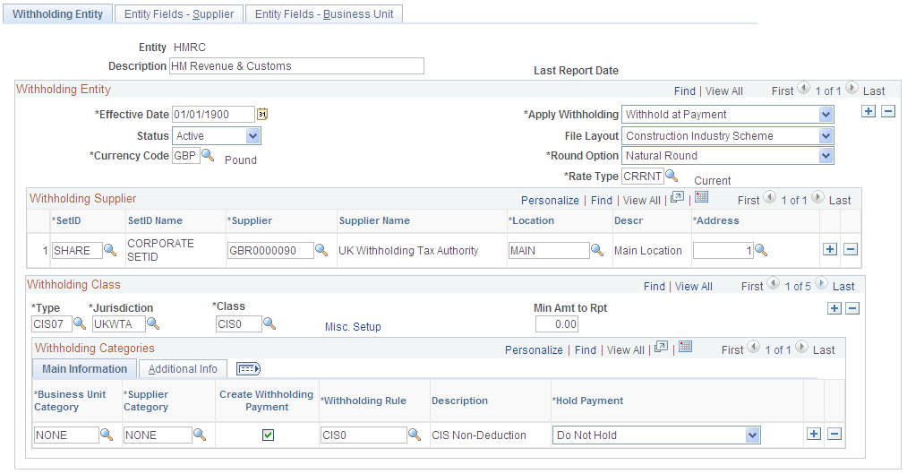

Withholding Entity Page
Use the Withholding Entity page (WTHD_ENTITY) to define the withholding entities (tax authorities).
Navigation:
Set Up Financials/Supply Chain, and then Product Related, and then Procurement Options, and then Withholding, and then Withholding Entities, and then Withholding Entity
This example illustrates the fields and controls on the Withholding Entity page.
The system creates scheduled payments for amounts that are deducted from payments to sub-contractors defined under the withholding entity. These payments must be made to the HM Revenue & Customs within 14 days after the end of the tax month. You must create a supplier that represents the Accounts Office of the HM Revenue & Customs to which these deducted amounts can be remitted. To ensure that scheduled payments are made to the HM Revenue & Customs supplier, you enter the supplier details on the Withholding Entity page.
To ensure that deductions from payments made to CIS Sub-contractors are kept as a separate payment that can be made at the end of the month to the HM Revenue & Customs, select the Create Withholding Payment check box for the CIS4 withholding class. Then, in the Round Option field, select Natural as the rounding option (you must not leave this field blank). Set the Hold Payment field to Wthd Only (withhold only) or No Hold.
Important. You must define at least one entity named HMRC as there is processing tied to the entity.

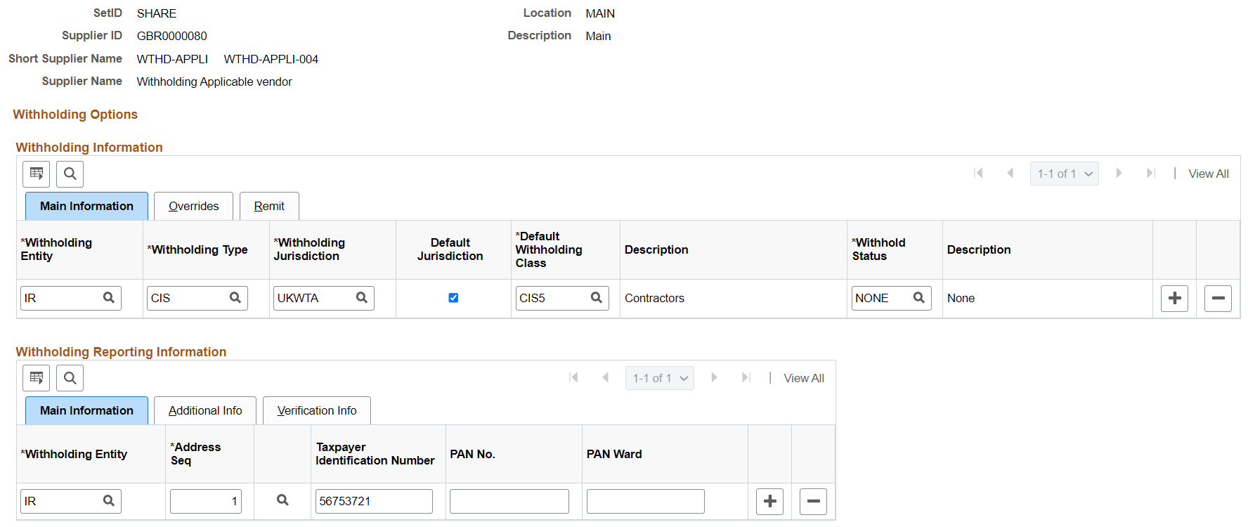

Withholding Supplier Information Page
Use the Withholding Supplier Information page (VNDR_GBL_OPT_SEC) to define withholding control information and reporting information for the supplier location.
Navigation:
Suppliers, and then Supplier Information, and then Add/Update, and then Supplier, and then Location
Click the Global Withholding link on the Supplier Location page.
This example illustrates the fields and controls on the Withholding Supplier Information page. You can find definitions for the fields and controls later on this page.
Withholding Supplier Information UK
Withholding Information
The following fields in this grid have specific requirements for certificate withholding:
Field or Control Description
Withholding Entity
Select the entity to which the withholding amounts are reported.
Withholding Type
Select the type of withholding. For each withholding type, there may be classes and categories associated with the type.
Withholding Jurisdiction
Select the withholding jurisdiction for this type of withholding.
Default Jurisdiction
Select to ensure that the withholding defaults are copied to the invoice.
Default Withholding Class
Select a withholding class that will be used as a default for this supplier location.
Withhold
Select when setting up certificate information or registration card information for the supplier.
Hold Pay Indicator
Accept the default from the control hierarchy, or select Specify to override the default and activate the Hold Payment field.
Hold Payment
Select from these options:
  • Hold All: Hold both the payment and the withholding amount for this supplier.
  • No Hold: Do not hold payments for this supplier.
  • Wthd Only (withhold only): Hold only the withholding amount.
Withhold Rule Indicator
Accept the default from the control hierarchy, or select Specify to override the default and activate the Rule field.
Withholding Rule
Select a withholding rule. The withholding rule describes the actions to be taken during withholding.
Remit Withhold to Flag
Select withholding Entity or Supplier to indicate to whom you remit withholding payments for this supplier location.
Remit Supplier
For a remit to of Supplier, select the supplier to whom you want to remit withholding information.
Withholding Reporting Information
Withholding Entity
Select the entity to which the withholding information is reported. The withholding entity is the body to which withholding is reported. You can define more than one entity for a supplier location.
Address Seq (address sequence)
Select the supplier's address from the addresses defined on the Supplier Information - Address page. The entity needs the supplier's address.
Business Type
Select Corporation or Individual.
Registration/Insurance Number
Enter the registration number if this is a corporation or the insurance number if this is an individual.
Verified
Select this check box if the number provided has been verified.
Verification number
Enter the verification number provided by the HMRC
Verification Date
The system automatically populates this field with the current date when the Verified check box is selected.
Match TIN
Select this check box if you have used the IRS online matching process. If the check box is selected, then the TIN Match Code is set to 0 and the TIN Match status set to Matched.
TIN Match Status
Displays the TIN match status. The various options displayed are New, Pending, Matched, or Error.
TIN Match Code
Displays the match code returned by the IRS (U.S. Internal Revenue Service).
  • 0: TIN and Name match
  • 1: TIN missing or entered incorrectly
  • 2: TIN entered is not currently issued
  • 3: TIN and Name do not match
  • 4: Invalid TIN matching request
  • 5: Duplicate TIN matching request
  • 6: TIN Match found only on SSN (Social Security Number)
  • 7: TIN Match found only on EIN (Employer Identification Number)
  • 8: TIN Match found on both the SSN and EIN
Match Date
Match date is the date the user enters when the file is uploaded. If the TIN was manually matched, the user can enter the match date from the Interactive TIN matching process. The Match date can be entered only if the Match TIN check box is selected.
IRS Tracking Code
The IRS assigns a tracking code to every file the user downloads. If the user enters the tracking code when the file is loaded into PeopleSoft, the supplier/location can be tracked enabling the user to tie the TIN to a bulk file.
Manually Matched
The check box will be selected as default if the matching was done through the online matching process.

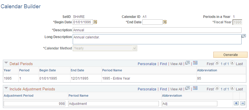

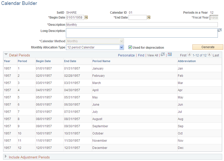

Calendar Builder Page
Use the Calendar Builder page (CALENDAR_BUILDER) to create and maintain tax calendars.
Navigation:
Set Up Financials/Supply Chain, and then Common Definitions, and then Calendars/Schedules, and then Calendar Builder

Monthly Calendar
This is an example of a monthly calendar:
This example illustrates the fields and controls on the Calendar Builder page (monthly calendar).
Annual Calendar
This is an example of an annual calendar:
This example illustrates the fields and controls on the Calendar Builder page (annual calendar).

Generating Payments to HMRC
There are several ways in which you can set up the system to generate the payment to the HMRC. The method you select depends on the volume of CIS transactions and the way in which you run your pay cycle.
Method 1 - Placing HMRC Payments on Hold
With this method, you set up the system to place the HMRC scheduled payments on hold automatically. Within 14 days after the end of the tax month, you take the scheduled payments off hold. Set up a pay cycle that includes scheduled payment dates within the tax period range (for example, from the sixth of the previous month to the fifth of the current month). Then a single payment to the HMRC can be generated for all withheld amounts.
To place the withheld scheduled payments on hold:
  1. Set the Hold option to Wthd Only (withhold only) on the Withholding Entity page for withholdingClasses CIS0, CISS, CISSM, CISI, and CISIM.
  2. Set the Withholding Date option to Payment on the Payment Selection Criteria - Dates page.
    This sets the scheduled due date on the payment so that it is equal to the payment date, making it easier to select only the withheld payments that were made during the tax month.
A variation of this method is to place the HM Revenue & Customs supplier on hold. With this approach, you leave the supplier on hold until just before running a pay cycle that selects HM Revenue & Customs scheduled payments. You take the supplier off hold before running the pay cycle and place the supplier back on hold immediately after the pay cycle completes. To do this, you select the Hold Payments check box on the Additional Payables Options collapsible region on the Supplier Information - Payables Options page.
Method 2 - Using Pay Groups
If the volume of withheld payment is too great to permit resetting the Hold option manually, then you can use Pay Groups. You define one set of pay groups for regular payments and another pay group exclusively for payments that are made to the HM Revenue & Customs. Then you assign the HM Revenue & Customs pay group to your HM Revenue & Customs supplier. When scheduled payments are created for the withheld amount, the system assigns the HM Revenue & Customs pay group to it. When payment to the HM Revenue & Customs is due, you either temporarily include the HM Revenue & Customs pay group in the Payment Selection Criteria component (PYCYCL_DEFN) or create a new pay cycle ID. To prevent the HM Revenue & Customs payments from being selected during the tax month, use different pay groups for all other voucher payments.
Method 3- Using Withholding Class Payment Terms
When defining your withholding entities, you can indicate for every combination of withholding class and withholding categories the payment terms you want to apply to the withheld payment. For example, knowing that you need to pay within 14 days after the end of the tax month, which ends on the 5th of the calendar month, you would create a payment term (Single Payment) that contains two split terms. The first term would say that for any payment falling between the 1st and the 5th of the calendar month, the payment ID would be Same month, on the 15th. The second term would indicate that between the 6th and the end of the calendar month, the scheduled date should be Next month, on the 15th. That way, all withheld amounts that need to be paid to the HM Revenue & Customs will be scheduled to be paid on the 15th, allowing you to run your pay cycle before the due date of the 19th of the calendar month.
