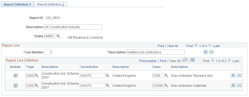

Report Definition 1 Page
Use the Report Definition 1 page (WTHD_RPT_DFN) to specify selection criteria for withholding reports.
Define the layout of the withholding reports based on your tax authority's reporting and filing requirements.
Navigation:
Set Up Financials/Supply Chain, and then Product Related, and then Procurement Options, and then Withholding, and then Report Definition, and then Report Definition 1
This example illustrates the fields and controls on the Report Definition 1 page. You can find definitions for the fields and controls later on this page.
Each report line is generally equivalent to a "box" on the withholding entity's withholding form. Enter a line for each withholding class combination you report separately on the report.
Field or Control Description
Include
Select this check box at the beginning of the line for each withholding class combination you are including in the report.
