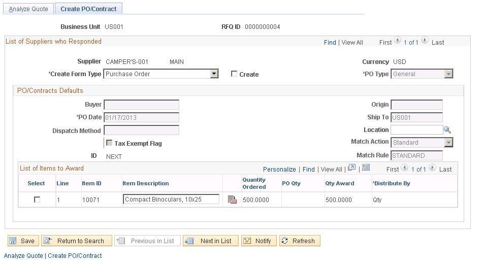

Create PO/Contract (create purchase order/contract) Page
Use the Create PO/Contract (create purchase order/contract) page (RFQ_GEN_PO) to view the awarded vendors of a specified RFQ and create a purchase order or contract based on the supplier and line item response.

This example illustrates the fields and controls on the Create PO/Contract page. You can find definitions for the fields and controls later on this page.
List of Suppliers who Responded
Field or Control Description
Create Form Type
Select a value to create a purchase order or a contract for the lines awarded to a supplier. Values are:
Contracts RFQ/Resp. Currency (contracts RFQ and response currency): Select to create a contract in the response currency and to have an entry in the UOM/Pricing table on the contract for each currency. With this feature, you can select the default price and currency to be used on the contract releases and ultimately the purchase order.
Contracts Response Currency: Select to create a contract in the response currency. The entry in the UOM/Pricing table on the contract appears in the response currency.
Purchase Order: Select to create a purchase order in the response currency.
Note: If the requisition associated with the RFQ has pegging information then you cannot create a contract from the RFQ. For example, if the requisition associated with the RFQ has PeopleSoft Maintenance Management work order information you will not be able to create a contract from the RFQ only a purchase order. The purchase order will contain the pegging information associated with the requisition.
Create
Select this check box to create the contract or purchase order.
PO Type (purchase order type)
Select a purchase order type:
General: Designates a general purchase order.
Kanban: Designates a Kanban purchase order.
PO/Contracts Defaults
Dispatch Method
Select a dispatch method for either the purchase order or contract.
Tax Exempt Flag
Designates whether the purchase order is exempt from sales and use taxes.
Exempt ID
If the Tax Exempt Flag check box is selected, the tax exempt ID appears by default from the business unit if it is set up with tax exempt status. The tax exempt ID prints on the purchase order.
ID
Indicates the ID of the purchase order or contract to be created. If you have autonumbering enabled, the field value is NEXT, and the ID is automatically generated by the system.
Origin
Displays the origin of the purchase order or contract. Origin codes are established on the Origin Codes page and help identify the origins of the transactions.
Ship To
Displays the ship to information defined on the User Preferences - Procurement: Request for Quote Process page. Ship to information assigned to purchase orders usually appears by default from the ship to value entered on the Request Quotes page and the Enter Responses - Maintain Responses page. The ship to address designated on the Maintain Responses page overrides the ship to defined on the Request Quotes page. However, if the ship to value is empty on the Maintain Responses page upon purchase order creation, this ship to value is used.
Location
Displays the user location defined on the User Preferences - Procurement page. Location information assigned to purchase orders usually appears by default from the location value entered on the Request Quotes page.
Match Action
Appears by default from the supplier. If it is not defined there, the value appears by default from the business unit. Values are:
No Match: No match is required.
Standard: Composed of two-way, three-way, and four-way matching, or any matching rules that you have defined.
Match Rule
Select a match rule. Match rules are defined on the Match Rules page and activated on the Match Rule Control page.
List of Items to Award
Use the RFQ Lines group box to select lines that you want to use to create the purchase order or contract.
Distribute by
Select the method by which you want to allocate or charge the expense account distribution. Select Amt (amount) or Qty (quantity). Inventory items cannot be distributed by amount; you must distribute inventory items by quantity.
