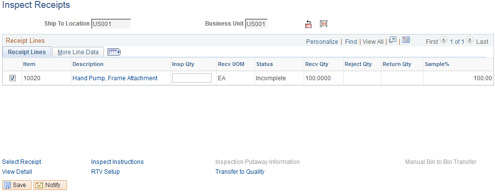

Inspection Page
Use the Inspection page (RECV_INSPECT) to put receipt line items through the inspection process.
The Inspection Required check box must be selected for the item on the receipt line.
Navigation:
Purchasing, and then Receipts, and then Inspect Receipts, and then Select Receipt
Enter search criteria on the Select Receipt page and click the Search button.
Click the Sel check box next to a receipt line and click the OK button.
This example illustrates the fields and controls on the Inspect Receipts page. You can find definitions for the fields and controls later on this page.
Field or Control Description
RTV Create
Click the RTV Create button to create an RTV transaction, and update the Return Qty field with RTV data that you entered on the RTV Setup page. The RTV transaction is now accessible on the Return to Vendor - RTV page, where you can view and modify detailed information for the RTV transaction.
Automatic Bin to Bin Transfer
Click the Automatic Bin to Bin Transfer button to move items from their inspection locations to their putaway locations. The transaction to move items from inspection to putaway locations is written to the electronic data collection log files, where it is picked up by a background process, enabling the move to be completed automatically. This function is available only if you are using an electronic data collection batch update process. The Auto Bin to Bin check box on the Inspection & Putaway Information page is selected for items that are available for use with this function.
Receipt Lines
Select the Receipt Lines tab.
Insp Qty (inspected quantity)
Enter the quantity of items inspected.
Status
The status of the inspection process appears. Values are Complete and Incomplete.
When the quantity inspected for the receipt line is equal to or greater than the Sample% of the receipt quantity (Recv Qty) the status is set to Complete. Otherwise, the status is set to Incomplete.
More Line Data
Select the More Line Data tab.
IN Unit (inventory business unit)
Displays the inventory business unit. If the item is an inventory item, this is the inventory business unit associated with the item. If the receipt line is targeted for Manufacturing (subcontract), this is the inventory business unit associated with the production ID and operation sequence displayed.
Production ID
If the item is associated with a PeopleSoft Manufacturing production kit, this field displays the item associated production ID.
Operation Sequence
Displays the number designating the order in which this material is used in the production sequence.
INV Stat (inventory status)
Designates if the receipt line item is an inventory item, along with its status. Values are:
  • Moved: Indicates that the receipt line has interacted with PeopleSoft Inventory.
  • N/A (not applicable).
  • Pending: Indicates that the receipt line has been staged and is pending interaction with PeopleSoft Inventory.
AM Status
Displays the asset information review status – Pending or Moved. This link is displayed only if the asset details are specified on the Distribution for Schedule page at the time of purchase order creation.
Click the Pending link of a receipt line to access the Maintain Asset Receipt Details page, where you can enter asset details for the selected receipt line. If you access the Maintain Asset Receipt Details page using the AM Status link, the Interface Receipt check box and the Interface Asset Information link are hidden.
For more information, see Maintain Receipt Asset Details Page.
Note: If you navigate to the Maintain Asset Receipt Details page without saving your modifications, an error message displays indicating that there are unsaved changes and you must save them.
Transfer to Quality
Click to create a quality data entry session and transfer to the PeopleSoft Quality Data Entry - Subgroup Method page or Data Entry - Sample Method page, depending on the data entry method that you specified when you created the quality control plan. Use this page to pass applicable receipt items on to PeopleSoft Quality for in-depth inspection.
Prior to transferring to PeopleSoft Quality, the receipt inspection function updates the hierarchy and trace field values that are passed to PeopleSoft Quality, as well as the inspection quantity, which is passed on to Quality as SGRP size. The inspection quantity to be passed on to PeopleSoft Quality is determined by multiplying the receipt quantity for the line by the sample inspection percent for the item, less the current inspection quantity.
Upon returning to receipt inspection on the Inspection page, if the SGRP size was updated by PeopleSoft Quality, it is retrieved and added to the current inspection quantity field value. If the inspection quantity is large enough to satisfy the inspection sample percent for the item, the inspection status is set to Complete.
Upon returning to receipt inspection on the Inspection page, if the PeopleSoft Quality fail count is greater than zero, the count is moved to the receipt inspection's return quantity. The reject action is set to Replacement and the reject reason is set to Failed Inspection by default.
Note: If the reject reason of Failed Inspection is not set up for the SetID, the system will issue an error message at save time. To correct this error situation access the RTV Setup page for the line and correct the error.
At save time, you have the option to generate an RTV transaction automatically for the returned quantity.

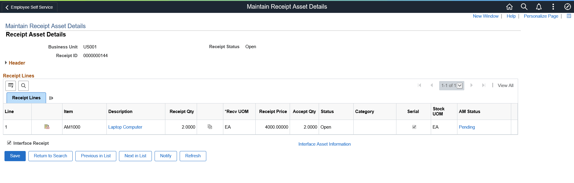

Use the Maintain Receipt Asset Details page (RECV_WPO) to view or update the asset-related information in a receipt. The page displays all the receipts, which contain asset information.
Navigation:
Purchasing, and then Receipts, and then Maintain Receipt Asset Details
Or
Click the AM Status link from the Inspection page.
This example illustrates the fields and controls on the Maintain Receipt Asset Details page. You can find definitions for the fields and controls later on this page.
AM Status link
Displays the status of the item data in relation to PeopleSoft Asset Management.
Values are:
  • Pending - Indicates that the receipt line is asset-related and is pending interface with PeopleSoft Asset Management. Click the link to access the Asset Management Information for Line page where asset information can be recorded.
    For more information, see Asset Management Information for Line Page.
  • Moved - Indicates that the receipt line has been interfaced to PeopleSoft Asset Management.
If the receipt line is not asset-related, this field does not display.
Interface Receipt
Select this check box to automate the passing of asset information through the receiving process.
If you access the Maintain Receipt Asset Details page from the inspection page, this check box does not display.
Click this link to access the Pre-AM1 page, where you can preview and correct data that is being sent to PeopleSoft Asset Management.
If you access the Maintain Receipt Asset Details page from the inspection page, this link does not display.

Use the RTV Setup page (RECV_INSPECT_RTV) to enter RTV details for inspected items.
This information is used to generate an RTV transaction automatically.
Navigation:
Click the RTV Setup link on the Inspection page.
You cannot create an RTV transaction for a receipt that has inventory or asset management interface requirements until it has a moved status.
When you enter RTV information on this page, you must create your RTV before saving your inspection transaction on the Inspection page. To create an RTV, click the RTV Create button on the Inspection page.
If you do not create your RTV before saving your inspection transaction, the system prompts you to create the RTV. Select Yes to create the RTV automatically and return to the Inspection page. The Return Qty field on the Inspection page is now populated with the RTV quantity.
If you select No, the system returns you to the Inspection page to enable you to modify your RTV information. RTV data that you enter is lost if you do not create the RTV before exiting the Inspection page.
Vndr Returned Qty (supplier returned quantity)
Displays the quantity returned based on the UOM assigned to the item by the supplier.
Std Returned Qty (standard returned quantity)
Displays the quantity returned based on the standard UOM for the item.
Vndr UOM (supplier unit of measurement)
Displays the UOM assigned to the item by the supplier.
Std UOM (standard unit of measurement)
Displays the UOM assigned to the item that reflects the most common unit of management for the item.
Reason Code
Select a reason for returning the product to the supplier. These values are defined on the Reason Codes page.
Rej Action (rejection action)
Select one of the following return action values for the rejected item:
  • C (return for credit): You return the items to the supplier and do not request replacement of these returned goods.
  • R (return for replacement): The supplier ships replacement goods, and you receive them against the original purchase order.
