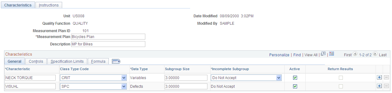

Measurement Plans - Characteristics Page
Use the Measurement Plans - Characteristics page (QS_MFDS_PLAN) to create and edit measurement plan characteristics.
Define a group of characteristics for analyzing quality data. Specify the unit of measure, specification, acceptance limits, and the control procedures and charts for monitoring the characteristics. Define formulas to calculate sample values for characteristics that cannot be measured directly.
Navigation:
Quality, and then Establish Control Plans, and then Measurement Plans, and then Characteristics
This example illustrates the fields and controls on the Measurement Plans - Characteristics page: General tab. You can find definitions for the fields and controls later on this page.
Do not use special characters, such as dashes and percent signs, in characteristic names.

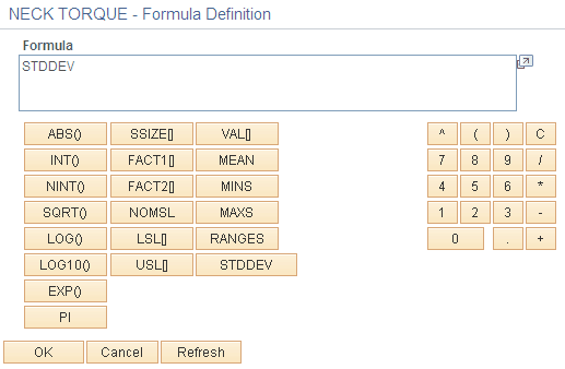

Formula Definition Page
Use the Formula Definition page (QS_MFDS_CALC_PNL) to create or edit characteristic formulas.
Navigation:
Click the Enter Formula button on the Formula tab of the Measurement Plans - Characteristics page.
This example illustrates the fields and controls on the Formula Definition page. You can find definitions for the fields and controls later on this page.
Equation component buttons are grouped according to these types of functions (from left to right):
  • Basic or standard mathematical functions.
  • Configuration parameters.
  • Simple statistics.
  • Sample value.
You can define a characteristic formula by entering values in the Formula field or by:
  • Clicking an equation component button.
  • Using the keypad area to insert numbers, mathematical operators, parentheses, and decimal points.
