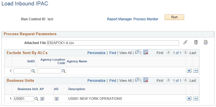

Load Inbound IPAC Page
Use the Load Inbound IPAC page (INTFC_IPAC_RQST) to load the IPAC .csv file into the IPAC staging tables using the Load Inbound IPAC Application Engine process (AP_INIPAC).
Navigation:
Accounts Receivable, and then Receivables Maintenance, and then Load Inbound IPAC, and then Load Inbound IPAC
This example illustrates the fields and controls on the Load Inbound IPAC page for Receivables. You can find definitions for the fields and controls later on this page.
Field or Control Description
Exclude Sent By ALCs grid
Enter a SetID and ALC that you want to exclude from the Load Inbound IPAC processing. Select the ALC from a list of all ALCs that belong to your company, the receiving agency running the Load Inbound IPAC process. The process compares the ALCs in this grid to the originating ALC on the incoming IPAC record. If there is a match, the IPAC record is ignored. An IPAC record is not ignored when the agency manually enters IPAC transactions into IPAC and wants to use the PeopleSoft Inbound IPAC interface to record the transactions by leaving the Exclude Sent By ALCs fields blank.
Business Units grid
Enter a business unit and select a check box to indicate the business unit is an AP business unit, an AR business unit, or both. The prompt for the Business Unit field shows all AP and AR business units. These business units are used by the defaulting logic in the Load Inbound IPAC process to narrow down the search when querying AP for previously entered vouchers and AR for previously entered items. The AP and AR check boxes indicate the Business Unit is an AP business unit, an AR business unit, or both.

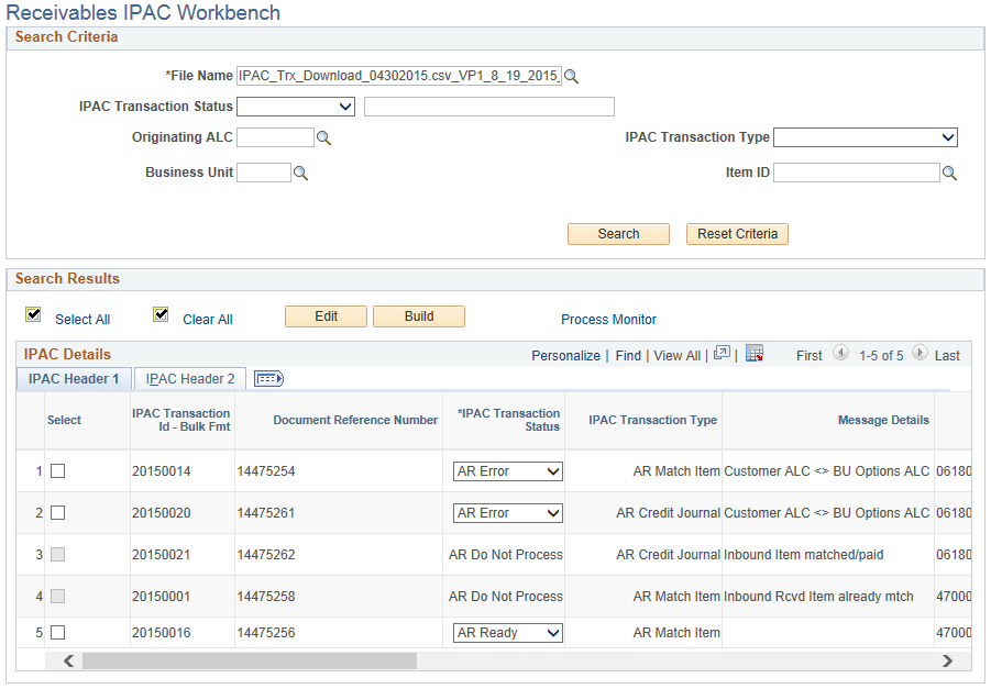

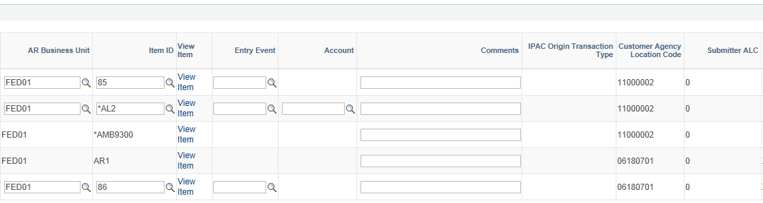

Receivables IPAC Workbench Page
Use the Receivables IPAC Workbench page (AR_INIPAC_WB) to review, correct, and process collection and adjustment transactions for Receivables.
Navigation:
Accounts Receivable, and then Receivables Maintenance, and then Receivables IPAC Workbench, and then Receivables IPAC Workbench
This example illustrates the fields and controls on the Receivables IPAC Workbench page, showing the search results for the specified file. You can find definitions for the fields and controls later on this page.
Search Results on the Receivables IPAC Workbench page
This example illustrates the fields and controls on the Receivables IPAC Workbench page – IPAC Details grid. You can find definitions for the fields and controls later on this page.
Receivables IPAC Workbench page - IPAC Details (1 of 3)
This example illustrates the fields and controls on the Receivables IPAC Workbench page – IPAC Details grid (continued). You can find definitions for the fields and controls later on this page.
Receivables IPAC Workbench page - IPAC Details (2 of 3)
Receivables IPAC Workbench page - IPAC Details (3 of 3)

Header Search Fields
File Name
(Required) Enter the IPAC file name.
IPAC Transaction Status
Select the staging line status. You can search the status field by these operators: contains and = (equals).
Valid values are:
  • AR Do Not Process
  • AR Error
  • AR in Process
  • AR Processed
  • AR Ready
  • AR Review
Originating ALC
Enter the originating ALC.
Business Unit
Enter the AR business unit. This field allows you to search for IPAC records that have already been matched.
IPAC Transaction Type
Select the IPAC transaction type. Valid values are:
  • AR Match Item – The build process creates a payment for the item and IPAC collection transactions.
  • AR Credit Journal – The build process creates a credit direct journal and IPAC adjustment transactions.
  • AR Outbound Item Mtch
  • AR Outbound Adjustment
Item ID
Enter an item ID. The Load process matched to this item. You can search by this field to verify that the processing matched to a specific entered item.
Search
Click the Search button to retrieve IPAC transactions in the staging tables using the search criteria specified.
Reset Criteria
Clears the entered search criteria from the search fields.

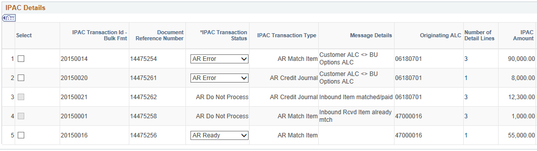

IPAC Details Grid
Select
Select IPAC transactions in the grid by row. This check box is enabled only for transactions with a status of AR Ready, AR Error, or AR Review.
IPAC Transaction Id – Blk Fmt (IPAC transaction ID – bulk format)
Displays the IPAC transaction ID.
Document Reference Number
Displays the IPAC Document Reference Number from the IPAC file.
Displays the current status of the IPAC header.
Valid values are:
  • AR Do Not Process
  • AR Error – You can change this status to AR Ready or Manager Error.
  • AR in Process
  • AR Processed
  • AR Ready – You can change this status to Manager Error.
  • AR Review – You can change this status to AR Ready or Manager Error.
Displays the interpreted transaction type calculated by the Load Inbound IPAC process: AR Match Item or AR Credit Journal.
Message Details
Displays any error messages generated during the Load Inbound IPAC Process.
Originating ALC
Displays the IPAC Originating ALC from the IPAC file.

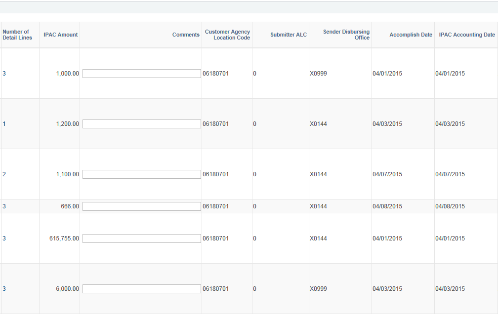

Number of Detail Lines
Click this link to display the IPAC Line Details page (AR_IPAC_WB_DTL_SEC). The link shows the number of lines in the invoice.
IPAC Amount
Displays the IPAC Header Dollar Amount from the IPAC file.
AR Business Unit
Displays the defaulted AR Business Unit. You can update this field if the status of the IPAC record is AR Ready, AR Error, or AR Review.
Item ID
Displays the defaulted Item ID. You can update this field if the status of the IPAC record is AR Ready, AR Error, or AR Review. You must first enter an AR Business Unit.
View Item
Click this link to access the View/Update Item Details page.
Entry Event
Displays the defaulted entry event. You can update this field if the status of the IPAC record is AR Ready, AR Error, or AR Review. You must first enter an AR Business Unit.
Account
Enter the default revenue account that is used when creating credit direct journals using the Build button. This field is required if the transaction type is AR Credit Journal.
Comments
Enter up to 60 characters of text in this field to communicate with managers or make any notes. This field is not used for reporting and is not carried forward to the created PeopleSoft AR transactions.

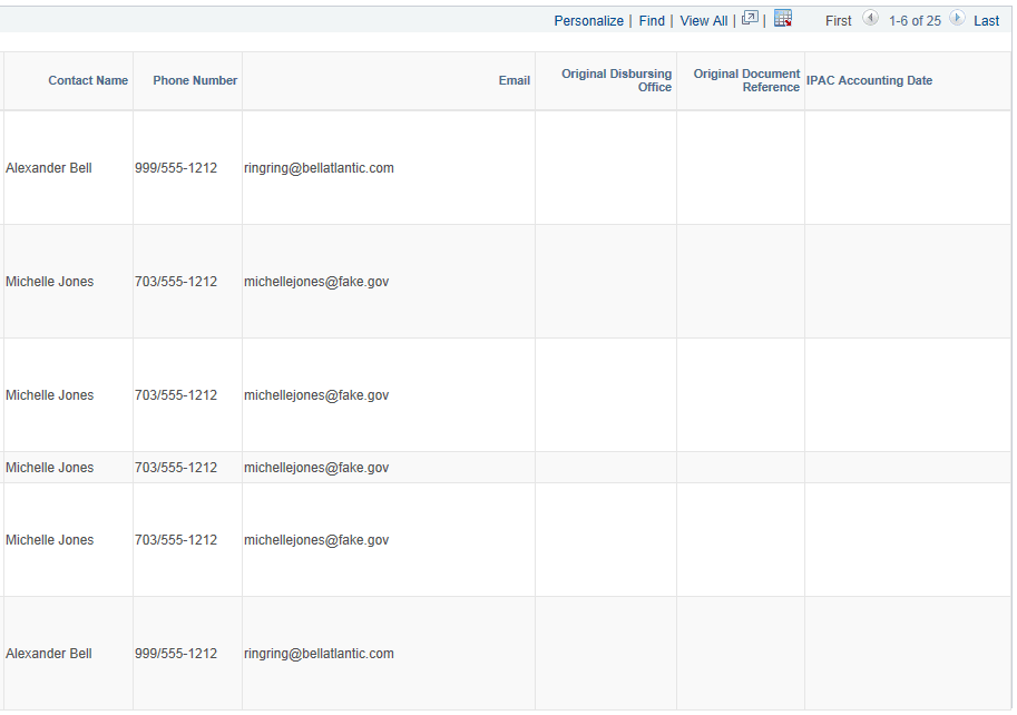

IPAC Origin Transaction Type
Displays the IPAC Origin Transaction Type from the IPAC file.
Customer Agency Location Code
Displays the recipient of an IPAC transaction or receiver agency from the IPAC file.

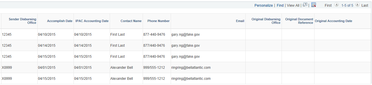

Submitter ALC
Displays the submitting agency from the IPAC file. This field is optional.
Sender Disbursing Office
Displays the sender’s disbursing office symbol that is associated with the Customer ALC from the IPAC file.
Accomplish Date
Displays the date that an IPAC transaction was successfully processed by the IPAC System.
IPAC Accounting Date
Displays the IPAC accounting date.
Contact Name, Phone Number, and Email
Displays the contact information from the IPAC file.
Original Disbursing Office
Displays the original disbursing office when the IPAC transaction is an adjustment.
Original Document Reference
Displays the original document reference number from the IPAC file when the IPAC transaction is an adjustment.
Original Accounting Date
Displays the accounting date from the original IPAC transaction when the IPAC transaction is an adjustment.

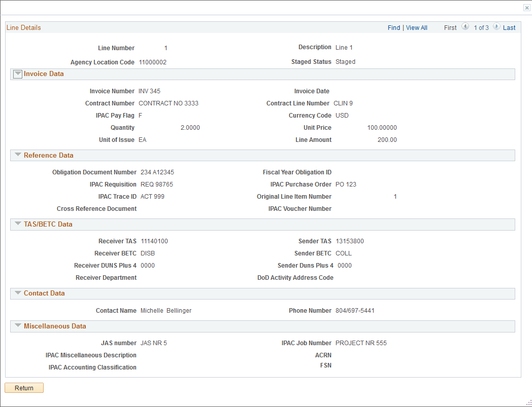

Line Details Page
Use the Line Details page (AR_IPAC_WB_DTL_SEC) to view fields from the IPAC detail staging table. This page is read-only.
Navigation:
Click the link in the Number of Detail Lines column on the IPAC Workbench page.
This example illustrates the fields and controls on the Line Details page.

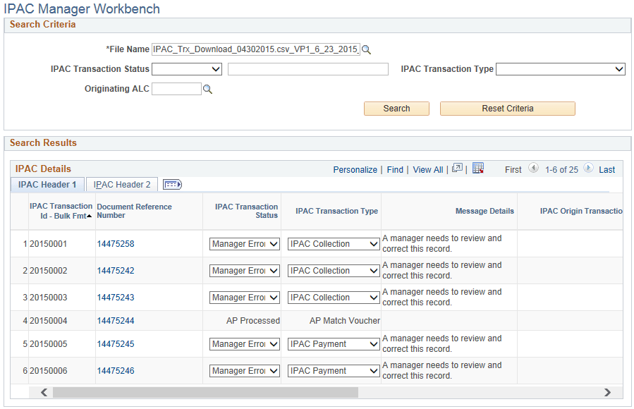

IPAC Manager Workbench Page
Use the IPAC Manager Workbench page (IPAC_MANAGER_WB) to review and classify transactions as either AP or AR.
Navigation:
Accounts Receivable, and then Receivables Maintenance, and then IPAC Manager Workbench
This example illustrates the fields and controls on the IPAC Manager Workbench page, showing the search results for the specified file. You can find definitions for the fields and controls under the Receivables IPAC Workbench page.
Search Results on the IPAC Manager Workbench page
This example illustrates the fields and controls on the IPAC Manager Workbench page, showing IPAC Details for the selected file. You can find definitions for the fields and controls under the Receivables IPAC Workbench page.

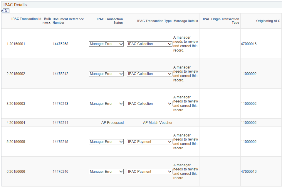

IPAC Manager Workbench page - IPAC Details (1 of 3)
This example illustrates the fields and controls on the IPAC Manager Workbench page, showing IPAC Details (continued) for the selected file. You can find definitions for the fields and controls under the Receivables IPAC Workbench page.
IPAC Manager Workbench page - IPAC Details (2 of 3)
IPAC Manager Workbench page - IPAC Details (3 of 3)
All transaction statuses for both Payables and Receivables are visible on the IPAC Manager Workbench. If the matching process is not able to determine whether the transaction is AP or AR, the status is set to Manager Error. The manager uses the IPAC Manager Workbench to review the record. The manager performs research to determine that the record should be assigned to AP or AR, updates the status to AP Review or AR Review, and sets the transaction type to the appropriate type. The manager can also enter a note in the Comments field.
Click the document reference link to transfer to the Receivables IPAC Workbench or the AP IPAC Workbench based on the transaction status.
The rest of the fields on the IPAC Manager Workbench are the same as those on the Receivables IPAC Workbench. For field definitions, see documentation for the Receivables IPAC Workbench Page.
