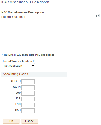

IPAC Miscellaneous Description Page
AR_IPAC_MISC_SEC
Enter additional text to describe an IPAC transaction and additional sender and receiver information.

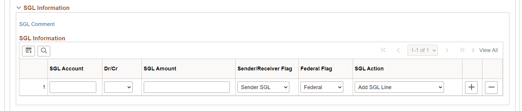

Post SGL Comments Page
AR_IPAC_SGLCMT_SBP
Enter standard general ledger comments.
See the Receivable IPAC Transactions Page.

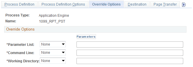

Override Options Page
PRCSDEFNOVRD
Enter override options for the Format EFT File process.
See Entering Override Options for the Format EFT File Process.
See the Override Options Page for more information.

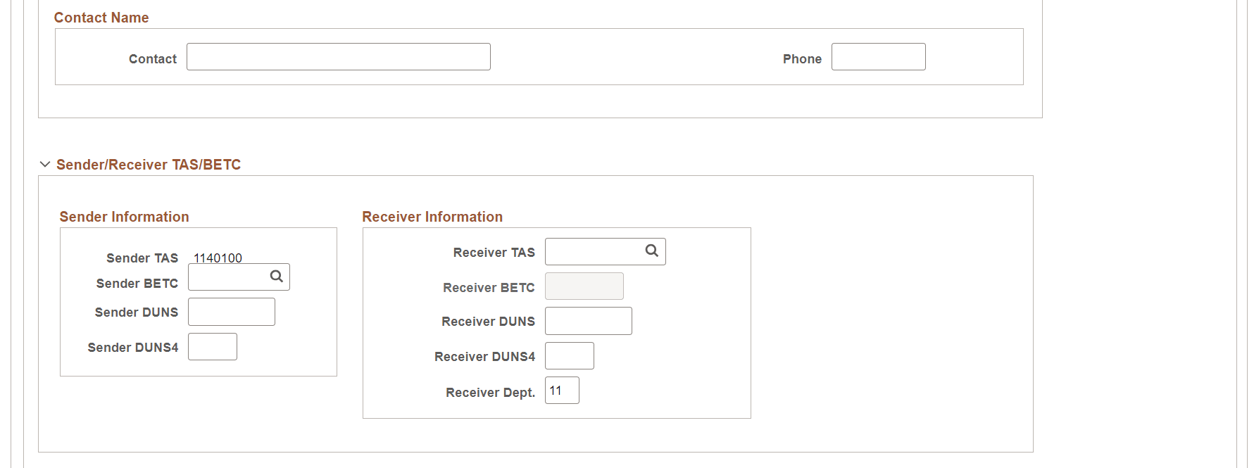

Understanding TAS and BETC in Receivables IPAC Transactions
PeopleSoft Receivables defaults TAS and BETC values as shown in the tables here on both the Receivable IPAC Transactions page and in the AR Posting program for items from an external billing system. The TAS and BETC fields must be set up on the Treasury Account Symbol Definition page and Business Event Type Code page for IPAC transaction processing. The Receivables Update multiprocess job (ARUPDATE) sets the AR_ERROR_CD field value to ISTAS, IRTAS, ISBET, or IRBET when required TAS or BETC values are missing. The payment group is marked in error and the message appears in the message log.
Agency Location Code GWA Type Consider Fund Code? TAS Format 27th column TAS Field
Sender ALC
GWA Reporter
Yes
GWA TAS
‘C’
Required
Sender ALC
Non-GWA Reporter
Yes
String TAS
Optional
Receiver ALC
GWA Reporter
No
GWA TAS
‘C’
Required
Receiver ALC
Non-GWA Reporter
No
String TAS
Optional
Agency Location Code GWA Type BETC Field BETC Defaulting Logic
Number of BETC codes <=4 Number of BETC codes > 4
Sender ALC
GWA Reporter
Required
Yes – default BETC
No Defaulting. User has to manually select the BETC code.
Sender ALC
Non-GWA Reporter
Optional
No
No.
Receiver ALC
GWA Reporter
Required
Yes – default BETC
Receiver ALC
Non-GWA Reporter
Optional
No
No
For the Receiver TAS/BETC, there will be no edit in the AR Posting program to validate that the field is required for external items. There will only be an edit to validate the setup of the Receiver TAS/BETC on the definition pages. This is because external billing systems do not populate IPAC data on the records being sent to Receivables.

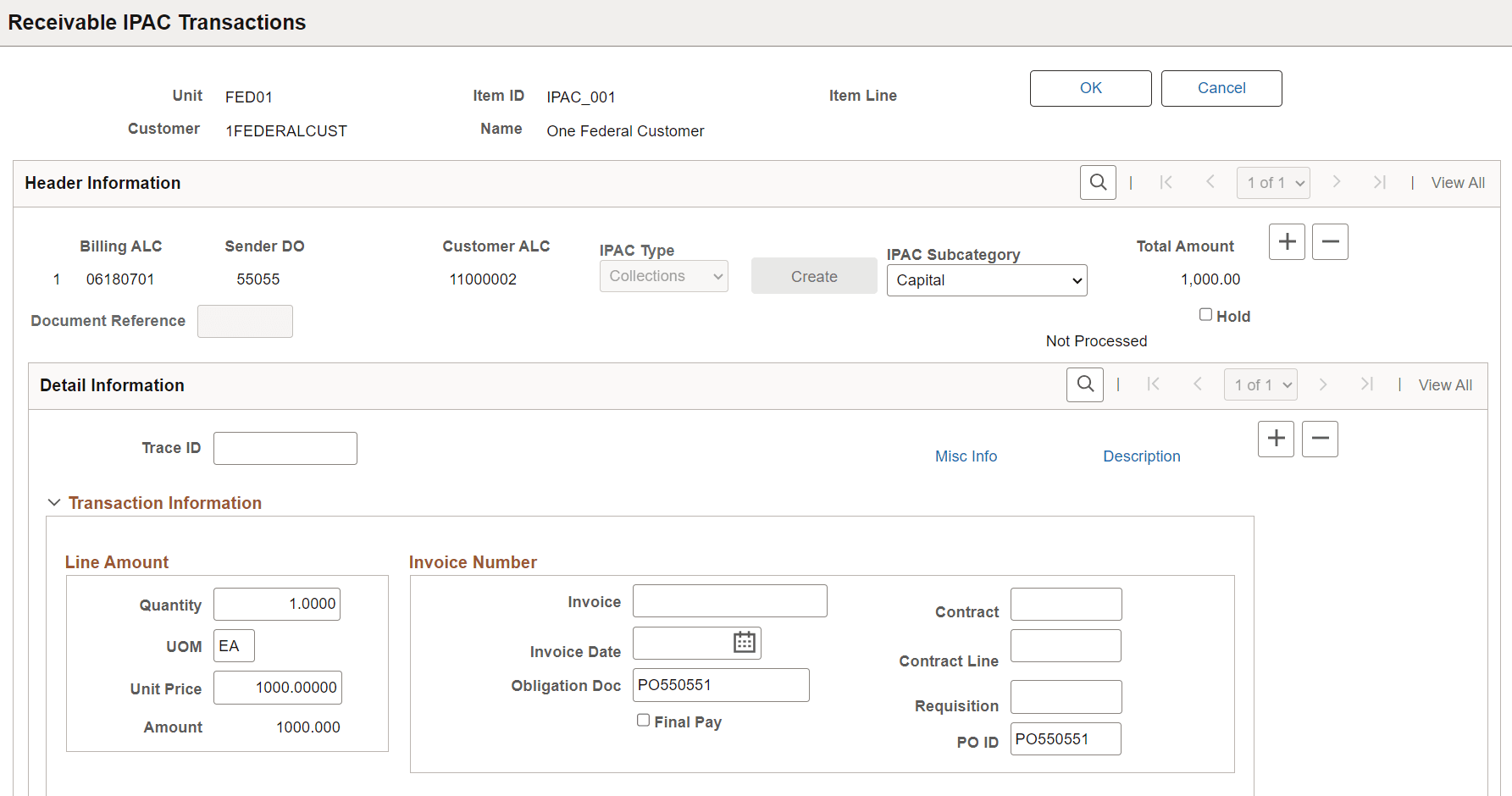

Use the Receivable IPAC Transactions page (AR_IPAC_SEC) to enter information required by IPAC.
Navigation:
Accounts Receivable, and then Customer Accounts, and then Item Information, and then View/Update Item Details, and then Detail 1
Click the Transfer to IPAC Transactions link on the View/Update Item Details - Detail 1 page.
This example illustrates the fields and controls on the Receivable IPAC Transactions page (1 of 3). You can find definitions for the fields and controls later on this page.
This example illustrates the fields and controls on the Receivable IPAC Transactions page (2 of 3). You can find definitions for the fields and controls later on this page.
This example illustrates the fields and controls on the Receivable IPAC Transactions page (3 of 3). You can find definitions for the fields and controls later on this page.
Some of the information displayed on this page comes from the default values for IPAC that you assigned to business units, customers, and contacts. You can override the default values as needed.
Header Information
Field or Control Description
Billing ALC (billing agency location code)
Displays the billing agency location code that you assigned to the SetID for the business unit. Override the code if needed.
Sender DO (sender disbursing office)
Displays the five-digit ID that you assigned to the SetID for the business unit. Override if needed.
Customer ALC (customer agency location code)
Displays the agency location code that you assigned to the customer associated with the item. Override if needed.
IPAC Type
Select an IPAC transaction type. Values are:
Collection: Use for new transactions that you are sending to the IPAC system.
Adjustment: Use for IPAC payment transactions received from another agency to add information and adjust the amount due. This option is not available if you initiated the transaction.
Post SGL: Use to add or change the SGL account information for prior transactions that you sent for collection.
Zero: Use for IPAC transactions that you have already sent to the IPAC system to change information other than the amount or the SGL account information.
None: Use for information purposes only. No data is sent to the Department of Treasury.
Note: The fields that require entry on the page vary based on the transaction type.
Subcategory
Displays the IPAC subcategory you defined on the Receivables Options - General 1 Page.
Subcategory values can be:
  • Benefits
  • Borrowings
  • Buy/Sell
  • Capital
  • Custodial Exchange
  • Custodial Non-Exch
  • Expenditure Non-Exch
  • Investments
  • Other
Create
Click to validate that no previous transactions exist for the item and to create IPAC transactions. Any previously entered transactions for the item must have a process status of Processed. After you click the Create button, the system enables data fields based on the IPAC record type selected.
If you click the Create button after IPAC detail records have been created, the system issues a message warning that the existing IPAC detail records for this IPAC transaction will be re-created. You can proceed or cancel the action.
Note: If you want to create additional IPAC transactions for an item that has prior transactions with a Processed status, you must insert a new record and IPAC type prior to clicking the Create button.
Total Amount
Displays the total amount of the IPAC transaction for all item lines.
Detail Information
Only the Original Line Item Number field is available for adjustment types. No other fields are available.
Trace ID
Displays the user-assigned identification number to enable back-end systems to match transactions.
Cross Ref Doc (cross-reference document)
Displays the document reference number on the header of the original transaction. This field appears only for zero dollar transaction types.
Original Line # (original line number)
Displays the detail line number from the original transaction, which is used for adjustments only.
Misc Info (miscellaneous information)
Click to add additional information about the transaction.
Description
Click to add information about the IPAC description on the IPAC Description page (AR_IPAC_DESCR_SEC).
Quantity
Displays the quantity amount that can be used to verify that the amount on each IPAC detail record equals the quantity times unit price, except for the Zero Dollar record type.
UOM (unit of measure)
Displays the units by which goods and services are measured. This field is not available for adjustment type.
Unit Price
Displays the total amount of each IPAC unit, which is quantity multiplied by unit price. This field is required for payment and collection.
Obligation Doc (obligation document)
Displays the billing agency's internal accounting document associated with a specific bill.
Final Pay
Select to indicate whether a payment is final (F) or partial (P).
Contract
Displays a number that uniquely identifies a contract between two trading partners.
Contract Line
Displays a contract line item number.
Requisition
Displays whether a payment is from a requisition or a partial payment.
PO ID (purchase order ID)
Displays a purchase order number. This field is required for IPAC collections.
Contact Name and Phone
Displays information about the primary IPAC contact that you assigned to a customer.
Sender/Receiver TAS/BETC
The fields that are available in this section vary based on the IPAC transaction type. This table shows the fields that are available based on the IPAC type:
IPAC Transaction Type Available Fields
Collection
All fields.
Adjustment
All fields except sender and receiver DUNS and DUNS4.
Zero Dollar
All fields except sender and receiver BETC.
TAS (Treasury Account Symbol)
For the sender, select the account number assigned by the U.S. Department of Treasury to classify transactions. Indicates the agency that initiated the billing.
For the receiver, select the account of the fund that will receive the payment.
The following table summarizes the TAS format for Sender ALCs and Receiver ALCs, and field dependencies in PeopleSoft Receivables.
Sender ALC
GWA Reporter
Yes
GWA TAS
‘C’
Required
Sender ALC
Non-GWA Reporter
Yes
String TAS
Optional
Receiver ALC
GWA Reporter
No
GWA TAS
‘C’
Required
Receiver ALC
Non-GWA Reporter
No
String TAS
Optional
BETC (business event type code)
Select the code used in the Governmentwide Accounting and Reporting Program (GWA) to indicate the type of activity being reported, such as payments, collections, and so on. This code must accompany the Treasury Account Symbol (TAS) and the dollar amounts to classify the transaction against the fund balance with the Treasury.
The selected TAS determines the available BETC codes. Most TAS will have the following four BETC codes:
  • DISB = Payables disbursement.
  • DISBADJ = Payables disbursement adjustment.
  • COLL = Receivables collection.
  • COLLADJ = Receivables collection adjustment.
The following table summarizes the BETC requirements and selections for Sender ALCs and Receiver ALCs, and field dependencies in PeopleSoft Receivables.
Sender ALC
GWA Reporter
Required
Yes – default BETC
Sender ALC
Non-GWA Reporter
Optional
No
No.
Receiver ALC
GWA Reporter
Required
Yes – default BETC
Receiver ALC
Non-GWA Reporter
Optional
No
No
DUNS and DUNS4
Enter the Dun & Bradstreet numbers used to identify the sender (your agency) or the receiver (the customer's agency). The Sender DUNS and Sender DUNS4 appears by default from the values defined on the Application Fundamentals: Agency Location Code Page, if the DUNS fields were set up as required on the Application Fundamentals: IPAC Fields Page. The Receiver DUNS and Receiver DUNS4 appear by default from the values defined on Customers - Additional General Information page.
Department
Displays the receiver department code of the customer. This field appears by default from the first two characters of the Receiver ALC.
Entering SGL Information
If you entered an entry event code for the item in PeopleSoft Billing or during pending item entry on the Pending Item 1 page, the Receivables Update process populates the fields in the SGL Information grid. You can override the values if needed. If you did not enter an entry event code, you must enter SGL account information for Post SGL transaction types, and you can optionally enter SGL account information for the Collection and Adjustment transaction types. The SGL information fields are not available for zero dollar transaction types.
SGL Comment (standard general ledger comments)
Click to access the AR Post SGL Comments page (AR_IPAC_SGLCMT_SBP), where you can enter standard general ledger comments. This link is active only when Post SGL is selected in the IPAC Type field.
SGL Account (standard general ledger account)
Enter a chart of accounts used by the U.S. Department of Treasury for central agency reporting.
Dr/Cr (debit/credit)
Select a debit or credit, which determines the type of amount entered. When this value is saved, the system validates that the total debit amount is equal to the total credit amount.
SGL Amount (standard general ledger amount)
Enter an SGL amount. The Dr/Cr field determines the type of amount to enter. This value is used to verify that the total SGL debit amount is equal to the total SGL credit amount. It also verifies that the individual SGL amount is no greater than the amount on the IPAC detail record
Sender/Receiver Flag
Select a value to indicate whether the SGL account information for the line is for the sender (your agency) or the receiver (the customer's agency).
Federal Flag
Select a value to indicate whether the SGL account information for the line is Federal or Non-Fed (non-federal).
SGL Action (standard general ledger action)
Select a value that indicates the action for the line. Values are:
Add: Indicates that this is a new line.
Edit: Indicates that this is a changed line.
For Post SGL transaction types, the action is Edit for existing lines and Add for new lines. For Adjustment transaction types, the action is Edit even though no existing rows exist.
Use the IPAC Miscellaneous Description page (AR_IPAC_MISC_SEC) to enter additional text to describe an IPAC transaction and additional sender and receiver information.
Navigation:
Click the Misc Info (miscellaneous information) link on the Receivable IPAC Transactions page.
This example illustrates the fields and controls on the IPAC Miscellaneous Description page. You can find definitions for the fields and controls later on this page.
Enter comments about the collection request in the text box.
Fiscal Year Obligation ID
Select a value to indicate the fiscal year of the obligation. Values are Not Applicable, Current Fiscal Year, and Prior Fiscal Year.
ACL/CD (account classification code)
Displays a project code and is supplied to the billing agency by the customer on the original request for services.
ACRN (account classification reference number)
Appears for adjustment type only.
Job
Not available for adjustment type.
JAS (job agency site)
Displays a combination of job order number, accounting classification record number, and site ID.
FSN (fiscal station number)
Displays an 8-digit number identifying the subdivision of an agency location code.
DoD (activity address code)
Displays the activity address code.
The fields that are available on this page vary based on the IPAC transaction type. This table shows the fields that are available based on the IPAC type:
Collection
All fields.
Adjustment
All fields.
Zero Dollar
All fields except Fiscal Year Obligation ID.
Post SGL
Only the text box.
Use the Override Options page (PRCSDEFNOVRD) to enter override options for the Format EFT File process.
Navigation:
PeopleTools, and then Process Scheduler, and then Processes, and then Override Options
This example illustrates the fields and controls on the Override Options page for the Format EFT File process. You can find definitions for the fields and controls later on this page.
Override Options page (Format EFT File process)
If you run PeopleSoft Receivables on a DB2 database on a Microsoft Windows or IBM OS390 server, you must manually insert an owner ID parameter in the list of parameters for the process definition before you can run the Format EFT Files process.
Parameters List
Enter Prepend.
Parameters
In the Parameters field next to the Parameters List field, enter %%OWNERID%% :EFT_WRK_PARM1 as shown in the preceding example. Note that a space is between the owner ID parameter (%%OWNERID%%) and :EFT_WRK_PARM1.
