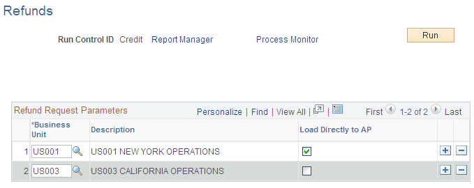

Refunds Page
Use the Refunds page (RUN_AR36001) to run the Receivables Refunds Application Engine process (AR_REFUND).
Navigation:
Accounts Receivable, and then Receivables Maintenance, and then Refunds, and then Request Refund Item, and then Refunds
This example illustrates the fields and controls on the Refunds page. You can find definitions for the fields and controls later on this page.
Refunds page
Field or Control Description
Business Unit
Specify one or more business units for each run of the Receivables Refund Application Engine process. You can add new rows for each business unit you want to include in the refund process.
Load Directly to AP (load directly to accounts payable)
Select to load the processed refunds into the PeopleSoft Payables voucher staging tables. Deselect to enable the system to write refund information to the PS_AR_REFUND_TMP table. If you do not select this check box, you must write a custom process to read information from the PS_AR_REFUND_TMP table and update the appropriate PeopleSoft Payables tables or third-party payables system. This check box is available only if PeopleSoft Payables is installed on your system.
