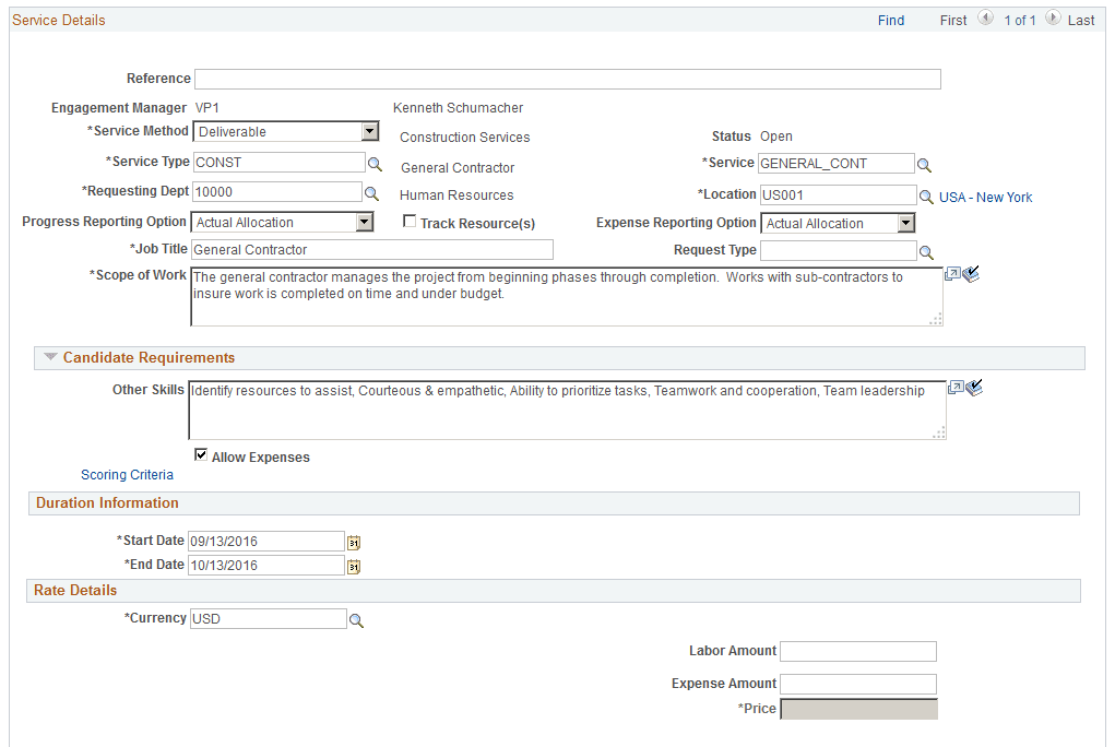

Use the Requisition page (SPF_REQ_INFO_PG) to enter basic service requisition information.
Navigation:
Services Procurement > Requisitions
This example illustrates the fields and controls on the Service Details page. You can find definitions for the fields and controls later on this page.
Service Requisition Page (1 of 2)

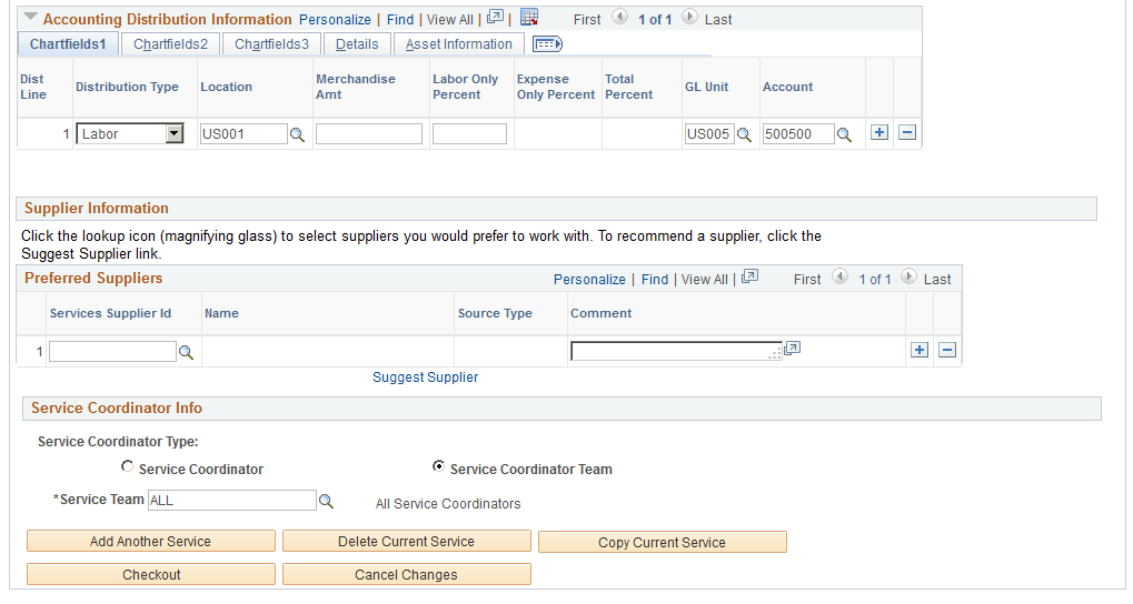

This example illustrates the fields and controls on the Service Requisition Page (2 of 2). You can find definitions for the fields and controls later on this page.
  1. Verify the job title, scope of work, and other skills, which appear by default based on attributes associated with the service.
  2. Verify the value of the Progress Reporting Option that is defaulted from Service Types. You can override this value. If you modify the values for Service method or for a Service Type, the Progress Reporting Option value will revert to the default value.
  3. Enter a price for the entire deliverable rather than an hourly rate, because this is a deliverables-based requisition.
  4. Verify the service coordinator, which appears by default from the service requester defaults.
  5. Select whether you want to track resources for the deliverables-based requisitions.
    The system provides the settlement options as a default from the service.
