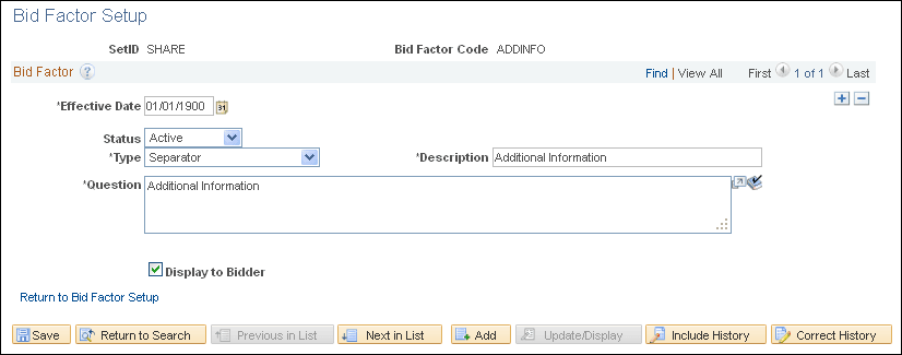

Bid Factor Setup Page
Use the Bid Factor Setup page (BID_FACTOR_PNL) to create bid factors.
Navigation:
  • Services Procurement, and then Define Services Procurement, and then Sourcing Setup, and then Bid Factor Setup, and then Bid Factor Setup
  • Sourcing, and then Create Events, and then Bid Factor Setup
This example illustrates the fields and controls on the Bid Factor Setup page. You can find definitions for the fields and controls later on this page.
Field or Control Description
Default Weighting
Assign an ideal default weighting for the bid factor question that you create.
Type
Select the bid factor type. The bid factor type determines the bid factor questions. Values are:
  • Date
  • List
  • Monetary
  • Numeric
  • Separator
  • Text
  • Yes/No
Additional fields appear, depending on the bid type selection.
Note: The separator bid factor type is used to organize long lists of bid factors by creating headings.
Question
Enter the text of the bid factor question.
Best and Worst
Enter the best and worst possible scores that a supplier can bid for a particular question. For example, if you create a new bid factor with type Date, and the Question field contains What is the end date? the Best and Worst fields represent the best and worst dates on which the candidate can complete the job.

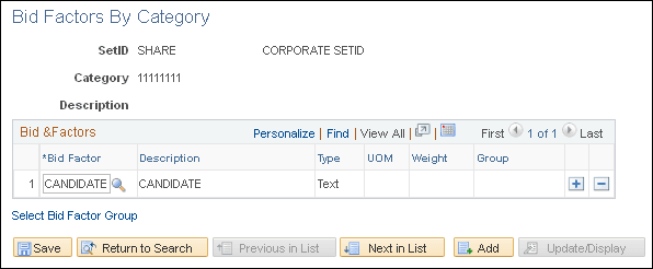

Bid Factors by Category Page
Use the Bid Factors by Category page (SP_BDFTR_BY_CAT_PG) to associate bid factors by category.
Navigation:
  • Services Procurement, and then Define Services Procurement, and then Sourcing Setup, and then Bid Factor Setup, and then Bid Factors by Category
  • Set Up Financials/Supply Chain, and then Product Related, and then Services Procurement, and then Bid Factors, and then Create Bid Factors by Category
This example illustrates the fields and controls on the Bid Factor by Category page.
Link bid factors to a specific item category. You can link bid factors to a category for both deliverable- and resource-based services. When a requisition is created for a service type, it looks for any bid factors linked to the item category for that service type. If it finds any bid factors, it lists them on the Bid Factors by Requisition Line page.
