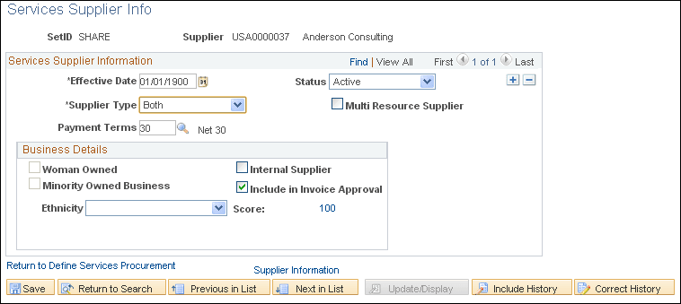

Services Supplier Info Page
VENDOR_SPRO_PG
Maintain suppliers as service suppliers.

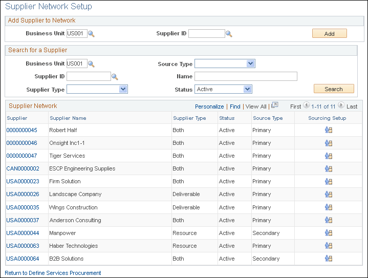

Supplier Network Setup Page
SPB_SUP_NETWORK
Maintain a network of service suppliers for each business unit.

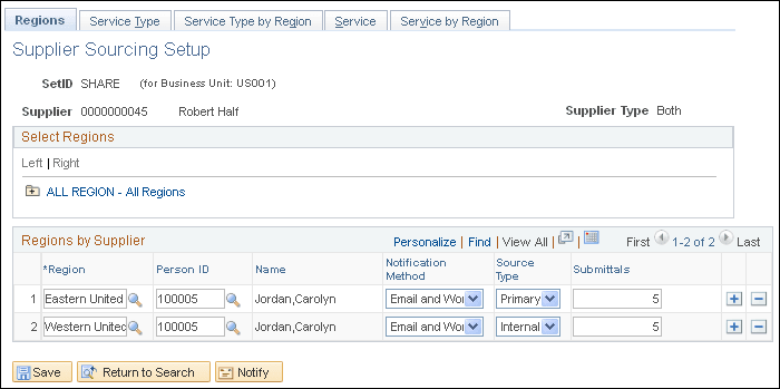

Supplier Sourcing Setup Page
SPB_SPLR_REGION_PG
Maintain sourcing rules for suppliers by associating them with regions, service types and services.

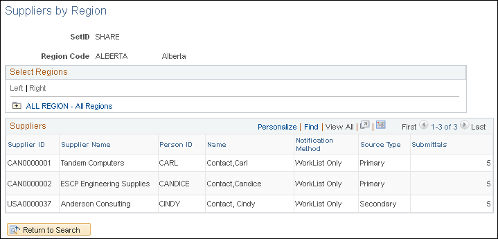

Suppliers by Region Page
SPB_REGION_SPLR_PG
Displays suppliers by region.
Use the Services Supplier Info page (VENDOR_SPRO_PG) to maintain suppliers as service suppliers.
Navigation:
  • Services Procurement, and then Define Services Procurement, and then Services Supplier Setup, and then Service Supplier Information
  • Services Procurement, and then Define Services Suppliers, and then Service Details
This example illustrates the fields and controls on the Services Supplier Info Page. You can find definitions for the fields and controls later on this page.
Services Supplier info page
Field or Control Description
Supplier Type
Select Resource, Deliverable, or Both. The supplier type determines what type of requisitions the supplier can fill. If a supplier only provides hourly employees, select Resource. If a supplier only provides services that are paid in one total amount, select Deliverable. If the supplier can provide both types of services, select Both.
Multi Resource Supplier
Select to indicate that this supplier can be included for multi-resource transactions. These transactions support multiple, unique services and service providers in Services Procurement requisitions, sourcing, and work orders. You must select this check box to enable this supplier to be used use multiple resource services.
Internal Supplier
Select if the supplier is internal to your organization.
Include in Invoice Approval
Select if invoices should be routed to the supplier for approval before being routed internally for approval.
If this option is selected after work orders have already been opened for the supplier, then the Supplier Invoice Approver name on these work orders will be missing. Therefore, the system issues a warning whenever this option is selected to remind the user to review all open work orders for this supplier and to assign a supplier invoice approver.
If the Supplier Invoice Approver is missing on any work orders, invoicing will bypass submitting the invoice to suppliers for approval even though this option is selected to Include in Invoice Approval.
Ethnicity
If the supplier is minority owned, select the ethnicity of the owner.
Score
Displays the supplier score as determined from data analysis.
Use the Supplier Network Setup page (SPB_SUP_NETWORK) to maintain a network of service suppliers for each business unit.
Navigation:
  • Services Procurement, and then Define Services Procurement, and then Services Supplier Setup, and then Supplier Network Setup
  • Services Procurement, and then Define Services Suppliers, and then Supplier Network Setup
This example illustrates the fields and controls on the Supplier Network Setup page. You can find definitions for the fields and controls later on this page.
Supplier Sourcing Setup icon
Click to access the Supplier Sourcing Setup component, where you can organize service suppliers by business unit, region, service type, and service.
When a supplier is both a resource- and deliverable-type supplier and the supplier is a multiple-resource supplier, multi-resource types are included in the list of values for the Service Type field.
Use the Supplier Sourcing Setup - Region page (SPB_SPLR_REGION_PG) to maintain sourcing rules for suppliers by associating them with regions, service types and services.
Navigation:
  • Services Procurement, and then Define Services Procurement, and then Services Supplier Setup, and then Supplier Sourcing Setup
  • Services Procurement, and then Define Services Suppliers, and then Supplier Sourcing Setup
This example illustrates the fields and controls on the Supplier Sourcing Setup page.
Use the Supplier Sourcing Setup component to add suppliers to the supplier network in one central location. Use this component to organize service supplier information by business unit, region, service type, service type by region, service, and service by region.
If a supplier is deliverable-based and also a multi-resource services supplier, all five tabs appear for the supplier, but only the multi-resource service types are selectable from the service type prompt.
Use the Suppliers by Region page (SPB_REGION_SPLR_PG) to displays suppliers by region.
Navigation:
  • Services Procurement, and then Define Services Procurement, and then Services Supplier Setup, and then Suppliers by Region
  • Services Procurement, and then Define Services Suppliers, and then Suppliers by Region.
This example illustrates the fields and controls on the Suppliers by Region page. You can find definitions for the fields and controls later on this page.
If the region tree structure is enabled, use the region hierarchy tree structure to build the supplier and region associations graphically.
