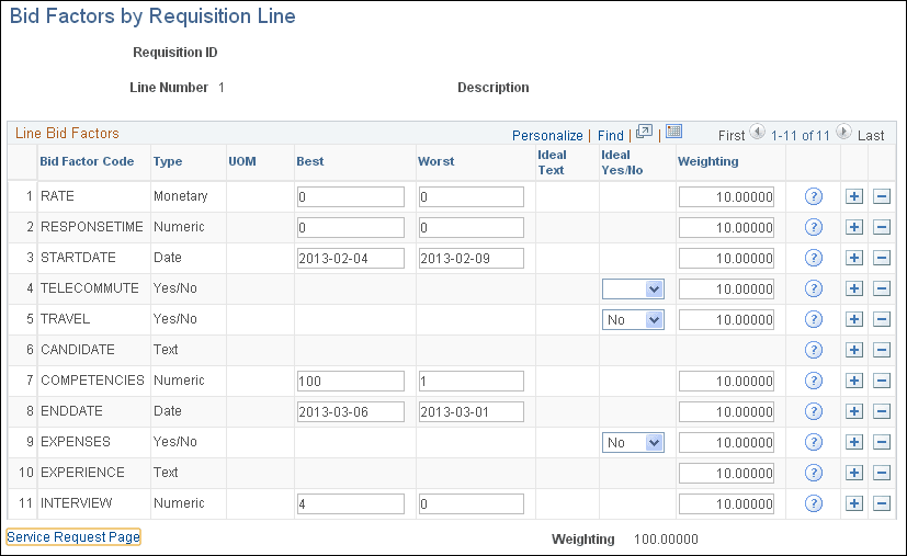

Bid Factors by Requisition Line Page
SPF_BDFTR_REQ_PG
Adjust the weightings of each bid factor to determine its level of importance.
Bid Factor List Items Page
SPF_BDFTR_LST
Enter bid factors where the bidder selects from a list.

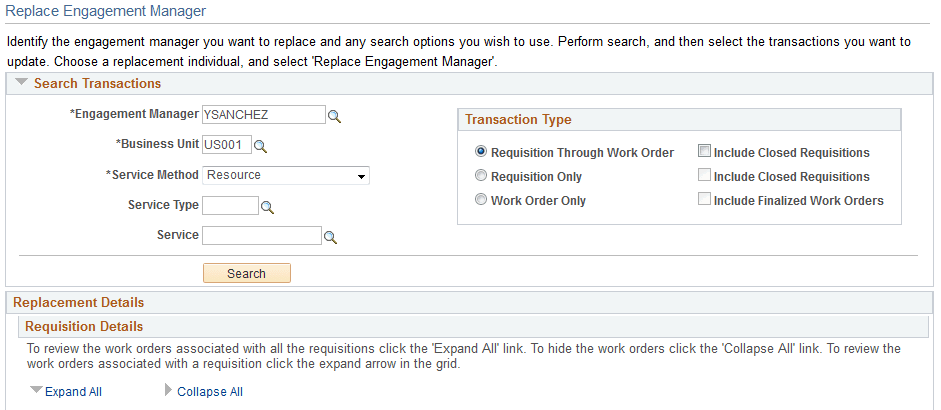

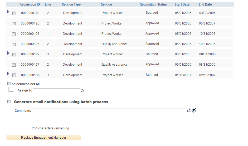

Replace Engagement Manager Page
SPB_REPLACE_EM
Change the engagement manager after creating a requisition or work order.

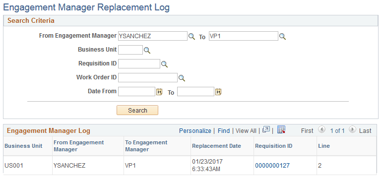

Engagement Manager Replacement Log Page
SPB_REPLAEM_LOG
View the details of reassigned transactions.

  7. Click the Scoring Criteria link on the Requisition Information page to access the Bid Factors by Requisition Line page.
    Use this page to adjust the weighting of each bid factor to determine its level of importance.

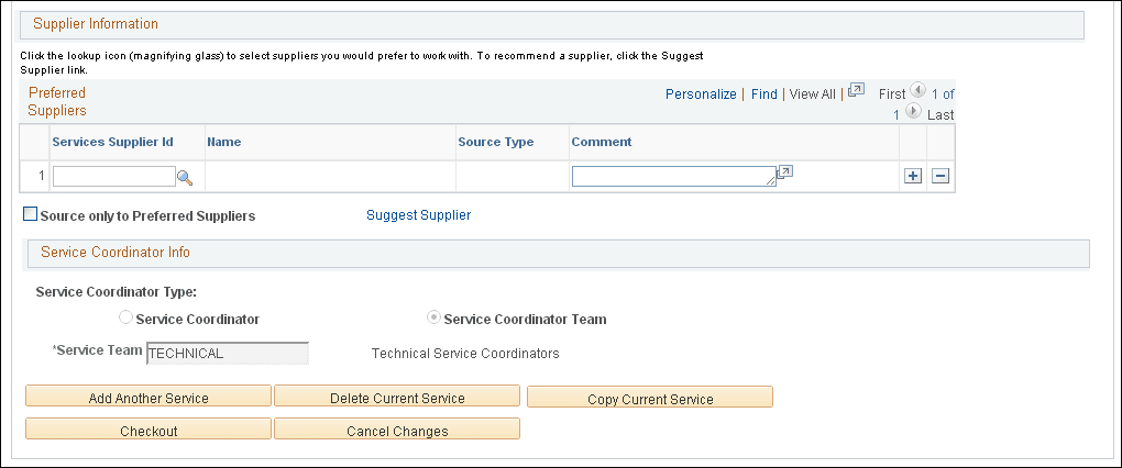

  8. Service coordinator values appear by default from requester defaults.
  9. After all data is defined, click the Checkout button at the top of the page to access the Checkout – Review and Submit page.

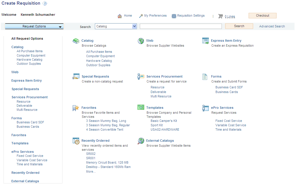

This section discusses how to create requisitions with Services Procurement. The left-hand side navigation panel of the Requisition page includes a section for Services Procurement. This section includes Resource, Deliverable, and Multi Resource options.
On selecting the Services Procurement on the left navigation menu, the right-hand side of the page displays a list of available services with a breakdown of three service methods mentioned. A list of services appears for each service method. Users can click the service method to display the search results using the service method as the search text. Clicking on the service also displays the search results, but the service is used as the search text.
Requisitions Page
Use the Requisitions page (PV_ALL_RQST_OPTION) to create requisitions.
Navigation:
Services Procurement, and then Create a Service Requisition
This example illustrates the fields and controls on the Requisition page. You can find definitions for the fields and controls later on this page.
Create Requisition page
You can add additional services to a requisition by returning to the home page and using the left navigation to locate and select the additional services.

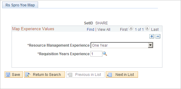

sPro uses Years of Experience defined in Resource Management. However, the setup used to define Years of Experience is different in Resource Management and in sPro. While the value of the Years of Experience field in sPro is governed by SetID, in Resource Management it is governed by the translate value defined in the YearsOfExp field. The values are defined in the setup level for sPro.
Use the RM to sPro Experience Map page to map the experiences in the Resource Management experience table with the experience table in sPro. The mapping occurs between Resource Management Experience fields and Years Experience field in sPro.
Navigation:
Services Procurement, and then Services Setup, and then Competency Setup, and then RM to Spro Experience Map
RM to sPro Years of Experience mapping
Years of experience mapping

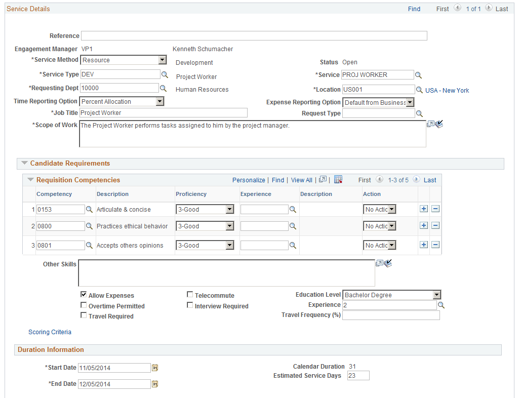

Use the Requisition page (SPF_REQ_INFO_PG) to enter basic service requisition information.
Navigation:
This example illustrates the fields and controls on the Requisition page (1 of 3). You can find definitions for the fields and controls later on this page.
This example illustrates the fields and controls on the Requisition page (2 of 3). You can find definitions for the fields and controls later on this page.
This example illustrates the fields and controls on the Requisition page (3 of 3). You can find definitions for the fields and controls later on this page.

Service Information
Field or Control Description
Engagement Manager
The field is available for all service methods, and is included at the child service level for Multi Resource services. The value for the Engagement Manager will be the same as the Requester upon initial creation for resource, deliverable, and parent multi resource services. For multi resource child services, the value will default from the parent service.
You can change the Engagement Manager after creating a requisition. The requisitions will be reassigned when you change the Engagement Manager. For more information, see Replace Engagement Manager Page.
Service Method
Review the service method for this requisition. If you defined a default service method using the Requester Defaults page, that method appears as a default value when you initially access this page. You can also select an alternate value other than the default value. Available values include:
Deliverable: Select to request services that are generally performed by an entire work force, such as a requisition for an entire project, not just the hours worked by a single service provider.
Multi Resource: Select to request services that support multiple unique services and service providers. When you select this value and enter a service type, the system displays the Multi Services Information grid box when you enter a service type.
Resource: Select to request the services of an individual service provider.
Service Type
Review the service type for this requisition, for example, information technology, professional, or hardware engineering. Initially, this value appears by default from the service requester defaults, if they are defined. You can also select an alternate value other than the default value. Available service types depend on the service method that you select.
Service
Review the specific service or role that is to be performed, for example, Java developer. You can only select services linked to the service type specified. Initially, this value appears by default from the service requester defaults, if they are defined. You can also select an alternate value other than the default value. For example, if you select Resource in the Service Method field, the system provides only services types that are defined as resource service types. The system also filters the content of the Service field based on the service method.
Requesting Dept (requesting department)
Select the requesting department.
Note: When PeopleSoft Human Capital Management (HCM) integration is enabled, the values are based on the HCM departments.
Location
Select the location where the job is to be performed. Initially, this value appears by default from the requester defaults.
Note: The region for rate sheet selection is automatically derived based on the location specified.
Job Title
Enter the internal classification of the position. This value appears by default from the service attributes, if it is defined.
Request Type
Select an appropriate request type. Values are defined by the Service Administrator.
Note: This field is not required.
Positions
Enter the number of service providers who will fill the requisition line. However, if the service requisition comes from Resource Management, the system populates values from Resource Management. You can modify the value.
Note: If you modify the value and save, a notification is sent to the Request Manager to indicate the changes made. The Request Manager has to manually update the Service Order to synchronize with the service requisition.
Note: You can specify up to 999 positions for a requisition line.
Scope of Work
Enter the scope of the engagement in this free-form field. This value appears by default from the comments field on the service attributes.
Candidate Requirements
Requesters can use this section to enter desired candidate competencies that relate to the service requisition. When candidate skills are deemed insufficient, a configurable rule is initiated to block, warn, or take no action.
Once candidate competencies are defined, service coordinators can view the competencies before sourcing the request to suppliers. This enables the service coordinator to source requisitions to the most appropriate suppliers.
If a service order is created in Resource Management, the system populates Requisition Competencies from Resource Management.
Competency
Select a competency to quantify and compare skills. Default values are provided from the service attributes.
Proficiency
Select a proficiency for the competency. The rating model associated to the competency determines the available values.
Experience
Select the years of experience required for the competency.
Action
Select an action for each competency Values include Block, No Action, and Warn.
Block: The provider contact is not allowed to submit a candidate if a candidate does not possess the required skill.
No Action: No action is taken if a candidate does not possess the required skill.
Warn: A warning message appears to the provider contact and the service coordinator if the candidate does not possess a required skill.
The default is No Action if service requisition is from Resource Management.
Note: The action will designate the appropriate message when a requisition competency does not match a provider's competency.
Other Skills
Enter a brief description of any additional skills that a candidate should possess to fill the position. If the Service Order has competencies that are not defined in sPro, they are passed to the Other Skills field.
Education Level
Select the education level that a candidate must possess to fill the position. This value appears by default from the competencies defined in the service attributes.
Experience
Enter the number of years of experience that a candidate must possess for the service. This value appears by default from the competencies defined in the service attributes.
Telecommute
Select when the job allows candidates to work from home.
Travel Required
Select when the job requires a candidate to travel.
Travel Frequency
If travel is required, enter the percentage of time required for travel.
Interview Required
Select this check box if a candidate interview is required. This option appears by default from the service attributes. When you select this option, you must record interview information prior to offering the position.
Scoring Criteria
Click to access the Bid Factors by Requisition Line page, where you can adjust the weighting of each bid factor to determine its level of importance.
Note: Bid factor elements are used to evaluate candidate submittals to determine which candidate is the best match for the requisition. The total of the bid factor weightings must add up to 100 before you can leave the page. If you do not visit this page, the system evenly weights each of the bid factors to reach a total of 100. The service coordinator can update the bid factor weightings at sourcing time.
Duration Information
Start Date and End Date
Enter the dates on which the job begins and ends.
Note: A message appears to the user and a notification is sent to indicate that the Requisition that was created from a Service Order is modified.
Calendar Duration
Displays the number of days between the start and end dates.
Estimated Service Days
A value appears by default after you enter the start and end dates. This value is used for calculating the quantity based on units of measure. The unit of measure that signifies a day is defined in the installation parameters.
Utilization % (utilization percent)
Enter the percentage of time that the candidate will spend during the engagement. For example, if the candidate typically works a half-day, then utilization is 50 percent. If the candidate typically works 3 days per week, then utilization is 60 percent.
Overtime Permitted
Select this check box if overtime is permitted for this requisition.
Note: This check box is for informational purposes only. Any premiums paid for overtime will depend on the predefined time reporting rules.

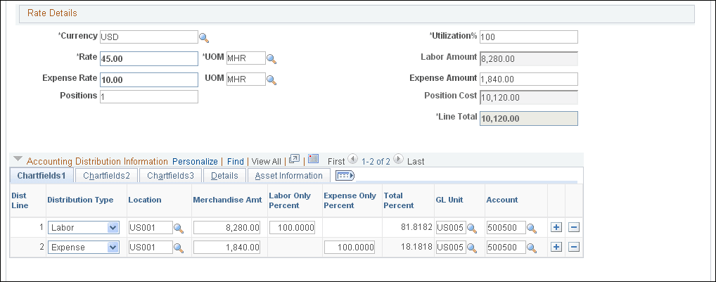

Rate Details
Rate
Enter the rate of pay that is associated with the service requisition. Modifications to the rate amount are validated against rate sheets that you define for the service and region. The tolerance amount for the rate sheet is verified by using base currency values that are stored at the requisition level. The currency values are not validated if rate sheets are not defined for the project role and region. If you enter a rate amount that is out of tolerance with the rate sheet, then you receive either an error or a warning message.
If you select SP Pay Types Enabledon the Services Procurement Installation Options page and the requester does not have the Hide Rate Breakdown role action, then rates are defined separately for each component of the rate breakdown.
Allow Expenses
Select to allow the entry of expenses on requisitions and work orders. The Allow Expenses setting is derived from the BSetup and Service Type Setup pages. When you select to allow expenses, you must enter an expense rate and amount. The system provides an error message if the Allow Expenses check box is selected but an expense-related rate and amount were not entered.
Note: This check box is only available if SP Expenses Enabled is selected on the Services Procurement Installation Options page. Although this setting appears by default from the Services Procurement Business Unit page, you can override it here.
UOM (unit of measure)
Select the unit of measure associated with the labor rate entered.

Accounting Distribution Information
Use this section to charge funds to the appropriate department or project.
If you create a requisition with multiple positions, all positions share the same ChartField distribution fields.
Distribution Type
Select Labor or Expense.
Merchandise Amt
Enter an amount for labor or expense distribution types.
Amount
Enter the amount that is to be charged to a particular ChartField combination.
Note: Changes to the labor percentage or total percentage trigger an automatic recalculation of the distribution line amount.
Labor Only Percent
Enter the labor percent allocation for the requisition line that is charged to a ChartField combination.
Note: Changes to the total percentage or amount trigger an automatic recalculation of the labor percentage for the distribution line.
This column is available only when the distribution type is Labor.
Expense Only Percent
Enter the expense percent allocation for requisition lines that are charged to a ChartField combination.
Note: If the amount is changed, then the system automatically recalculates the expense percent for the distribution line.
This column is available only when the distribution type is Expense.
Total Percent
Displays the percent of the distribution lines if there is more than one line. If there is one line, then this field equals 100.
Account
Enter the account that is to be charged to a particular ChartField combination.
Budget Status
Displays whether the distribution has been budget checked when commitment control is selected. Values for this field include Not Chekd and Valid.
Budget Date
Displays the date used by commitment control to determine the budget period to which this item cost belongs.
Pre-Encumbrance Balance
Displays the pre-encumbrance balance. Pre-encumbrance is created in your budget records by the budget checking process when you generate a requisition.
Pre-Encumbrance Balance will appear only when commitment control is selected and if budget checking has been run at least once for the requisition.
The sum of the expense percentage for all expense lines must equal 100 percent to save the requisition. Defaulting logic for the account ChartField value on expense distribution lines will remain unchanged.
See Application Fundamentals: Understanding PeopleSoft ChartFields.
Supplier Information
The preferred suppliers grid is hidden for users having a role defined for the SP_HIDE_SOURCING_PG role action.
Services Supplier ID
Select the preferred service supplier to whom you want to source the requisition, if known. This is an instruction for the service coordinator, it will not be enforced by the system.
Source Type
Displays the source type. Values are Primary, Secondary, and Tertiary.
Source only to Preferred Suppliers
Select to indicate that the service coordinator should source this requisition only to the suppliers defined on the requisition.
Note: This check box is only available if the requester is authorized to source to preferred suppliers on the service requester defaults.
Suggest Supplier
Click to access the Suggest Supplier page, where you can suggest a supplier who does not yet exist in the system.
Service Coordinator Information
Service Coordinator
Select this button to specify the service coordinator who will source this requisition line to service suppliers.
Coordinator
Enter the name of the person who is responsible for filling the requisition line. Initially, this value appears by default from the service requester defaults, if they exist.
Note: This field is only available when you select the Service Coordinator option.
Note: The service coordinator must have one of the roles defined in the SP_SRVC_COORDINATOR role action.
Service Coordinator Team
Select this button to specify a service team that will source this requisition line to service suppliers.
Note: When creating a requisition, the default service coordinator or team is assigned in this order: first, the system checks for a default team on the service requester; next, it checks for a team by region and service type; last, the system checks in the business unit.
Service Team
Enter the service team that is responsible for filling the requisition request.
Note: This field is only available when you select the Service Coordinator Team option.
Use the Bid Factors by Requisition Line page (SPF_BDFTR_REQ_PG) to adjust the weighting of each bid factor to determine its level of importance.
Navigation:
Click the Scoring Criteria link on the Service Requisition Information page.
This example illustrates the fields and controls on the Bid Factors by Requisition Line page. You can find definitions for the fields and controls later on this page.
For resource-based requisitions, the system automatically selects every bid factor with a resource service type bid factor selected on the Bid Factor Mapping page.
Bid Factor Code
Displays PeopleSoft Services Procurement bid factor codes that appear by default from the Bid Factors page.
Note: You can add improvised bid factors or modify existing bid factors while you create the requisition. Improvised bid factors are not predefined for PeopleSoft Services Procurement.
Best and Worst
Enter the best and worst possible responses that a candidate can provide in response to a particular question.
Ideal Yes/No
Select the ideal response that a candidate can provide for a particular question. Values are Yes and No.
Weighting
Adjust the weighting of each bid factor to determine its level of importance. For example, if the candidate start date is the most important qualification, then you might weigh that bid factor more heavily than the others.
Note: The total of all bid factor weightings must equal 1.
Bid Factor Question icon
Click the Question button to view the bid factor question that is associated with the bid factor code. For example, if a bid factor code is experience, then the bid factor question associated with the code might be: "How many relevant years of experience does the candidate have?"
Use the Replace Engagement Manager (SPB_REPLACE_EM) page to select a new engagement manager for a requisition or work order.
Navigation:
Services Procurement, User and Team Setup, Replace Engagement Manager
This example illustrates the fields and controls on the Replace Engagement Manager page (1 of 2). You can find definitions for the fields and controls later on this page.
This example illustrates the fields and controls on the Replace Engagement Manager page (2 of 2). You can find definitions for the fields and controls later on this page.
Select the current engagement manager, business unit, service method, and transaction type and perform your search.
Requisition Through Work Order
Select to replace the Engagement Manager for selected Requisitions and the Work orders associated with them.
Requisition Only
Select to replace the Engagement Manager in selected requisitions only.
Work Order Only
Select to replace the Engagement Manager in selected Work Orders.
Requisition Details
Select the requisitions to be transferred to the new engagement manager.
Assign To
Select the new engagement manager.
Generate email notifications using batch process
Select to send notifications through batch process (i.e. SP_EMAIL). If you want to send the notification at the time of replacement you may deselect this check box.
Comments
Enter your comments to the new engagement manager.
Click this button to confirm your selection. Upon confirmation, the new engagement manager receives an e-mail notification.
Use Engagement Manager Replacement Log page (SPB_REPLAEM_LOG) to view the details of the reassigned requisitions.
Navigation:
Click the Engagement Manager Log link in the e-mail notification.
This example illustrates the fields and controls on the Engagement Manager Replacement Log page.
Enter the search criteria to search and view the details of reassigned transactions.
