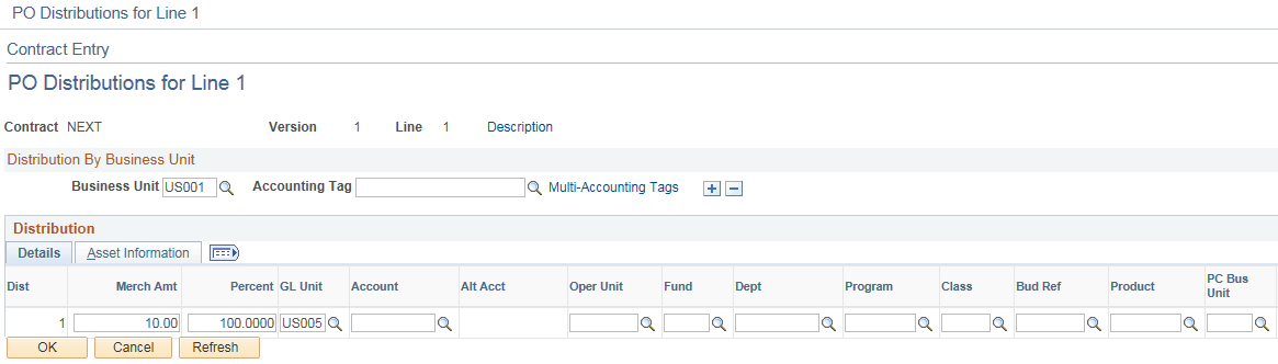

PO Distributions for Line Page
CNTRCT_DSTRBPO_SEC
Enter contract line-level distribution defaults. This enables you to maintain unique sets of purchase order distribution defaults for each business unit. You can use the distribution entries as default values during the contract release process, based on the affected purchasing business unit.

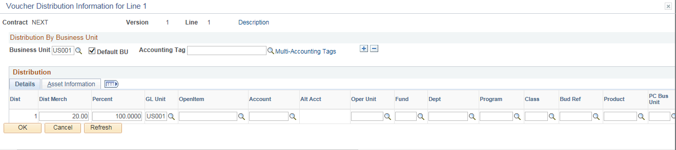

Voucher Distribution Information for Line Page
CNTRCT_DSTRB_SEC
Set up one or more distribution lines for each contract line. When a contract line is released to a voucher, the distribution lines are copied to the voucher line. You can use this page for voucher releases only.

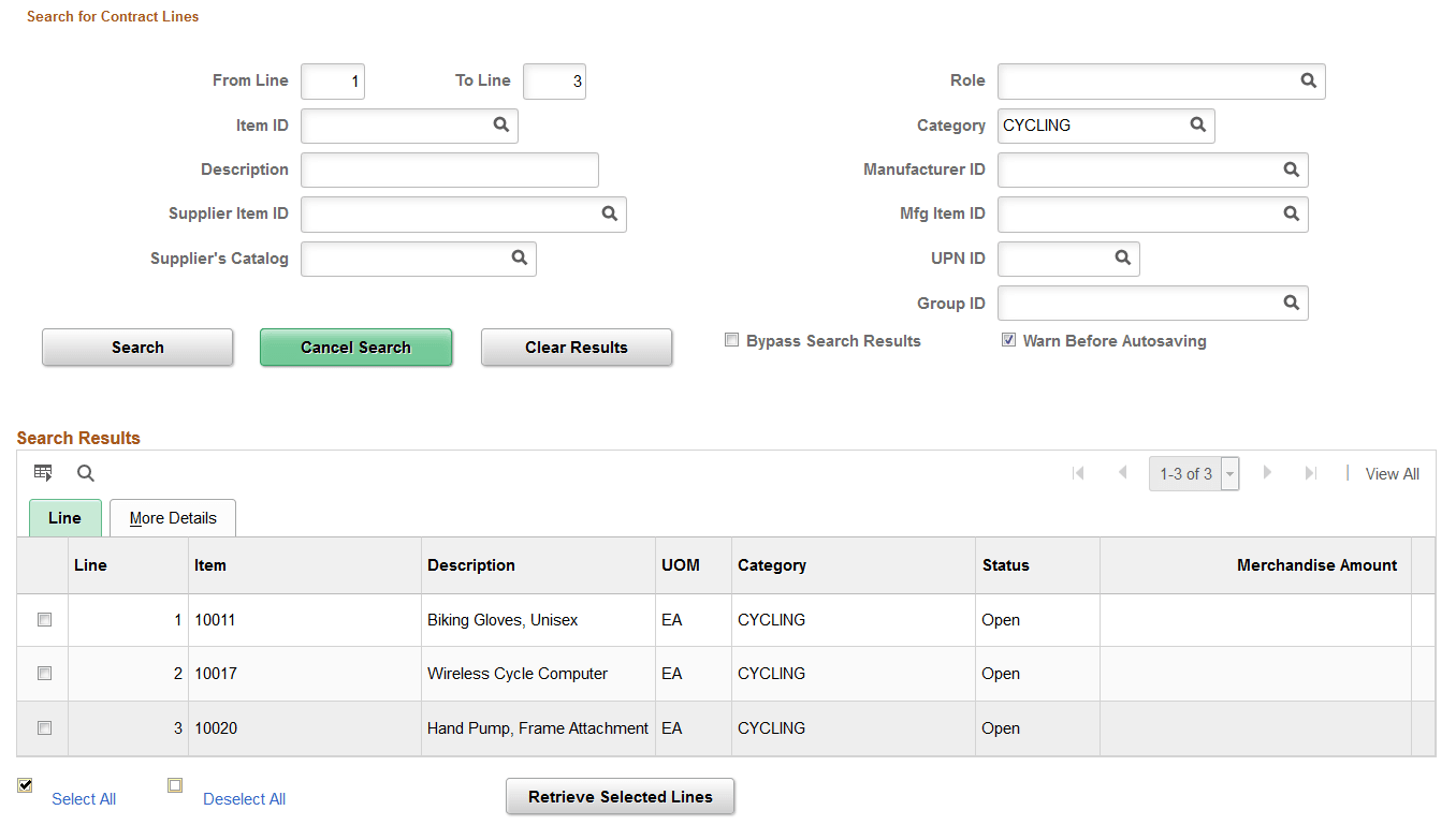

Searching for Contract Lines
Use the Contract page (CNTRCT_HDR) to enter line and item information for the contract.
Navigation:
Procurement Contracts, and then Add/Update Contracts, and then Contract. Select the Search for Contract Lines link.
This example illustrates the fields and controls on the Contract Entry - Contract page, Search for Contract Lines.
When you are working with a large contract that contains many lines, this search page provides better control and flexibility over which lines the system retrieves from the contract. The Search for Contract Lines box automatically appears on the Contract page when the number of rows on a contract exceeds the maximum number of rows predefined value. This value is determined by the number entered in the Contracts field for Purchasing installation options. See Application Fundamentals: Installation Options - Purchasing Page.
You can retrieve lines by item, description, line number ranges, or any of the other parameters on the page. Each time you enter new criteria and click the Search button, the system appends the additional results to the Search Results grid. Select the lines in the search results that you want to work with and click the Search button to load the lines into the contract page.
Instead of searching for selected contract lines, you can click the Load All Contract Lines link to load all contract lines associated with the contract. This link appears next to the Search for Contract Lines link before you perform a search. You can use the link instead of performing the search. If the Warn Before Autosaving check box has been selected in a previous search, the system displays a message indicating that the load action will force a system save.
Field or Control Description
From Line andTo Line
Enter a single line for both fields to retrieve one contract line item. Enter a range of line numbers to retrieve multiple lines with the from line being the lowest number.
Item ID
Select a single item ID on which to base a contract line search.
Category ID
Select a category ID on which to base a contract line search. When you click the Look Up Category button, the system provides a list of values that contains all of the categories associated with the contract. When you select the category, the search results provide all contract lines for that category.
Description
Enter an item description on which to base the search. This field is case-sensitive.
Manufacturer ID, Supplier Item ID, Mfg Item ID(manufacturer item ID), UPN ID, Supplier Catalog and Group ID
Select one of these options on which to base a search. You can select multiple options to reduce the results. For example, you can select a supplier item ID on which to base a contract line search. All contract lines that contain the supplier item ID and that meet other search criteria you enter are returned in the search results.
Search
Click to search for items that meet the search criteria. If you do not enter criteria, the system returns all contract lines associated with the contract.
Note: Chunking is a process in which the system places a small subset of transaction lines in a buffer. Sample data delivered with PeopleSoft Purchasing sets chunking at the maximum rows in contracts to 50.
When performing searches, the system amends the previous search with the results of the current search unless you click the Clear Search button.
Cancel Search
Click to exit the Search for Contract Lines group box and cancel the search criteria that you entered. If you select to bypass the search results, the Cancel Search button is not available.
Clear Results
Click to remove the previous search results from the Lines grid box. This enables you to initiate a new search, otherwise, the system amends the previous search results with those of the current search.
Bypass Search Results
Select to bypass viewing returned search results. Instead of populating the Search Results grid, the system navigates directly to the Lines grid with the search results, making it quicker to work with contract lines.
Select to enable messaging where the system provides a warning message that an action will force a save. When the message appears, click the OK button to save and continue. If you do not want to save, click the Cancel button to return to the Contract page with the unsaved changes.
The system automatically saves all changes to the database when the Warn Before Autosaving check box is not selected and you:
  • Click the Search button and the Bypass Search Results check box is selected.
  • Click the Retrieve Selected Lines button after you perform the search.
  • Click the Load All Contract Lines link prior to performing the search.
Select All
Select all contract lines returned by the system search. When you click the Retrieve Selected Lines button, the system displays the lines for review and maintenance. Select individual check boxes to select specific lines to retrieve.
Deselect All
Select to deselect all contract lines in the search results.
Retrieve Selected Items
Click to retrieve the contract lines that you selected. After retrieving the lines, you can review and maintain individual lines. The system displays a warning when you do not select contract lines to retrieve. If the Warn Before Autosaving check box is selected, the system displays a message indicating that the retrieve action will force a system save.
Search Results
This grid displays the contract lines returned by the search. The Line and More Details tabs provide a summary of the search criteria used in the search and details about the contract line.
Use the Voucher Distribution Information for Line page (CNTRCT_DSTRB_SEC) to set up one or more distribution lines for each contract line.
Navigation:
Click the voucher distribution button Voucher Distrib button that is located in the line area of the Contract page.
This example illustrates the fields and controls on the Voucher Distribution Information for Line page. You can find definitions for the fields and controls later on this page.
Business Unit
Select the business unit to which to apply the defined distribution.
The business unit on the first business unit row appears by default from the Contract page or the User Preferences - Overall Preferences page.
This business unit becomes the default voucher-release business unit.
If more than one business unit row is entered per contract line, you can select a different default business unit by selecting the Default BU check box for the business unit row.
The default business unit that you select on the Voucher Distribution Information for Line page is used on the Voucher Tax Info for Line page and applies to all contract lines. Therefore, if you change the default business unit for one line, it becomes the default business unit for all lines.
Only voucher business units that are set up on this page are eligible for release. For example, if you define the business unit for line 1 but not line 2 of a release on the Create Releases page, only line 1 can be released.
For every business unit row on the Voucher Distribution Information for Line page, the total in the Dist Merch (distribution merchandise) field must equal the line amount, and every distribution line must have an account entered.
Suppose that on one line you set up business units US001 and FRA01. When you insert a second line, these same business units are inserted into the business distribution rows for this second line. If you then delete one of the business unit rows from one of the lines, the business unit row on the other line is not deleted.
For every business unit row, the total distribution amount must equal the line amount, and every distribution line must have an account entered.
SpeedChart
Select a SpeedChart code to assign preset distributions to the line.

Details
Percent
Enter the distribution percentage. This percentage is calculated based on the amount on the voucher distribution. The total percentage must equal 100.
Use the PO Distributions for Line (purchase order distributions for line) page (CNTRCT_DSTRBPO_SEC) to enter contract line-level distribution defaults.
Navigation:
Click the PO distribution button PO Distribution Details button on the Contract page.
This example illustrates the fields and controls on the PO Distributions for Line page. You can find definitions for the fields and controls later on this page.
PO Distribution line page
Business Unit
If the distribution was created from an RFQ or strategic sourcing event, all distribution fields are populated by the RFQ or Strategic Sourcing Event distribution. If the RFQ or SS event originates from a requisition, you cannot delete distribution rows for the requisition or RFQ or SS event business unit.
SpeedChart
Note: The field is enabled only when the default option is set to override. Accounting Tags appear in lieu of Speedcharts when the Accounting Tag check box is selected for Purchasing on the Accounting Tag Registration page. See Application Fundamentals: Setting Up Accounting Tags
Accounting Tag
Enter an Accounting Tag that will be used to populate ChartFields on transaction distribution lines. The system automatically prorates the distribution amounts according to the proration percentages defined on the Accounting Tag.
Note: Accounting Tags appear in lieu of Speedcharts when the Accounting Tag check box is selected for Purchasing on the Accounting Tag Registration page. See Application Fundamentals: Setting Up Accounting Tags
Multi Accounting Tag
Click to access the Multi Accounting Tag page, where you can append and override accounting tags for the distribution lines.
Note: Multi Accounting Tag link appears only if amount only check box is selected on the Contract line details page.
Details
Select the Details tab.
Dist Merch
This field becomes visible on Contract PO Default Distributions for general contract and purchasing order contract, if the corresponding line ‘Amount Only’ flag is checked.
The total distribution amount and the related line merchandise must be equal and the total percentage should be 100. If you change any of this value, the distribution merchandise and percentage is recalculated. The same functionality applies also in case you have multiple business units.
The Distribution Merchandise amount is calculated as Line merchandise amount * percentage of accounting tag (or speedchart) when using accounting tag (or speedchart) template to default the distributions.
Percent
Enter the distribution percent. This percentage is calculated based on the amount on the purchase order distribution. The total percentage must equal 100.
Note: Account marked as open-item cannot be used for PO releases.

Item Search Criteria Page
Use the Item Search Criteria page (ITEM_SEARCH_SP) to search for items.
Navigation:
  • Click the Item Search link that is located in the line area of the Contract page.
  • Click the Items button that is located in the line area of the Contract page.
The fields that are available for entry on this page make up the item search criteria. The system finds all items that match the search criteria that are entered. You can perform narrow or wide searches, but you must enter at least one search parameter. The values on this page are defined in the Item Definition component.
Select an item check box to select the associated item and populate the selected transaction line on the original page from which you access the Item Search Criteria page. Selecting an item check box causes the selected item to overwrite any existing item on the selected line on the original page.
