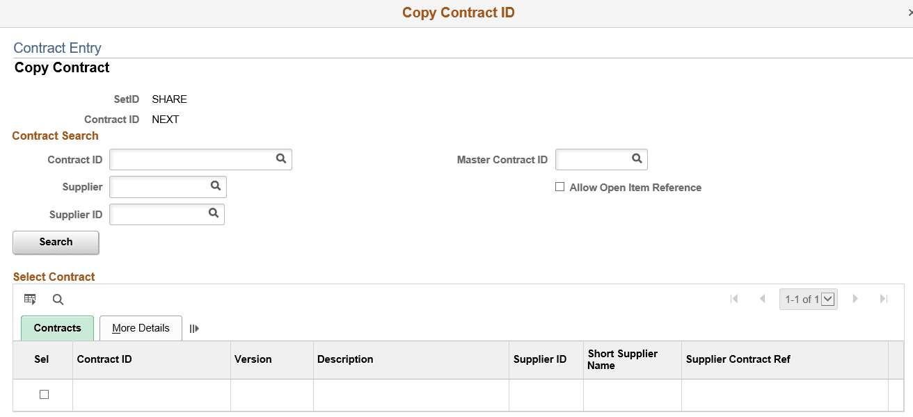

Copy Contract ID Page
CNTRCT_COPY_SEC
Copy from an established or expired contract. This page is available only in Add mode.

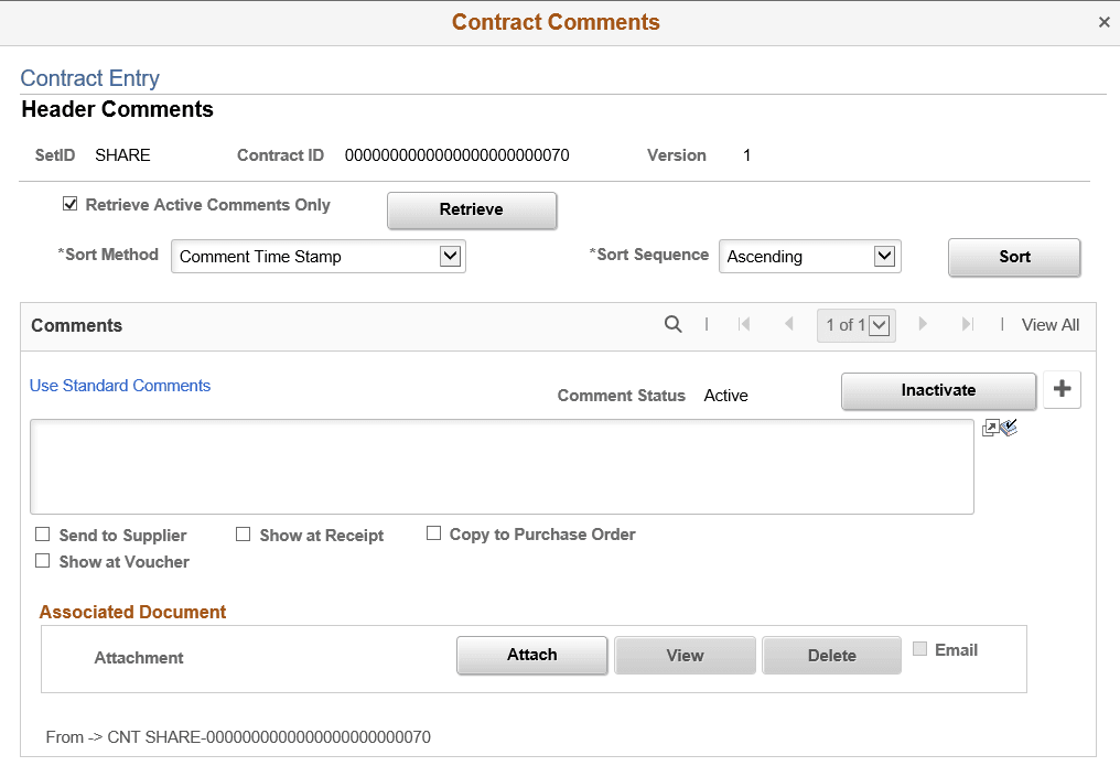

Contract Comments - Header Comments Page
CNTRCT_CMNTS_SEC
Enter comments for a transaction. You can enter your own comment, or you can select from predefined standard comments.

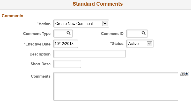

Standard Comments Page
STD_COMM_SEC
Copy or add comments that are standard comments used by an organization, such as shipping comments.

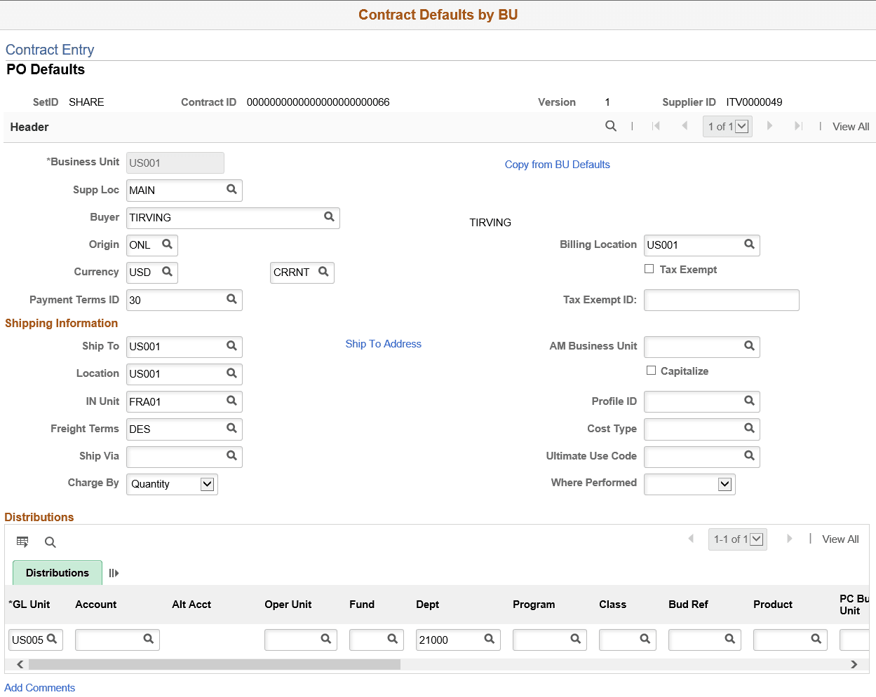

Contract Defaults by BU - PO Defaults Page
CNTRCT_DFLT1_SEC
Set default information for order contracts for each business unit. If no other defaults appear in the default hierarchy, the information that you set up on this page appears by default in each release schedule that you define for the specified combination of order contract and business unit.
This page applies to order contract releases only.

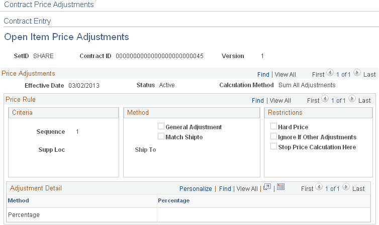

Open Item Price Adjustments Page
CNTRCT_PRC_ADJ_SEC
Enter price adjustments that apply to items that reference the contract as an open item contract. The Add Open Item Price Adjustments link becomes available only if the Allow Open Item Reference check box is selected on the Contract page. Open item references are applicable to Purchase Order and General contracts with purchase order releases only.

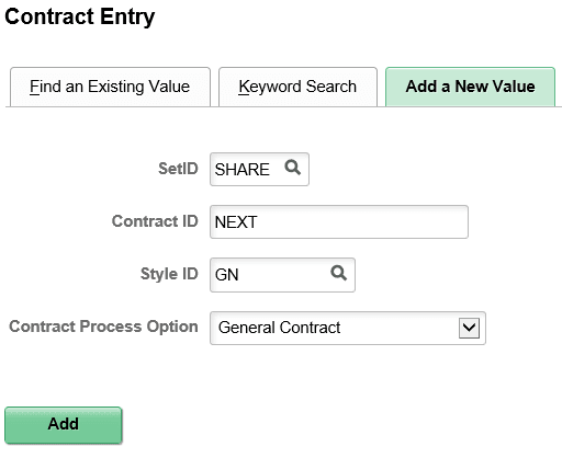

Contract Entry Page - Add a New Value
Use the Contract Entry page - Add a New Value to create a contract.
Navigation:
Procurement Contracts, and then Add/Update Contracts, and then Add a New Value
This example illustrates the fields and controls on the Contract Entry Page - Add a New Value.
Contract Entry - Add a New Value
Field or Control Description
Style ID
Select a style ID. Style IDs are created using the Contract Style page.
Contract Process Option
Select a contract process option. For more information about contract process options, see Contract Process Options

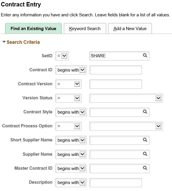

Contract Entry Page - Find an Existing Value
Use the Contract Entry page - Find an Existing Value to define search criteria to retrieve a contract.
Navigation:
This example illustrates the fields and controls on the Contract Entry Page - Find an Existing Value.
You can search for existing contracts using a variety of criteria that include the contract ID, version, contract style, process option, and version status. For example, if you are using version control, you can limit a contract search to only those contracts at version two. You can further limit the search by searching for only the Current version of a contract.
After entering search criteria, click the Search button. The system retrieves those contracts that match the search criteria. The search also provides high-level details about the contracts. To view details about a contract, click the contract link. If you are using contract versions, you can view any version of the contract. When you open a contract, all fields are protected unless the selected version is the Draft version or the selected version is the Current version and the contract status is Open. If version control is not in use, you can open the Current version to make changes.
This page also provides a way to view prior versions of the contract if you are using version control. To view a prior version, select a contract version that is in a History version status.

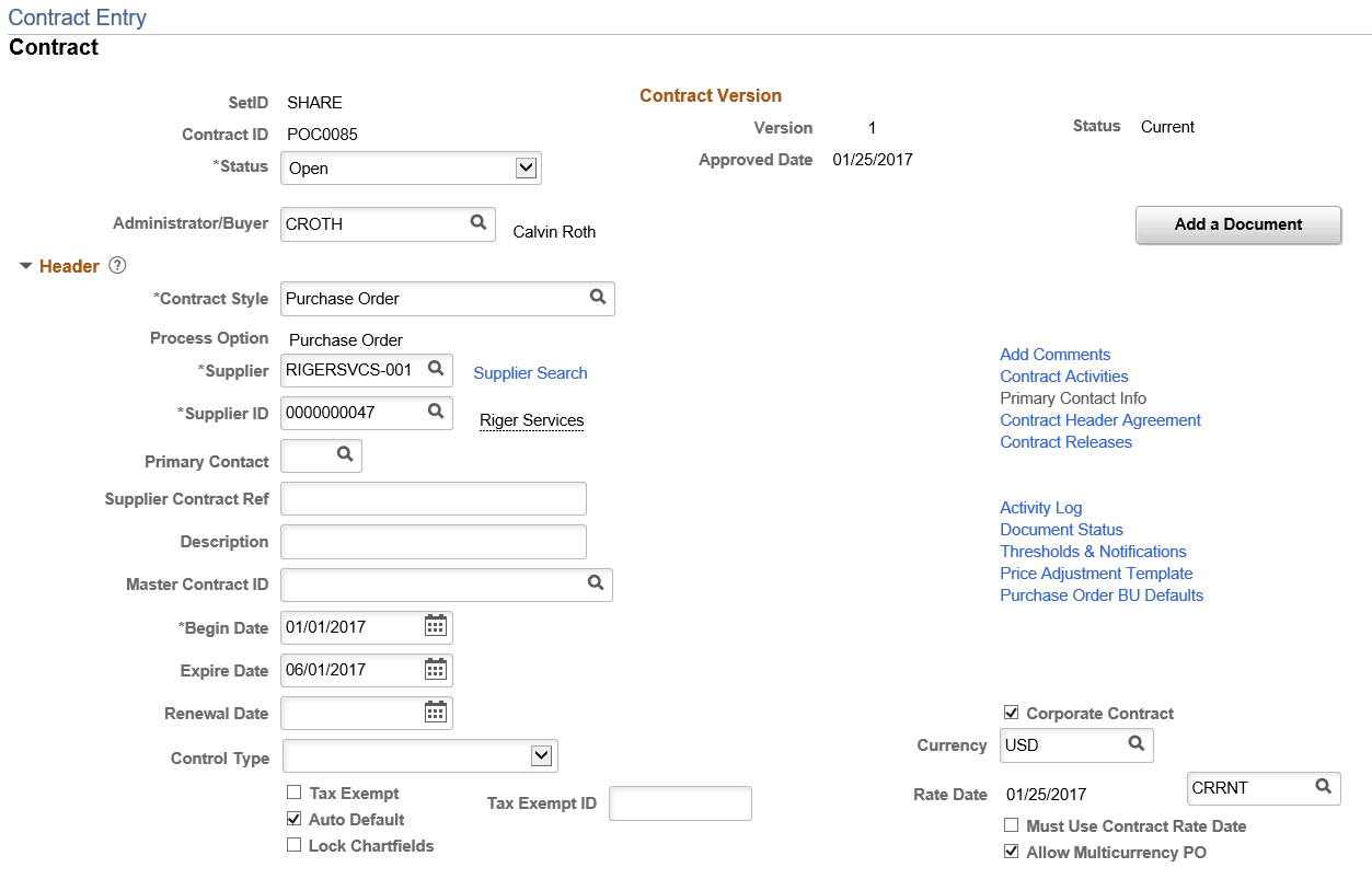

Contract Entry - Contract Page
Use the Contract page (CNTRCT_HDR) to enter procurement contract information.
Navigation:
Procurement Contracts, and then Add/Update Contracts, and then Contract
This example illustrates the fields and controls on the Contract Entry - Contract Page (Purchase Order) (1 of 3).
This example illustrates the fields and controls on the Contract Entry - Contract Page (Purchase Order) (2 of 3).
This example illustrates the fields and controls on the Contract Entry - Contract Page (Purchase Order) (3 of 3).
Use the Contract Entry - Contract page to enter header and line information for the transactional purchasing or voucher-based contracts. When you create a contract, the system uses the value in the Contract Process Option field to determine the fields that appear on the page. For more information about process options, see Contract Process Options.
The description of this page is divided into sections that describe contract header and contract line fields along with links to other contract features. Depending on the contract style and status, sections that may be available are:

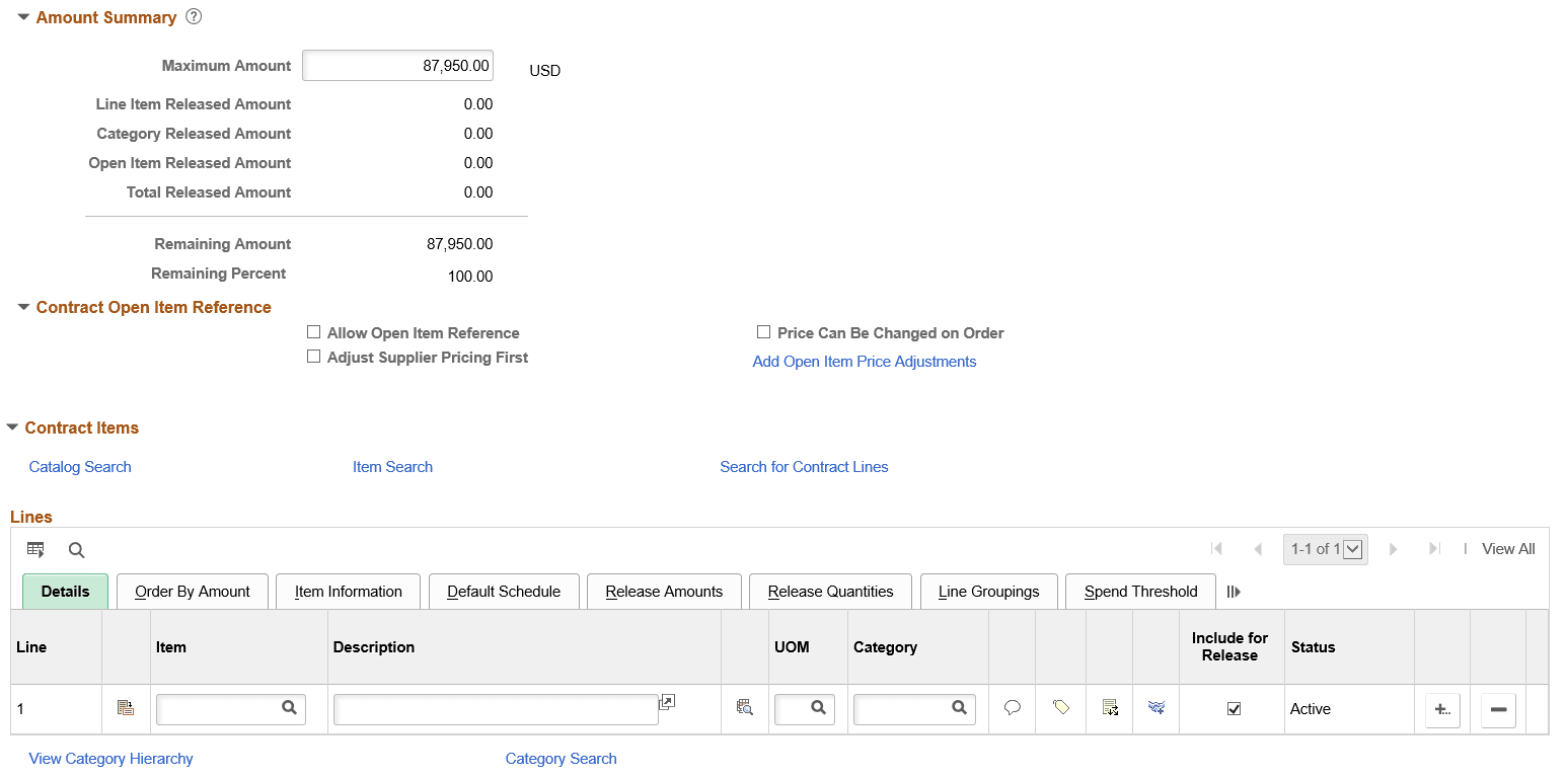

  • Amount summaries.
  • Contract Open Item Reference
  • Contract items.
  • Contract categories.

Copy from Contract
Click to access the Copy Contract ID Page where you can create a new contract by copying an existing contract. This link is only available after clicking OK on the Contract Entry Page - Add a New Value.
When you copy a contract, you must copy a contract with the same processing option as the contract that you are creating. The system sets the copied contract to an Open status so that you can make further changes prior to getting contract approval.
Status
Select the status of the contract. Values are Approved, Canceled, Closed, On-Hold, Open, and Pre-Approved.
When you create a contract, the status appears by default as either Open or Approved based on the settings for the user on the User Preferences - Contracts page. Only contracts with an Approved status are eligible to have releases created against them, or to be referenced by other transactions. Only contracts in Add mode or in Open status can be modified.
You cannot set the status to Closed or Canceled if open lines or staged releases against the contract exist. If a contract's status for the Current version is returned to Open, purchase orders that reference that contract version are not available for change until the contract is approved again. This is necessary to maintain data integrity.
When vouchers exist for a contract and the contract is closed, all vouchers that are eligible for closure are also closed. Eligible vouchers include those that have not been posted, paid, matched, or budget checked. If the contract is later reopened, releases can be created for these vouchers again, and a new voucher ID is assigned.
If the contract originated from an RFQ (request for quote) and the contract is canceled, you can return quantities to the RFQ.
If you are using contract versions, you can update the status to finalize the Draft version to Current. When you select the Approve status and click Save, the system updates the Draft version to the Current version and updates the Current version to the History version. When you are using the Full Life Cycle option as a document type setting, the system also notifies you if a PeopleSoft Supplier Contract Management contract document is associated with the contract and that the document is not in an Executed status. This is just a reminder that the corresponding document should be finalized as well.
Contracts with a Pre-Approved status are available only for users with access to Approve Contracts, which is determined on the Application Fundamentals: User Preferences - Contracts Page.
The status, along with the value of the approval due date, can be used to schedule the date when the contract is automatically approved.
If the contract status is Pre Approved, you can update the approval due date. The system displays an error if the approval due date is not updated, or if it’s prior to the current date.
You cannot modify contracts that have a Pre- Approved status. Only contracts that are being created initially, or have an Open status, can be modified.
Note: The Pre Approved status is only available on a draft version of the contract. You cannot change the status of an approved contract when a Draft version exists for the contract. Instead, you can either make the change in the Draft version or delete the Draft version.
Administrator/Buyer
Select a user who serves as the contract administrator or buyer. These terms are different:
  • Contract Administrator is used by Supplier Contract Management.
    The contract administrator is used as a default value when creating an authored document .
  • Buyer is used by PeopleSoft Purchasing.

Type: Select the type of supplier. Options are ADV (advertising), CNS (consultant), CNT (contractor), ENT (entertainment), FRG (foreign supplier), GVT (government agency), MNR (minority supplier), PR (public relations), TRD (tradesman), TRN (transportation), and TRV (travel related services).
Max Rows (maximum rows): Enter the maximum number of rows that you want the system to retrieve. Using this field could improve search performance.
Supplier ID
Select the supplier ID for the contract.
Note: If a supplier ID is selected from the look-up option, the Supplier field is automatically populated based on your selection.
Primary Contact
Select the supplier contact for the contract. If a contact is specified and an address is associated with this contact, that address appears on the dispatched contract. Otherwise, the system uses the address from the default supplier location.
To use this field, you must have already set up supplier contact information in the Supplier Information component. See Entering Supplier Contact Information.
Supplier Contract Ref (supplier contract reference)
Enter a reference to identify a supplier contract number or some other identifier by which the supplier identifies this contract. The value can be used in searching for contracts.
Description
Enter the contract description. This is an optional field.
Master Contract ID
Select a master contract ID, if applicable.
Begin Date
Select the start date for use with the contract. The default value is the current system date. If you create staged releases and the user changes either the beginning date or the expiration date of the contract, the system checks the dates to ensure that they are within the range of the purchase order or invoice dates.
If you change the purchase order date on a purchase order that references a contract, the system checks the date against the beginning and expiration dates.
When you select a contract on a purchase order or when the PO Calculations process validates a contract that is specified on a line, the system checks the date against these beginning and expiration dates.
You can have multiple contracts for the same item-supplier relationship, and you can have multiple open-item reference contracts as long as they have different beginning dates or the Auto Default setting is turned on for, at the most, only one of the contracts.
Expire Date
Select the end date of the terms and conditions of the contract. The expire date cannot be earlier than the begin date. The system can notify you if you want to be warned when the expiration date approaches. You use the Thresholds & Notifications link to set up this notification.
Renewal Date
Enter a contract renewal date. This is an optional field that indicates when a contract is up for renewal. If you enter a renewal date, it should be later than the current date, and if a contract expiration date exists, then the renewal date should be before or equal to the expiration date.
The system can notify you if you want to be warned when the renewal date approaches. You use the Thresholds & Notifications link to set up this notification.
Control Type
Select a control type, which is available for Manufacturer and standard (General, Purchase Order, and Single to Release Purchase Order) contracts. The option that you select determines the grid in the Contract Control section below.
When creating a contract, you can enter specific Purchasing business units, contract domains, ship to’s, or a combination of all three. However, when specifying this field on a standard contract, it eliminates all other standard contracts where the control type doesn’t match. Therefore, adding another level of control.
For Standard Contracts:
  • When creating standard contracts, the Control Type determines access, but not pricing.
  • After a value is selected and the contract is saved, the Control Type cannot be change.
  • If Business Unit is selected, the Purchasing business unit has no impact on Purchase Order Defaults.
  • If the Corporate Contract check box is not selected (the contract is a non-corporate contract), the control type displays Business Unit by default.
    In addition, the system populates the grid with valid business units defined for purchase order defaults for non-corporate contracts.
Control Types are pre-defined using the Contract and Vendor Rebate Controls Page.
For Manufacturer Contracts see Creating Distributor and Manufacturer Contracts.
Punchout Pricing Option
Select an option to indicate how the contract pricing must be applied for contract lines that are matched to transaction lines. This field is available only when the Line Matching options are selected in the Contract and Vendor Rebate Controls Page
Select from the following values:
  • Always Use Contract Price: Use this option to override the Punchout Price by the Contract Line Base Price on the transaction line, and for any line Adjustments that was applied. This is the default value
  • Always Use Punchout Price: Use this option to use the Punchout Price on transaction line. If this option is used, the contract line Base price and Adjustments will not be applied to the transaction line.
  • Use Punchout Price if Lower: Use this option when a calculated price (contract line base price plus any adjustments) is higher than the Punchout price.
Tax Exempt
Select if the contract is tax exempt. This field applies to both voucher contracts and order contracts. If you select this option for an order contract, enter the tax exempt ID in the text box for this option. The tax exempt ID is not used for voucher contracts.
Auto Default
Select to make this contract available to automatically supply a purchasing requisition and purchase order transaction. When enabled, the system enforces that the procurement contract is unique such that the system may select one unique contract onto the purchasing requisition and purchase order transaction. This check box is selected by default. If you deselect the check box, requesters and buyers must manually select the contract on transactions, rather than have the system find them automatically.
In addition, the business unit setup must enable automatically supplying a contract to a requisition, purchase order, or both. Select the Default Contract on Req and Default Contract on PO check boxes to enable the automatic default. The system searches for and ensures that the current, approved contract is selected for use with the transaction.
The contract process option must be purchase order, general, or release-to-single PO only and the supplier on the contract must match the supplier on the transaction.
Note: Although you select the Auto Default check box, the contract will not be supplied by default on a transactional requisition or purchase order unless the corresponding business unit flag for defaults is also selected.
See PeopleSoft Purchasing: Understanding How to Apply Procurement Contract Prices to Transactions and Understanding Procurement Contract Default Rules
Lock Chartfields
Select to prevent changes to purchase order ChartFields at the purchase order distribution level that are released from this contract. When this check box is selected, you cannot manually reference this contract on requisitions and purchase order lines. Purchase orders that reference contracts with the Lock Chartfields check box selected must be created as releases from the contract or created by copying the contract
The following rules also apply to this option:
  • Transactions undergoing the PO Calculation process do not pick this contract.
  • When the Lock Chartfields check box is selected, you cannot add a schedule or a distribution to the purchase order for a line that was directly released from a contract.
Note: This option is enabled only when the Commitment Control feature is used.
Corporate Contract
Select if you want this contract to apply to all business units within the specified SetID. If you do not select this option, you must enter a list of valid business units for this contract on the PO Defaults page. At the time of release, the release business unit must be defined on the Contract Defaults page. This option is selected by default for order contracts. This option does not apply to voucher contracts.
The system supplies the business unit of the purchase order that is associated with the contract. The field value cannot be changed. You cannot insert additional business-unit default rows.
Currency
Select the currency and exchange rate type that apply to the contract. The currency changes after the supplier is selected if the supplier currency is different.
The currency that is identified here is the currency that the system uses to maintain the amount limits and the released amounts of the contract. This currency does not prohibit prices in other currencies on this contract for order releases.
After you enter lines, create releases, or reference this contract on a requisition or purchase order, the currency cannot be changed.
The currency that you select here is the currency that must be used for voucher releases and for the purchase order that is associated with a recurring purchase order voucher.
Rate Date
If you select the Must Use Contract Rate Date check box, enter the rate date that you want to use. The rate date is the date that the system uses to determine the correct currency conversion rate to use on the purchase orders that are created to satisfy the contract. The default value for this field is the current system date.
Select to have any purchase orders that are created against this contract use the rate date on this contract for currency conversions. This check box becomes available for selection if you select the Allow Multicurrency PO check box.
Allow Multicurrency PO (allow multicurrency purchase order)
Select to indicate that the purchase order that you create to satisfy the contract can be in a currency other than the one that is specified on this supplier contract. If so, the currencies from the contract are converted to the currency of the purchase order.
Header Links
This table lists the potential links that can appear in the Header section:
Add Comments or Edit Comments
Click to access the Contract Comments - Header Comments Page, where you can enter comments about the contract, define comment actions, and attach associated documents. You can also select to add standard comments.
If comments already exist for the contract, the Edit Comment button appears.
Contract Activities
Click to access the Contract Activities page (CNTRCT_ACTVTY_SEC), where you can create and maintain notations for an activity associated with this contract. The information on this page can be used as a To-Do list. You can organize activity comments by logging the due date and selecting the Done check box.
Primary Contact Info (primary contact information)
Click to access the Supplier Contact Information page, where you can maintain contact information for the contact. You must select a contact in the Primary Contact field before accessing the page.
Contract Header Agreement
Click to access the PeopleSoft Supplier Contract Management: Contract Header Agreement Assignments Page, where you can define agreement requirements.
Contract Releases
Click to access the Create Releases page, where you can create and maintain releases, review release details and release comments. The page provides release details for all versions of the contract if version control is in use.
See Generating Contract Releases.
Retention
Click to access the Voucher Retention Page, where you can determine the retention amount and percent.
Use this page to define retention payments for all lines on a contract. You can set up rules to have the system place a portion of a payment on hold until a certain condition is met.
Activity Log
Click to access the Activity Log page (PO_MAINT_POP), where you can review a log of activities for a contract including the dates on which the log was entered, modified, and approved.
Document Status
Click to access the Document Status page (PRCR_DOCSTAT_INQ), where you can view information about documents associated with the contract.
Click to access the Thresholds & Notifications Page, where you can view and update contract expiration and renewal dates, spend threshold, and maximum amount notifications and contract amount summaries.
Price Adjustment Template
Click the access the Template Price Adjustments Page, where you can define a set of standard price adjustments that you can copy to the contract line item, open item, and category levels. Price adjustment templates are available only for contracts with Purchase Order, General, and Release-to-Single PO Only processing options.
View Changes
Click to access the Contract Change History - Contract Header Page, where you can view changes that have been made to a contract. The page contains the change history across the contract versions. This link is available when you select to track contract changes using the Set Controls-Contracts option in Purchasing procurement options setup and when change history records exist for the contract.
Current Change Reason
Click to access the Change Reason page, where you can view the most recent reason change code used to update the contract. Reason codes are available when the system is tracking contract changes. You can update the change reason when you click the Save button after making a change to a contract that has been approved in the past, even if the contract is not currently in an Approved status.
You define reason codes for contracts using the Reason Codes page. Select to use a Procurement Contract reason type to define the code.
If you select the Use Same Reason code field, the system uses the reason code again during subsequent saves. For example, while you are working on a contract with numerous changes, you save multiple times. Instead of having this page appear each time that you save, the system uses the current reason code when you save the contract and includes the code with the change history.
The system requires a reason code and comments if the Reason Code Required and Comments Required check boxes are selected on the Contract and Vendor Rebate Controls Page.
For additional information on Reason Codes see PeopleSoft Purchasing: Sourcing by Region.
Purchase Order BU Details
Click the access the Contract Defaults by BU - PO Defaults Page.

Amount Summary
Released amounts are not version controlled. The released amounts displayed reflect current released amounts to date on all contract versions.
Maximum Amount
Enter a total amount that this contract should not exceed. The total released amount of all lines and the total amount for all category lines plus the amount released for open items must not exceed this amount. This value is expressed in the contract header currency.
Line Item Released Amount
Displays the sum of released amounts for all contract line items on the contract. The amount is expressed in the contract header currency.
Category Released Amount
Displays the sum of released amounts for all contract category lines on the contract which is expressed in the contract header currency.
Open Item Released Amount
Displays the amount that is released for open items in an open item contract which is expressed in the contract header currency. This amount is updated during the PO Calculations process or online purchase order creation when the purchase order is linked to the contract using the open item reference.
Total Released Amount
Displays the amount that has been released for this contract, including the line item, category, and open item amounts. The value is expressed in the contract header currency.
Remaining Amount
Displays the amount remaining on this contract: (maximum amount – total released amount = remaining amount). This amount is expressed in the contract header currency. This amount appears only if the maximum amount is greater than zero.
Remaining Percent
Displays the percentage of the amount that has been released for this contract.
This section displays when the process option is:
  • General Contract
  • Purchase Order
  • Recurring PO Voucher
  • Release to Single PO Only
Select to enable items that are not specified on the contract to be purchased against it. Whether you're defining an open or fixed-item contract, this check box enables you to reference the contract for any requisition and purchase order item that is ordered from this supplier within the terms and limits of this contract. This check box also enables you to add open-item price adjustments to the contract. This check box is available only for PO and General contract process options with purchase order releases.
If you do not select this check box, you must enter at least one contract line item, or category line, before you can save the contract.
Requisitions, the PO Calculations process, and online purchase orders can use the Allow Open Item Reference check box.

Add Open Item Price Adjustments or Edit Open Item Price Adjustments
Click to access the Open Item Price Adjustment page, where you can enter price adjustments that apply to items that reference the contract as an open-item contract. This link appears when an open-item price adjustment does not exist on the contract.
Click this link to access the Open Item Price Adjustments Page where you can maintain price adjustments that apply to items that reference the contract as an open item contract. This link is only available if the Allow Open Item Reference check box is selected.

Contract Items
Use this section to search for and add items to the contract. This section is not available for group, distributor, and special purpose contracts.
You define a variety of details, including schedules, release amounts and quantities, and item details.
See Creating Contract Line Information.

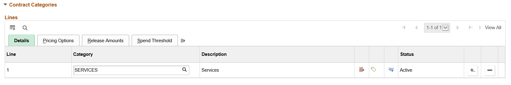

Contract Categories
Use this section to define information for contract categories and line items, including item adjustments, exclusions, and category agreements.
The Contract Categories - Lines section is used to determine the categories that you want to include in the contract. Contract categories enable you to specify groups of items on a contract, rather than entering items one at a time. Contract categories enable you to add categories to a contract, along with item exclusions, upper and lower limits, and price adjustments. When you create requisitions and purchase orders, the system automatically locates and verifies that it uses the appropriate contracts. You can use categories in conjunction with contract lines and open items, but you cannot create contract releases using category contracts.
Along with categories, you define a variety of details, release amounts, and category details. You can also assign agreements for contract categories. Click the Contract Agreement button in the Lines section to add contract agreements for individual categories at the line level. The button is represented by a blue hand-shake icon.
This section is not available for group and special purpose contracts.
Use this group box to define information for contract categories.
See Setting Up Contract Categories.
Use the Copy Contract page (CNTRCT_COPY_SEC) to copy from an established or expired contract.
Navigation:
Click the Copy From Contract link, next to the Set ID on the Contract Entry - Contract page, after adding a new value.
This example illustrates the fields and controls on the Copy Contract ID Page.
Copy Contract ID page
The default status of a copied contract is Open. All contract information including defaults, line items, comments, and price adjustments is copied to the new contract. Staged releases are not part of the actual contract and are not copied. If you are using version control, the current copy of a contract is the version that the system copies.
When you copy a contract and the selected source contract contains more contract lines than the number defined for the maximum number of rows to retrieve on the Purchasing Installation Options page, the system automatically copies the contract using a batch process.
When you select a contract to copy and click the OK button to copy the contract, the system displays the message Would you like to wait until the Contract copy process is completed?
  • If you click No, the system displays a message that the contract has been scheduled for copying with the process instance for the batch job.
  • If you click Yes, the system creates the new contract.
Contract ID
Select the contract to use as a template. If you leave this field blank, the system returns all contracts that have the same process option as the contract that you are creating.
Use the Contract Comments - Header Comments page (CNTRCT_CMNTS_SEC) to enter comments for a transaction.
Navigation:
Click the Add Comments link on the Contract page.
This example illustrates the fields and controls on the Contract Comments - Header Comments page.
After you enter comments on this page, you must save the contract before the comments are entered into storage for later use with the Header Comments page.
Use the Standard Comments page (STD_COMMENTS_PO) to define frequently used comments.
Navigation:
From the Contract Comments - Header Comments Page, click the Use Standard Comments link.
This example illustrates the fields and controls on the Standard Comments page.
You must have already defined standard comment types on the Standard Comment Type page. See Setting Up Standard Comments.
Action
Select the action that you want to perform on the standard comments. Options are:
  • Copy Comment: Select to make standard comments available on the Comments page. You can use the standard comments as they are or modify them. Modifications to the standard comments on the Comments page do not affect the original standard comments. If you select this option, you must also select the standard comment type and comment IDs for the standard comments that you want to use. The text of the selected standard comment appears in the text box at the bottom of the page.
  • Link to Comment: Select to copy a selected standard comment to the Comments page. You cannot modify or add to the text of the comment if you select this option. You can use this option multiple times to include more than one standard comment. If you select this option, you must also select the standard comment type and comment ID for the standard comment that you want to use. The text of the selected standard comment appears in the text box at the bottom of the page.
  • Create New Comment: Select to enter a standard comment for an existing or new comment ID within an existing standard comment type. The comment that you enter becomes a new standard comment available in the standard comment table, and it is carried over to the transaction.
Comment Type
Select a standard comment type code. Standard comment types are defined on the Std Comm Type (standard comment type) page.
Comment ID
Enter a standard comment ID. Different IDs are available depending on the selected standard comment type. These comment IDs are defined on the Standard Comments page.
Use the Contract Defaults by BU - PO Defaults (purchase order defaults) page (CNTRCT_DFLT1_SEC) to set default information for order contracts for each business unit.
If no other defaults appear in the default hierarchy, the information that you set up on this page appears by default in each release schedule that you define for the specified combination of order contract and business unit. This page applies to order contract releases only.
Navigation:
Click the Purchase Order BU Defaults link on the Contract page.
This example illustrates the fields and controls on the Contract Defaults by BU - PO Defaults page.
Contract Defaults By BU PO Defaults page
If the Corporate Contract option is selected on the Contract page, this page is optional. If the option is not selected, setting up business units on this page is required, and you can create order releases only for these business units.
If a contract originates from an RFQ, this information appears by default when the contract is created from the RFQ.
If the contract originates from a requisition, you cannot delete the business unit row or change the business unit.
Specification of default values on this page for related purchase order contracts affects only contracts with a contract processing option of General Contract, Purchase Order, Recurring PO Voucher, or Release to a Single PO.
Although default values appear from the purchasing default hierarchy, you can override those values on the Contract Entry component.
Header
Business Unit
Select the business unit to which the defaults apply.
Copy from BU Defaults (copy from business unit defaults
Click to access the Copy Defaults from Business Unit Page (CNTRCT_COPY_BU_SEC), where you can copy the purchasing business-unit default values from one business unit to another.
Supplier Loc (supplier location)
Select the supplier location for the address that appears on the purchase order for the supplier.
Buyer
Select the buyer to be assigned to the purchase order releases against the contract.
Currency
Select the currency and exchange rate type. These values appear by default from the selected business unit.
Payment Terms ID
Select the payment terms that are expected for the vouchers corresponding to any purchase orders or vouchers that are generated from this contract.
Shipping Information
Ship To
Select the shipping location that you're defining for the item. Ship-to location codes are established on the Ship To Locations page.
Ship To Address
Click to access the Contract Ship To Address page (CNTRCT_ADDRESS) where you can view contract ship-to address details.
IN Unit (PeopleSoft Inventory business unit)
Select a default PeopleSoft Inventory business unit for which you are purchasing the items.
Freight Terms
Select the freight terms code for the Set ID. Values are defined on the Freight Terms page.
IN Unit (inventory unit)
Charge By
Select to charge by amount or quantity. You can charge only by amount for amount-only contract lines.
Ultimate Use Code
Enter an ultimate use code to override the default tax rate for a location. In most cases, sales tax is computed as a use tax based on the tax code that is applicable to the ship to or usage destination. However, the way that merchandise is ultimately used can also affect the tax rate within the same ship to or usage destination.
Where Performed
Select the default location where a service is physically performed most often. Options are Buyer's Location, Ship From Location, Ship To Location, and Supplier's Location.
Additional Link
Add Comments
Click to access the Release Comments page (CNTRCT_DFL_COM_SEC) where you can view and enter free–form text for the order contract. These comments are used as release reminders and remain with the contract. They do not carry over to the purchase order. You can review and modify these comments on the Review Staged Releases page.
Use the Open Item Price Adjustments page (CNTRCT_PRC_ADJ_SEC) to enter price adjustments that apply to items that reference the contract as an open item contract.
Navigation:
Click the Add Open Item Price Adjustments link on the Contract page.
This example illustrates the fields and controls on the Open Item Price Adjustments page. You can find definitions for the fields and controls later on this page.
You use the Open Item Price Adjustments page to maintain price adjustments for open item contracts. The Allow Open Item Reference check box must be selected for you to view this page. Price adjustments that you enter will apply to requisition or purchase order lines that use the open item contract reference. This means that no contract line or category number reference exists.
Header information on this page displays the SetID, contract ID, and version and line numbers if they apply to the contract.
Price Adjustments
Effective Date
Select the date on which price adjustments are effective for this contract. The system uses the calculation method for the effective date to process price rules and adjustment details. You can create a template for only one effective date at a time and can apply item price adjustments into the future by adding a template with a future effective date.
Status
Select an open item adjustment status. Values include:
Active: Select to make the adjustment value active. As long as the adjustment is within the effective date, the system applies the open item price adjustments.
Inactive: Select to make the adjustment values inactive. This means that the system does not apply the adjustments even when they are within the effective date.
Calculation Method
Select the method that the system uses to calculate adjustments. Options are:
Increment Adjustments: Each valid adjustment is made against the current (base or adjusted) price. For example, if you have a base price of 100 USD and two percentage adjustments (price rules) of 10 percent each, then the first adjustment is deducted from the base price of 100 USD, for a current adjusted price of 90 USD. The second adjustment of 10 percent is deducted from 90 USD for a final adjustment price of 81 USD.
Sum All Adjustments: Adjustments are summed and made against the original base price. For example, if you have a base price of 100 USD and two percentage adjustments of 10 percent each, the system takes the total adjustment of 20 percent and deducts it from the base price of 100 USD for a final adjusted price of 80 USD.
Price Rule
Price rules enable you to set pricing criteria and define the adjustment method, restrictions, and details. These values are processed according to how you define the calculation method.
Sequence
Enter the sequence number for the ascending sequence that the system follows when applying price adjustments. The order is in an ascending sequence. The sequence distinction is important if percentage adjustments exist. The amount that the percentage represents can vary depending on the order in which the adjustments are applied. You cannot change the sequence number of system-calculated adjustments for the base price.
Displays the supplier price location to use for pricing on this contract line.
Currency
Displays the supplier currency that appears by default from the Contract page. The default value for the field is the business unit currency.
General Adjustment
Select if this is a general or normal adjustment that is not used as a unit of measure or ship to adjustment. When you select General Adjustment, the Match Shipto and Ship to check boxes become unavailable for entry.
Note: You must select either the General Adjustment or Match Shipto method.
Match Shipto
Select if this adjustment is based on the ship to ID. For example, if the supplier gives you an additional 5 percent discount if you purchase items within your own state, you could define a price adjustment for each ship to location within your state.
Ship To
Select a ship to ID for which the adjustment is to be applied. This field becomes available for entry if you select the Match Ship check box.
For the ship to adjustment to be applied by the system, the ship to ID that you enter here and the ship to ID on the purchase order must match. All ship to IDs are available. This field is required when the Match Shipto check box is selected.
Hard Price
Select to have the system apply the price resulting from an adjustment regardless of any other adjustments it finds.
Ignore If Other Adjustments
Select this adjustment restriction to create a price adjustment scenario in which the system ignores this price adjustment if the contract qualifies for another adjustment. If another adjustment does not apply, this adjustment will apply even if the Ignore If Other Adjustments check box is selected.
Stop Price Calculation Here
Select to have the adjustment that you defined set a final price. If the check box is selected, the system does not calculate any further adjustments.
Adjustment Details
Only one detail row can exist for open-item price adjustments.
Method
Open items can be adjusted by percentage only. Percentages can be either positive or negative. A negative adjustment means that the price or schedule value is reduced by the adjustment, that is, a discount is applied. A positive adjustment means that the price or schedule value is increased by the adjustment, that is, a surcharge is applied.
Adjust Percentage (adjustment percentage)
Enter the percentage of the adjustment.
