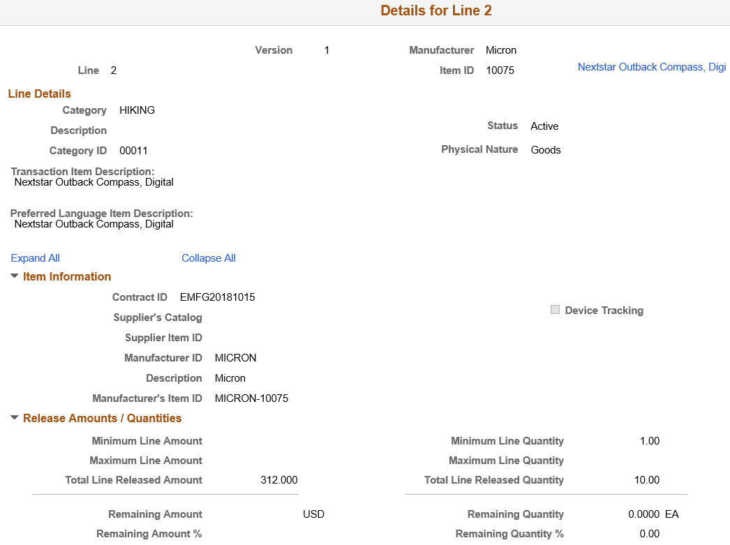

Details for Line Page (Manufacturer)
CNTRCT_PRC_UOM_SEC
View details for the Manufacturer contract line.

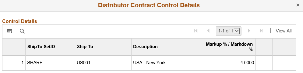

Distributor Contract Control Details Page
CNT_MFG_DST_SEC
View or modify the business unit, contract domain, or ship to for the Distributor.

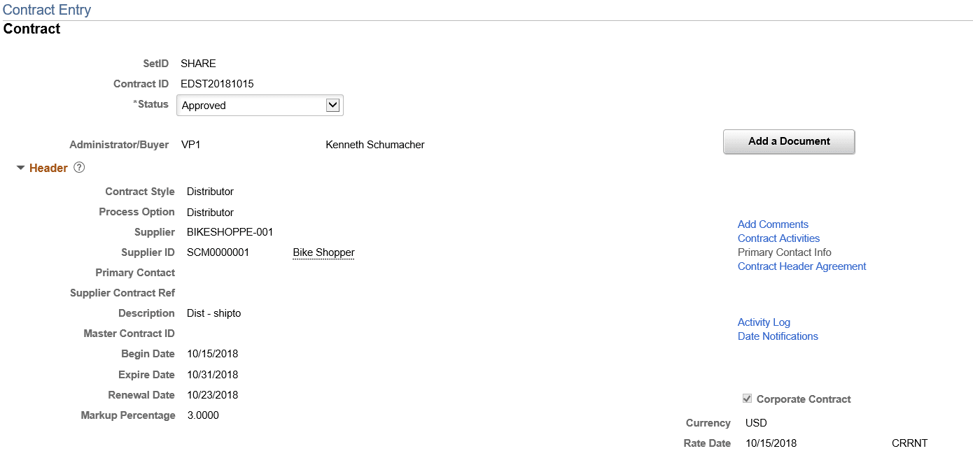

Contract Entry - Contract Page (Distributor)
Use the Contract Entry - Contract page (CNTRCT_HDR) to create Distributor contracts.
Navigation:
Supplier Contracts, and then Create Contracts and Documents, and then Contract Entry
Procurement Contracts, and then Add/Update Contracts
This example illustrates the fields and controls on the Contract Entry - Contract Page (Distributor) (1 of 2).
Contract Entry - Contract page (Distributor) 1 of 2
This example illustrates the fields and controls on the Contract Entry - Contract Page (Distributor) (2 of 2).
Contract Entry - Contract page (Distributor) 2 of 2
Create a Distributor contract for each distributor with a markup or markdown and default start and end dates. A Distributor Contract can be used with multiple Manufacturer Contracts. Markups and markdowns can vary by business unit, contract domain, and Ship To.
To create Distributor contracts, .the Contract Process Option must be Distributor:
  1. Access the Contract Entry - Add a New Value page
  2. Contract ID defaults to Next, as long as you have setup automatic numbering on the Application Fundamentals: Auto Numbering Page and selected the Distributor Contracts check box in the Auto Numbering section of the Contract and Vendor Rebate Controls page. Otherwise, enter a contract number.
  3. Select Distributor in the Contract Process Option field.
  4. Select a style ID that is associated with the Distributor contract process option, in the Style ID field.
  5. Click the Add button.
Distributor contracts are similar to other procurement contracts with these exceptions:
  • Many fields that appear for procurement contracts do not appear for distributor contracts, such as; Tax Exempt, Tax Exempt ID, Open Item, Auto Default, Categories, PO Defaults, Schedule Defaults, Voucher defaults, maximum amounts, and so on.
  • Many fields that appear for distributor contracts function the same as procurement contracts with the exception of the fields defined below.
    For field definitions on Procurement contracts, see Contract Entry - Contract Page.

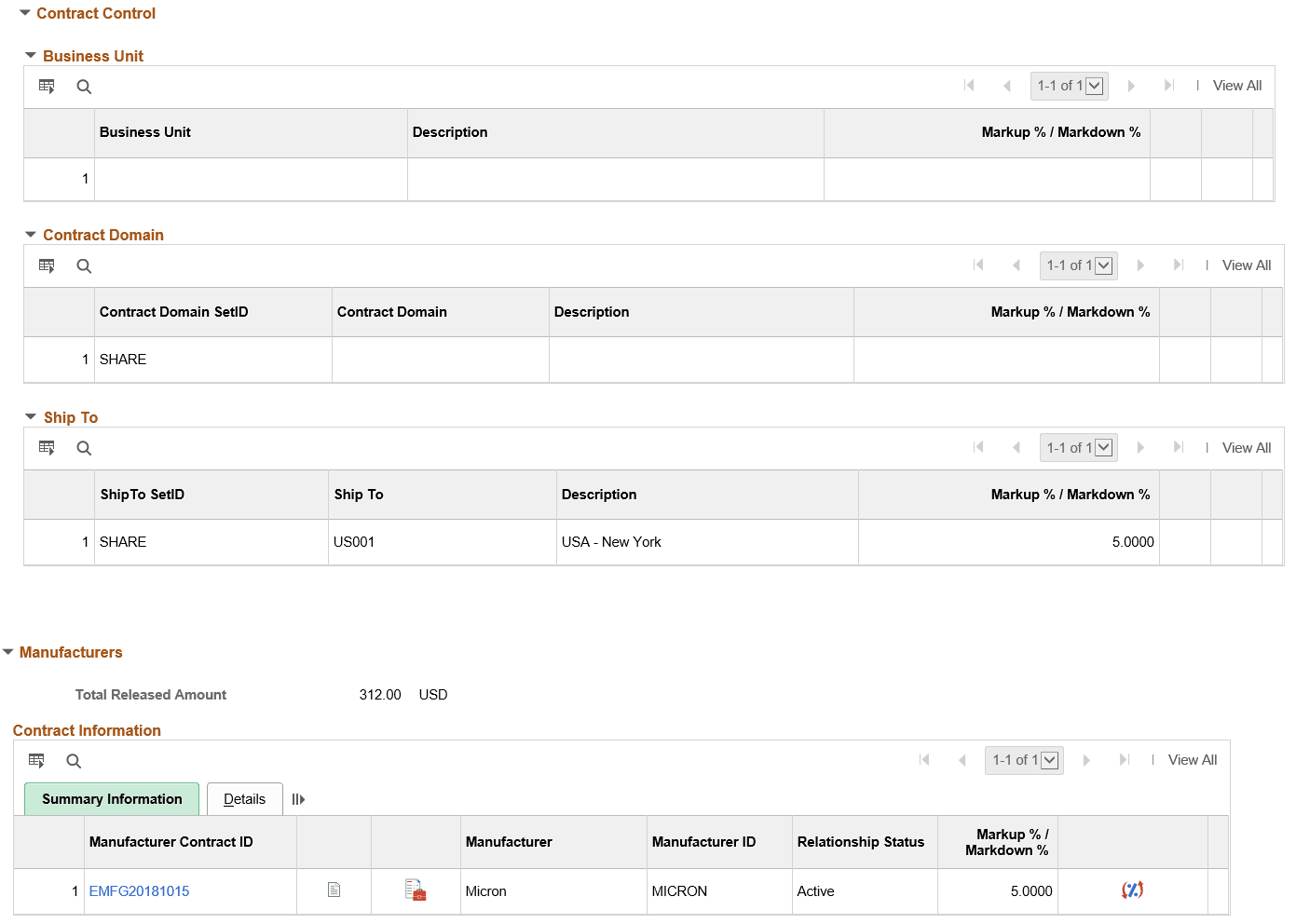

Contract Control: Business Unit, Contract Domains, Ship To
Enter the business units, contract domains, ship to’s, or a combination of each as well as the markup or markdown percent. Each section appears only if selected in the Contract Usage Options section of the Contract and Vendor Rebate Controls Page. These values appear by default on the Manufacturer contract when that Manufacturer contract is associated with a Distributor contract. When associating a Distributor contract with a Manufacturer contract, the business unit, contract domain, ship to, and markup information is copied to the Manufacturer contract and can be edited.
Only contracts in an Open status can be edited.
If you change the options in the Contract Usage section of the Contract and Vendor Rebate Controls page, the change only impacts contracts created from that point in time and forward.
Field or Control Description
Markup % (percent) / Markdown % (percent)
Enter a percentage for the Distributor contract. This value can be a positive or negative amount, which is considered a mark up or markdown percent.
When a Distributor contract is linked to a Manufacturer contract, this information is used as a default and can be overridden on the Manufacturer contract.
These values are not used when pricing a requisition or purchase order.
Manufacturers
This section lists all Manufacturer contracts where this Distributor contract is used. Changes to the relationship between a Distributor and a Manufacturer should be performed at the Manufacturer contract level.

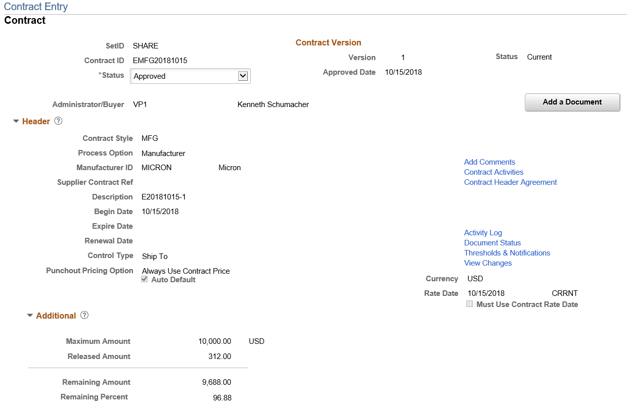

Contract Entry - Contract Page (Manufacturer)
Use the Contract Entry - Contract page (CNTRCT_HDR) to create a manufacturer contract.
Navigation:
This example illustrates the fields and controls on the Contract Entry - Contract Page (Manufacturer) (1 of 2).
Contract Entry - Contract (Manufacturer) 1 of 2
This example illustrates the fields and controls on the Contract Entry - Contract Page (Manufacturer) (2 of 2).
Contract Entry - Contract (Manufacturer) 2 of 2
Manufacturer contracts are similar to other procurement contracts with these exceptions:
Manufacturer ID
Select a Manufacturer ID. This field can be changed unless the contract has been approved and saved, or one or more Distributor contracts have been connected.
The Manufacturer ID is created using the Manufacturers Page.
Note: This is a required field.

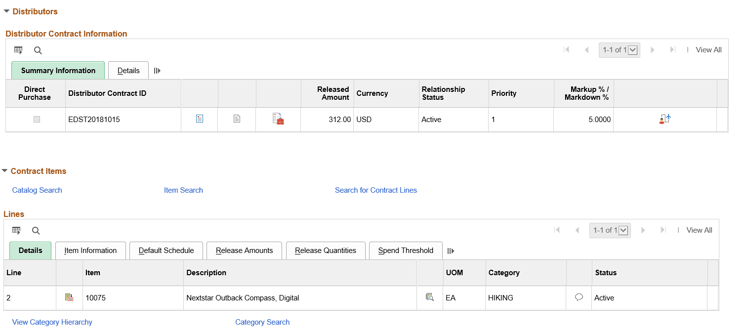

Distributors
Use this section to identify the Distributor contracts that can purchase items from this Manufacturer and what the markup or markdown is. A manufacturer contract can be associated with many Distributors. Manufacturers can have specific distributor contracts for the items on this contract.
This section appears only when usage, pricing, or both options are selected on the Contract and Vendor Rebate Controls Page, and the Control Type for this Manufacturer contract matches a control type on the Distributor contract.
Direct Purchase
Displays as selected when the Distributor and Manufacturer contracts have the same Supplier. This field is display-only and is determined on the Manufacturers Page. The manufacturer must also be setup as a distributor. This field only appears when this relationship is present.
Distributor Contract ID
Select a Distributor contract that can be used with the Manufacturer contract. The Manufacturer contract must be in a Draft or Open status in order to add Distributor contracts.
More than one Distributor contract can be added.

For additional information about a Direct Purchase Manufacturer, see Defining Manufacturer IDs.
View Contract icon (view contract)
Click to access Distributor contract information in a display-only window. This includes the distributor contract controls (business unit, contract domain, and ship to) and the markup or markdown percent.
Document icon (document)
Click to access an Authored Document, if one exists, in a display-only window. Supplier Contract Management must be installed.
Document Management icon (document management)
Click to access the PeopleSoft Supplier Contract Management: Document Management Page Supplier Contract Management must be installed.
Released Amount
Displays the total amount released (to date) for the Manufacturer and Distributor combination. The amount value is expressed in the Manufacturer contract currency.
  • If a Distributor contract is added to a Manufacturer contract there is no impact to the Manufacturer totals because the Distributor has not been used against the Manufacturer contract.
  • If a Distributor contract is deleted from an Manufacturer contract, there is no impact to the Manufacturer totals because you can only delete a Distributor contract when no activity has occurred within the Distributor and Manufacturer combination.
  • If a Distributor contract is inactivated from an Manufacturer contract, there is no impact to the Manufacturer totals because transaction are not allowed.
  • If a Distributor contract is inactivated and then reactivated for a Manufacturer contract, released amounts accrue within the relationship. However, the system requires that a new version of the contract be created. New transactions that occur are tracked in the new version.
Currency
The currency is always displayed using the currency on the Manufacturer contract header.
Relationship Status
Select an option to change the Manufacturer and Distributor relationship.
A Distributor can be removed from a Manufacturer contract as long as a requisition or purchase order does not exist for that Distributor.
If a requisition or purchase order exists, then you can change the relationship status to Inactive as long as all purchase orders that use this relationship are closed. When Inactive, the Distributor cannot be used on a requisition or purchase order.
An inactive relationship can be change to Active as long as another active relationship does not exist for the same Supplier. This means that multiple Distributor contracts can exist for the same Supplier, but only one active relationship can exist for that Supplier.
Priority
Enter a unique number, using one (1) as the top priority. This value is used by the system when a supplier is not provided on a requisition. The system selects the distributor with the highest priority.
Markup % / Markdown % (markup percent or markdown percent)
Enter a different markup or markdown percent if needed. This value appears by default from the Distributor contract, but can be changed on the Manufacturer contract.
If the Distributor contract does not have business unit, contract domain, or ship to values, then this value is used when a requisition or purchase order is created for the Manufacturer.
Control Details icon (control details)
Click to access the Distributor Contract Control Details Page. This window provides the control fields (business unit, contract domain, and ship to) and markup or markdown percent for the mine distributor.
These values can be change on this page and saved. Original values are defaulted from the distributor contract.
Contract Items
Search for and enter contract line information for the Manufacturer contract. The markup or markdown percent, which is determined on the distributor contract, determines the price on the manufacturer contract.
If the Auto Default flag is selected on the contract, you cannot have multiple line items that have the same item ID, unless a unique GTIN exists. The GTIN appears in the Details for Line Page (Manufacturer), UOM/Pricing section.
Catalog Search, Item Search, and Search for Contract Lines
Click to access the Search pages to select line items. Manufacturer contracts only support line items, not open items or categories.
Note: There could be multiple suppliers through Distributor contracts. Therefore, the Supplier for the Manufacturer (selected on this page) is used. See PeopleSoft Purchasing: Contract Search Page, PeopleSoft Purchasing: Item Search Criteria Page, PeopleSoft Purchasing: Category Search Page
Details tab
Select the items for the manufacturer contract.
Icons available are: Item Details, Item Search, and Line Comments.
Item Information tab
The manufacturer identifies the available items with the Universal Product Number (UPN). The Manufacturer ID, Manufacturer Item ID, UPN Type Code, and UPN ID is tracked on the contract. The UPN information from the contract is copied to transactions such as the requisition and purchase order. Receipts access the UPN information from the purchase order, and the voucher can access the UPN information from the receipt or purchase order.
For inventory items, if you have set up the information in the Item Manufacturer UPN table, this information appears by default into the contract. If you order by UPN ID, the item ID and related information is copied to the purchase order or requisition line. The system verifies that the UPN ID is valid for inventory items and matches what is set up in the Item Manufacturer UPN table.
You can maintain UPN information for non-inventory items. The UPN for a description-only (Ad Hoc) item is not validated.
Supplier Item ID and Supplier Catalog fields have values only with a Single Supplier Direct Purchase contract.
The Supplier Item ID and Supplier’s Catalog fields appear from the Item(???) selected. The link between the Manufacturer and Supplier is optional, therefore, this information may or may not appear. In addition, there could be multiple Suppliers based on the Distributor contracts associated with this Manufacturer contract.
The Manufacturer ID, UPN Type Code, and UPN ID appear by default from the Manufacturer ID on the contract and cannot be changed from this location. If changes are made to Supplier Item tables or the Manufacturer information after the line is saved, the changes are not reflected on the contract.
All items selected must have an item ID and Manufacturer ID.
Use the Details for Line page (CNTRCT_PRC_UOM_SEC) to view item details for the Manufacturer contract line.
Navigation:
From the Contract Entry - Contract page, in the Contract Items - Lines section, Details tab, select the Line Details icon.
This example illustrates the fields and controls on the Details for Line Page (Manufacturer) (1 of 2).
Details for Line window (Manufacturer) (1 of 2)
This example illustrates the fields and controls on the Details for Line Page (Manufacturer) (2 of 2).
Details for Line window (Manufacturer) (2 of 2)

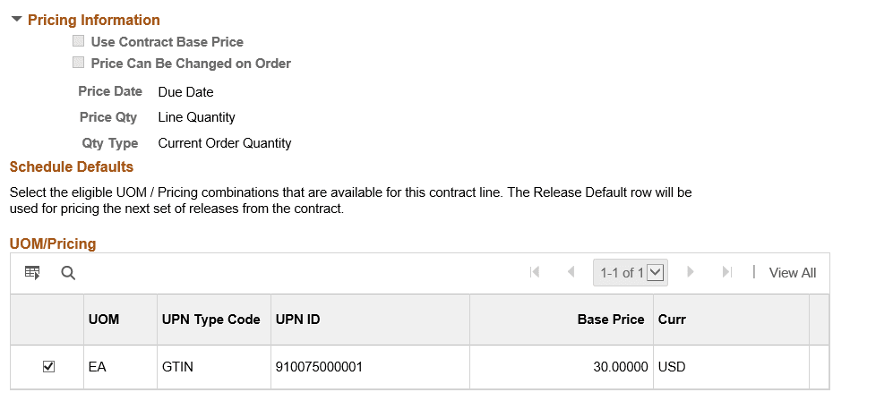

Schedule Defaults: UOM/Pricing
If you change the base price in this section, it impacts all distributors who purchase that item.
GTIN is a UOM dependent field. Therefore the contract line is limited to allow only one UOM value. When the GTIN is places on a purchase order, the UOM is not converted to another UOM.
Use the Distributor Contract Control Details page (CNT_MFG_DST_SEC) to view the contract controls and markup or markdown percent for the Distributor.
Navigation:
From the Distributor Contract Information section of a Manufacturer contract, Summary Information tab, click the Control Details icon.
This example illustrates the fields and controls on the Distributor Contract Control Details page.
This window is only available if the usage and pricing options are selected on the Contract and Vendor Rebate Controls Page. The first fields that appear depend on the Control Type selected on the Manufacturer header. All Usage Control Types from the associated Distributor contracts appear.
The contract control (business unit, domain, and ship to) information is used to restrict usage. Each contract domain can have a different agreement with the manufacturer.
Contract control information can be added only if they exist on the Distributor contract.
If purchase order releases do not exits for the Distributor, then the business unit, contract domain, and ship to information can be modified or deleted.
Displays the value entered in the Contract Control section of the Contract Entry - Contract Page (Distributor) for the matching business unit, contract domain, or ship to. In addition, this column only appears if the Pricing option is selected on the Contract and Vendor Rebate Controls Page.
This value is applied to the base price, which is then used when a requisition or purchase order is created.
