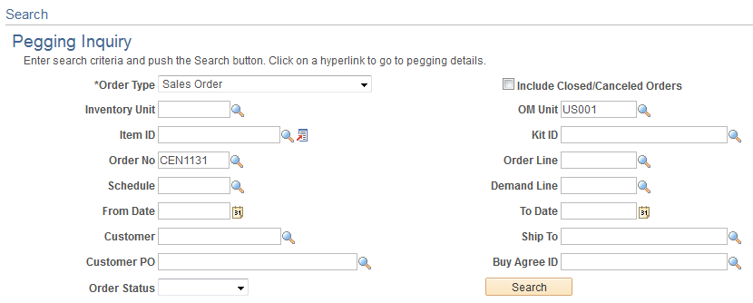

Use the Search - Pegging Inquiry page (IN_PEG_SEARCH) to enter search criteria and select the demand or supply to review.
Navigation:
Inventory, and then Order Pegging, and then Pegged Order Inquiry
This example illustrates the fields and controls on the Search - Pegging Inquiry page. You can find definitions for the fields and controls later on this page.
This page uses the same fields as the Search - Pegging Workbench page plus a few additional options.
Field or Control Description
Order Type
Select an order type for the peg chains to be viewed. The order type selected determines the search criteria fields displayed. This page includes all the order types that are used by the Search Pegging Workbench page plus one more option:
WO Non-Inventory: (demand-side) Select to view peg chains that link work orders in PeopleSoft Maintenance Management to non-inventory items on a requisition or purchase order in PeopleSoft Purchasing. This selection opens up the following search criteria fields: Work Order Unit (PeopleSoft Maintenance Management business unit), Work Order ID, Task Number, Line, Work Type, Service Group, and Shop.
In addition, this page enables you to view sales orders with configured items that were pegged using the PeopleSoft Product Configurator setup. These pegs can be viewed but not changed.
Include Closed/Canceled Orders
Select to search for orders with a closed or canceled status.

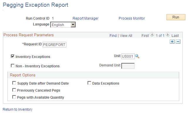

Use the Pegging Exception Report page (IN_PEG_REP) to enter parameters and run the Pegging Exception Report (INS9095) process.
Navigation:
Inventory, and then Order Pegging, and then Pegging Exception Report
This example illustrates the fields and controls on the Pegging Exception Report process page. You can find definitions for the fields and controls later on this page.
Inventory Exceptions
Select to include inventory items in the pegging exception report.
Unit
Enter the PeopleSoft Inventory business unit for inventory item pegging exceptions.
Non-Inventory Exceptions
Select to include non-inventory items used in work orders in the pegging exception report.
Demand Unit
Enter the business unit for PeopleSoft Maintenance Management.
Report Options
Select to produce the following reports:
Supply Date after Demand Date
Select to produce a report of peg chains whose supply date is after the demand date; that is, the supply will come in too late to satisfy the demand.
Data Exceptions
Select to produce a report of:
  • Peg chains where the supply or demand quantity is less than the pegged quantity.
  • Peg chains where the inventory business unit of the demand does not match the supply.
  • Incorrect pegged status, where orders have pegs but the peg status on the line is turned off and vice versa.
  • Canceled transactions with open pegs, where a transaction which has been canceled still has pegs remaining against it.
Previously Canceled Pegs
Select this check box to produce a report of peg chains where the supply or demand has been canceled. The system breaks the peg chain automatically when this happens.
Pegs with Available Quantity
Select this check box to produce a report of peg chains where open peg quantity exists and there is available quantity for the item currently in the inventory business unit that could be used to fulfill the demand line.
