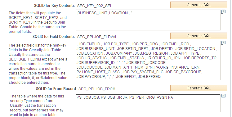

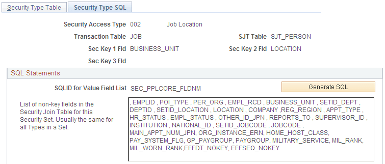

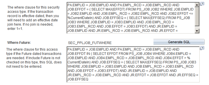

Security Type SQL Page
SCRTY_TYPE2_SQL
Enter the SQL statements for the new security types.

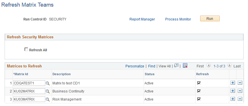

Refresh Matrix Teams Page
SCRTY_MX_REFRESH
Refresh security-related matrix teams.

The system only creates future-dated security rows in SJT_PERSON when you:
  1. Select one or more actions on the Security Installation Settings page.
  2. Enable future-dated rows for the security access type.
    This enables you to use future-dated security with some types but not others.
  3. Create and save a future-dated row in a component that uses the JOB record using one of the actions you selected on the Security Installation Settings page.
If you have selected the action of Transfer in the Actions that trigger Future Dated Security Rows grid, then when you create a future-dated Job Data row with the action of Transfer for a person, the system will add a row to the SJT_PERSON with the transaction data from the new row. Users with data permission to the future-dated transaction security data will have access to the person's data.
Only component security views use future-dated security rows.

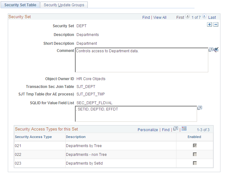

Security Set Table Page
Use the Security Set Table page (SCRTY_SET_TBL) to review existing security sets and the security access types you've attached to them.
Navigation:
Set Up HCM, and then Security, and then Core Row Level Security, and then Security Sets, and then Security Set Table
This example illustrates the fields and controls on the Security Set Table page. You can find definitions for the fields and controls later on this page.
Field or Control Description
Object Owner ID
Security sets with a PeopleSoft Object Owner ID are system data and not available for modification on this page. You can still modify the Security Update Groups of delivered security sets.
Transaction Sec Join Table
The security join table that stores the transaction data for this security set.
Note: If you are creating a new security set, you must have created this table in Application Designer before creating the security set. Creating a new security set requires modification of the system. Please refer to the Security technical brief on My Oracle Support for directions.
SJT Temp Table (for AE process)
The temporary record used for PeopleSoft Application Engine. It is a copy of the transaction security join table and also contains the Application Engine process fields. This table updates the transaction security join field using the Application Engine process.
SQLID for Value Field List
The list of fields (not including the key fields) that are in the transaction security join table.
Generate SQL
Click to generate the SQL and SQLID for the value field list.
Security Access Types for this Set
The system lists the security access types for this security set and indicates which ones are enabled. Enable or disable security access types on the Security Type Table page.
See Security Type Table Page.

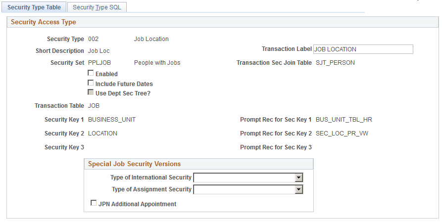

Use the Security Type Table page (SCRTY_TYPE2_TBL) to enable or modify existing security access types or create new ones.
Navigation:
Set Up HCM, and then Security, and then Core Row Level Security, and then Security Access Type, and then Security Type Table
This example illustrates the fields and controls on the Security Type Table page. You can find definitions for the fields and controls later on this page.
You can enable more than one security access types for a security set and you can assign data permission access to a permission list using more than one access type.
PeopleSoft has delivered the most asked for security access types and you should not need to create new types. Enable or disable the types your installation requires.
Please refer to the Security technical brief on My Oracle Support for directions on how to create new security types.
The more security access types you enable and options you use, the more rows of data the system stores in the security join tables. This affects system performance. PeopleSoft advises you to enable only the security types and options required to manage your data permission needs.

Security Type
The system automatically numbers new security types.
Transaction Label
Enter a field label. The system will display this label on a transaction page when the security access type is used as a field to gather data.
For example, if you are using fields in addition to POI type to control access to the data of POIs without jobs, the system will use the label you enter here on the Add a POI Type page and Edit POI Relationship page to prompt for security transaction values.
Security Set and Transaction Sec Join Table
The security set whose data you are securing and the security join table associated with the security set.
See Security Set Table Page.
Enabled
Select to enable the security type.
Include Future Dates
Select to enable the security join tables to store future-dated security rows for this type. The system will only update the security join tables with the future-dated rows that have the actions you selected on the Security Installation Settings page.
Use Dept Sec Tree? (use department security tree?)
Select if this security type uses the department security tree.
You can only create department security trees for departments and can only grant data permission based on department security trees to row security permission lists.
Transaction Table
The transaction table that stores the field or fields that will control security for this type.
Special Job Security Versions
If you enable special job security versions on the Security Installation Settings page, enable the options for this security access type.
See Security Installation Settings Page.
Security Key 1, Prompt Rec for Sec Key 1 (prompt record for security key 1), Security Key 2, Prompt Rec for Sec Key 2 (prompt record for security key 2), Security Key 3. and Prompt Rec for Sec Key 3 (prompt record for security key 3)
Define the security data fields for this type. The fields need to be on the Transaction Table record.
The prompt record is the record the prompt field values come from when you are assigning values to a permission list. You must select all the records and fields necessary to make a unique qualification here.
For example, to select a location (key 2), you first need to select a business unit (key 1). The prompt record for the BUSINESS_UNIT field is BUS_UNIT_TBL_HR and the prompt record for the LOCATION field is LOCATION_TBL.

Use the Security Type SQL page (SCRTY_TYPE2_SQL) to enter the SQL statements for the new security types.
Navigation:
Set Up HCM, and then Security, and then Core Row Level Security, and then Security Access Type, and then Security Type SQL
This example illustrates the fields and controls on the Security Type SQL page (1 of 3). You can find definitions for the fields and controls later on this page.
This example illustrates the fields and controls on the Security Type SQL page (2 of 3). You can find definitions for the fields and controls later on this page.
This example illustrates the fields and controls on the Security Type SQL page (3 of 3). You can find definitions for the fields and controls later on this page.
The Application Engine uses the SQL fragments on this page to build the update and insert statements to update the transaction security join table.
You can use any SQLID but when you click the Generate SQL buttons, the system generates unique IDs based on the security set and/or type.
WARNING:
This page should only be used by users with a strong understanding of SQL joins and the table relationships.

Use the Refresh Security Matrix Teams page (SCRTY_MX_REFRESH) to refresh security-related matrix teams.
Navigation:
Set Up HCM, and then Security, and then Core Row Level Security, and then Refresh Matrix Teams, and then Refresh Matrix Teams
This example illustrates the fields and controls on the Refresh Matrix Teams page.
After a matrix team is registered, use the Refresh Matrix Teams run control page, which allows either refreshing or creating of content for all registered matrix teams (Refresh All) or for individually selected matrix teams, to run the Refresh Matrix Teams (SCRTY_MX_REF) process. This process populates the security Matrix Team Results (SCRTY_MXRES_TBL) transaction table that is used in security access. The process will also remove any inactive matrix teams that are identified on this page. Matrix Teams that are future dated will not be picked up by this process.
You need to run the process from the Refresh Transaction SJT tables component to pick up the information stored in the Matrix Team Results (SCRTY_MXRES_TBL) transaction table.
Refresh All
Select this option to refresh or generate new content for all active registered security related matrix teams. Any inactive registered matrix teams will be removed from the security results table.
To register a team for security purposes, see the Matrix Team Registration Page.
Matrix Id
Select from those matrix teams that were registered on the Matrix Team Registration Page.
Status
Indicates if this matrix team is active or inactive. The Security Matrix Team Refresh process generates new content and updates the security Matrix Team Results table for active matrix teams and removes content for inactive matrix teams listed on this page.
Refresh
Select to refresh (add, update, or remove) specific rows of matrix team data. The process will use the selected data to update the Matrix Team Results (SCRTY_MXRES_TBL) transaction table accordingly. The system will process only those rows that are selected, unless the Refresh All option is selected and then all rows will be processed.
When the Access Type Matrix Team (046) is enabled, the security sync AE program will pick up and generate entries in SJT_PERSON for all employees found in the associated matrix team table. To enable an Access Type, see Security Type Table Page.
