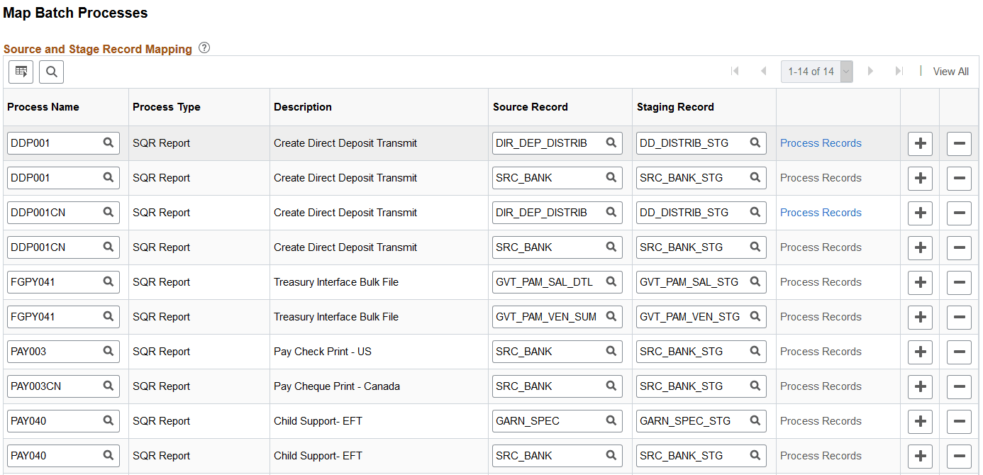

Map Batch Processes Page
HSC_PRCSSTG_MAP
Identify application batch processes that display unmasked data in output files.

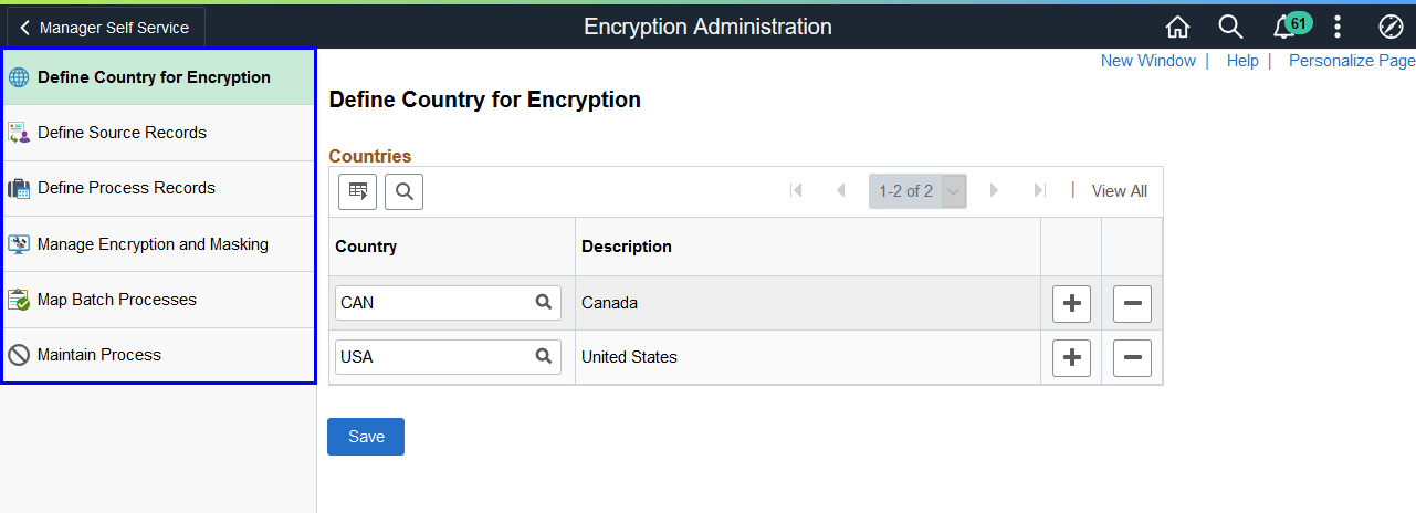

Encryption Administration Navigation Collection for Framework Setup
Use the Encryption Administration component to access the pages that are used to configure the Encryption Framework. Pages appear in the navigation collection for easy access.
Administrators must have the Encryption Configuration Admin role to access this setup component.
This example illustrates the Encryption Administration component, which lists pages that used to set up the Encryption Framework in HCM.
Encryption Framework setup using the Encryption Administration component
In this topic, Payroll for North America is used as an example to demonstrate the setup of the Encryption Framework.

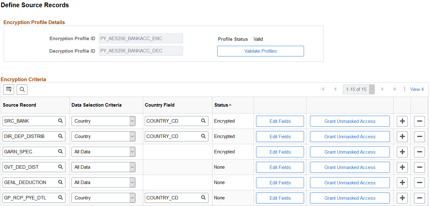

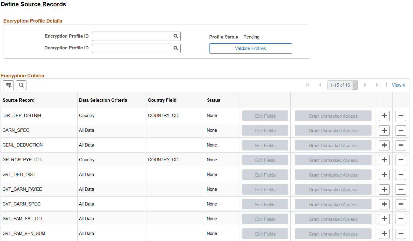

Define Source Records Page
Use the Define Source Records page (HSC_CRYPTRUN) to define encryption criteria.
Navigation:
Set Up HCM, and then Common Definitions, and then Encryption Configuration, and then Encryption Administration, and then Define Source Records
This example illustrates the fields and controls on the Define Source Records page before the encryption process is run. Fields in the Encryption Criteria section are read-only.
Define Source Records page before encryption
This example illustrates the fields and controls on the Define Source Records page after the encryption process is run, in which the fields in the Encryption Criteria section become editable.
This screenshot shows the system-delivered data for Payroll for North America, which includes the DIR_DEP_DISTRIB (direct deposits), GARN_SPEC (garnishment), and SRC_BANK (source bank) source records. To comply with Nacha requirements, do not change the delivered data.
Encryption Profile Details
Field or Control Description
Encryption Profile ID, Decryption Profile ID, and Validate
Specify a profile that will be used by the framework to encrypt and decrypt data (bank account numbers in this example) respectively. You may use existing profile IDs you have already created provided they are not based on 3DES algorithm, or create new profile IDs.
Important: The IDs in this screenshot are for illustration purposes only. Use your own set of profile IDs; do not use any of the profiles provided as sample data.
Click the Validate button to verify the profiles specified. The system updates the profile status to Valid after the profiles are validated successfully.
For more information about encryption profiles, see PeopleTools: Security Administration, “Securing Data with PeopleSoft Encryption Technology”, Defining Encryption Details.
Encryption Criteria
Source Record
Specify the “source-of-truth” record(s) that store and maintain the data to be encrypted and masked.
For Payroll for North America, the source records for storing the data are DIR_DEP_DISTRIB, GARN_SPEC, and SRC_BANK.
Note: The framework allows customers to add new source records with a corresponding source record field to store the encrypted data. Since the field name can be determined by the user, there is no validation to ensure the selections are correct when using the prompts.
Data Selection Criteria
Select the scope of data encryption. Values are:
All Data: Selects all data in the record for encryption.
Country: Selects data that belongs to the countries specified on the Define Country for Encryption Page for encryption.
Country Field
Enter the field in the source record that is used to identify the country to which a row of data belongs. This field becomes available for selection if the data selection criteria is set to Country. The lookup prompt shows the fields of the source record.
For Payroll for North America, the framework uses the COUNTRY_CD field in DIR_DEP_DISTRIB and SRC_BANK records to identify country-specific data rows that are subject to encryption. Data (account numbers) that belongs to the countries (specified on the Define Country for Encryption page) from the corresponding source record will be encrypted.
Status
Displays the current encryption status of the source record. Values are:
None (no action has been performed on the data in the source record – delivered value).
Encrypted (data in the source record is encrypted).
Decrypted (data in the source record is decrypted).
Edit Fields
Select to change the field mapping of the data to be encrypted on the Field Mapping Page, if needed. This page is editable when the source record is in the Decrypted status.
Grant Unmasked Access
Select to specify roles for users who can view unmasked data on the Grant Unmasked Access Page.

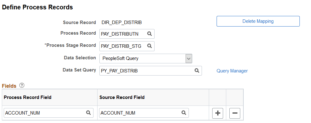

Define Process Records Page
Use the Define Process Records page (HSC_MASKREC) to define process records for batch processes that display unmasked data.
Navigation:
Set Up HCM, and then Common Definitions, and then Encryption Configuration, and then Encryption Administration, and then Define Process Records
This example illustrates the fields and controls on the Define Process Records page.
This screenshot shows the system-delivered data for Payroll for North America, which is the DIR_DEP_DISTRIB source record. To comply with Nacha requirements, do not change the delivered-system data for the Process Record and Process Stage Record fields.
Some applications have batch processes that display the sensitive data in its actual, unmasked form in the output files. For example, the account numbers that appear in direct deposit transmit files created by the DDP001 process need to be unmasked. For the unmasked data to display in its outputs after the encryption is run, the batch process (DDP001) copies the required data from the process record (defined on this page) to perform data unmasking in the stage record. The stage record structure must match the process record + one additional key field PROCESS_INSTANCE as the first key field.
Use this page to define an association between a process record (where the masked data is stored) and a source record (from where the application batch process retrieves the encrypted data to unmask the data coming from the process record).
The framework allows the customers to define a process record with a corresponding process stage record to decrypt data. Since the field name can be determined by the user, there is no validation to ensure the selections are correct when using the Process Record Field and Process Stage Record field prompts.
Process Record
Specify the record that contains the sensitive data that needs to be unmasked.
The sensitive data is masked in the process record after the encryption process is run.
Specify the temporary record that will be used by the application batch process to unmask data, using the required data copied from the process record.
The stage record structure must match the process record, plus one additional key field PROCESS_INSTANCE as the first key field.
Data Selection
Select the data selection option. Values are:
PeopleSoft Query: Use this option if it is not possible to define a join between the source and process records. This usually requires additional tables to be used to build the join to define a 1:1 relationship for the data in the 2 records.
For Payroll for North America, PeopleSoft Query SELECT should have all columns of the process record plus the account number field(s) from the source record. No other columns should be part of the SELECT.
Join Source Record: Use this option of the key structure if source and process record can be mapped to define a 1:1 relationship for the data in the 2 records.
Data Set Query
This field is available if the Data Selection field is set to PeopleSoft Query. Use the Query Manager link to identify the PS Query to be used to define the data mapping between the process and source records.
Note: PS Query will display the masked account numbers stored in ACCOUNT_NUM once encryption is run. At this time, we don’t deliver a process to display the unmasked account numbers.
Note: The framework allows the customers to define the query. Since the field name can be determined by the user, there is no validation to ensure the selections are correct when selecting the query name in the prompt.

Fields
Process Record Field and Source Record Field
Use Process Record Field to identify one or more fields from the specified process record that should be masked, and Source Process Field to specify their corresponding fields from the specified source record to get the actual values during the unmask process.

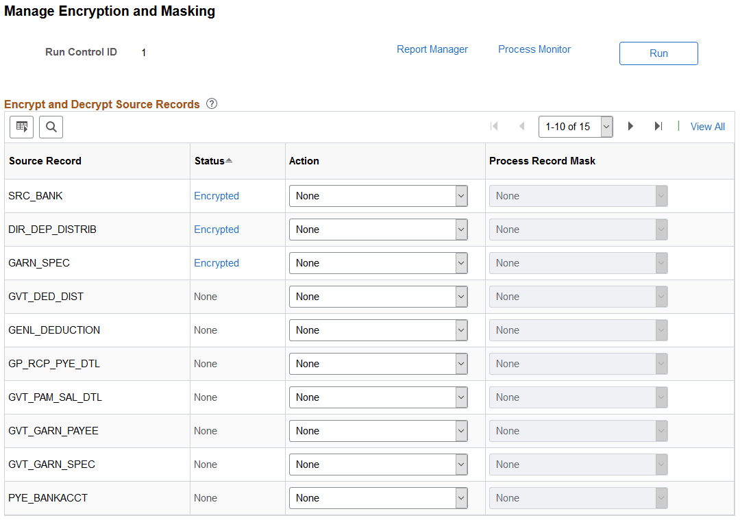

Manage Encryption and Masking Page
Use the Manage Encryption and Masking page (HSC_CRYPT_RCTL) to run the encryption process for specified source records.
Navigation:
Set Up HCM, and then Common Definitions, and then Encryption Configuration, and then Encryption Administration, and then Manage Encryption and Masking
This example illustrates the fields and controls on the Manage Encryption and Masking page.
Run
Click to run the encryption and masking process (HCCRYPTAE) to encrypt (or decrypt) and mask (or unmask) data for the source records using the specified parameters.
Encrypted data can only be viewed with a query; it’s not available on any delivered online page.
Encrypt and Decrypt Source Records
Use this section to specify the parameters used to run the encryption process.
Source Record
Displays the “source-of-truth” records that are defined on the Define Source Records Page.
Status
Decrypted
Encrypted: Click the link to view the list of countries with encrypted data from the source record on the Encryption Details Page.
None
Action
Select an action to be performed on the source record. Available values are based on the current encryption status:
None: available to all statuses.
Decrypt: available when the status is Encrypted.
Encrypt: available when the status is None or Decrypted.
Process Record Mask
Select a masking action to be performed on the process record. Available values are:
Always Mask
Do Not Unmask
None (this is the only available mask action if the source record is not associated with any process record)
Unmask
The availability of these mask values are controlled based on the current action value for the source record.
For example, for Payroll for North America, the following values are available for the DIR_DEP_DISTRIB source record:
Always Mask: available when the action is Encrypt.
Do Not Unmask: available when the action is Decrypt.
None: available when the action is None.
For the GARN_SPEC and SRC_BANK source records, the only available mask action is None.
Use the Map Batch Processes page (HSC_PRCSSTG_MAP) to identify application batch processes that display unmasked data in output files.
Navigation:
Set Up HCM, and then Common Definitions, and then Encryption Configuration, and then Encryption Administration, and then Map Batch Processes
This example illustrates the fields and controls on the Map Batch Processes page.
This batch process mapping is used to identify application batch processes that are required to output the actual data. Without this configuration, application batch processes will always show masked data in the output.
This screenshot shows the system-delivered data for Payroll for North America. To comply with Nacha requirements, do not change the delivered data.
This setup step is not required for Global Payroll for United States.
Process Name
Specify an application batch process that is required to include the actual data in its output.
Source Record
Specify the source-of-truth record to retrieve the encrypted data.
Staging Record
Specify the source staging record, which is a clone of source record with PROCESS_INSTANCE as the additional key field. During the batch process run-time, the framework process will copy the required data from source record over to the stage record for decryption.
Process Records
Click the link to view the process record setup (available on the Define Process Records Page) for the application batch process.

The source record, process record, and process stage record setup is defined on the Define Process Records Page.
The process stage record is a clone of the process record plus PROCESS_INSTANCE as the additional key field. During the application batch process run-time, the framework process will copy the required data from the process record over to the process stage record. After copying the data, the framework process unmasks the data in the process stage record using the decrypted data in the source stage record. The application batch process can then retrieve the actual data (bank numbers in Payroll for North America).
Action
Displays the Unmask value, which means that the data in the process stage record will be unmasked during the application process run-time.
