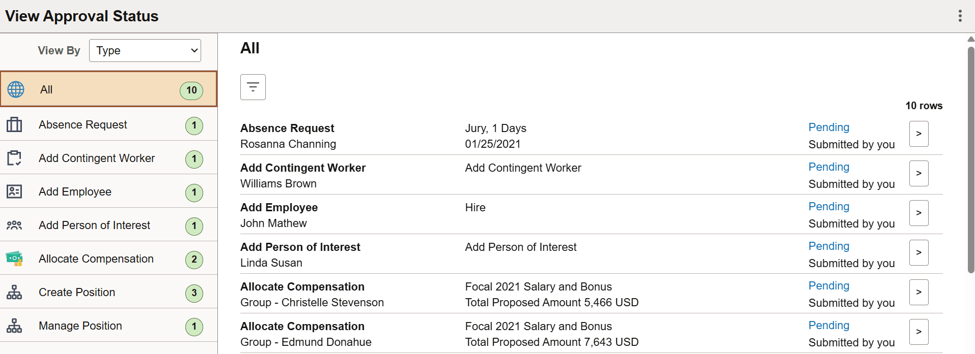

This example illustrates the fields and controls on the View Approval Status page.
This page does not replace the Pending Approvals Page, which is used by managers and approvers to approve or deny transactions. In addition, requesters must use application-specific transaction pages to resubmit or withdraw transactions.
When a requester is logged in:
  • The list only displays transactions where the person who is logged in is the requester.
  • Transactions are in read-only mode, and you cannot act on them.
  • The list includes transactions that have a status of Pending: In-Process, On-Hold, or Pushed Back; or Completed: Approved, Denied, or Withdrawn.
  • Transactions that are submitted by the person logged-in are indicated with Submitted by you.
  • Transactions that are submitted by a proxy user for you are indicated with Submitted for you.
  • Transactions that have an Approved or Denied status are displayed for x number of days.
    The number of days is determined on the Enterprise Components: Fluid Approval Setup - General Settings Page page, Age for Approvals History in Days field, and is calculated by the last updated date on the transaction.
When a submitter is logged in:
  • The behavior is the same as the requester view.
  • Transactions that you submitted on behalf of someone else are indicated with Submitted by you.
    For example, if Sam submitted a leave of absence request on behalf of Karl for approval, then both Sam and Karl see the transaction in their respective Requester’s view of the View Approval Status Page.
When an approver is logged in:
  • The list displays transactions where you are an approver and you have already acted on the transaction such as approving or denying the transaction.
    Transactions that are waiting for the logged-in user's approval are not listed. Use the Pending Approvals Page to act on transactions.
  • Transactions where you are included in the approval chain are indicated with Approved by you or Denied by you.
  • Transactions are displayed for x number of days.
    The number of days is determined on the Enterprise Components: Fluid Approval Setup - General Settings Page page, Age for Approvals History in Days field. and calculated by the last updated date on the transaction.
  • If you are a requester and an approver who acted on a transaction, the Requester role takes precedence, and is indicated with Submitted by you.
    For example: You submit a leave of absence request, and you are listed as one of the approvers. You approve the request. The transaction is listed on the View Approval Status page and identified as Submitted by you. In addition, it displays the approver action taken by you.
Field or Control Description
More Actions
(more actions)
Select to access a menu where you can select Pending Approvals. This option allows you to jump to the Pending Approvals Page. You can jump back to this page using the same icon and selecting View Approval Status.
View By
Select to group and filter approval requests in the left-hand navigation pane. Options include:
  • Date Routed - displays a weekly list based on the transaction date of the routing.
  • From - displays transactions based on the last sender.
    The last sender could be the requestor of the transaction or the last approver in the approval chain.
  • Requester - displays transactions by requester, which is helpful you are a requester and an approver.
  • Status - displays transactions based on the status.
  • Type - displays approval requests by transaction type and appears by default when you access the page.
Load More (button)
Select to display additional transactions in chunks according to the value entered on the Enterprise Components: Fluid Approval Setup - General Settings Page, Maximum Lines Displayed field.
Filter
(filter)
Select to access the Filters window where you can filter transactions by Type, Requester, From, and Status.
(center column)
The center column displays transaction information.
(status link)
Select the linked status to access the Approval Chain window. This window is read-only and displays the approval path for the transaction and approval comments. Comments that are entered by approvers are displayed for requesters and approvers.
View Detail
(view detail)
Select to access the transaction detail page. The detail page opens in read-only mode. No actions are allowed from this page.
