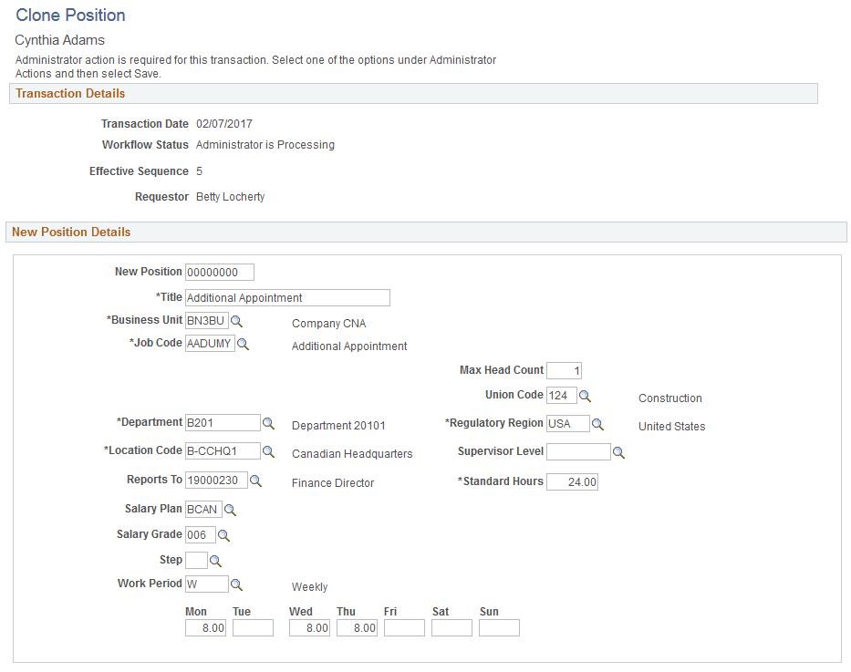

<Transaction Name> - Transaction Details Page (for Final Administrator Approval)
WF_MSS_CT_EE
Perform an administrator approval action for a guided self-service transaction, and choose whether to make the database updates automatically (if possible) or manually.

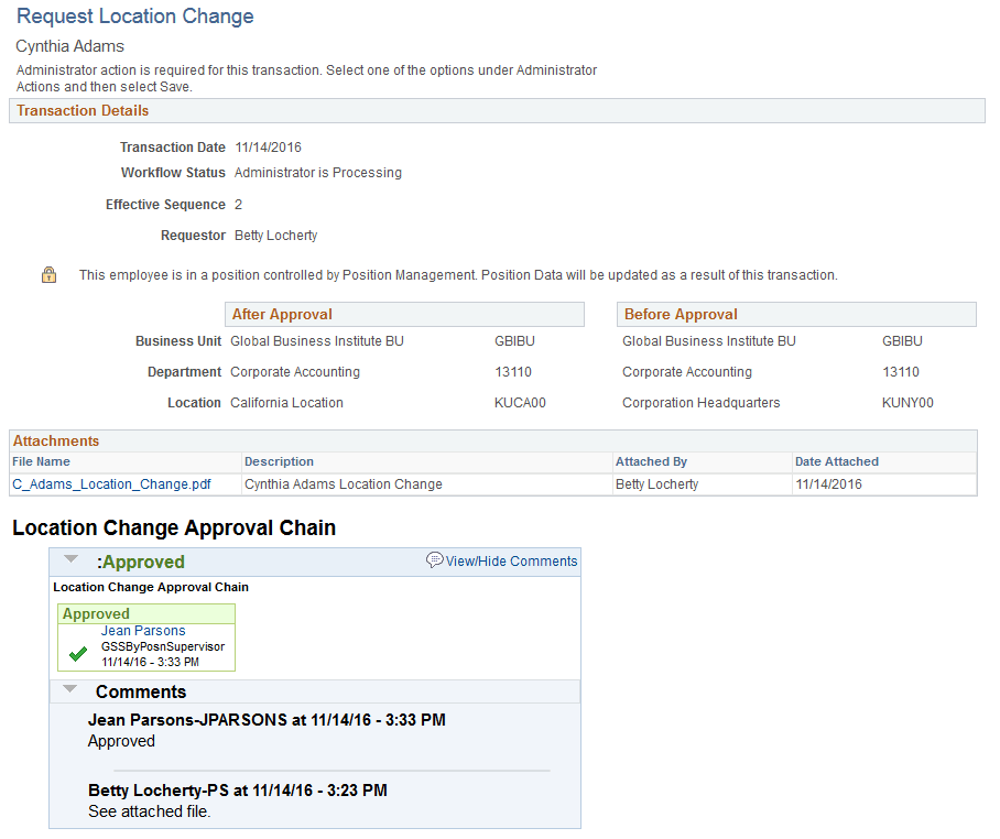

The Application Fundamentals: Workflow Configurations Page for self-service transactions includes an Allow DB Update (allow database update) check box. When this check box is selected, the system updates the database immediately after the transaction is approved by the final approver in the regular approval chain. However, if this check box is not selected, an administrator must complete the request
Administrators use the <Transaction Name> - Transaction Details Page (for Final Administrator Approval) to perform this final step. (Although other types of transactions can receive final administrator approval on the Monitor Approvals page, the Monitor Approvals page is read-only for guided self-service transactions.)
The administrator’s approval page lets the administrator choose whether to:
  • Approve the transaction and automatically update the database.
    This option is not available if the transaction updates a position-controlled field that cannot be automatically updated. Refer to the documentation for the <Transaction Name> - Transaction Details Page (for Final Administrator Approval) page for additional details about when this occurs.
  • Approve the transaction without updating the database. The administrator must then make the updates manually.
  • Cancel the transaction
In general, the page for final administrator approval does not permit the administrator to override transaction data. However, the Clone Position transaction is an exception, and administrators can edit any of the position data on the page.

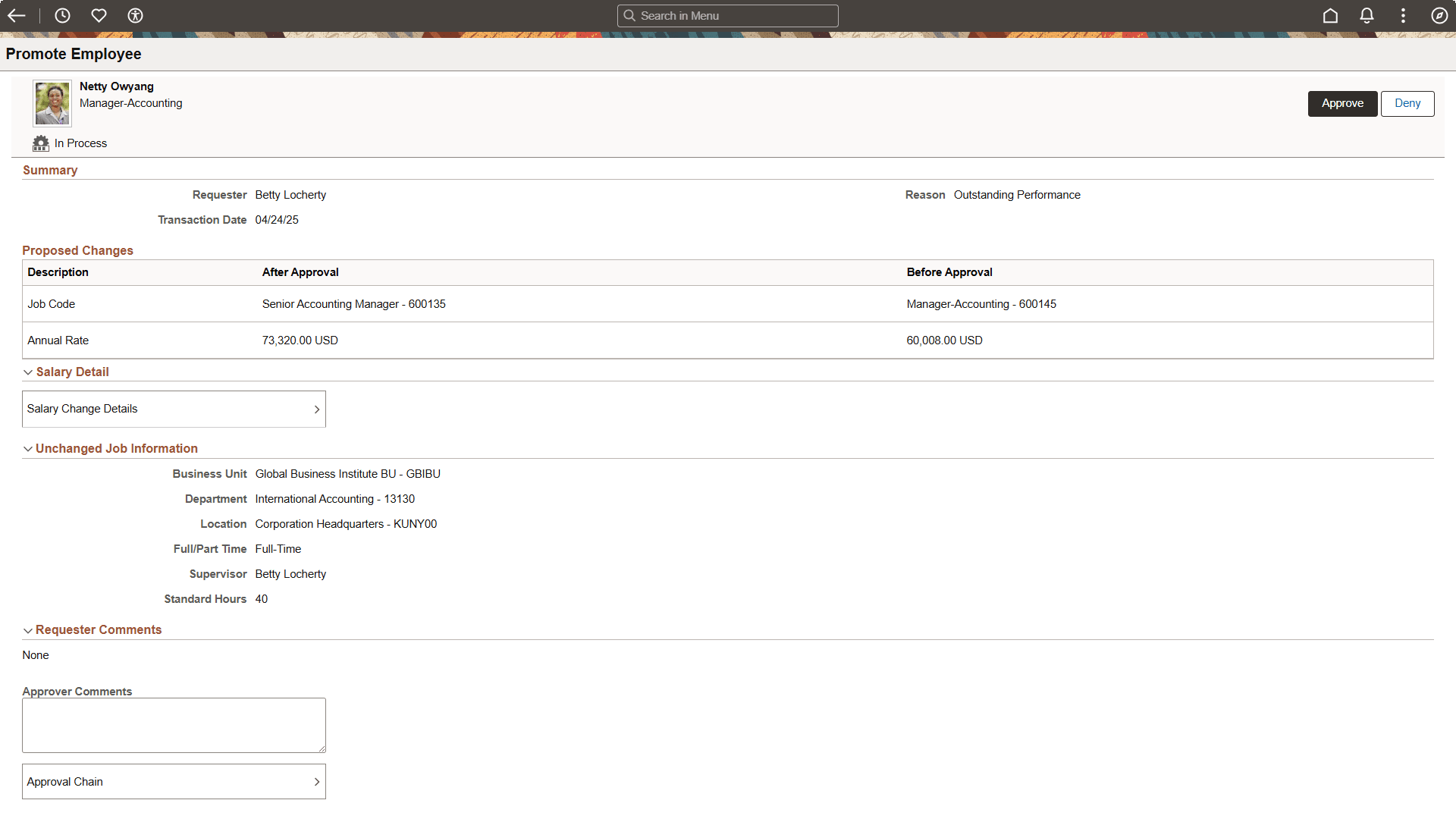

Proposed Changes
For transactions that update employee data, this grid lists the specific data changes that are being requested. The fields vary depending on the transaction.
This section is not shown for the delivered Request Leave of Absence, Retire Employee, or Terminate Employee transactions. The leave request transaction doesn’t update job data fields other than the Expected Return field, which appears in the Summary section of this page. The retirement and termination transactions don’t make any changes to job data fields—they simply insert a new job data row with an action reason to record the retirement or termination.
Field or Control Description
Description
Displays the name of the field to be updated.
If the transaction includes salary changes, a single row in the grid shows the annual salary rate information. To view additional salary information, go to the Salary Detail section of this page and click the Salary Change Details item.
After Approval
Displays the proposed new value for the specified field.
Before Approval
Displays the current value of the specified field so that you can compare the old data to the proposed change.
Guided Self Service will not update Job Data with blank field values.
Salary Detail
For transactions that update employee data, this section provides additional salary details. The section is hidden for transactions that do not change an employee’s salary. The delivered transactions that include this section are Ad Hoc Salary Change, Demote Employee, Promote Employee, and Transfer Employee.
Click this item to open the Salary Change Details Page, where you can review the proposed salary changes for this transaction.
Unchanged Job Information
For transactions that update employee data, this section lists additional data that is relevant to the transaction but that is not changing. The fields in this section vary depending on the transaction.
If no fields are shown, the entire section is hidden. The delivered Ad Hoc Salary Change and Full/Part Time Status approval pages do not show any unchanged job information.

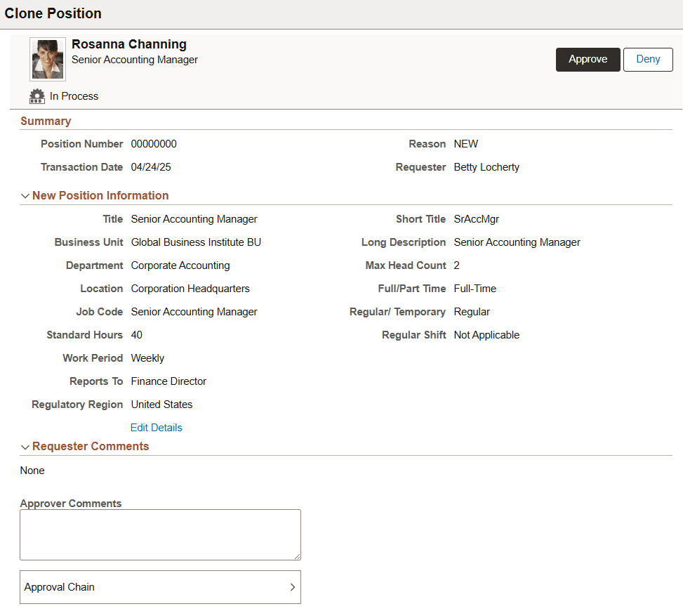

New Position Information
For the Clone Position transaction, this section displays the data for the new position that will be created. The transaction configuration controls which fields are visible.
Edit Details
This link is available only for the final approver for the Clone Position transaction.
Note: The final approver must be assigned the same role that is defined on the Application Fundamentals: Workflow Configurations Page for the HR_POSITION_CLONE (Position Clone) transaction. As delivered, this value is the Personnel Administrator role.
Select this link to access the fluid guided self service Clone Position component, which allows the approver to modify any position details prior to final approval. After saving the updates to the position, you are returned to the approval pages where you will see your changes. Approve the request for these changes to take place.

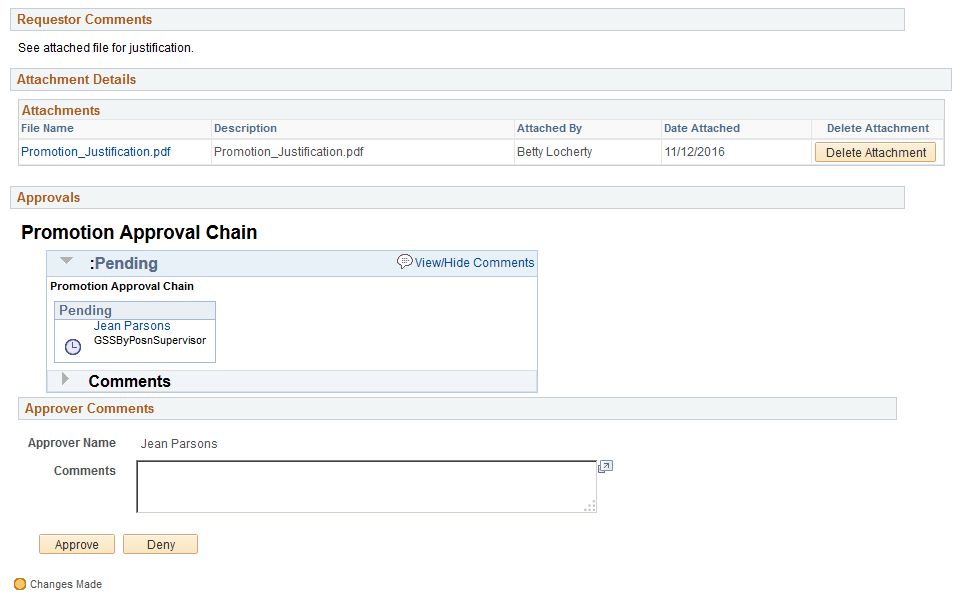

Requester Comments
This section displays any comments that the requester added before submitting the transaction. If the requester did not enter any comments, the word None appears.
Click this item to open the Attachments Page, where you can access files that the requester attached to the request.
Due to limitations on the number of sections that can appear on this page, certain transactions display this item within the Requester Comments section rather than in a separate Attachments sections.
Approver Comments and Approval Chain
Approver Comments
Enter any comments related to the approval action you take.
Approval Chain
Click this item to open the Approval Chain page, where you can review information about all approvers for the transaction.

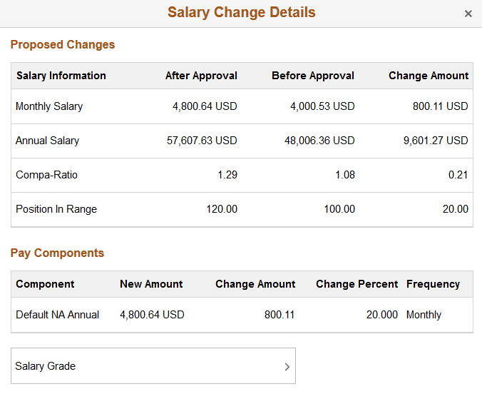

Use the Salary Change Details page (HR_MSS_CT_MACMP_FL) to review detailed information about proposed changes to an employee’s salary.
Navigation:
Click the Salary Change Details item on a guided self-service fluid approval page.
This example illustrates the Salary Change Details page.
Proposed Changes
This grid displays salary information for the employee.
The four rows in the grid display these types of salary information: Monthly Salary, Annual Salary, Compa-Ratio, and Position in Range.
For each type of salary information, the grid columns display the value after approval, the value before approval, and the change amount.
Note: Guided Self Service will not update Job Data with blank field values.
Pay Components
This grid displays information about each component of pay in the employee’s salary. The grid displays the pay component name and frequency along with before and after information and the change percent.
Salary Grade
Click to access the Salary Grade Information Page to review an employee’s proposed salary changes in the context of the employee’s salary grade.

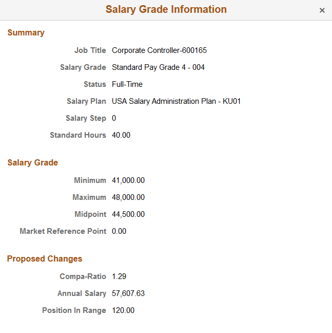

Use the Salary Grade information page (HR_MSS_CT_MAGR_SCF) to review an employee’s proposed salary changes in the context of the employee’s salary grade.
Navigation:
Click the Salary Grade item on the Salary Change Details page.
This example illustrates the Salary Grade Information page.
Summary
This section displays the employee’s job title; the salary grade, plan, and step; full-time/part-time status; and standard hours.
Salary Grade
This section displays the maximum, minimum, and midpoint salaries for the employee’s salary grade.
Proposed Changes
This section displays the compa-ratio, annual salary, and position in range for the salary change that has been requested.

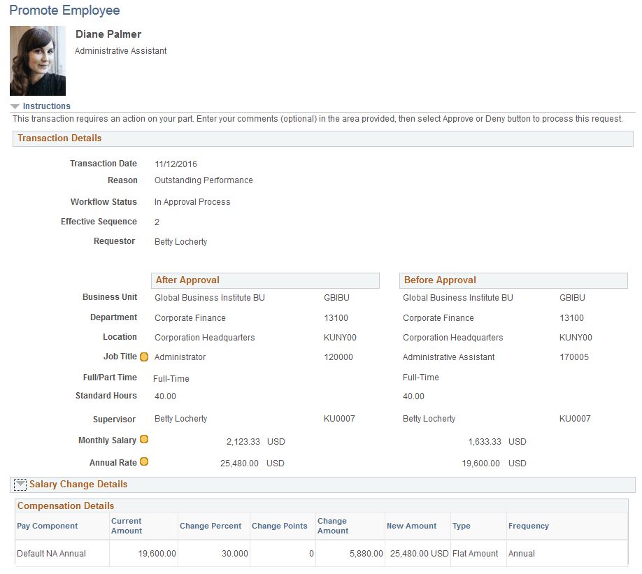

(Classic) Pending Approvals - <Transaction Name> Page (for Guided Self-Service Approvals)
Use the classic <Transaction Name> page (HR_MSS_CT_APPR) to review and approve a guided self-service request using a classic (non-fluid) page. The page title depends depending on the transaction type.
If an approver has access to the Fluid Approval pages, then conditional navigation redirects the approver to the Fluid Approval page that displays pending approvals.
Navigation:
This is the first of two example illustrating the classic <Transaction Name> page for guided self-service approvals. This example shows the Promote Employee transaction.
<Transaction Name> Page for approving submitted transactions (1 of 2)
This is the second of two example illustrating the classic <Transaction Name> Page for guided self-service approvals.
<Transaction Name> Page for approving submitted transactions (2 of 2)
Transaction Details
This section of the page provides information about the changes that the user is being asked to approve.
If the transaction affects an employee’s position data, a message provides additional information about the position data changes.
After Approval and Before Approval
For transactions that update an employee’s data, these two columns provide information about the requested updates.
For transactions that update an employee’s salary data, a collapsible Salary Details section displays additional details about the proposed changes.
New Position Details
Requestor Comments
Displays any comments that the requestor entered when submitting the transaction.
Attachment Details
Displays a grid with any attachments that the requestor supplied. Click the file name to open the file. The Delete Attachment button enables you to remove a specific attachment from the transaction.
Approvals
Displays a graphical representation of the approval chain for the transaction. An expandable Comments section displays any comments entered by previous approvers.
Approver Comments
Enter any comments related to the approval action that you take on this page.
Approve and Deny
Use these buttons to approve or deny the request.

This is the first of two examples that illustrate the <Transaction Name> page for final administrator approval.
Administrator Approval page for Guide Self-Service Transactions (1 of 2)
This is the second of two examples that illustrate the <Transaction Name> page for final administrator approval.
Administrator Approval page for Guide Self-Service Transactions (2 of 2)
This example partially illustrates the administrator approval page for the Clone Position transaction. The sections for Attachments, the Approval Chain, Administrator Processing, and Administrator Actions are not shown, but they are the same for Clone Position as for all other transactions.
Clone Position page for administrator approval
Transaction Details
The Transaction Details section of the page provides information about the original request.
Workflow Status
Displays information about the transaction’s approval status.
The status Administrator is Processing indicates that all regular approvals are complete, but the transaction is still awaiting a final administrative approval before the database is updated with the requested changes. For Guided Self Service transactions, the final administrative approval must occur on this page. (Although other types of transactions can receive final administrator approval on the Monitor Approvals page, the Monitor Approvals page is read-only for guided self-service transactions.)
This section is visible only for the Clone Position transaction. It displays editable position data fields for the new position.
Note: The Clone Position transaction is unique in allowing the administrator to update data before approving the transaction.
This section includes these fields:
  • The New Position field
    This is for the unique identifier that will be assigned to the new position. If the system is set up to automatically assign position numbers, the administrator should accept the default value 00000000 so that the system can assign the next available number.
  • Fields that are configured to be visible for this transaction.
    Important: The newly created position will include data from all fields that are available for configuration, even if some fields are not configured to be visible.
  • The Salary Plan, Salary Grade, and Salary Step fields, which are not part of the transaction configuration and are therefore never visible to the requestor or approvers.
    Because the requesting manager and the approvers cannot see these fields, the administrator should review this data carefully. The data is copied from the position that was cloned, but if the requesting manager changed or cleared the default Business Unit for the transaction, the system cleared the copied data and the three salary-related fields are blank.
