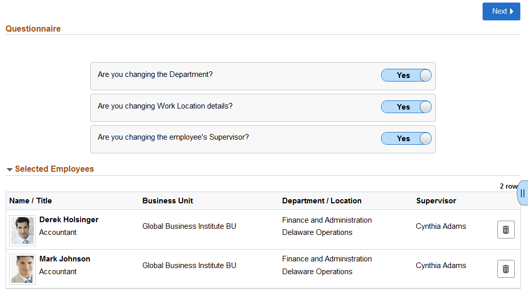

Questionnaire Page
HR_MSS_CT_QUES_FL
Answer questions that determine which pages and fields users will see during the guided self-service transaction.

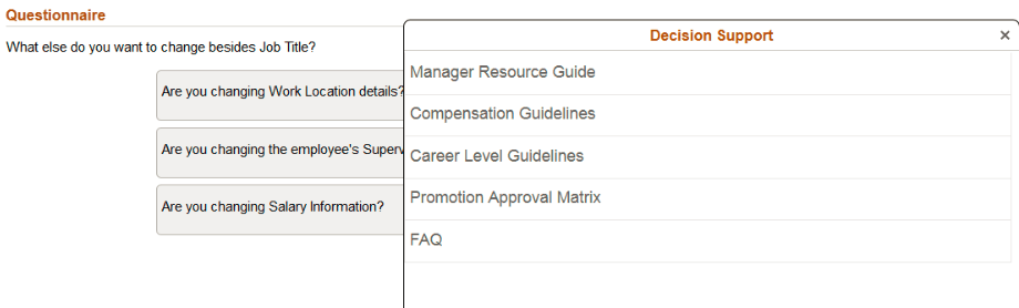

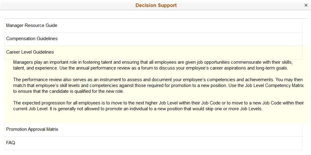

Decision Support Page
HR_MSS_CT_DSUP_FL
View decision support topics that are defined in the transaction configuration.
This page appears in PeopleTools 8.55 or later. With earlier versions of PeopleTools, decision support appears in a panel on the Questionnaire page.

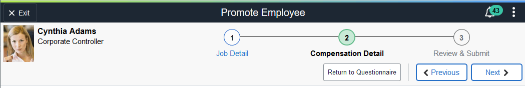

Common Header for Guided Self-Service Pages
not applicable
The common header provides navigation buttons and contextual information for the steps in a transaction.

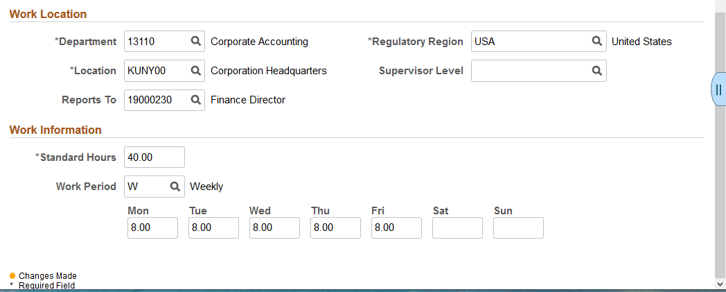

Work and Job Information Page
HR_MSS_CT_PG1_AGFL (PeopleTools 8.55 or later)
HR_MSS_CT_PG1_FL (PeopleTools versions before 8.55)
Enter work and job changes for an employee.

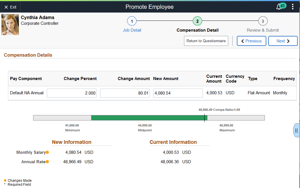

Compensation Details Page
HR_MSS_CT_PG2_AGFL (PeopleTools 8.55 or later)
HR_MSS_CT_PG2_FL (PeopleTools versions before 8.55)
Enter compensation changes for an employee.

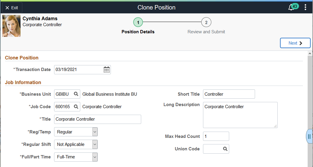

Clone Position Page
HR_MSS_POSN_AGFL
Enter or update position data to create a new position based on an existing one.
This page requires PeopleTools 8.55 or later. The Clone Position transaction is not available with earlier versions of PeopleTools.

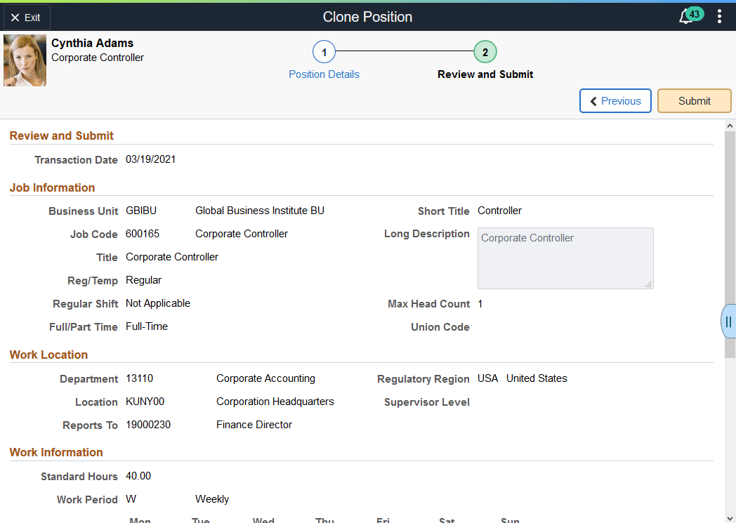

Review and Submit Page
HR_MSS_CT_SBM_AGFL (for employee transactions using PeopleTools 8.55 or later)
HR_MSS_CT_SUBMT_FL (for employee transactions using PeopleTools versions before 8.55)
HR_MSS_CT_PSNSB_FL (for the Clone Position transaction)
Review transaction information, add comments, and submit the request.

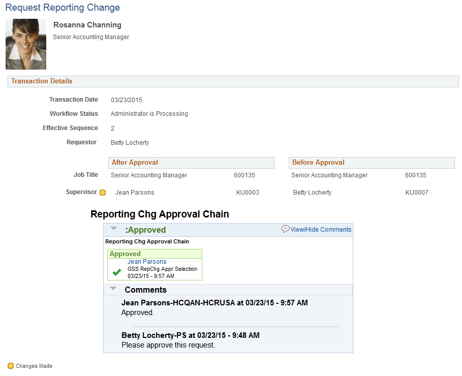

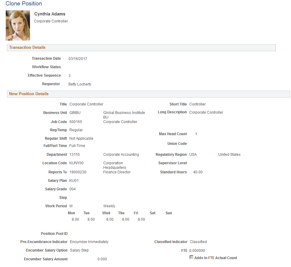

<Transaction Name> Page for Reviewing Submitted Transactions
HR_MSS_CT_EE
Submitters use this page to review read-only information about a guided self-service transaction that has been submitted for approval.

  1. Questionnaire Page: this appears only if the transaction is configured with questions that are not hidden.
  2. Work and Job Information Page: this appears if the transaction is configured to show job data.
  3. Compensation Details Page: this appears if the transaction is configured to show compensation data.

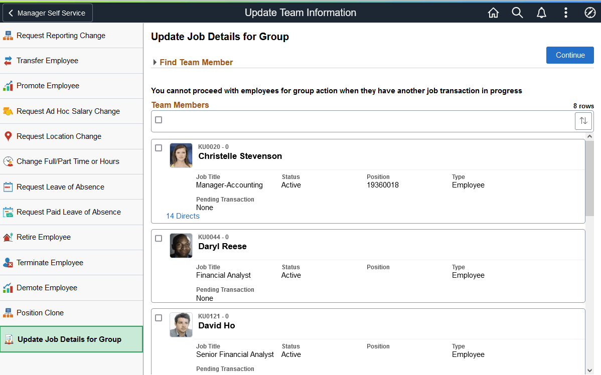

Update Team Information Page
The Update Team Information page is a navigation collection where you can initiate a guided self-service transaction.
Navigation:
Click the Update Team Information Tile.
This example illustrates the Update Team Information page.
On this page:
Throughout the remainder of these topics, the page illustrations will often show the transaction page of the Update Team Information process without the context of the left guided self-service navigation collection. Even though the left frame is not illustrated, remember that pages appear within that layout.

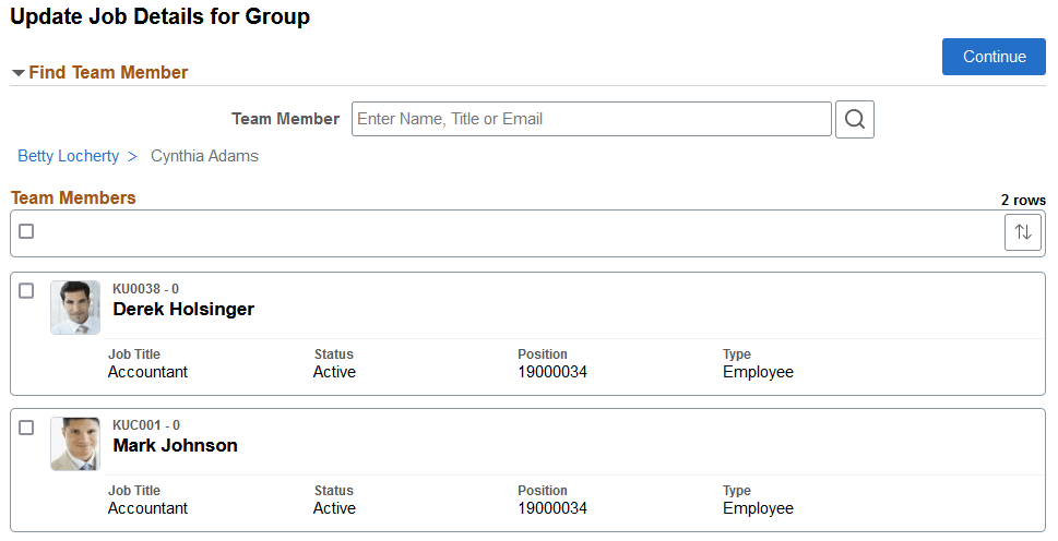

<Transaction Name> - Find Team Member Page for Selecting Employees
Use the <Transaction Name> - Find Team Member page (HR_PSEL_FLU) to select one or more employees for a guided self-service transaction. The page name matches the transaction name.
Navigation:
This page appears when users access a guided self-service transaction using the Update Team Information tile or using menu navigation.
When you use a related action for an employee to initiate the transaction, the system bypasses this page.

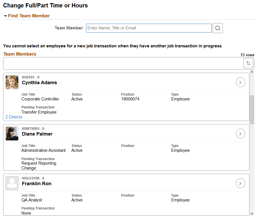

This example illustrates the <Transaction Name> - Find Team Member page when the Allow Multiple Transactions for Employee has not been enabled on the Installation Table - Application Fundamentals: HCM Options Page.
Example of the <Transaction Name> - Find Team Member page when Allow Multiple Transactions for Employee is not enabled
As delivered, a manager can initiate only one job data transaction request at a time for an employee. This screenshot shows the page when multiple transactions for an employee is prohibited. For more information on allowing multiple transactions, see the "Allowing Multiple Guided Self Service Transactions for an Employee" subtopic under the Understanding Guided Self-Service Transactions discussion in this topic.
The reporting hierarchy is the same hierarchy that managers see on the My Team – Summary Page.

Shows whether the employee has a job request in progress by displaying one of the following:
  • None - indicating that you can initiate a new job transaction for this employe
  • The name of the In Progress transaction for the employee - indicating that you cannot initiate a new job transaction for this employee.
Although you may have allowed multiple transactions for individual transactions, the message and field still appear for all transaction types with the exception of the leave transactions or when cloning a position.
When you select a person, or a group that has a person with a transaction in progress, the system will issue a warning, such as shown in the following screenshots:
Example of the warning message when an employee has a job transaction in progress
Warning message when an employee has a job transaction in progress
Example of the warning message when a group of people you have selected has an employee that has a job transaction in progress
Warning message when a selected group has an employee that has a job transaction in progress
When Multiple Transactions for Employee is Enabled Globally

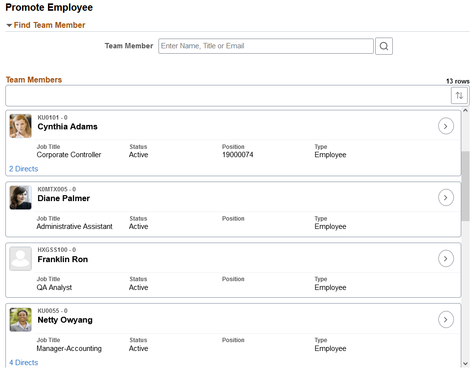

These screenshots show the page when multiple transactions for an employee are enabled on the Installation Table - Application Fundamentals: HCM Options Page, overriding the delivered setting.
This example illustrates the <Transaction Name> - Find Team Member page for transactions where you can select only one employee.
<Transaction Name> - Find Team Member page for selecting one employee
This example illustrates the <Transaction Name> - Find Team Member page for the Update Job Details for Group transaction, which allows you to select multiple employees. In this example, The user (Betty Locherty) has drilled down in her reporting structure, so the reporting structure for the current list of employees appears above the team members list.
<Transaction Name> - Find Team Member page for selecting multiple employees
For more detailed information on enabling multiple transaction for an employee, see the "Allowing Multiple Guided Self Service Transactions for an Employee" subtopic under the Understanding Guided Self-Service Transactions discussion.

This example illustrates the Questionnaire page for the Update Job Details for Group transaction. Because this transaction allows multiple employees, the page displays a Selected Employees list rather than displaying a single employee’s information at the top of the page.
Questionnaire page - Update Job Details for Group
Employee Information
For transactions other than Update Job Details for Group, the Questionnaire page includes a header with identifying information about the employee whose data is being updated.
Questionnaire
The on-page instructions, the questions that follow the instructions, and the default answers to the questions are all configured on the Transaction Configuration - Questionnaire Page. When you configure questions, you can choose alternate text to use on small form factors.
Field or Control Description
Yes or No
Swipe a Yes/No slider to answer a question. The selected answers determine the pages and fields that appear in the transaction.
Next
Select this button to move to the next step in the guided self-service transaction.
An error appears if the Update Job Details for Group transaction includes employees from multiple business units and your questionnaire answers indicate that you want to change department or work location data.
Selected Employees
This section appears only for the Update Job Details for Group transaction. It lists the employees whose data is being updated. The list appears even if the user selects just one employee.
Delete icon Delete
Click this icon to remove an employee from the Update Job Details for Group transaction without going back to the page for selecting employees. If there is only one employee in the list, you cannot delete that employee.
You cannot add employees on this page. To add employees, restart the transaction.

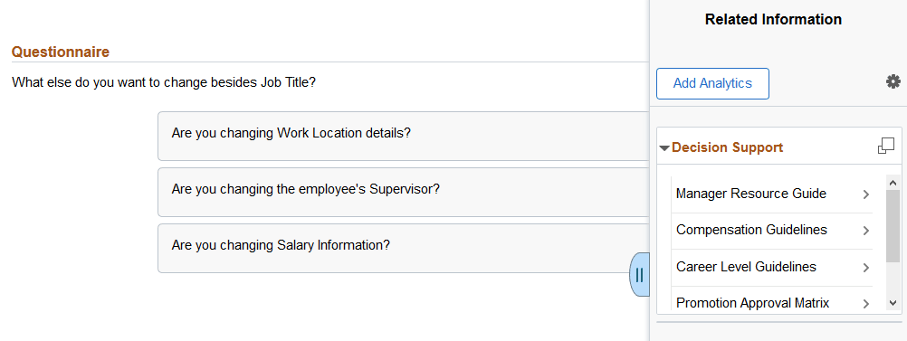

Click this tab to open the Related Content panel. The Related Information pane lists topics that have been configured for the transaction.
Note: This tab appears on the guided self-service pages as well as on the Questionnaire page.
This example illustrates the related content panel on the Questionnaire page in PeopleTools 8.55 and later.
Related content panel in PeopleTools 8.55 and later for the Questionnaire page

Display Decision Support in Modal icon (Display Decision Support in Modal icon)
Click this icon to expand and open the Decision Support Page in a modal window, where you can view the complete list, text and details of the decision support topics.
This example illustrates the Decision Support panel in PeopleTools versions older than 8.55
Click the Decision Support button then click an area of interest to view specific content. Use the back arrow buttons or use the Exit icon (X) to return to previous pages.
Use the Decision Support page (HR_MSS_CT_DSUP_FL) to view decision support topics that are defined in the transaction configuration.
Navigation:
Open the Related Information panel on the Questionnaire page. On the Decision Support tab, click the Display Decision Support in Modal Window icon (this icon is next to the Decision Support title).
This example illustrates the Decision Support page.
This page lists the decision support topics that are defined in the transaction configuration. Click a topic title to expand it and view the full text for the topic, then click again to hide the text and return to the list of topics.

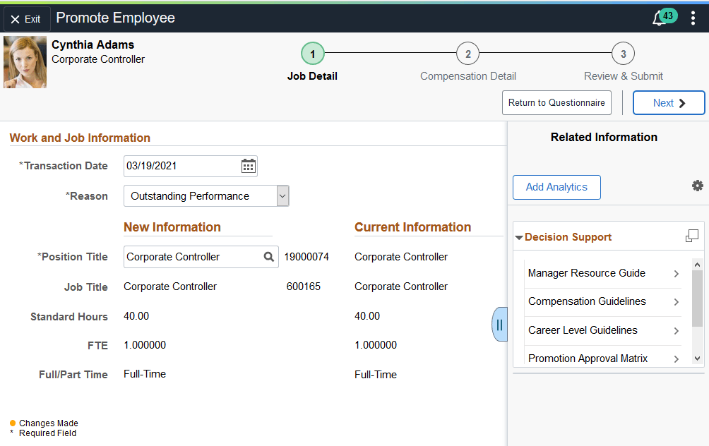

A common header appears on the pages for each post-questionnaire step in a guided self-service transaction. Use this header for navigation and to provide context.
The header on small form factor devices (phones) differs from the standard header.
This example illustrates the guided self-service header on larger devices.
Guided self-service page header (PeopleTools 8.57 and higher)
This example illustrates the guided self-service header on small form factors.
Guided self-service header on small form factors
The common header in PeopleTools 8.55 and higher is rendered by the Activity Guide framework and is slightly different from the header that appears with earlier versions of PeopleTools. These differences are pointed out in the following documentation.
Exit icon (small form factor) or Exit
Click to exit the transaction entirely and return to the page where the transaction was invoked.
In pre-Activity Guide systems, users see the standard fluid return button, labeled with the name of the page that will appear when the user exits.
<Standard Banner Icons>
When the common header is rendered by the Activity Guide framework, most of the standard banner icons are hidden, including icons such as Home and Navigator which would lead the user away from the activity. This keeps users focused on completing the steps in this transaction.
The Notifications icon is still available in guided self-service transactions. On larger devices it appears as a banner icon, but on small form factor devices, it appears as an option in the Actions List menu.
Previous icon Previous and Next icon Next
Click to navigate to the previous or next step in the transaction.
In pre-Activity Guide systems, these buttons appear below the header area rather than in the header area.
Actions List button or Actions List iconActions List button
The icon for the Action List button depends on your version of PeopleTools. Click the icon to access a menu with these options:
  • Return to Questionnaire: this appears only if the transaction includes an end-user questionnaire. When the user returns to the questionnaire, transaction data is not saved, and the user must start the process over.
  • Home: returns the user to the Fluid Home page.
In pre-Activity Guide systems, the Return to Questionnaire action is not in the actions menu. Instead, a Questionnaire button appears next to the Previous and Next buttons.
<employee information>
For the Update Job Details for Group transaction, the page displays a Group Update label and icon along with text stating how many employees are included.
For all other transactions, the page displays the name, job title, and photo for the individual employee whose data will be updated.
On small form factor devices, only the name or the Group Update label appears at the top of the page, but users can tap the text to display the additional information.
In pre-Activity Guide systems, a related actions button appears next to an individual employee’s name. When the common header is rendered by the Activity Guide framework, this button is hidden to keep users focused on completing the steps in this transaction.
<graphical representation of steps>
On larger devices, the header area includes a graphical representation of the steps in the transaction. This list includes step names and numbers. Users can click a step to go directly there as long as steps are completed sequentially.
On small form factor devices, the header shows an overall progress indicator. The progress indicator does not show step names, but is shows the text Step n of n along with a progress bar that gets filled in to indicate the percentage completion. You cannot click this header to navigate to different steps.

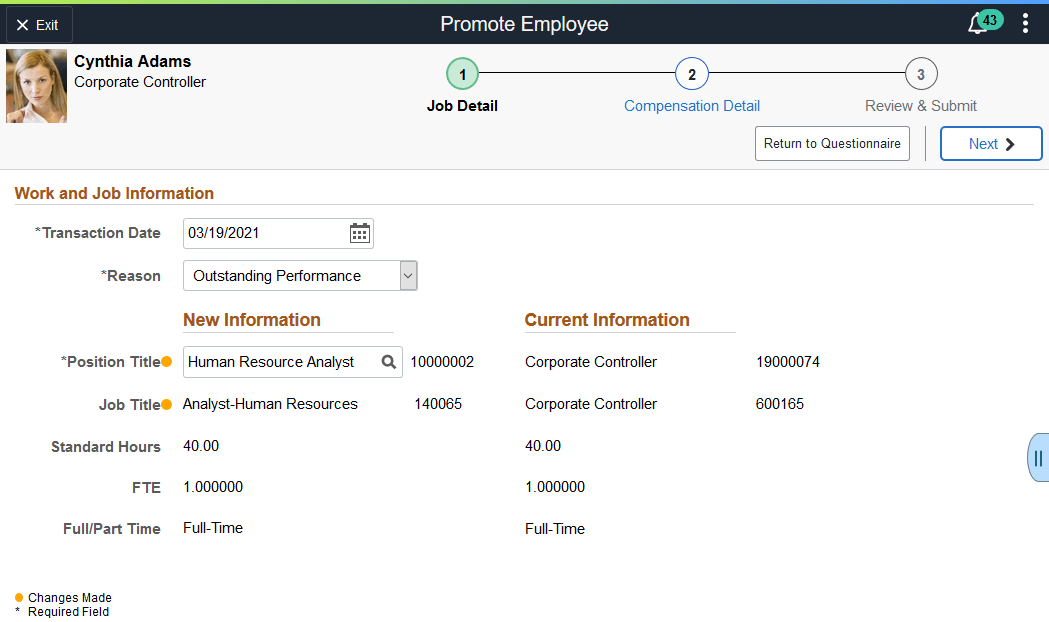

This example illustrates the Work and Job Information page, which appears under the Job Detail step in the guided process.
Work and Job Information (PeopleTools 8.55 and higher)
Guided self-service transactions include this page when the transaction includes an update to the job or work location data. The fields on this page vary based on setup and on the answers to the questions on the Questionnaire Page.
Guided Self Service will not update Job Data with blank field values.
Transaction Date
The default transaction date is the current date. This date is used as the effective date of the data changes.
If a transaction has been configured to include the Last Date Worked field, the last date worked must be equal to or earlier than the transaction date. The default last date worked is the day before the transaction date. The Last Date Worked field is normally relevant only to the Terminate Employee and Retire Employee transactions.
Reason
Select an action reason to use for the job data row that will be created when this transaction is submitted and approved. The transaction configuration controls whether this field appears, whether it is required, the list of available values, and the default value.
Position Data Message
If you use the Promote Employee, Demote Employee, or Transfer Employee transaction to change which position an employee holds, a message appears if the position data is overridden in the employee’s job data. The message states that job data must be updated manually.
If the employee is in a position and the position data is not overridden in the employee’s job data, a message appears when you make changes to data that is derived from the position:
  • If the system is able to automatically update the position data, the message states that position data will be updated. This is possible only for transactions that have been explicitly configured to update position data.
  • If the system is not able to update the position data automatically, the message indicates that the Human Resources department will be notified that the transaction needs to be processed.
See Understanding Updates to Position Data.
New Information
Enter the new data for the employee in this column. The fields that appear on this page depend on the transaction configuration.
If the Standard Hours field appears, a read-only FTE (full-time equivalent) field also appears, and the system updates the FTE value when the user changes the standard hours.
The employee’s business unit controls the valid values for fields such as Department and Location that are controlled by setID. The Update Job Details for Group transaction requires that all selected employees have the same business unit.
Some page elements can vary depending on whether the employee is in a position:
  • When performing a Promotion, Demotion, or Transfer transaction for an employee in a position, the page prompts the user to enter a new position number. If the employee is not assigned to a position, then the page prompts the user to enter a new job code.
    To move an employee from a job code to a position, or vice versa, the request should be handled by an HR administrator rather than through guided self-service.
  • The Reports To field appears only for employees in positions, while the Supervisor ID appears for employees who are not in positions, or whose Reports To position data has been overridden with a Supervisor ID.
    The Reports To field displays the position to which the employee reports rather than the person to whom the employee reports, so if this field is shown, the page also displays a read-only Manager Name field.
  • For the Update Job Details for Group transaction, the Reports To field appears if all employees are in positions. The Supervisor ID appears if at least one employees is not in a position. (An employee who reports to a supervisor as the result of a position override is not considered to be in a position.)
    If the group includes a mix of employees in positions and employees not in positions, the Supervisor ID field has the following logic:
    • If the selected supervisor is not in a position, a message indicates that the supervisor cannot be automatically assigned as the manager for employees who are in positions. All position employees in the group are sent to an administrator for processing
    • If the selected supervisor is in a position, a Reports To field displays the supervisor’s position.
    • If the selected supervisor is in multiple positions, the Reports To field becomes a drop-down list of those positions, and the user must select the position to which the employees in positions will report.
Current Information
This column displays the employee’s current data.
With the Update Job Details for Group transaction, it is possible for the selected employees to have different current information. When this occurs, the field indicates that there are multiple values. For example, if the selected employees are currently in different locations, the current information for the Location field is Multiple Locations.
Selected Employees
For the Update Job Details for Group transaction, this section lists the employees whose data is being updated.
If the list includes position employees whose data cannot be automatically updated, a lock icon appears in the last column of the grid. Additionally, the page includes informational text to explain that an administrator will complete the processing for the position data.
Position data cannot be automatically updated when an employee has a position data override, when a position has multiple incumbents, or when position data is not activated for the Update Job Details for Group transaction.
Use the Compensation Details page (HR_MSS_CT_PG2_AGFL or HR_MSS_CT_PG2_FL) to enter compensation changes for an employee.
Navigation:
  • Select the Next button from the previous page in the guided self-service transaction.
  • Select the Compensation Details step in the graphical map of the steps in the transaction.
  • For transactions that include the Compensation Details page but do not include a questionnaire or the Work and Job Information page, this page appears immediately when a user navigates to the transaction.
This example illustrates the Compensation Details page.
Compensation Details page (PeopleTools 8.55 and higher)
The guided self-service transaction includes this page when the transaction requires an update to the compensation data. The fields on this page vary based on setup and on the answers to the questions on the Questionnaire Page.
The navigation buttons (Questionnaire, Previous, and Next) are the same on this page as on the Work and Job Information page.
Pay Component
For each pay component listed, enter the salary change details. When you enter a number in either the Change Percent, Change Amount, or New Amount fields and move from the field, the system automatically calculates and updates the other fields based on your entry.
Note: To decrease the employee’s salary enter a negative adjustment in the Change Percent or Change Amount field. The Demote Employee transaction displays a warning if you enter an adjustment that is not negative.
Salary Range Graphic
The graphical representation of the annual pay range for the employee’s job or position provides a helpful visualization of where the new salary amount falls in that range. If this transaction includes a new job or position, the visualization is based on the new pay range.
New Information
Displays the new salary information.
Current Information
Displays the employee’s current salary information.
Clone Position Page
Use the Clone Position page (HR_MSS_POSN_AGFL) to enter or update position data to create a new position based on an existing one.
This page is available only with PeopleTools 8.55 or later.
Navigation:
Start a Clone Position guided self-service transaction.
This is the first of two examples illustrating the Clone Position page.
Clone Position page (1 of 2)
This is the second of two examples illustrating the Clone Position page.
Clone Position page (2 of 2)
Use the Next button to continue to the Review and Submit page after looking at the position data fields and making any necessary changes.
The position data fields on this page vary based on setup. They correspond to the fields on the PeopleSoft Human Resources Manage Positions: Position Data - Description Page and the PeopleSoft Human Resources Manage Positions: Position Data - Specific Information Page.
The default values in all of the fields come from the position of the employee whose position is being cloned. Unlike other guided self-service transaction, there is no requirement for the user to change any data. However, there is also no requirement to retain any of the data. Managers are free to keep all, some, or none of the default values in the fields that appear on this page.
Here is additional important information about certain fields on this page:
  • The Mon through Sun day-of-the-week fields for daily hours are visible only if the work period is W (weekly).
    When these fields are visible, and the user updates the standard hours, the system automatically updates the Mon through Sun fields by distributing the an equal number of hours across Monday through Friday.
  • As delivered, the transaction does not display the Company field. Even when the Company field is hidden, its value can change if the manager selects a Department that is in a different company.
  • As delivered, the transaction does not display the encumbrance related fields.
    The encumbrance-related fields are Position Pool ID, Encumbrance Indicator, Encumber Salary Option, Classified/Unclassified Ind, FTE, and Adds to FTE Actual Count.
  • The clone process copies data from all fields that can be configured to appear, even those that are hidden due to the transaction configuration.
  • The clone process also copies the original position’s salary plan, grade, and step unless the Business Unit is changed or cleared, in which case the system clears this data for the new position.
    The salary-related fields are not part of the transaction configuration, so they are never visible on this page. An administrator is responsible for verifying that the newly created position has the correct salary information. If administrator approvals are required, this review can be done on the administrator approval page, where the administrator can update the fields before approving the transaction.
  • If the Business Unit is changed or cleared, the system also clears the Department, Job Code, and Location fields, and the user sees a warning.
  • The Update Incumbents check box is always selected in new positions that are created by the delivered Clone Position transaction.

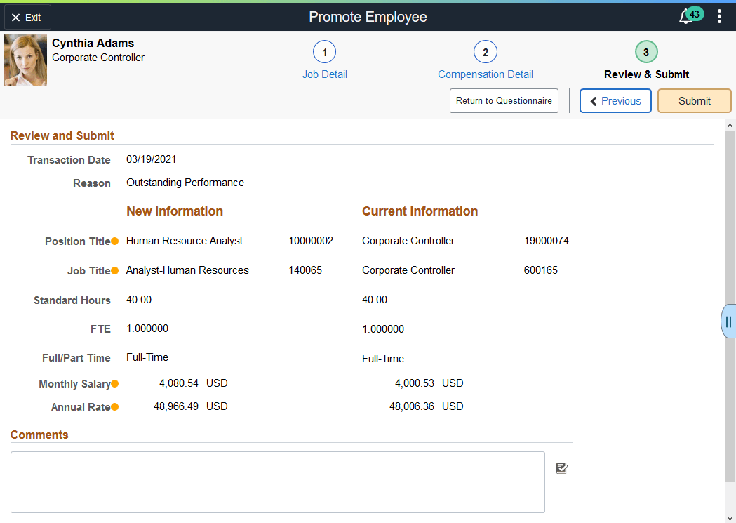

Use this Review and Submit page (HR_MSS_CT_SBM_AGFL or HR_MSS_CT_SUBMT_FL) to review transaction information, to add comments, and to submit a request.
Navigation:
Select the Next button from the previous page, or select this step in the graphical representation of the transaction steps.
This example illustrates the fields and controls on the Review and Submit page for an employee transaction.
Review and Submit page for an employee transaction (PeopleTools 8.55 and higher)
This example partially illustrates the Review and Submit page for the Clone Position transaction. The Comments and Attachments sections are not shown, but they are the same for the Clone Position transaction as for employee transactions.
Submit
Select this button to finalize the transaction and, if approvals are required, to begin the approval process.
If no errors are encountered, the system displays a confirmation page that shows the approval chain. If errors are encountered, the HR administrator is notified.
If approvals are not required, the confirmation page appears after the system makes the related database updates. For the Update Job Details for Group transaction, processing time increases with the number of employee records that are being updated.
Oracle PeopleSoft delivers Notification Composer Framework to manage the setup and administration of all notifications in one central location.
Once you have adopted the Notification Composer feature, you must use it to create new notifications and manage your existing notifications.
Notifications delivered with HCM Image 47 or later must use Notification Composer.
For more information about Notification Composer Framework, see Enterprise Components: Understanding Notification Composer.
Transaction Details for Employee Transactions
Transactions other than the Clone Position include a Review and Submit area that displays transaction information. The transaction date appears at the top of the page.
Reason
Employee data changes are associated with an action and an action reason. This field displays the action reason for that transaction.
The action is never visible, but the transaction configuration determines whether the Reason field is visible.
New Information
This column displays the data that will take effect when the transaction is approved. A yellow dot between the field name and the field value indicates data that is changing.
To change a value, return to the appropriate page in the transaction to make the changes.
Current Information
This column displays the employee’s current data so that you can easily see the changes that are being requested.
Selected Employees
Transaction Details for Clone Position
The same sections and fields that appeared on the Clone Transaction page appear on the Review and Submit page for the transaction. The transaction date appears at the top of the page.

This example illustrates the read-only page that submitters and reviewers use to view a Clone Position transaction.
Clone Position page for reviewing a submitted transaction
