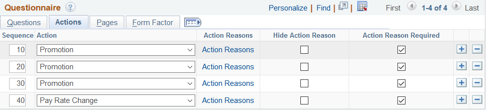

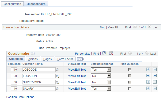

Transaction Configuration - Questionnaire Page
HR_MSS_CT_SEQ
Add questions for guided self-service transactions.

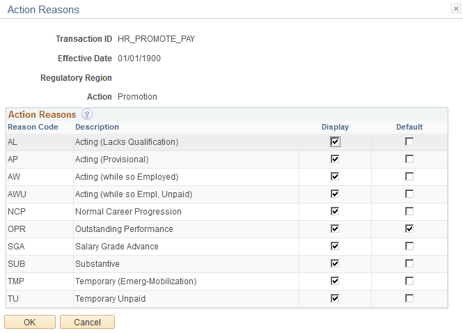

Action Reasons Page
HR_MSS_CT_RSN_SEC
Choose the valid action reasons for the job data row that the transaction creates, and choose a default action reason.

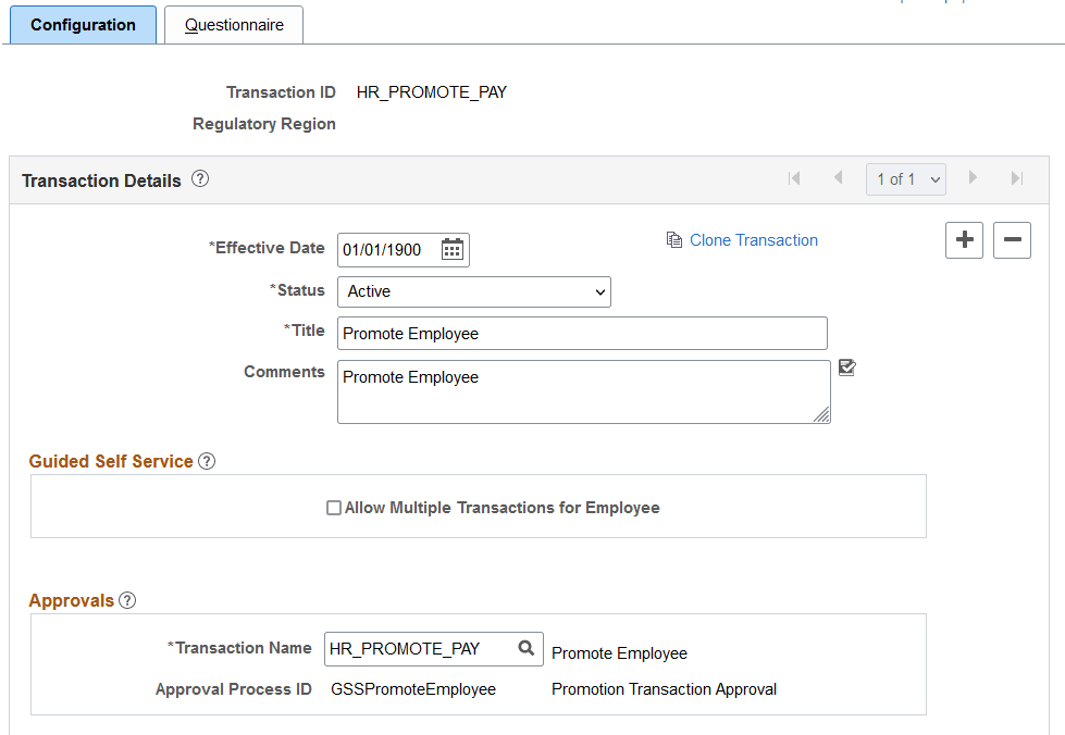

Transaction Configuration - Configuration Page
Use the Transaction Configuration - Configuration page (HR_MSS_CT_CFG) to configure guided self-service transactions for managers.
Navigation:
Set Up HCM, and then Common Definitions, and then Guided Self Service, and then Transaction Configuration, and then Configuration
This example illustrates the Transaction Configuration - Configuration page (1 of 2).
This example illustrates the Transaction Configuration - Configuration page (2 of 2).
Field or Control Description
Transaction ID
Configuration settings are keyed by effective date and regulatory region as well as by transaction ID, but the transaction ID is the field that identifies the transaction.
For example, all settings with the transaction ID HR_PROMOTE_PAY are for the Promote Employee transaction. At runtime, when a manager initiates a Promote Employee transaction, the system looks at the effective date and regulatory region values to select the correct row for the HR_PROMOTE_PAY transaction.
Regulatory Region
Displays the regulatory region that you are configuring. For every Transaction ID, there must be a configuration record with no regulatory region defined. This is the default configuration that system uses for employees in regulatory regions that do not have region-specific settings.
Transaction Details
Clone Transaction
Click to copy the current transaction to create a new configuration row for the transaction.
The newly created row retains the current Transaction ID, but you can enter a new effective date and / or regulatory region to create a modified configuration to support requirements that have changed or that are different for different regulatory regions.
Status
Keep the default value of Active for configurations that are currently in use. Select Inactive to remove a configuration from use. You cannot inactivate all effective-dated rows for a transaction’s default configuration (the configuration with no regulatory region).
Title
Enter a short description for this transaction. At runtime, the system will display this title at the top of the guided self-service pages.
Comments
Enter any additional descriptive information about the transaction.
Guided Self Service
Use this section to override the default setting that prevents a manager from submitting more than one transaction request for an employee at a time.
For more detailed information on enabling multiple transaction for an employee, see the "Allowing Multiple Guided Self Service Transactions for an Employee" subtopic under the Understanding Guided Self-Service Transactions discussion.
Allow Multiple Transactions for Employee
Select this option for individual transactions to override the delivered Guided Self Service setting that prevents managers from entering multiple job transactions for an employee.
Enabling this option at the transaction configuration level allows a manager to initiate a request for this specific transaction even though another transaction may be in progress for the employee. The system sees the transaction as an exception and allows it. You will need to enable this option for each transaction that should be an exception.
Important: Organizations can enable this functionality at a global level by selecting the Allow Multiple Transactions for Employee option in the Guided Self Service section of the Installation Table - Application Fundamentals: HCM Options Page. When this option is selected on the Installation Table, the system will allow multiple job requests for all transactions and effective dates. The system does not look at the individual transaction configuration settings. Note that you cannot disable a transaction when this functionality is enabled on the Installation Table. Oracle recommends that you do NOT enable multiple transactions at the global (Installation Table) level.
When deselected here and on the Installation Table, the manager cannot initiate a request if an employee already has a job transaction in progress.
Approvals
Transaction Name and Approval Process ID
Enter the workflow transaction name to be used. The system displays the approval process ID that is related to the specified workflow transaction.
The delivered transactions all include delivered approval processes. For a list of the delivered approval processes, see Understanding Delivered Approval Process IDs for Guided Self-Service Transactions.

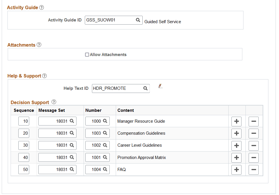

Activity Guide
This section appears only if you use PeopleTools 8.55 or above. In earlier versions of PeopleTools, guided self-service transactions do not use the Activity Guide framework.
Activity Guide ID
Select the activity guide that renders the transaction steps to end users. Guided self-service transactions that Oracle delivers already include an activity guide ID.
Activity Guides have their own security setup.  In the delivered activity guides, the eProfile Manager Fluid role has access to guided self-service transactions. If you set up your own activity guides, or if you use other roles for guided self-service users, use the activity guide security settings to ensure all users have proper access.
The delivered activity guides are GSS_POSN1L for the Clone Position transaction and GSS_SUOW01 for all other delivered transactions. Do not modify these activity guides except to update security. If you need to change other areas of the activity guide configuration, clone the delivered activity guide, make your changes, and then update the transaction to reference the modified activity guide.
Allow Attachments
Select this check box to enable requestors to attach supporting documents for this transaction.
When this check box is selected, the Review and Submit page for the transaction includes an attachments section where the requestor can upload attachments related to the request.
Approvers using classic approval pages or Fluid Approvals can review these attachments during the approval process. (Attachments are not supported by the Mobile Approvals Platform (MAP). If you still use MAP, consider switching to Fluid Approvals so that approvers can see attachments.)
For information on configuring attachment storage and allowable file types, see Understanding URL Definitions for Guided Self-Service Attachments.
Help & Support
Help Text ID
Enter the message catalog text ID for the introductory text that appears before the questions on the Questionnaire Page of the guided transaction. This text gives the user instructions or guidance for answering the questionnaire.
Edit Help Text icon Edit Help Text icon
If a Help Text ID has been entered, you can click the Edit Help Text pencil icon to open a dialog box that displays the specified text catalog entry on the Application Fundamentals: Maintain Text Catalog Page. Use the dialog box to view or modify the text catalog entry.
Decision Support
Use this section to list the decision support topics that appear within the Decision Support tab on the Questionnaire page. This information should provide guidance and assist the user in completing the transaction.
Sequence
Enter the order in which the Decision Support tab should display the help topics.
Message Set and Number
Select the message set and number associated with the text that you want to display for Decision Support. The messages will appear as links and text on the Decision Support tab on the Questionnaire Page. Use the PeopleTools message catalog (not the HCM Text Catalog) to define additional decision support content for your organization.
Content
Displays the message text from the specified message catalog entry.
Clone Transaction Secondary Page
Use the Clone Transaction secondary page (HR_MSS_CT_CLNE_SEC) to create a new row for an existing transaction ID, and specify the effective date and regulatory region for the new row.
Navigation:
Click the Clone Transaction link on the Transaction Configuration - Configuration page.
This example illustrates the Clone Transaction secondary page.
Regulatory Region
Enter the regulatory region for the new row to be created. When a transaction has different configurations for different regulatory regions, the system uses the configuration for the employee who is being processed. If there is not a row for the employee’s regulatory region, the system uses the default configuration (the one that does not have any regulatory region specified).
Title
The title for the new row appears as the transaction title at runtime.
Use the Transaction Configuration - Questionnaire page (HR_MSS_CT_SEQ) to add questions for guided self-service transactions.
Navigation:
Set Up HCM, and then Common Definitions, and then Guided Self Service, and then Transaction Configuration, and then Questionnaire
This example illustrates the Transaction Configuration - Questionnaire page.
The pages and fields that appear in a guided self-service transaction depend on the answers to the questions listed in the Questionnaire grid. All transactions must have at least one question, even if that question is hidden and the end-user never sees it. Questions that are not hidden appear on the Questionnaire Page, which is presented to the end user when the transaction is first invoked.
Questions Tab
Sequence
Enter a sequence number to determine order in which the questions are presented to the end-user on the Questionnaire page.
For the Hide Action/Reason setting on the Actions tab, the sequence also determines which setting is used if different rows have different settings. Specifically, the system uses the settings from the first question that has a Yes answer.
Question Text ID
Enter the text catalog ID for the text of the question. Valid text catalog IDs are those that have the object owner ID of HELM (eProfile Manager Desktop) and the sub ID of CT.
On the Form Factor tab, you can enter a different text catalog ID for small form factor devices such as phones.
View/Edit Text
If a Question Text ID has been entered, you can click this link to open a dialog box that displays the text catalog entry on the Maintain Text Catalog page. Use the dialog box to view or modify the text catalog entry.
Default Response
Select a default response of Yes or No to this question. The field defaults to No.
Hide Question
Select this check box to hide this question from the end user on the Questionnaire page. This check box is enabled only when the Default Response value is Yes.
If all the questions defined for a transaction are hidden, the Questionnaire page is not displayed as part of the guided self-service transaction.
Note: Any fields that are essential to a transaction should be associated with a hidden question. Because this question always has a Yes answer, the fields are always included in the transaction, even if the user answers No to all other questions.
Actions Tab
This example illustrates the Actions tab from the Questionnaire grid on the Transaction Configuration - Questionnaire page.
Transaction Configuration - Questionnaire page: Actions tab
The fields on this tab relate to the actions and action reasons on the employee’s job record. They are not relevant to the delivered Clone Position transaction, which does not affect employee job records.
Action
Select the personnel action code to associate with this question. You can select any active action that is defined on the PeopleSoft Human Resources Administer Workforce: Actions Page, with the exception of these actions:
  • Hire
  • Rehire
  • Add Contingent Worker or Renewal (actions for contingent workers).
The system uses this action code in the new Job record row that is created when the transaction is approved. If the same action code is specified for all of the transaction’s questions, then the system writes one row to the Job record. If different questions have different action codes, then the system creates multiple rows in the Job record, but the same data, except for the action and action reason, is written to each row.
Note: The manager will not see the Action field on the guided self-service transaction page.
Action Reasons
Click to access the Action Reasons Page, where you can choose valid action reasons for the job data row that the transaction creates and you can choose a default action reason.
Note: Rows that have the same action must also have the same action reason settings. If you change the action reason settings for a row, your changes are automatically applied to any other rows with the same action.
Hide Action Reason
Select this check box to hide the Reason field on the guided self-service transaction pages. This configuration prevents the manager from overriding the default reason.
If you select this check box for some questions but not for others, at runtime the system uses the setting from the first question that has a Yes answer. Typically this is the first question in the transaction, which is normally configured as a hidden question with a Yes answer.
When you select the Hide Action Reason check box, the Action Reasons link on this configuration page becomes read-only. Therefore, if you want a default action reason that cannot be changed, click the Action Reasons link and choose a default action reason before you select the Hide Action Reason check box.
Action Reason Required
Select this check box if an action reason is required for the transaction. This check box is available only if the Reason field is visible in the transaction (that is, the Hide Action Reason check box is not selected).

Action Reasons Page
Use the Action Reasons page (HR_MSS_CT_RSN_SEC) to choose the valid action reasons for the job data row that the transaction creates and to choose a default action reason.
This page is not relevant to the delivered Clone Position transaction.
Navigation:
Click the Page Fields link on the Actions tab of the Transaction Configuration - Questionnaire page.
This example illustrates the Action Reasons page.
Action Reasons page
Important:
The fields at the top of the page identify the transaction and regulatory region you are configuring and the action code for which you are configuring action reasons.
Action Reasons Grid
Reason Code and Description
These fields identify the action reasons that are associated with the action you are configuring. The grid lists all available reasons for the specified action.
Display
Select this check box to make an action reason available for the job data row that gets created for this action. You must select this check box for the default action reason. Also select this check box for all values that you want managers to be able choose manually.
If you configure the transaction to hide the Action Reason field from end users, then the end user cannot override the default and there is no reason to select any rows other than the default.
Default
Select this check box for one row only. The selected reason becomes the default reason for the job row that is created with the specified action. The end user will be able to override the default reason unless you select the Hide Action Reason check box for this action.
If multiple questions have the same action code but different reasons, the system uses the default reason for the first question that has a Yes answer. Typically this is the first question in the transaction, which is normally configured as a hidden question with a Yes answer.
