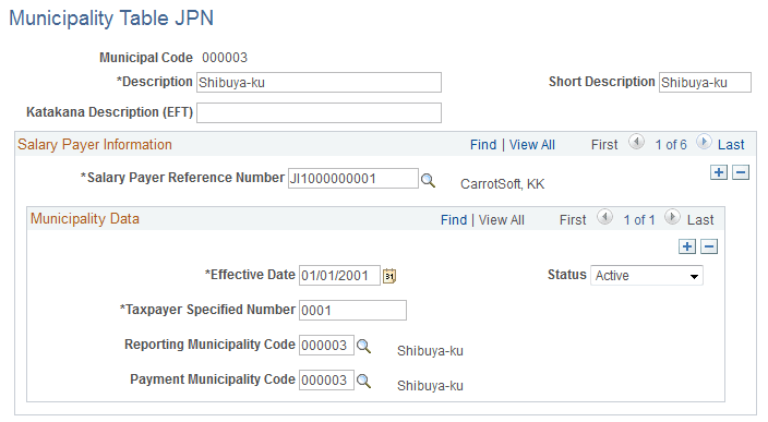

Municipality Table JPN Page
Use the Municipality Table JPN page (GPJP_IH_MUNIC) to define municipality codes and associate them with salary payers.
For each salary payer, record the taxpayer-specified number assigned by the municipality.
Navigation:
Set Up HCM, and then Product Related, and then Global Payroll & Absence Mgmt, and then Taxes, and then Municipality Table JPN, and then Municipality Table JPN
This example illustrates the fields and controls on the Municipality Table JPN page. You can find definitions for the fields and controls later on this page.
Field or Control Description
Salary Payer Reference Number
Select each income tax establishment associated with this municipality.
Taxpayer Specified Number
Enter the number assigned by the municipality to the salary payer for special collection.
Reporting Municipality Code
Enter the reporting municipality code where the wage payment report to be sent.
Payment Municipal Code
Enter the municipal code where the inhabitant tax should be paid.
