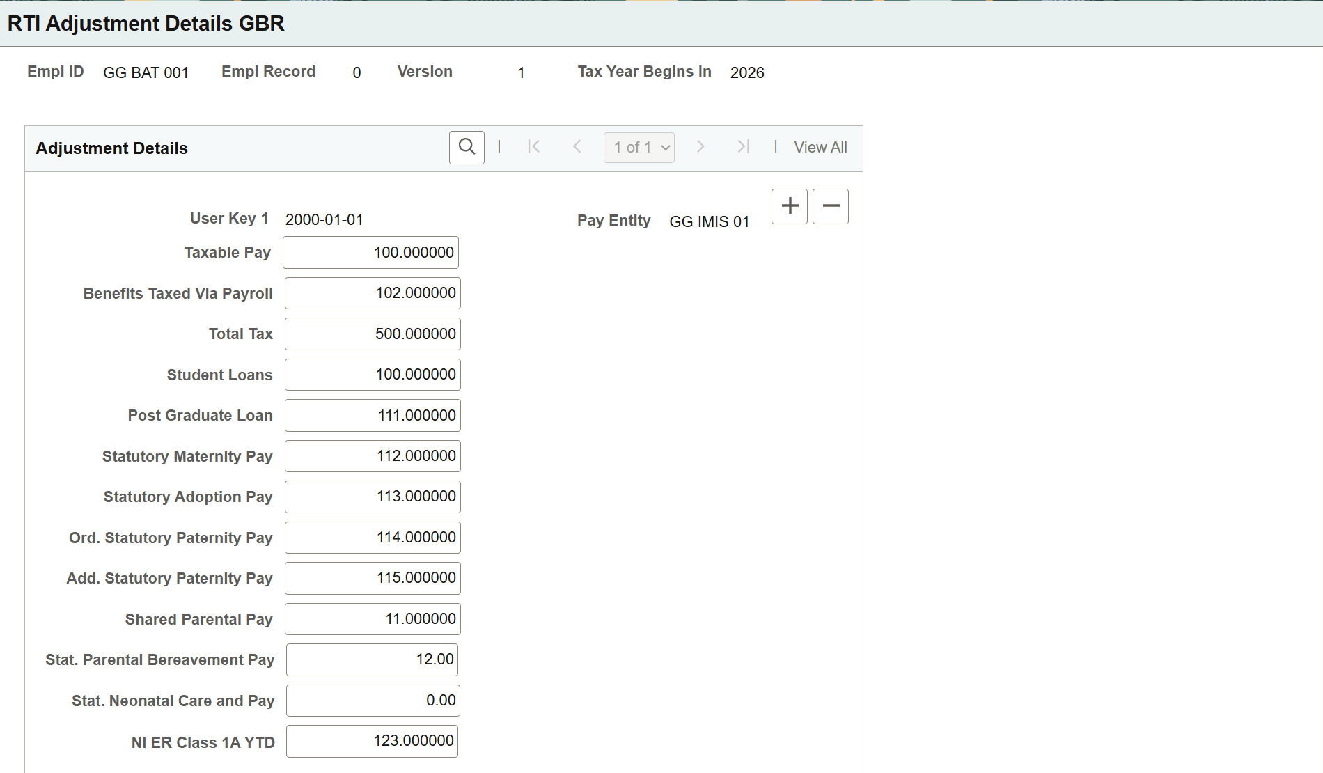

Tax/Absence Adjustments Page
GPGB_RTI_TAX_ADJ
To capture the adjustment tax details of the employees for EYU process.

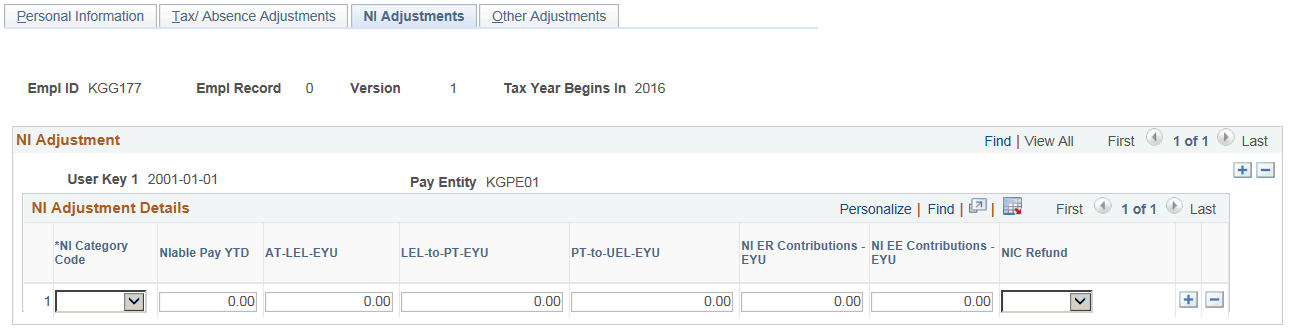

NI Adjustments Page
GPGB_RTI_NI_ADJ
To capture the adjustment NI details of the employees for EYU process.

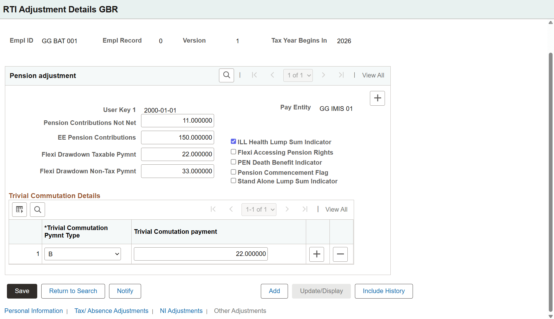

Other Adjustments Page
GPGB_RTI_ADJ_OTH
To capture any additional adjustments required for EYU.

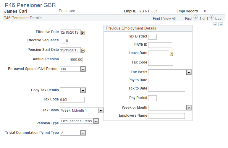

P46 Pensioner GBR Page
Use the P46 Pensioner GBR page (GPGB_P46_PENSN_DTL) to complete the P46 Pensioner page information when customers do not create a new employment record for employees who become pensioners.
Navigation:
Global Payroll & Absence Mgmt, and then Payee Data, and then Pension Information, and then P46 Pensioner GBR, and then P46 Pensioner GBR
This example illustrates the fields and controls on the P46 Pensioner GBR page.
When customers do not create a new employment record for employees who become pensioners, the Starter Declaration for a pensioner is sent to HMRC but the date that the pension started is sent in place of the employee's hire date. The P46 Pensioner page is used under such instances.
Field or Control Description
Trivial Commutation Pymnt Type (Trivial Commutation Payment Type)
A trivial commutation pension payment and other lump sum pension payments are one-off lump sums that pay off or are paid in place of a small pension, instead of paying the usual weekly, monthly or annual payments. Typically, these one-off payments are used if the regular payments would be very small.
Categorize these payments in the Trivial Commutation Payment Type field. The field indicates the type of lump sum paid (other than lump sum death benefits and on serious ill-health).

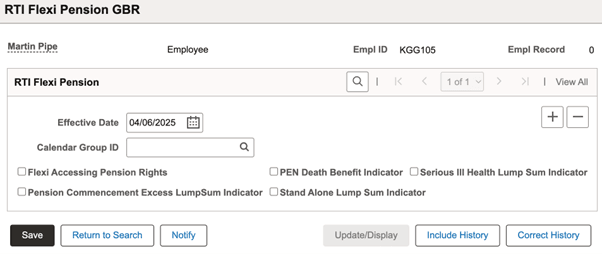

RTI Flexi Pension GBR Page
Use the RTI Flexi Pension GBR Page (GPGB_RTI_PEN_FL_IN) to select the RTI flexi drawdown pension. Flexibly accessing pension rights details are incorporated in RTI using FPS.
Navigation:
Global Payroll & Absence Mgmt, and then Payee Data, and then RTI Flexi Pension GBR
This example illustrates the fields and controls on the RTI Flexi Pension GBR page.
Effective Date
Enter the date from which the pension is effective.
Calendar Group ID
Select the required calendar group id for the Flexi Pension to be selected.
Flexi Accessing Pension Rights
Select if any part of the taxable/non-taxable payment is a flexi accessing pension rights payment.
PEN Death Benefit Indicator
Select if any part of the taxable/non-taxable payment is a Pension death benefit payment.
Serious Ill Health Lump Sum Indicator
Select if any part of the taxable/non-taxable payment is a serious ill health lump sum payment.
Pension Commencement Excess LumpSum Indicator
Select if any part of the taxable/non-taxable payment is a pension commencement excess lump sum payment.
Stand Alone Lump Sum Indicator
Select if any part of the taxable/non-taxable payment is a stand alone lump sum payment.

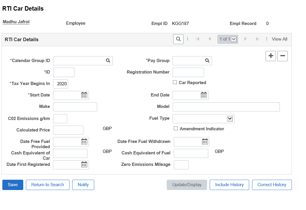

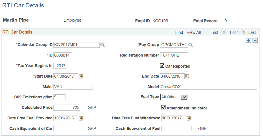

RTI Car Details Page
Use the RTI Car Details Page (GPGB_RTI_CAR) to enter the Car details. Company Car details is incorporated in RTI using FPS.
Navigation:
Global Payroll & Absence Mgmt, and then Payee Data, and then Real Time Information GBR, and then RTI Car Details GBR
This example illustrates the fields and controls on the RTI Car Details GBR page.
RTI Car Details GBR Page
Calendar Group ID
Select the required calendar group id for the car. Car will be added in the FPS report with the specified Calendar Group ID.
Pay Group
Select the pay group for the car. Car will be added in the FPS report with the selected Pay Group details.
ID
Enter a unique identification for the car. This helps to distinguish multiple car added for the same employee in the same Calendar group ID.
Registration Number
Enter the registration number of the car. It is the car identifier in the FPS report.
Car Reported
Once the car is reported in the Calendar Group, Car Reported check box will be selected by the FPS process. If we rerun FPS for the same Calendar Group, the cars will be reported again but not for the subsequent calendars.
Start Date
Enter the date from which the car is available.
End Date
Enter the date up to which the car is available.
Amendment Indicator
Select the check box if there is any amendment in the already reported cars.
If the tax year begins in 2020, two additional fields will be displayed as shown:
RTI Car Details page
Date First Registered
Date on which the car was registered.
Zero Emissions Mileage
Enter the zero emission miles.

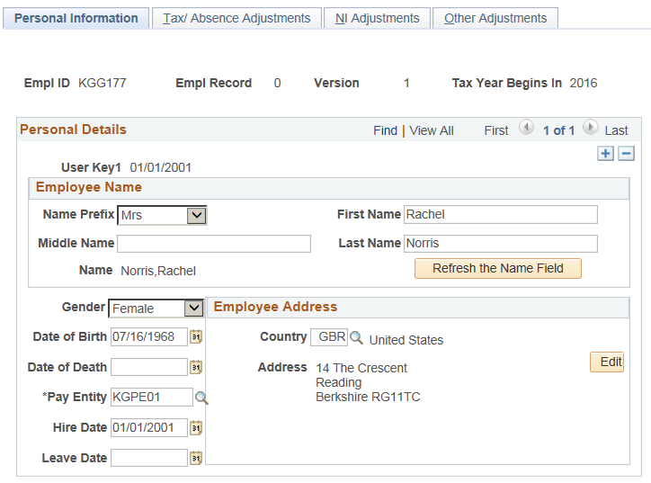

Personal Information Page
Use the Personal Information Page (GPGB_RTI_PERD_ADJ) to capture the personal information of the employees that needs to be modified while running EYU (Earlier Year Update) process.

This example illustrates the Personal Information page.
RTI Adjustment Details Personal Information Page
Based on the selected employee, the details are displayed. If you update any data the same will be considered while reporting EYU.
Use the Tax/Absence Adjustments page(GPGB_RTI_TAX_ADJ) to capture the tax details that need to be modified while running EYU process.
The values submitted in the EYU file are adjustments and not replacement values. For example, consider a scenario where you have submitted a value of £1000 in the final FPS for an employee's Tax Paid YTD value, and then you want to change it as £1500. Here, to change the amount, you should submit a value of £500 in the EYU file, not £1500. Adjustment values may be positive or negative.
Navigation:
Global Payroll & Absence Mgmt, and then Payee Data, and then Taxes, and then RTI Adjustment Details GBR, and then Tax/Absence Adjustments
This example illustrates the Tax/Absence Adjustments Page.
NI Adjustments Page
Use the NI Adjustments page( GPGB_RTI_NI_ADJ ) to capture the NI details that need to be modified while running EYU process.
Navigation:
Global Payroll & Absence Mgmt, and then Payee Data, and then Taxes, and then RTI Adjustment Details GBR, and then NI Adjustments
This example illustrates the NI Adjustments Page
NI Adjustments Page
Use the Other Adjustments Page( GPGB_RTI_ADJ_OTH ) to capture any additional adjustments required for EYU..
Navigation:
Global Payroll & Absence Mgmt, and then Payee Data, and then Taxes, and then RTI Adjustment Details GBR, and then Other Adjustments
This example illustrates the Other Adjustments Page.
Other Adjustments
You can enter any adjustments made for previous tax years in the Disguised Remuneration Income field. This field is displayed only if tax year is 2018 or above.
