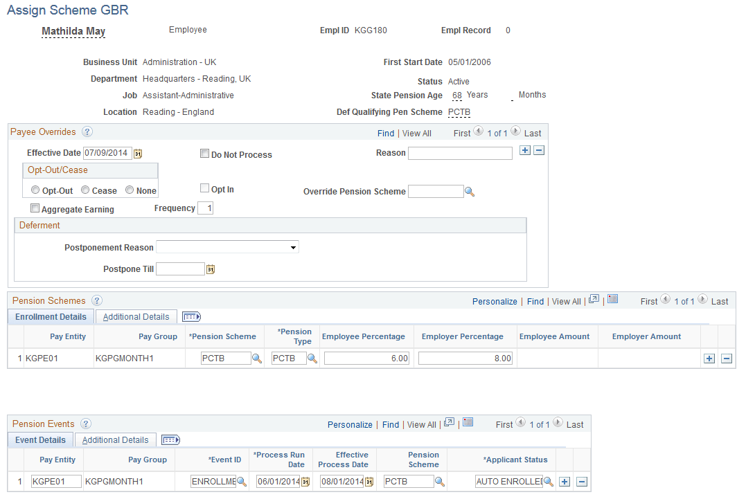

Assign Scheme GBR Page
Use the Assign Scheme GBR page (GPGB_EE_PENSION) to define payee data for pension.
Navigation:
Global Payroll & Absence Mgmt, and then Payee Data, and then Pension Information, and then Assign Scheme GBR, and then Assign Scheme GBR
This example illustrates the fields and controls on the Assign Scheme GBR page.
Auto Pension Enrollment GBR page
This example illustrates the fields and controls on the Pension Schemes and Pension Events - Additional Details tabs.
The Pension Schemes and Pension Events grids are updated by the auto enrolment process run using the Auto Pension Enrollment GBR page. See Auto Pension Enrollment GBR Page.
Payee Overrides
The Payee Overrides grid is used by Administrators to enroll non-eligible workers/job holders using the Opt-in functionality. The applicant is opted out in the subsequent auto enrolment process run. Administrators can also define postponement at payee level.
Field or Control Description
Effective Date
If you select the Opt In check box, enter the date on which the opt-in notice is received. If you select the Opt-Out option, specify the end date of the qualifying pension scheme currently active in the system. See Qualifying Pension Scheme GBR Page.
Note: The system considers the maximum effective dated entry.
Opt-Out/Cease
Select the Opt-Out option to opt out the employee from the pension scheme. The auto enrolment batch process opts out the employee. The auto enrolment process updates the pension end with the effective date provided for the opt-out. The pension end date is displayed in the End Date field in the Pension Schemes – Additional Details tab. The employee receives the entire pension amount deducted as a refund.
Select the Cease option to stop the employee’s pension scheme. The process updates the Pension end date with the effective date provided for the opt-out or cease. Pension deduction happens during the cease period. Refund is not applicable for the Cease option.
When the Opt In check box is selected to enroll an employee back into the pension scheme, the Opt-Out/Cease options are disabled till the auto enrolment process is run.
Note: Eligible employees can be auto-enrolled only after three years of opting out.
Do Not Process
Select this check box for employees who should not be includes for the auto enrolment batch process.
Opt In
Select this check box if a non-eligible employee needs to be opted in.
Specify a new effective date and select the Opt In check box for re-enrolment, if the previous enrolment has been cancelled using the Opt-Out option, as requested by the employee.
The employee can be opted back into the system immediately after the opt-out or cease. Opt in is enabled if the employee is not enrolled in any pension scheme or employee has already been opted out from the pension scheme.
Override Pension Scheme
Select the applicable pension scheme for employees who need to be enrolled using the Opt In check box.
Aggregate Earning
Select this check box if earnings from multiple jobs need to be added before comparison with the earnings threshold to calculate eligibility for auto enrolment.
Frequency
If the employee has multiple records in different pay reference periods, enter a frequency. When the most recent payroll earnings are multiplied by the frequency, it calculates the amount paid to the employee in the default pay reference period.
Postponement Reason
Select the valid reason. Values include Job Holder Deferment, Staging Date Deferment, and Worker Deferment.
Postpone Till
Enter the postponement date.

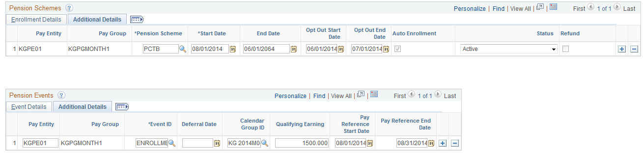

Pension Schemes – Enrollment Details Tab
Employee Percentage/Employer Percentage/Employee Amount/Employer Amount
Appropriate values are updated by the auto enrolment batch process.
Pension Schemes – Additional Details Tab
Start Date
Enter the start date of the pension scheme.
End Date
Enter the end date of the pension scheme.
Opt Out Start Date
Enter the start date of the opt-out period.
Opt Out End Date
Enter the end date of the opt-out period.
Pension Events – Event Details Tab
Event ID
Events are automatically updated by the auto enrolment batch process.
Process Run Date
The process run date entered in the for the auto enrolment batch process is updated in this field.
Effective Process Date
Indicates the first day of the period from which the event will be effective.
Pension Scheme
Indicates the name of the pension scheme.
Applicant Status
The status is automatically updated by the auto enrolment batch process.
Pension Events – Additional Details Tab
Calendar Group ID
Enter the calendar run ID of the most recent payroll that needs to be used by system for assessment. For example, if the April Payroll is finalized and May Payroll is being processed, you can select either April or May payroll for assessment.
Qualifying Earning
Enter the qualifying earning value for the calendar mentioned in the Calendar Group ID field.
Pay Reference Start Date
Enter the start date of the most recent period in which the pension payment was made.
Pay Reference End Date
Enter the end date of the period in which the pension payment was made.

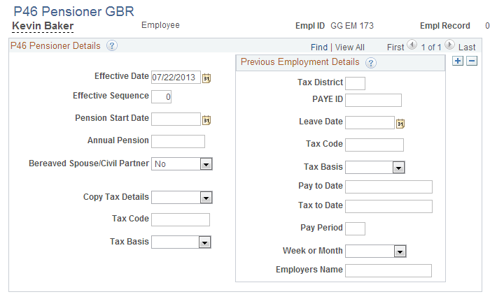

P46 Pensioner GBR Page
Use the P46 Pensioner GBR page (GPGB_P46_PENSN_DTL) to enter P46 pensioner information for pensioners and eligible dependents.
Navigation:
Global Payroll & Absence Mgmt, and then Payee Data, and then Pension Information, and then P46 Pensioner GBR, and then P46 Pensioner GBR
This example illustrates the fields and controls on the P46 Pensioner GBR page.
P46 Pensioner Details
Bereaved Spouse/Civil Partner
No and Yes
Dependent ID
If you select Yes in the Bereaved Spouse/Civil Partner field, the system displays this field. Select the dependent that should receive pension benefits.
Copy Tax Details and Tax Code
If you select No in the Bereaved Spouse/Civil Partner field, the system displays this field.
Select Yes to copy tax details. The system automatically fills in the Tax Code and Tax Basis fields.
Select No if you do not want to copy tax details. In this case the system fills in the Tax Code field.
Tax Basis
If you select No in the Copy Tax Details field, select either Cumulative or Wk 1/Mnth1.
Previous Employment Details
If the person you are enrolling worked for another employer, fill in these fields:
  • Tax District
  • PAYE ID
  • Leave Date
  • Tax Code
  • Tax Basis
  • Pay to Date
  • Tax to Date
  • Pay Period
  • Week or Month
  • Employers Name
