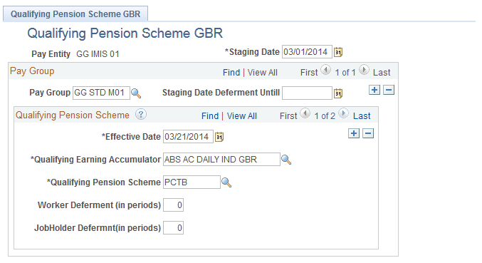

Qualifying Pension Scheme GBR Page
Use the Qualifying Pension Scheme GBR page (GPGB_QPNSH_DFLT) to define the Qualifying Pension Scheme for a pay entity.
Navigation:
Set Up HCM, and then Product Related, and then Global Payroll & Absence Mgmt, and then Pensions, and then Qualifying Pension Scheme GBR, and then Qualifying Pension Scheme GBR
This example illustrates the fields and controls on the Qualifying Pension Scheme GBR page.
Field or Control Description
Pay Entity
Indicates the pay entity to which the qualifying pension scheme will be mapped.
Staging Date
Enter the staging date defined for the employer.
Staging Date Deferment Untill
Enter an alternate staging date if the current staging date needs to be deferred.
Effective Date
Enter a base date to calculate the end date of worker/job holder deferment.
Qualifying Earning Accumulator
Enter the earning accumulator to be used by the auto enrolment batch process to validate against the qualifying earning thresholds.
Enter the pension scheme to be mapped to the pay entity.
Worker Deferment (in periods)
This field is applicable for new employees in the organization. Enter a period value for the system to apply worker deferment (if available) for employees for whom either no event has been triggered or postponement has been triggered.
JobHolder Defermnt (in periods)
This field is applicable for the current employees in the organization. Enter a period value for the system to apply job holder deferment (if available) for employees for whom no event for postponement has been triggered.
Note: The number of periods entered in the Worker Deferment (in periods) or JobHolder Defermnt (in periods) fields are used for the automatic enrolment batch process. For example, if worker deferment period is entered as ‘1’ for a monthly pay group then an employee is the worker deferred by 1 month from his hire date. Similarly, If a job holder deferment period is entered as ‘1’ for a weekly pay group then an employee is the job holder deferred by 1 week from his first eligibility date.
See Auto Pension Enrollment GBR Page.

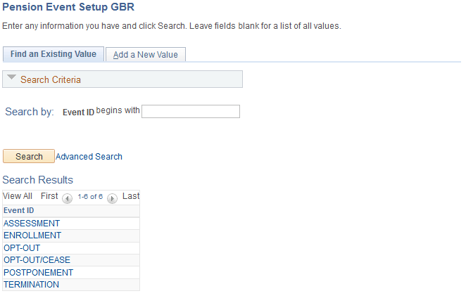

Pension Event Setup GBR Page
Use the Pension Event Setup GBR page (GPGB_SET_EVNT) to maintain events and the corresponding status for a pension applicant.
Navigation:
Set Up HCM, and then Product Related, and then Global Payroll & Absence Mgmt, and then Pensions, and then Pension Event Setup GBR, and then Pension Event Setup GBR
This example illustrates the fields and controls on the Pension Event Setup GBR search page.
Pension Event Setup GBR search page displaying system default events
This example illustrates the fields and controls on the Pension Event Setup GBR page.

For the values mentioned in the above table, the Process Used check box in the Pension Event Setup GBR page is selected. The check box appears in display-only mode. The auto enrolment process sets these events and statuses in the Pension Schemes and Pension Events grids in the Auto Pension Enrollment GBR page. However, the Payroll Administrator can add more events or statuses. Refer Auto Pension Enrollment GBR Page and Assign Scheme GBR Page.
