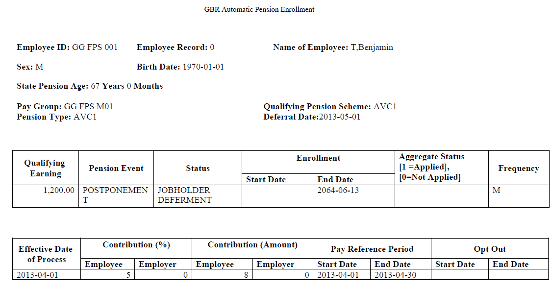

This example illustrates the GBR Automatic Pension Enrollment report sample.
