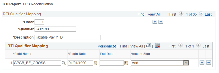

RTI Qualifier Mapping Page
GPGB_RTI_QL_MAP
Used to map the RTI Qualifiers to the GPGB_FPS_SUBMIT fields.

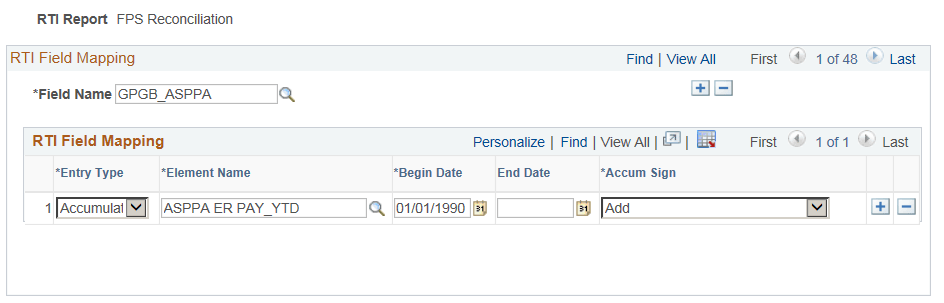

RTI Field Mapping Page
GPGB_RTI_FL_MAP
Used to map the GPGB_FPS_SUBMIT fields to Payroll Earning/Deduction Elements and Accumulators.

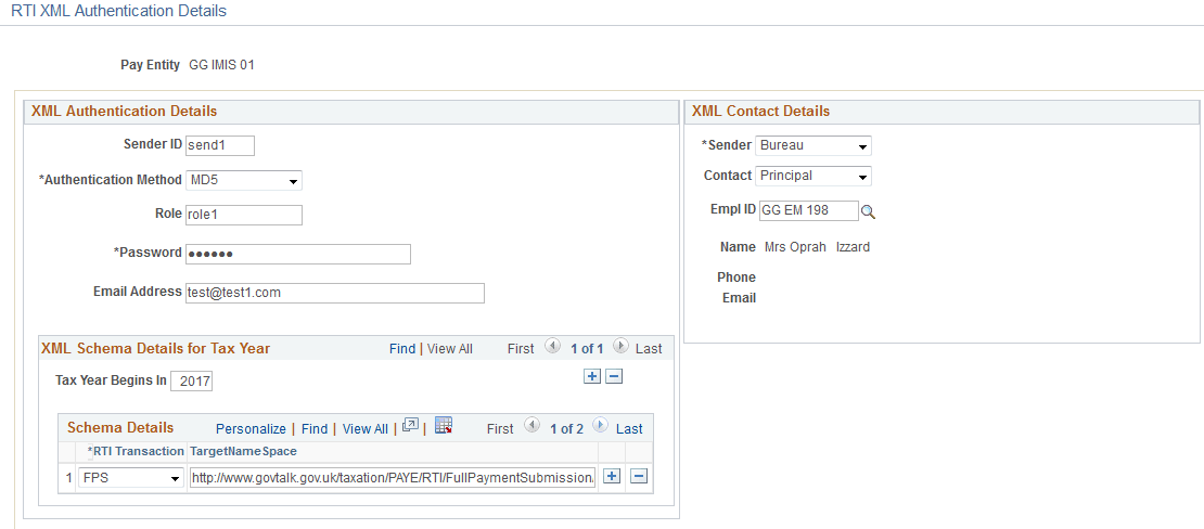

XML Additional Details
Click the XML Additional Details link to open the RTI XML Authentication Page.
This example illustrates the fields and controls on the RTI XML Authentication page
RTI XML Authentication Details
Field or Control Description
Sender ID
Enter the Gateway User ID.
Authentication Method
Enter the value as MD5.
Role
Enter the Authentication Role.
Password
Enter the Gateway password.
Sender Email Address
Enter the Sender’s Email Address.
Tax Year Begins in
Enter the tax begin year for which the RTI files are run.
RTI Transaction
Enter the RTI Report Type.
TargetNameSpace
Enter the URL that is used by HMRC for validation.
Note: A unique URL is used for each RTI report type and for each tax begin year. HMRC will be using this for validating the XML file submitted to them. The URL is given by HMRC for each year and for each report type in the tax year.
Sender
Select the sender from the available options.
Contact
Select the contact. This data helps HMRC to identify whether the files are sent by the Employer or through an Agent.
Note: If you select “Principal“ in the Contact field, then the Employee ID is automatically populated and the selected Employee’s contact details gets printed in the XML Report. If you select “Agent“ in the Contact field, then the Set ID and Vendor ID needs to be entered. The selected Vendor’s contact details gets printed in the XML Report.

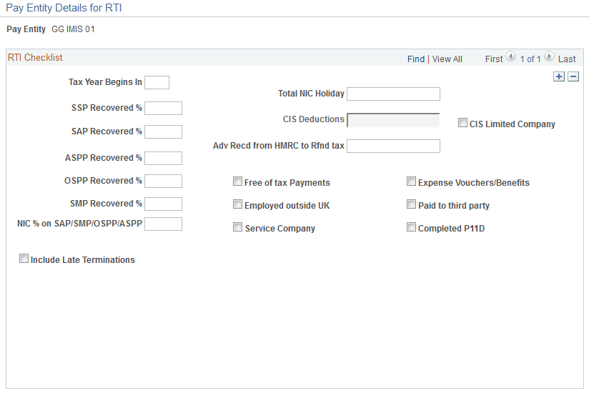

Pay Entity Details for RTI Page
Use the Pay Entity Details for RTI page (GPGB_PYENT_RTI) to enter high level information required for RTI in addition to your existing EDI configuration.
Navigation:
Set Up HCM, and then Product Related, and then Global Payroll & Absence Mgmt, and then Framework, and then Organizational, and then Pay Entity Details GBR, and then Pay Entity Details GBR. Click the RTI Checklist link.
This example illustrates the fields and controls on the Pay Entity Details for RTI page.
Tax Year Begins In
Indicates the corresponding tax year in order for which the RTI files will be generated.
Note: No files will be generated if this field is blank.
SSP Recovered %, SAP Recovered %, ASPP Recovered %, OSPP Recovered %, and SMP Recovered %.
The statutory payment amounts to be recovered are calculated using the percentage values entered in these fields. These amounts are calculated when generating the EPS file.

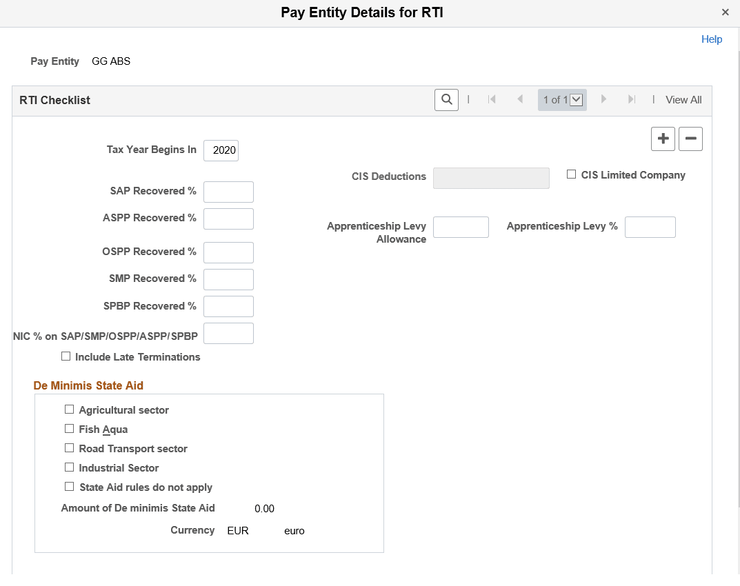

If the ‘Tax Year Begins in’ is selected as 2020 or above, the page is displayed as shown below.
This example illustrates the Pay Entity Details for RTI page when ‘Tax Year Begins in’ is selected as 2020.
Pay Entity Details RTI page
SPBP Recovered%
Enter the rate at which Statutory Parental Bereavement Pay (SPBP) can be recovered. This can be a partial or full recovery according to the employers annual liability for NI. Typically this is 92% for large employers and 100% for small employers.
De Minimis State Aid
Select the appropriate sector if you are claiming for Employment Allowance. If State Aid rules do not apply is selected than do not select any other options.

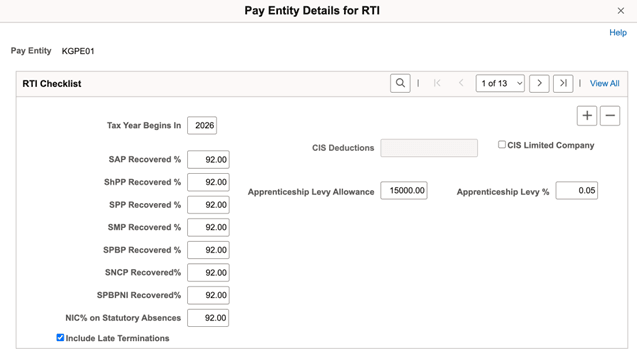

If the ‘Tax Year Begins in’ is selected as 2026 and above, the page is displayed as shown below.
This example illustrates the Pay Entity Details for RTI page when ‘Tax Year Begins in’ is selected as 2026.
pay entity details rti
SPBPNI Recovered%
NIC% on Statutory Absences

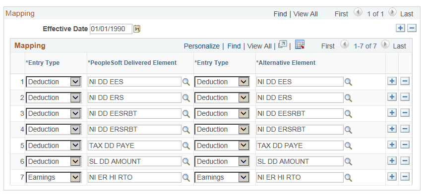

RTI Elements Mapping Page
Use the RTI Elements Mapping page (GPGB_RTI_REC_MAP) to map any customized Earnings/Deductions that is used instead of the PeopleSoft delivered Earnings/Deductions that are being reported in RTI. The mapping data will be delivered pre-populated and can be changed based on payroll elements, if required.
Navigation:
Set Up HCM, and then Product Related, and then Global Payroll & Absence Management, and then Reports, and then RTI Elements Mapping GBR
This example illustrates the fields and controls on the RTI Elements Mapping GBR page.
Effective Date
The date from which the Mapping is valid.
Entry Type
Displays the Element Type. Values can be:
  • Earning
  • Deduction
PeopleSoft Delivered Element
The Element Name that is used/delivered by PeopleSoft.
Alternative Element
The Element Name that is used by the customer for the same Earning/Deduction as delivered by PeopleSoft.
Use the RTI Qualifier Mapping page (GPGB_RTI_QL_MAP ) to map the RTI Qualifiers to the GPGB_FPS_SUBMIT fields. The mapping data will be delivered pre-populated and is recommended to not modify this data. The Reconciliation Process will pick up the mappings from this page.
This mapping is only used for RTI Reconciliation and not used in the process to generate the RTI files.

This example illustrates the fields and controls on the RTI Qualifier Mapping GBR page.
RTI Report
Values can be:
  • FPS Reconciliation
  • EPS Reconciliation
  • Payroll Reconciliation
Order
The Sequence Order of the Field on the Report.
Qualifier
The actual Qualifier Name on the Report as specified by HMRC.
Description
The description of the Qualifier.
Field Name
The name of the field from GPGB_FPS_SUBMIT that is mapped to the particular Qualifier.
Begin Date
The date from which the mapping is valid.
End Date
The date till which the mapping is valid.
Accum Sign
Values can be:
  • Add: Specify whether the corresponding field adds to the Qualifier Total.
  • Subtract: Specify whether the corresponding field deducts from the Qualifier Total.
Use the RTI Field Mapping page (GPGB_RTI_FL_MAP ) to map the GPGB_FPS_SUBMIT fields to Payroll Earning/Deduction Elements and Accumulators. The mapping data will be delivered pre-populated and is recommended to not modify this data. The Reconciliation Process will pick up the mappings from this page.
Navigation:
Set Up HCM, and then Product Related, and then Global Payroll & Absence Management, and then Reports, and then RTI Field Mapping GBR
This example illustrates the fields and controls on the RTI Field Mapping GBR page.
RTI Report
Field Name
The name of the fields that are being used for reporting and are mapped on the Qualifier Mapping page.
Entry Type
  • Earning
  • Deduction
  • Accumulator
Element Name
The Element Name that is mapped to the Field.
Begin Date
End Date
Accum Sign
Values can be:
