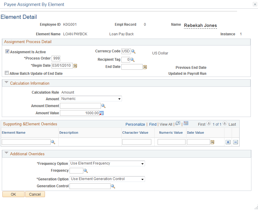

Element Detail Page
GP_ED_PYE_DTL_SEC
Use this page to:
  • Assign earnings and deductions to payees.
  • Override the component values defined for an earning or deduction element.
  • Override variable values associated with an earning or deduction assigned to a payee.
  • Override generation control, frequency, and arrears.

Batch Updates to End Dates of Assigned Earnings and Deductions
Batch updates to the end dates of assigned earnings and deductions are governed by two system elements: SET ED END DATE and UNSET ED END DATE. The process by which the system updates end dates involves the following steps:
  • For each earning and deduction assignment, the system checks the Allow Batch Update of End Date check box. If it is selected, the system checks the associated system elements.
  • If the SET ED END DATE system element is on:
    • The system updates the Previous End Date field with the current value of the End Date field.
    • The system updates the End Date field with the date of the slice or segment that initiated the end date change.
    • The system updates the Updated in Payroll Run field with the ID and description of the calendar group that initiated the end date change.
  • If the UNSET ED END DATE system element is on:
    • The system deletes the current value of the End Date field, leaving it blank.
These system elements work only within the context of the current earning or deduction being processed. Furthermore, PeopleSoft does not deliver a method to turn the SET ED END DATE and UNSET ED END DATE system elements on. Therefore, you should create a formula that turns these system elements on and attach it as a post-process formula to the earnings and deductions for which you want to update the end date. By defining the formula yourself, you can choose how your system determines the criteria for turning the system elements on.
For example, assume that you have a loan deduction that you want stopped when they payee to which it is assigned pays off the loan amount. In addition, you want the system to update the end date of the loan deduction to reflect the stoppage of repayment. To accomplish this you create a formula with the following parameters:
  • Name of deduction: GXDDED01.
  • Variable: GXVRED01. This value stores the loan amount (amount to be repaid).
  • Variable: GXVRED02. This is a temporary variable that is used to store a temporary value during the processing of the formula.
  • Accumulator: GXDDED01_CUS. This custom period accumulator stores the amount paid, to date, toward the loan amount.
Using these parameters, you create a formula with the following parts:
  1. If the amount paid to date plus the current amount is less than the loan amount then exit. This part of the formula is expressed as:
    If (ac) GXDDED01_CUS + (sy) CURR AMT VAL < (vr) GXVRED01
    THEN
    EXIT
  2. If the amount paid to date plus the current amount is equal to or greater than the loan amount, however, the system takes the amount paid to date plus the current amount and subtracts the loan amount. This is the amount that the system subtracts from the current amount to determine the amount to deduct. This part of the formula is expressed as:
    ELSE
    – (vr) GXVRED01 >> (vr) GXVRED02
    (sy) CURR AMT VAL – (vr) GXVRED02 >> (sy) OVRD CURR AMT VAL
    (sy) OVRD CURR AMT VAL >> (formula name)
    1 >> (sy) SET CURR AMT VAL
  3. Finally, because the condition was met, the system sets the end date:
    1 >> (sy) SET ED END DATE
Setting or unsetting the end date occurs only during current periods and not during retro periods.
WARNING:
It is recommended that you not update end dates in batch if you manually maintain the end dates for a payees or elements. Using this feature overrides any manually entered values that are not available to the formula.

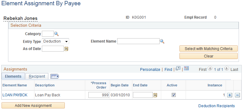

Element Assignment By Payee Page
Use the Element Assignment By Payee page (GP_ED_PYE) to by payee, view and update earning and deduction assignments, or disable earning/deduction assignments.
Navigation:
Global Payroll & Absence Mgmt, and then Payee Data, and then Assign Earnings and Deductions, and then Element Assignment By Payee
This example illustrates the fields and controls on the Element Assignment By Payee page.
When you first access this page, the system displays all existing assignments for the payee in the Assignments grid. Use the fields in the Selection Criteria group box to select and display a subset of the earnings and deductions retrieved for the payee.
Field or Control Description
Category
Select a category of elements to display. The system displays only categories that match the country of the pay entity. If no category is entered, category is not used in the element search.
Entry Type
Select an entry type. Valid options are:
  • Deduction
    Select to search for assigned deductions only.
  • Earnings
    Select to search for assigned earnings only.
  • Blank
    Select to search for both assigned earnings and assigned deductions.
Element Name
Enter an element name or leave the Element Name field blank to search on all elements belonging to the specified entry type and category.
Only elements with a country matching the payee's pay entity, or elements defined for all countries, are available for selection. In addition, you can enter only elements with an override level of Payee.
As of Date
Enter an as of date or leave the field blank.
If you enter an as of date, the system retrieves only those element assignments that are active as of the specified date. Active assignments include:
  • Assignments for which the begin date is less than or equal to the as of date and the end date is not specified.
  • Assignments for which the begin date is less than or equal to the as of date and the end date is greater than or equal to the as of date.
If you do not enter a date, the system retrieves elements without regard to the as of date.
Select with Matching Criteria
Click to select the earnings or deductions to which the payee has been assigned based on the specified search criteria.
Clear
Click to clear out all of the specified search criteria.
Add New Assignment
Click the Add New Assignment button to add a new earning or deduction assignment. When you do this, the Select an Element dialog box appears, where you must specify the entry type (earning or deduction) and the name of the element you want to assign. You can then click OK on the Select an Element dialog box to access the Element Details page where you can enter additional details related to the new assignment.
Deduction Recipients
Click to access the Add Deduction Recipients page for the payee whose name and ID are displayed at the top of the page.
Use the Add Deduction Recipients page to link a recipient to a deduction and a payee.
See Understanding Banking.
Elements
Access the Elements tab.
Use the fields on the Elements tab to update or disable element assignments.
To update an earning or deduction element for a payee:
  1. Click the Element Name hyper link.
  2. Modify the process order.
  3. Modify the end date.
To disable an earning or deduction assignment:
  1. Choose the assignment to disable.
  2. Deselect the Apply check box or manually enter an end date for the assignment.
When you assign an element to an element group, you indicate that the element should be calculated automatically for each payee whose eligibility group contains that element group, or that the element should be calculated only when it's assigned to a payee.
With the second option, the element is resolved for a payee only if positive input exists for the payee or you assign the element to the payee on the Element Assignment By Payee page, the Payee Assignment By Element page, or the Entitlement/Take Assignment page.
Process Order
Update the processing order of the assigned element.
The value of this field defaults to 999. 1 is the lowest value and indicates that the element will be processed first.
Note: This field controls the order in which assignments of the same element are processed. For example, if you assign Deduction A multiple times with the same or overlapping begin and end dates, the Process Order field controls which instance of the assignment is processed first, second, third, and so on. This field cannot be used to control the relative processing order of different elements. To do this, you must define the processing sequence of the elements using process lists and sections.
See Understanding Multiple Resolutions.
Begin Date
This field displays the begin date of the element assignment. To modify this date, click the Element Name hyper link to access the Element Detail page and change the date in the Begin Date field on that page.
End Date
This field displays the end date of the element assignment. You can modify this date directly in the End Date field on the Elements tab.
Active
This check box is selected by default. Deselect it to prevent the system from resolving the element for this payee.
Instance
The system automatically assigns an instance number to each element assigned.
The value of this field increases by 1 for each new occurrence of the same earning/deduction.
Note: This number is used to create unique instances of an element when there are multiple assignments of the same element. It allows multiple resolutions of an element with identical or overlapping begin and end dates.
See Generating Multiple Resolutions Using Element Assignments.
If you define a component to replace the standard element assignment interface, you can grant or deny users the ability to delete assignments, apply assignments, and update assignment begin and end dates. You cannot limit user access to these actions on the standard component shown here.
See Defining Element Definition Overrides.
Recipient
Select the Recipient tab.
Recipient Tag
Use the Recipient Tag field to update or modify the recipient tag for an earning or deduction assignment.
Recipient tags are used with multiple resolutions and for single resolutions for Individual Recipients. Because different assignments of the same element can each be associated with a unique recipient tag, and each tag can be tied to a different recipient ID or recipient name, the system can direct each resolution of the assigned element to a different recipient.
Define recipient tags for deductions and payees on the Add Deduction Recipients page.
See Assigning Recipients to Deductions and Payees.

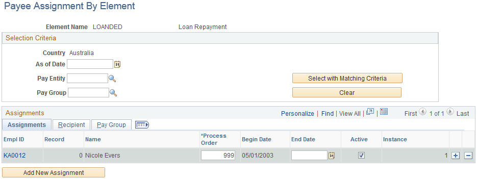

Payee Assignment By Element Page
Use the Payee Assignment By Element page (GP_ED_ELEM) to element by element, view and update earning and deduction assignments, or disable earning/deduction assignments.
Navigation:
Global Payroll & Absence Mgmt, and then Payee Data, and then Assign Earnings and Deductions, and then Payee Assignment By Element
This example illustrates the fields and controls on the Payee Assignment By Element page.
This page is similar to the Element Assignment By Payee page. Except for page elements described below, the information about the Element Assignment By Payee page applies to this page as well.
See Element Assignment By Payee Page.
Use the fields in the Selection Criteria group box to specify search criteria for retrieving the payees to whom the earning or deduction shown at the top of the page is assigned.
Country
This field is unavailable for data entry unless the element is defined for all countries. If the element applies to all countries, the field is blank and you can enter a specific country.
As of Date
If you enter an as of date, the system displays payees for whom the element assignment is active as of the date specified when you click the Select With Matching Criteria button.
Note: Active assignments are defined in the same way as when searching for elements by payee.
If you do not enter a date, the system displays all payees who have ever been assigned to the earnings and deductions retrieved during the search.
Pay Entity
Specify the pay entity of the employees with the element assignment that you want to retrieve.
Pay Group
Specify the pay group of the employees with the element assignment that you want to retrieve.
Add New Assignment
Click to add a new earning or deduction assignment.
When you do this, the Select Payee dialog box appears, where you must specify the EmplID (employee ID) and Empl Rcd Nbr (employee record number) of the payee to whom you are assigning the element, as well as an assignment begin date. You can then click OK on the Select Payee dialog box to access the Element Details page where you can enter additional details related to the new assignment.
Assignments
Select the Assignments tab.
Use the Active field on the Assignments tab to activate or disable element assignments.
Recipient
This tab appears for elements that are associated with a deduction recipient.
Recipient Tag
Use the Recipient Tag field to specify or modify the recipient tag for an earning or deduction assignment.
Note: Recipient tags are specifically for use with multiple resolutions: because different assignments of the same element can each be associated with a unique recipient tag, and each tag can be tied to a different recipient ID or recipient name, the system can direct each resolution of the assigned element to a different recipient.
Note: Define recipient tags for deductions and payees on the Add Deduction Recipients page.
Edit Recipients
Click to access the Add Deduction Recipients page for the payee whose ID is displayed in the EmplID column.

Element Detail Page
Use the Element Detail page (GP_ED_PYE_DTL_SEC) to:.
Navigation:
  • Click the element name link on the Element Assignment By Payee page.
  • Click the payee ID link on the Payee Assignment By Element page.
This example illustrates the fields and controls on the Element Detail page.
Element Detail page
You can modify the appearance of the Element Detail page using the Configuration by Element and Configuration by Category components, or designate a user-configurable component to replace this page. Depending on the option you choose, your page may appear different than the standard page shown here.
See Understanding Overrides.
Assignment Process Detail
