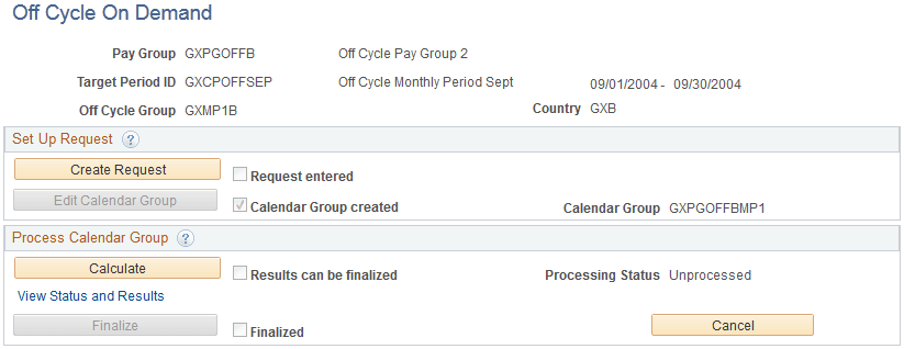

Off Cycle On Demand Page
Use the Off Cycle On Demand page (GP_ONDEMAND) to:
  • Create or edit an off cycle request.
  • Create or edit an off cycle calendar group.
  • Process the off cycle calendar group. You can calculate, cancel, or finalize the run from this page.
Navigation:
Global Payroll & Absence Mgmt, and then Absence and Payroll Processing, and then Off Cycle, and then Off Cycle On Demand, and then Off Cycle On Demand
This example illustrates the fields and controls on the Off Cycle On Demand page.
Field or Control Description
Create Request or Edit Request
Click to create a request on the Off Cycle Request page. When the request has been created, the button reads Edit Request, which you click to edit the off cycle request that is created.
Create Calendar Group or Edit Calendar Group
Click to access the Calendar Group page to create a calendar group for processing the off cycle transactions. When the calendar group has been created, the button reads Edit Calendar Group, which you click to edit the calendar group that is created.
See Defining Calendar Groups.
Calculate
Click to calculate the off cycle transactions. The calculation is performed as a remote call. The remote call causes the browser to remain on the Off Cycle On Demand page for the duration of the calculation process.
Note: The simplified approach of the Calculate push-button does not allow certain options like freezing calculations or running the process with element trace on. If this is desired, go to the Calculate Absence and Payroll page to process the off cycle calendar group.
See Entering Processing Instructions.
View Status and Results
Click to access the Payee Status page. Use this page to view payees by process indicator, calculation status, or other criteria and specify the action that the system is to take. Also, you can access the Results by Calendar Group component (GP_RSLT_CAL_RUN) or Payee Messages component (GP_MESSAGE) by clicking the links on the Payee Status page.
See Viewing Payee Status and Updating a Payee's Processing Instructions, Viewing Results by Calendar, Viewing Payee Messages.
Finalize
Click to finalize an off cycle run. This button is available only after the calendar group has been successfully calculated.
Cancel
Click to cancel an off cycle run. This option becomes available as soon as the off cycle group has been associated with a calendar group.
Request entered, Calendar Group Created, Results can be finalized, and Finalized
The check boxes to the right of the push buttons on the Off Cycle On Demand page are unavailable for entry. The system maintains these check boxes, which consists of milestones, that indicate how far along you are in the off cycle process. For example, if you have already created the request, completed your calendar group creation, and run a calculation once with no errors, the system selects several check boxes (Request entered, Calendar Group Created, and Results can be finalized) on the Off Cycle On Demand page, representing the steps you have already completed.

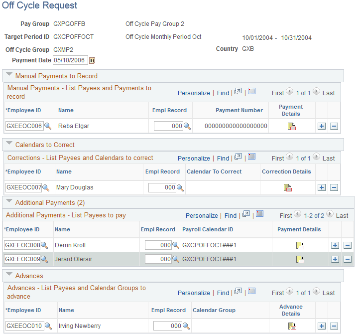

Off Cycle Request Page
Use the Off Cycle Request page (GP_OFFCYCLE_REQ) to access the detail pages of the off cycle transaction types for the employee IDs that are entered.
Navigation:
  • Click Create Request on the Off Cycle On Demand page.
  • Global Payroll & Absence Mgmt, and then Absence and Payroll Processing, and then Off Cycle, and then Off Cycle Request, and then Off Cycle Request
This example illustrates the fields and controls on the Off Cycle Request page.
Employee ID
Enter the employee ID in the applicable off cycle transaction section. The section will limit itself to payees (and jobs) associated with the pay group that is associated with the off cycle group.
Empl Rcd Nbr(Employee Record Number)
Select the job for which you want to create the off cycle transaction.
Reason
Select the default reason code or the reason code that is applicable to the off cycle request being created. This field is available only if you have configured the off cycle transaction type to use reason codes. The configuration is completed on the Off Cycle Configuration page.
Note: A reason code is only used if a configuration has been created for the transaction type. If you enter a reason code it means you have chosen a specific configuration.
See Understanding Off Cycle Configurations.
Payment Details, Correction Details, or Advance Details
Click to access the Manual Payment Detail page, Correction Detail page, Additional Payment Detail page, or Advance Detail page, where you enter the details for the applicable off cycle transaction type.
