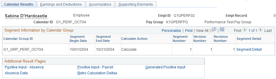

Results by Calendar - Calendar Results Page
Use the Results by Calendar - Calendar Results page (GP_RSLT_CAL_SEG) to view segmentation information for a payee.
Page includes links to other pages that display positive input, absence, and retroactive results.
Navigation:
Global Payroll & Absence Mgmt, and then Absence and Payroll Processing, and then Review Absence/Payroll Info, and then Results by Calendar, and then Calendar Results
This example illustrates the fields and controls on the Results by Calendar - Calendar Results page.
Field or Control Description
Segment Detail
Click to access the Result Segment Detail page.

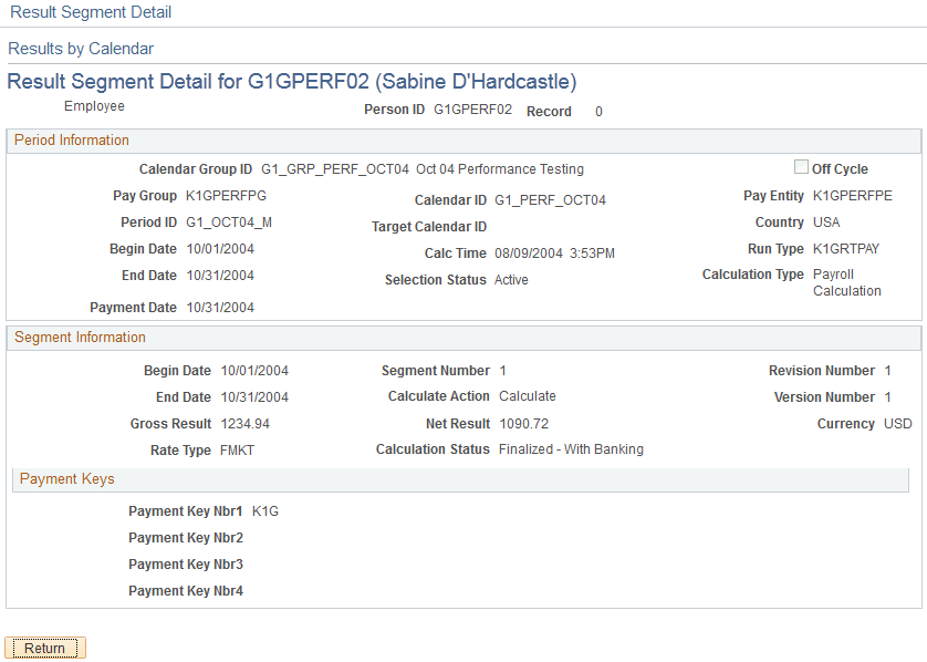

Result Segment Detail for <EMPLID> Page
Use the Result Segment Detail for <EMPLID> page (GP_RSLT_SEG_SP) to view more information about a segment's process and segment statuses.
This page is also accessible by calendar group.
Navigation:
  • Click the Segment Detail link on the Calendar Results page.
  • Click the Segment Detail link on the Calendar Group Results page.
This example illustrates the fields and controls on the Result Segment Detail for <EMPLID> page.
Period Information
Period ID
The ID for the time period that is covered by the calendar.
Begin Date and End Date
The begin and end dates that are associated with the Process Stat record. The dates match the calendar begin and end dates.
Target Calendar ID
The target calendar that you selected when defining the calendar for this calendar run.
Calc Time (calculation time)
The last time that calculations were run for this payee.
Segment Information
Rate Type
The exchange rate type associated with the payment. (You define the exchange rate type on the Pay Group Name page and can override it by payee.)
Calculation Status
Values are:
Active in Segment: Payee was active for at least one day during the calendar segment.
Inactive in Segment: Payee was not active during that time period.
Finalized: This particular calculation for the payment/transaction has been finalized.
Transaction Type
Appears for off-cycle results. Values are Correction, Advance Payment, Unscheduled Payment, and Manual Payment.
Payment ID
The ID of a manual payment.
Payment Number
The payment number of a manual payment.
Payment Keys
This group box displays any payment keys that have been defined for the payee's pay entity.

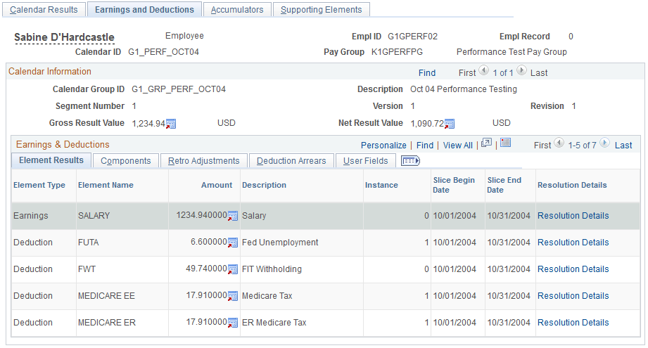

Results by Calendar - Earnings and Deductions Page
Use the Results by Calendar - Earnings and Deductions page (GP_RSLT_CAL_ED) to view information about earnings and deductions for a payee.
Navigation:
Global Payroll & Absence Mgmt, and then Absence and Payroll Processing, and then Review Absence/Payroll Info, and then Results by Calendar, and then Earnings and Deductions
This example illustrates the fields and controls on the Results by Calendar - Earnings and Deductions page.
Amount
The amount that the system calculated for this element. For deductions, this is the amount plus the payback.
Retro Adjustments
Calculation Adjustment
If there was retroactivity for the earning or deduction element, the sum of any retroactive adjustments that were applied during this pay period.
Base Adjustment
If base is a component of the element's calculation rule, the sum of any retroactive adjustments applied to the base amount during this pay period.
Unit Adjustment
If unit is a component of the element's calculation rule, the sum of any retroactive adjustments made to the units during this pay period.
Deduction Arrears
Amount
The deduction amount plus the payback amount.
Amount Not Taken
The deduction amount that exceeds the net pay accumulator for the current pay period.
Payback Amount
The portion of the arrears balance that is being paid off during the current pay period.
Amount Added to Arrears
The amount that is added to the arrears balance accumulator. (The displayed value equals the Amount Not Taken if you selected Deduction Arrears Allowed on the Arrears page.)
Resolution Details
Click to access the Element Resolution Details page, where you can view resolution details for each element.

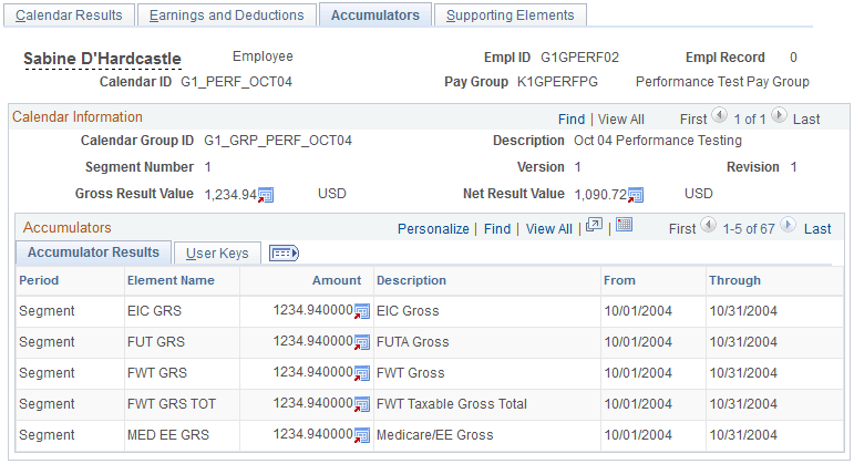

Results by Calendar - Accumulators Page
Use the Results by Calendar - Accumulators page (GP_RSLT_CAL_ACUM) to view accumulator amounts.
Navigation:
Global Payroll & Absence Mgmt, and then Absence and Payroll Processing, and then Review Absence/Payroll Info, and then Results by Calendar, and then Accumulators
This example illustrates the fields and controls on the Results by Calendar - Accumulators page.
Accumulator Results
Period
The period of time tracked by the accumulator.
User Keys
This tab displays the system element or variable element that is associated with the user keys for each accumulator.

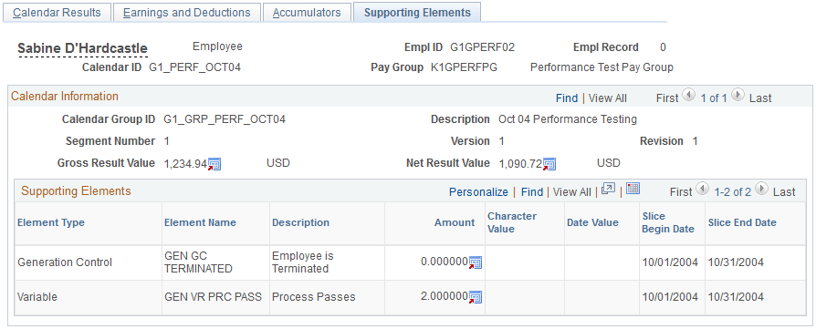

Results by Calendar - Supporting Elements Page
Use the Results by Calendar - Supporting Elements page (GP_RSLT_CAL_PIN) to view information for each supporting element that was used to calculate the earning or deduction amount.
Navigation:
Global Payroll & Absence Mgmt, and then Absence and Payroll Processing, and then Review Absence/Payroll Info, and then Results by Calendar, and then Supporting Elements
This example illustrates the fields and controls on the Results by Calendar - Supporting Elements page.
The type of value that the supporting element resolved to determines the column that it is listed under Amount, Character Value, or Date Value.
Slice Begin Date and Slice End Date
The begin and end dates of the slice in which the supporting element was resolved.
